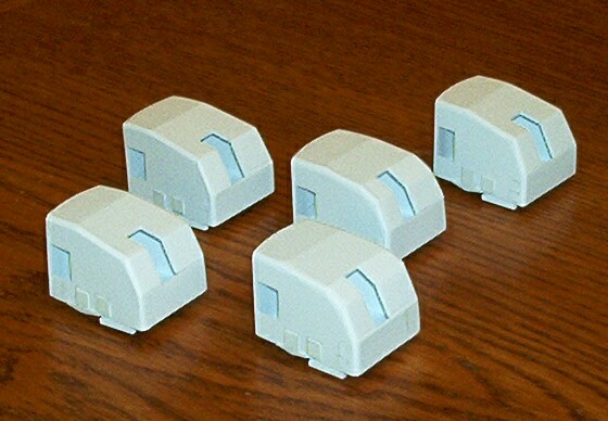

So the big question: improve the Lindberg gunhouses or replace them?
The kit gunhouses are inaccurately shaped, have little detail and the roofs
are all wrong.
The gunhouse on a real Fletcher is larger on one side giving the appearance
that the gun is off-center. The gun is truly on-center, it just appears off-center
because of the asymetrical shape of the gunhouse. The Lindberg gunhouses
are incorrectly symetrical.
Noticeably, the real gunhouses had roofs of two distinct types known
as "single knuckle" and "double knuckle". The roofs of the two turrets on
the main deck are the two "double knuckle" turrets. These are the
foremost and aft-most turrets (aka Turret 51 and Turret 55). Those two
had additional reinforcement in the roof to protect the roof from muzzle
blast of the turrets mounted above on the 01 level. So those two turrets
have two joints (knuckles) in the roof. The other three gunhouses, those
mounted on top of the deckhouses have just one knuckle.
Also, the forward part of the turret on a real Fletcher sits over the barbette,
not the center of the turret as it does on the Lindberg kit.

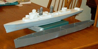

Other than length, the Lindberg kit's hull is inaccurately shaped. Here is
the Lindbergh hull in front of my scratch-built hull. You can better see the
shape difference between the Lindberg supertanker hull and one made
from accurate plans.
On the scratch-built hull in this photo you can see
the deckhouses for the late war Fletcher I had orginally intended. They
have all since been replaced. When I began the project a while ago, I
first built and installed deckhouses for a late-war Fletcher with the heavy
AA modification (quad Bofors in place of twins and the forward TT mount,
etc.). I later decided to build one of the five Fletchers built with twin
rudders. Research indicated that DD-802 did not receive the heavy AA
modification during the war and the only two wartime photos of her I
could find show her without the heavy AA mod. In those photos she
carries two TT mounts and all Bofors mounts are twins. So I replaced the
deckhouses to match DD-802's appearance in the photos.

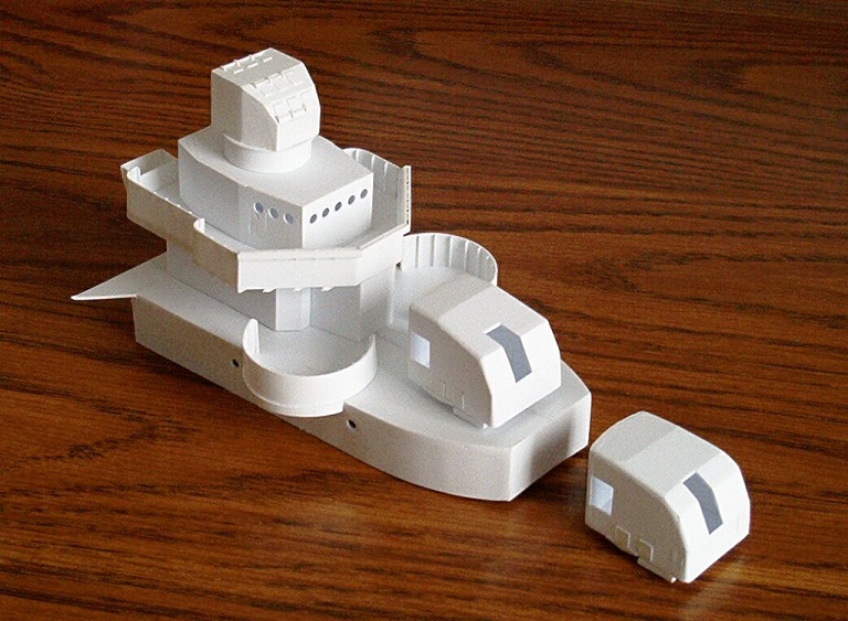

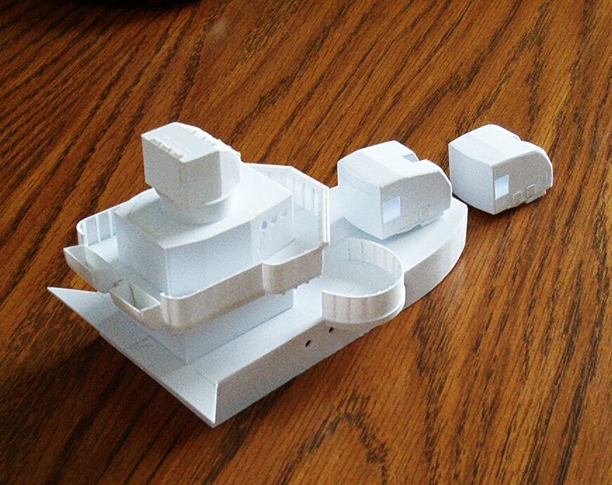

Roughing out the 5-inch gunhouses. Some seam cleanup is still required
using a bit of putty and sanding. The gunhouse roofs, floor and back are
made from .040" styrene but the sides are made from .020. I chose
thinner sides so that the thickness at the hatch openings would appear
more scale.
Much work yet to do. You can see that the basic shape for each is done
but the gun openings need to be extended a bit further down and there
are numerous details to be added such as gun captain blast shields for
two of them, hatches, spent-shell ejection chutes, vents, etc., etc. I like
the idea of having the hatches open.
Notice the gun openings appear off-center. That's because the gunhouse
for a 5-inch/38 is larger on the left side of the gun to accommodate the
gun crew and fuse setting mechanism. Also notice that two of the
gunhouses have two-knuckle, reinforced roofs while the other three have
just one knuckle.
A friend has offered to send a couple resin mounts. Thanks Tim! If mine
turn out well, I'll cast them and send him a full set as a thank you.
A special thanks to Cadman and Bruce Ross!

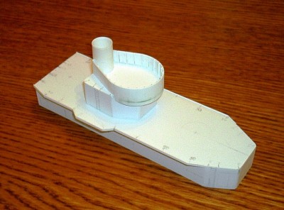

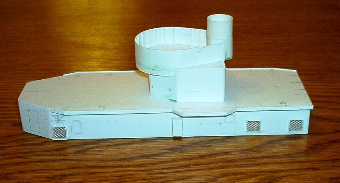

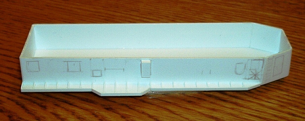

Thanks to Bruce Ross for his terrific scans of actual plans, I began
detailing the deckhouses.
The first step is to determine the kind and
location of structural details of the specific ship you are modeling, in this
case DD-804. There were 175 Fletchers built in 11 different yards on both
coasts. So they varied greatly in details.
DD-802 was among the last 21 Fletchers built at Seattle-Tacoma.
I could only find two wartime photos of DD-802. Although terrific
photos, it was difficult to make out the kind and location of some of the
details such as vents, ladders, etc. But it seemed reasonable that the 21
Fletchers all built at the same yard would be very similar if not identical.
So I began to compare the structural details appearing in the photos of
the 21 Fletchers all built at Seattle-Tacoma. Sure enough, the structural
details of those ships were consistent. I felt confident that if a detail
appeared on a photo of any one of those 21 Fletchers, it was very likely
to appear the same way on DD-802.
The next step was to mark detail locations in pencil on the deckhouses.
The markings did not have to be exact drawings of the details, just simple
sketches to indicate what the detail was and where it was located.
Fletcher trivia: some Fletcher class destroyers had spent shell casing
ejection chutes fitted to the backs of the turrets. The stanchions near
those turrets were located away from the deckhouses on outriggers so
that the chutes would clear the stanchions as the turret rotated.
On the model, normal stanchion locations are marked "S" while those on
outriggers are marked "SO".
Supporting structure under the overhang is in place as well as the trim around the deck edge.  This was made with .020 x .060 styrene strip.  It was cut to the proper angle using my favorite tool, a common cuticle clipper.
Splinter shield has been installed for the gun director.  It is styrene tubing that has been thinned from the inside for a more scale appearance.  I simply turned a curved Xacto blade inside the tubing to thin the wall.

are made from Evergreen .015 x .040 strip (0.4 x 1.0mm).
