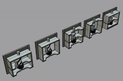

Re: USS Monitor turret engine crankcase
Posted: Sat Mar 19, 2011 9:27 pm
by mcg
We have a couple of overhead views of the crankcase for the V-twin turret engine, but the side views are incomplete or unclear. So basically we start from a 2D overhead view. The best one we have (Peterkin #176, Stevens McCord collection No. 30/124) is a rough draft, with several crossings out, erasures, overdrawings and redrawings. Accordingly, there are several possible 3D interpretations of how the turret drive crankcase looked and worked. Here are five mocked up possibilities:
2D shows at least one curved shelf -- but why, where and how many?
In this circumstance, you can only ask yourself, how should this thing work? And try to guess the most reasonable approach.
Here are some design criteria for the crankcase:
1) It must be possible to assemble it. Put another way, there must be some means for getting the crank into the crankcase.
2) The crankcase requires adequate clearance to swing two connecting rods. We have one partial overhead sketch of one of these con rods, and some circles and lines Ericsson pulled to show their range of motion.
3) It requires adequate room for the valve gear drive, which consists of two eccentrics driving two rods to actuate the valves.
4) The crankcase must stabilize the crank and the pinion against very considerable reversing loads. For this reason I think it needed a middle bearing between the crank and the pinion.
Here is my current guess at the structure of the crankcase.
One assumption is that the crank pin could be locked and unlocked. According to a handbook on 19th century steam engine practices, this was a fairly common mechanical feature.
It appears from the drawings that Ericsson provided simple (un-split) thrust bearings at the top and bottom of the crank, inset or simply cast into the basic box. In the middle of the crank, between the crank and the pinion gear, I am guessing there was a bearing set into a web. This central web would work very like a crankcase web you would find if you dropped the pan of a modern IC engine. At this middle web, there would have been a cap secured with bolts -- a split bearing surface. All three bearings could be align-bored.
To install the crank, the lower half would have been positioned in the bottom and web bearings. The upper component of the crank could then be loosely mounted on the crankpin, and rotated into the box. It could then be slid upward along the crankpin so that the crank axle seated in the upper thrust bearing. The crankpin would then be locked or pinned in place. and the split middle bearing completed with a bolted cap.
The open box structure of this crankcase allows sufficient clearance to rotate the ends of two connecting rods.
Above the crank, it appears there would be room enough for two cams, each driving a valve of the V-twin steam cylinders. These cams certainly exist, but it is not clear from the drawing where on the shaft � up or down or in the middle -- the cams were positioned. They appear only in an overhead view (Peterkin #13, Stevens McCord collection No. 14). I�d like to put them on the upper part of the crank because there seems to be room for them there, and because this positioning gives the valve rods a reasonably direct path to the valve linkage.
Clearance looks adequate for the two valve rods to rotate on their eccentrics. So this mock-up looks plausible, but to see whether this type of crankcase could actually work, I will need to fill in the cams, the valve gear and the connecting rods.
Re: USS Monitor turret drive machinery
Posted: Tue Mar 22, 2011 9:50 am
by Fritz
MCG,
Looks like a reasonable method. Some very nice investigative thinking. I assume that the split bearings would be grease lubricated brass liners?

Update. The computer enhanced image has now come in from the Mariner's Museum. My speculation that the crankcase had three tiers now seems very unlikely. There isn't enough room between the pinion and the crank for a third bearing. So the likelier crankcase, in light of the new SIDE image, is a simple box with just two bearings.

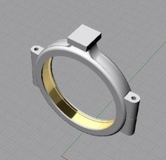

Everyday 19th century steam engines commonly used eccentric sheaves and cams to time the valves.
Here is photo from "Steam on the water", a blog by a steam enthusiast that shows some typically Victorian eccentric sheaves.
http://2.bp.blogspot.com/_irmB-ntBP9o/T ... heaves.JPG
Here is a pair of cams and sheaves in action, in an animated valve gear of the Stephenson type.
And here is a simplified application in a typical steam engine with a slide valve.
http://www.mgsteam.btinternet.co.uk/svalve.htm
In an early USS Monitor drawing (Peterkin #13, Stevens #14) eccentric sheaves and cams are clearly present in an overhead view of the turret engine crankshaft. But Peterkin thought this drawing was just a draft or preliminary sketch, and points out several other features that do not appear or change markedly in subsequent drawings.
In any event, the eccentric sheaves and cams disappeared -- vanished completely -- in subsequent drawings of the USS Monitor.
In Starseeker's astonishing drawing of the Monadnock turret engine, we get a hint at what may have happened. It depicts a valve gear and reversing mechanism in which there are no cams nor cam followers.
The valve drive push-and-pull for each cylinder's slide valve is picked up (borrowed, in effect) from the crosshead of the other cylinder in the V-twin. This works because the two cylinders are locked 90 degrees out of phase.
This type of camless valve drive is usually attributed to Otis W. Young, who patented it for use in steam locomotives in the 1920s. Apparently Ericsson or some other inventor in the 1850s or 1860s had already visited this very good idea.
As for the USS Monitor of 1861-2 it is hard to guess whether or how much of the 1864 Monadnock technology applied. In the USS Monitor we have the mysterious absence of cams and sheaves -- they are missing from all but one of the USS Monitor drawings, and that one is thought to have been preliminary. Although "absence of evidence is not evidence of absence," I will probably rely on the camless Monadnock technology from here on.
Eventually the turret drive will come up from underwater, and on that day we can quit guessing how it worked.
Starseeker, thank you again for this huge contribution. Re the copyrights, the Peterkin book is not copyrighted, However, every important drawing in it was reproduced with attribution and specific permission from one collection or another. This is the 150th anniversary of the civil war, a lot of books are coming out for the occasion, and I notice the collections are extremely careful about preserving and marketing their rights. No objections from me. Money raised this way goes to the good causes of diving expeditions, documentation and preservation.
no cam small.jpg (32.36 KiB) Viewed 7416 times
This is one of the eccentric sheaves I was working on. The brass bearing inset is relieved for the cam.
This shows the cam ghosted into place, clamshelled between the two halves of the eccentric sheave, which was also called an eccentric strap. The cams as sketched are 1.5 inches deep, and the USS monitor crankshaft and crankcase are designed with just enough room to stack two of these, one per cylinder. One possibility is that cams were in fact used in the Monitor, and another is that they were discarded around October, 1861, in favor of the much cleverer camless system researched by Starseeker. The whole turret drive apparatus, which Admiral Porter dubbed "the coffee grinder" was installed in the ship at the Continental Iron works in the last week of November, 1861.
I may end up drawing the system both ways, since I have already sketched the cam system. Michael
