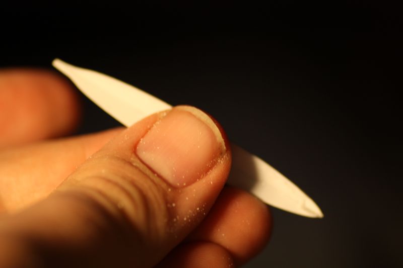

We begin with two strips of styrene cut to an identical length and taped together using double sided tape.
Measuring... much too long, but that was intended... always easier to shorten things than to lengthen them... :big_grin:
Tapering to a fine point for the bronze ram at the bow.
We have trimmed and shaped to the correct length. Now opening the 'sandwich' of the two identical halves of the waterline plate...
The tape has served its purpose and can now be removed.
