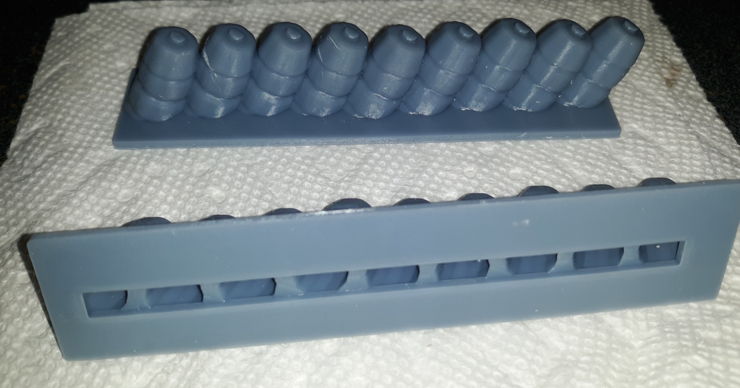

Here's all 200 hammocks mostly in groups of 9.
A battalion of hammocks
The hammocks are on "trays" of 9 hammocks each.  All hollow to save resin/money and weight.
About half the hammocks printed, with a quick coat of "canvas" (white with some tan) airbrushed on.

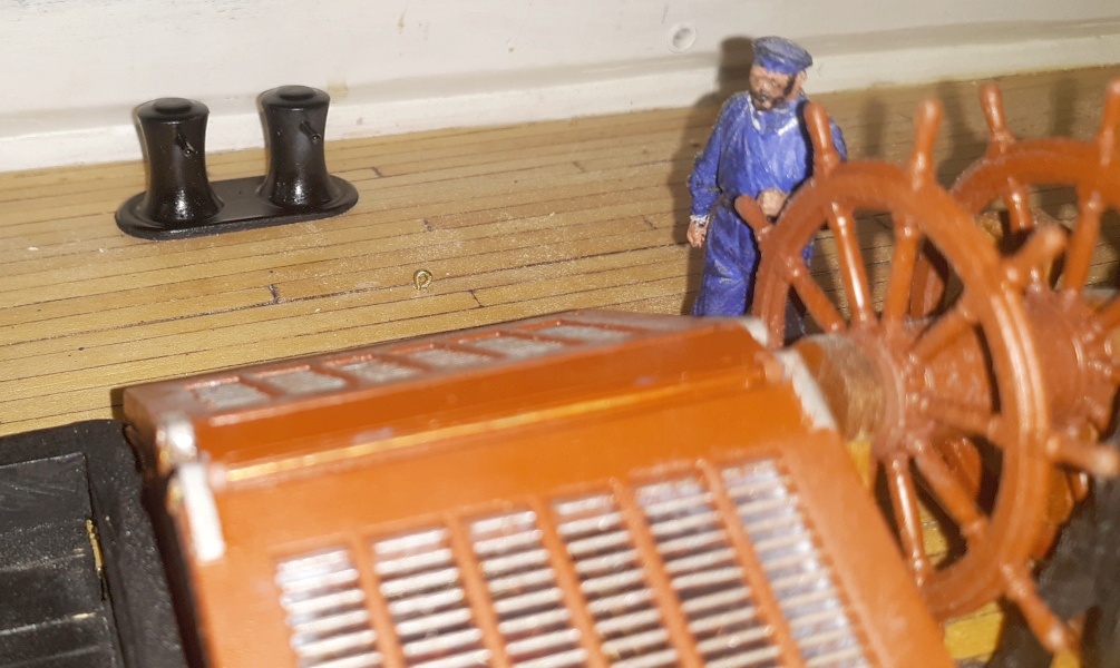

The new skylight sashes and the wheel all got painted. The skylight sashes are glazed with a couple of microscope slides.
Skylight and wheel got painted
The skylight has a couple of microscope slides for glass and opens for access to the main power switch.

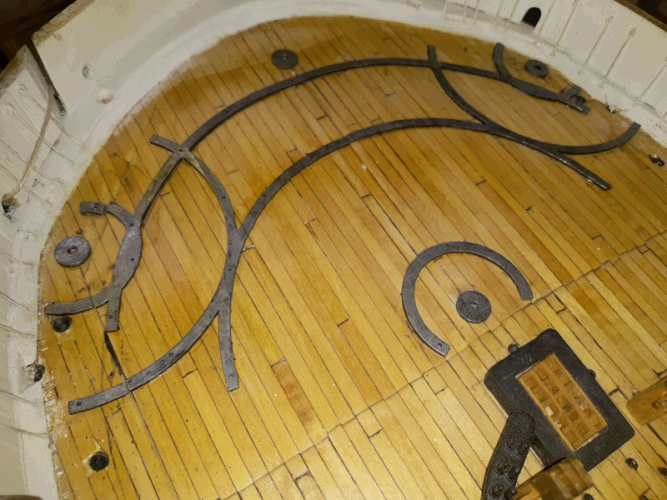

The gun circles (rails on the deck for the pivot guns to slide on) were hand cut from sheet styrene and were too sloppy, too wide, and too thin. I modeled new ones using the 3D model of the gun as a reference for size and proportion. These got printed in one go, but unlike the oars, I left more space between things so the supports would stick to the parts.
New gun circles were modeled using the 3D model for the guns as a reference to make them more accurate; and printed all in one go.

Made 4 sets of bitts as shown in her 1884 deck plan and earliest photos
Bitts
Bitts

More elaborate deck circles printed
Bow deck circles painted Steel
Stern deck circles painted Steel

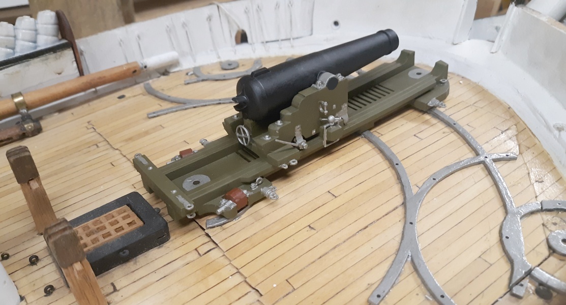

Finally got some Olive paint that didn't need a higher credit score to get, and airbrushed the pivot gun carriages
Using Testors Flat Steel to pick out the gun's iron work

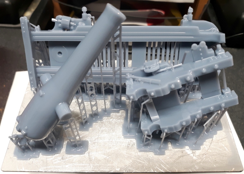

The parts of the model that make it a warship - the pivot guns all painted.
Bow pivot gun
Bow pivot gun
Stern pivot gun
Stern pivot gun
without paint, for reference
Pivot gun just printed

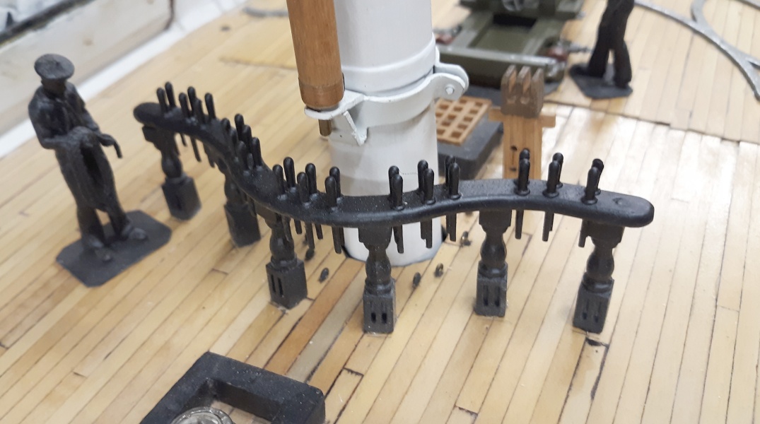

Pin rails installed at the base of the fore and main masts

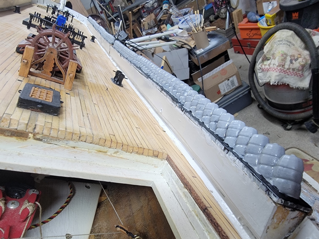

Gluing down starboard side hammocks
Seam between hammock pieces and bulwark covered with a strip of basswood.  Still 3/4 of the rails to do like this.

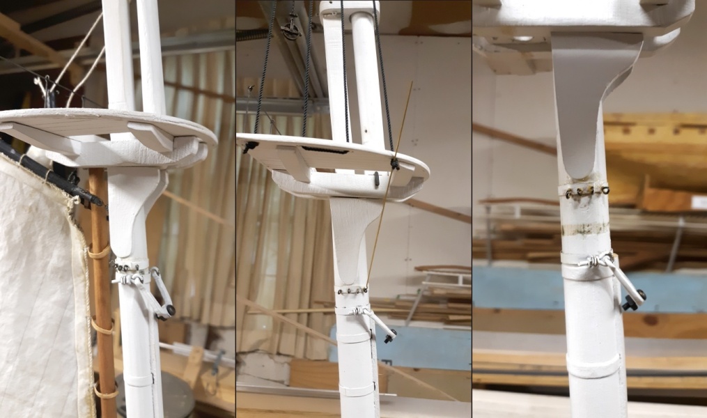

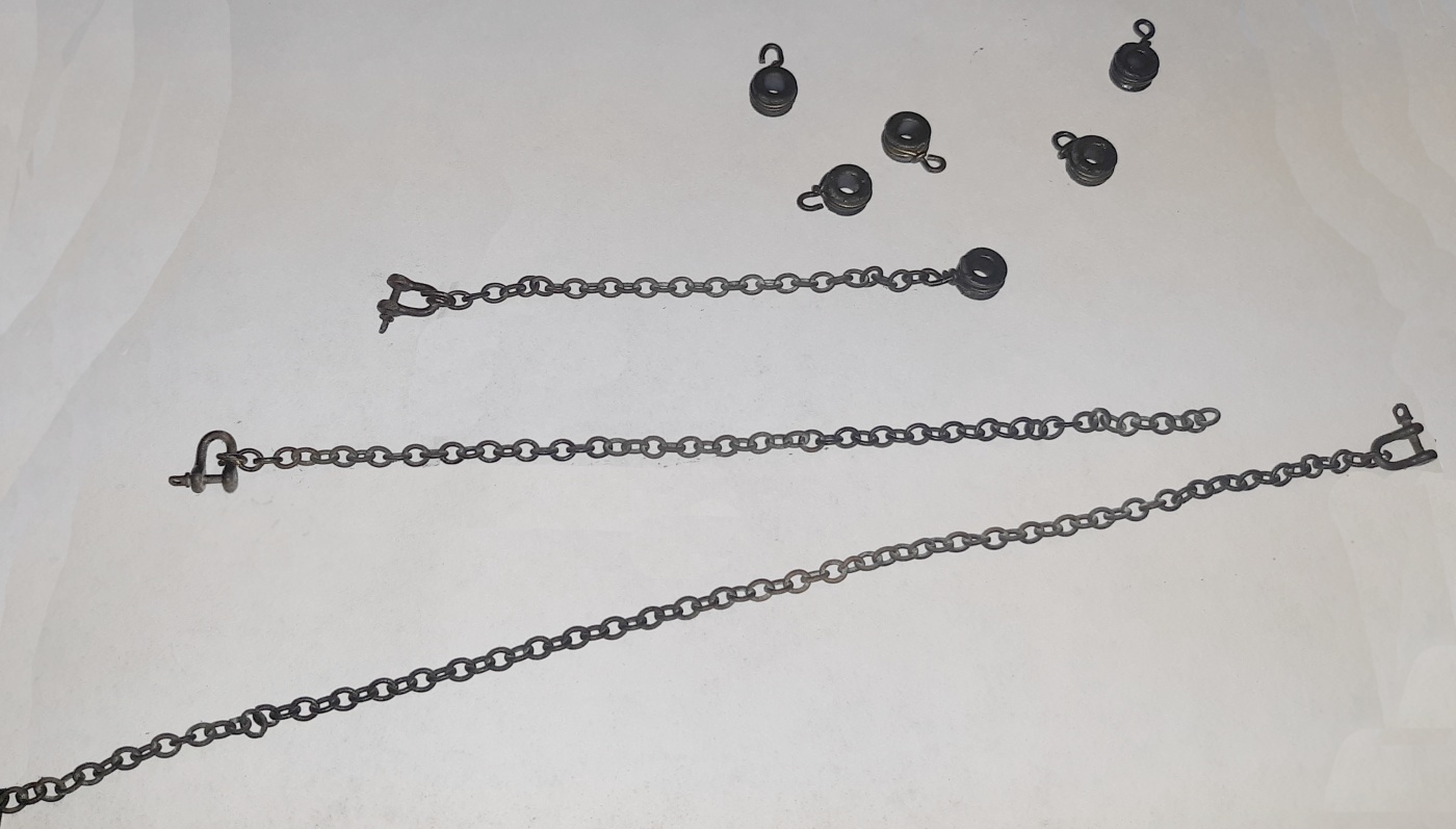

A bit of research nailed down that the ship was rigged with rigging-screws (turnbubkles) from the start (1855), and didn't get deadeyes-and-lanyards until nearly 1914.
The red arrows are the rubbing boards I was looking for when I realized this 1856 portrait of the ship showed she didn't have deadeyes-and-lanyards.
Constellation at Naples 1856 by deSimone
Finding good images or specs on these things is hard, but going with the best photo I could find, I came up with...
Constellation's rigging-screws c.1884 and 3D model on the right
Obviously, you won't find these things, especially in 1:36 scale, at any vendor, and I couldn't even find left-handed taps and dies (or steel screws and nuts to use as taps and dies) to make a functional version with. Having had good luck with 3D printed parts in a somewhat "structural" use, I opted to model and print them. I saw 3D printing used to cast jewelry, and looked into that with the idea of having solid, non-functional ones in brass, but that's not looking like something I can afford to do, or have done.
Two rigging-screws in place to test
After adjusting the 3D model, 45 more were printed...

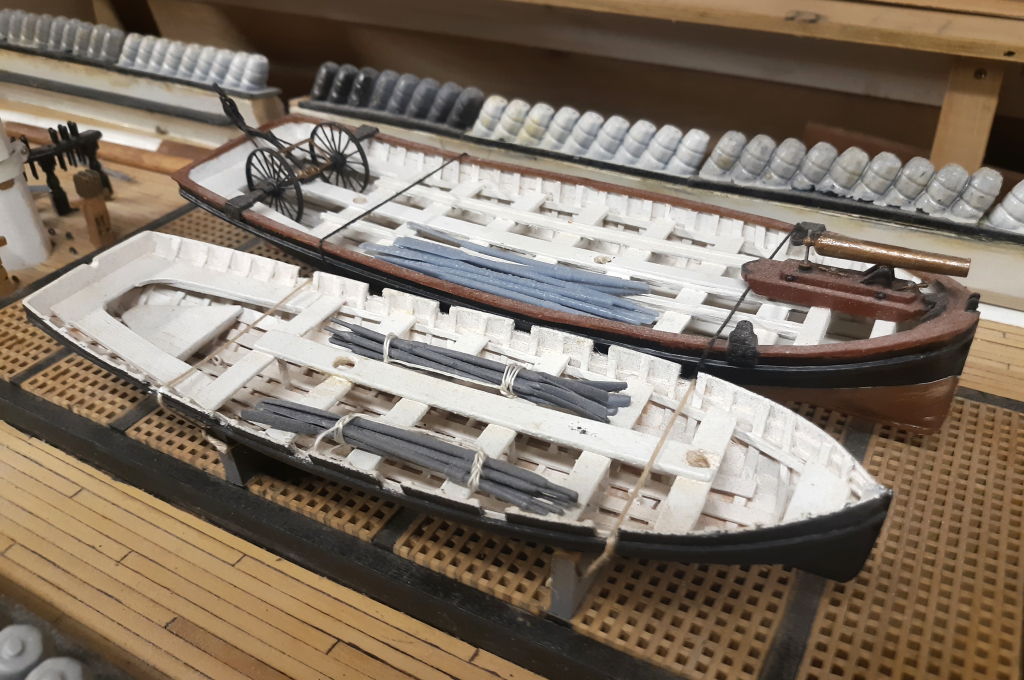

As 3D printing things for the models was going pretty well, I decided to also print the remaining boats. I had already built the launch and 1st cutter, and planned to build the 2nd cutter next, in the same way, but began a 3D model back in 2020.
Ship's launch and 1st cutter in wood with some 3D printed parts added.

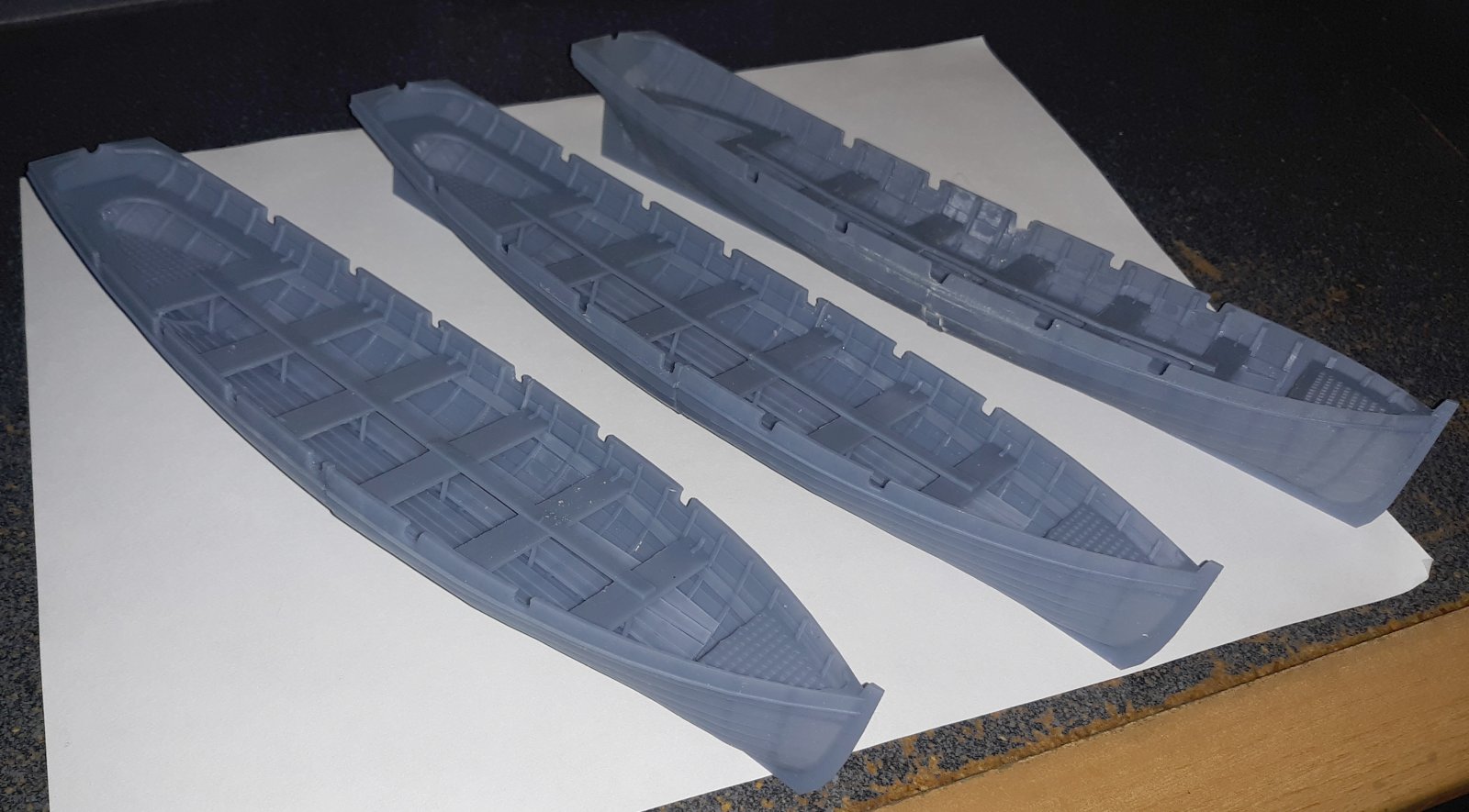

These boats look very much like the cutters, but are a little longer, not as tall, with narrower sterns. At 1:36 scale, they're about 8-7/8th inches long (22.5cm). All the boats will be too long to print in one piece, and are made in halves, but both quarter-boats can be printed at once with room to spare.
In the slicer; done in halves to fit in the printer's available volume.
Printing took about 5-1/2 hours.
Printed and washed
Printed and washed

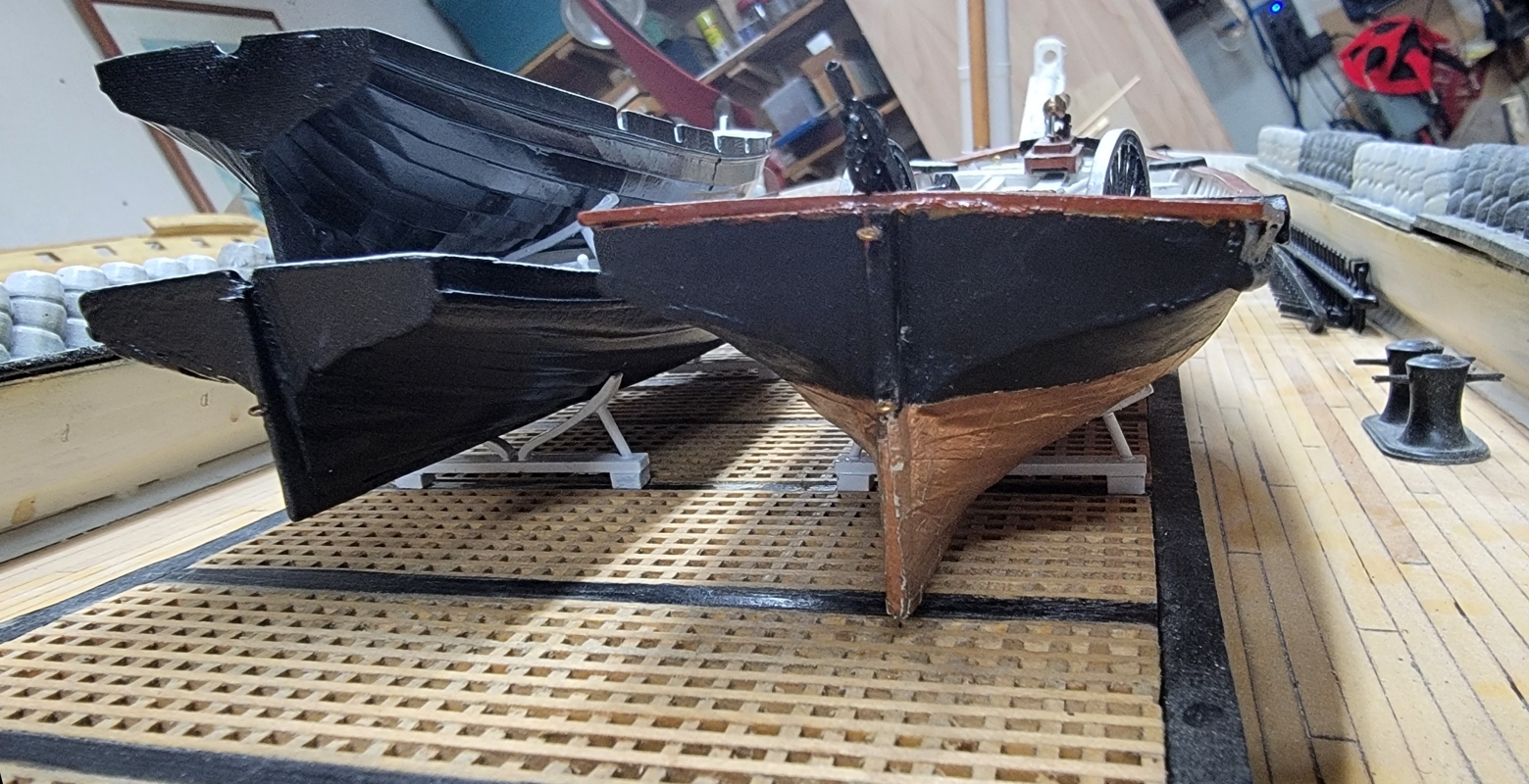

Two quarter-boats and the 2nd cutter
Here's the boats sitting about where they'll live on the main model
Where the boats go on the main model

The slide for this gun, while very like the Mississippi gun's slide, was wider and shorter. I used the slide from the 3D model of the previous pivot gun, shortened and widened, which saved some time and effort.
I printed the gun in three parts; slide, carriage, and tube; to facilitate painting, and reducing what I'd need to reprint if one of the parts failed. The first gun lost one of it's rollers, but I could fix that without reprinting. The second gun printed perfectly.
Second gun, fresh off the printer

A shorter slide meant I needed to make new deck tracks, which I 3D modeled like last time, but I made them short/thinner to be more in scale.
The guns are mounted on access hatches, fore and aft. I removed the old tracks, sanded the scars best I could, and re-coated the hatch decking with polyurethane. The newly printed tracks were primed, painted, glued onto the hatches, painted again, and the whole thing was clear-coated. The guns too were primed, and the tubes painted and detailed, but the carriages and slides are waiting to be painted the same olive color as the old set.
Deck hatches cleared of old tracks and refinished.

After airbrushing on a couple of coats of Testor's Flat Olive, I painted all the hardware with Testor's Flat Steel, then cut in the Olive again to neaten things up. The rollers were lignum vitae, a very hard wood used for such things, including sheaves in blocks, and bushing blocks, and so on. These I painted "Rust."
Getting painted
Getting painted
The aft gun (left in photo) lost a roller during printing and I replaced it with a bit of mahogany dowel, and filled in the missing portions with built up resin ~ drip some in, zap with UV, drip in some more, zap again, etc. There's a little more touch-up painting, and then clear-coat to do.
Almost ready for rigging
These will get attached to the access hatches as shown, with two screws each. Eye-bolts will get installed along with the blocks and tackle used to shift the guns about on deck. The aft gun is set off like that and will have a few crew members around it to be more interesting, and out of the way of the spanker sheet - this is a working model after all. The forward gun is left centered and no figures will be up here to keep clear of the heads'l sheets.

To that end, an item Constellation needs before rigging can begin are her pin-rails. It'll be near impossible to install them once the rigging's going up, and many rigging items attach to the pin-rails.
I opted to 3D print the pin-rails that attach to the bulwarks as I did the ones at the base of the masts.
3D printed Pin-rail at base of the fore-mast
There are basically four pairs of pin-rails: Port and starboard at the mizzen, main, fore, and a pair at the bow on either side of the bowsprit.
Building from the 3D models of the mast rails, mostly belaying pins and the shape of the rail, and getting size and shape from an 1888 spar-deck plan, and the few photos that show enough of anything to work with; I started with the aft rails. The printed with a little deformity at one end that was repairable, but I also had forgotten to account for the fact that the bulwark they attach to leaned inboard and I had not modeled in that angle. I fixed the 3D model and it printed perfectly.

There's a fife-rail around the base of the mizzen (rear-most) mast, but I can find any thing showing pin-rails at the stern. There may be pin-rails in the mast tops, or just cleats seized to the shrouds. to determine this will require investigating the ship's contemporaries as I haven't found anything specific to Constellation regarding it.
These rails need to be drilled for attachment pins; then primed, painted, and clear-coated before they can be installed.

Installing the pin-rails is a bit involved. Painting the bulwarks after the pin-rails are installed would be a huge pain-in-the-a$$.
The 3D printed hammock are on "trays" that are slightly wider than the bulwark to accommodate any irregularities. That overhang has to be ground flush with the bulwarks, so a covering board trim piece can hide the seam.
3D printed trays of hammocks
How the model's bulwarks are constructed
That done, any gap were filled with epoxy/sawdust putty, and the bulwarks got painted. I also painted the hammocks, but the color doesn't look canvas enough for me.
Hammock trays ground flush, and some paint
The covering board is a strip of stained basswood.
seam cover on
seam cover on

In between the step, waiting for paint and/or glue to dry, I made cradles for the boats, painted the boats, inside and out, made new crown-bitts, and blocks.
Boat's on their new cradles
New crown-bitts and an old one
3D model of working and static large blocks
