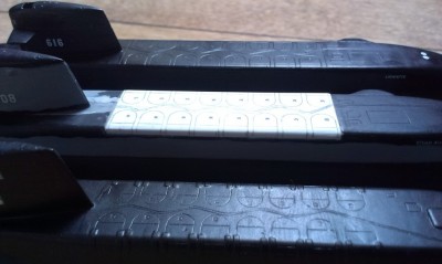

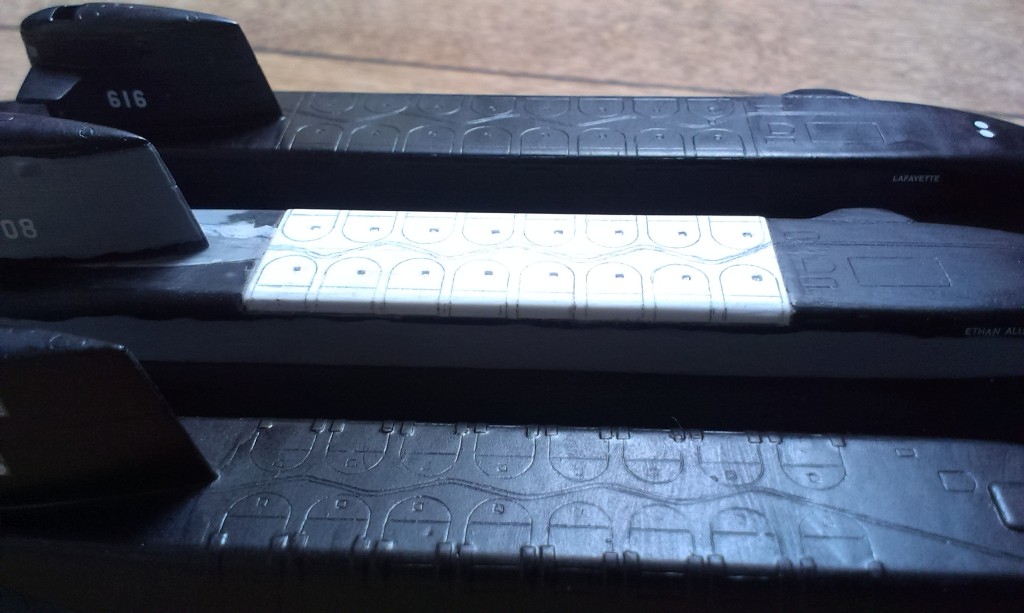

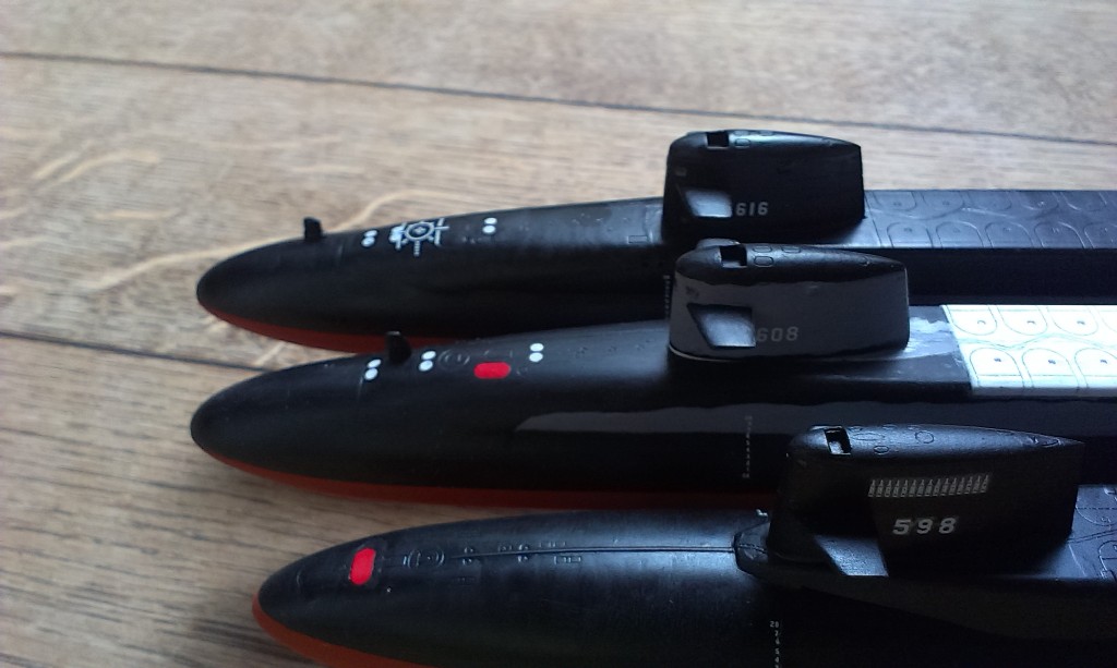

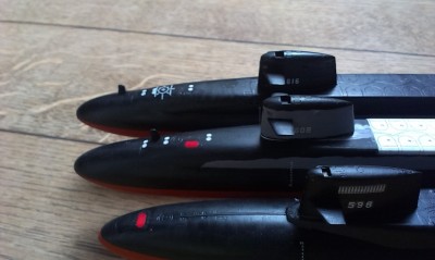

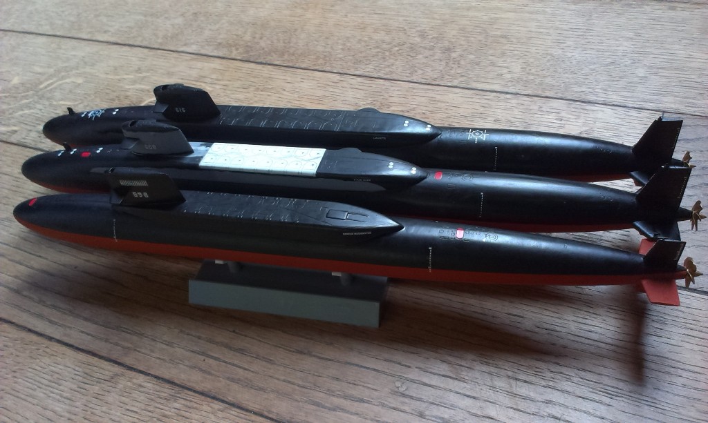

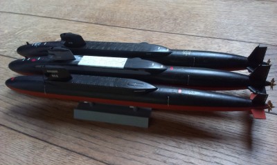

Maarten Sch�nfeld wrote:Here's the math: there are eight missiles lengthwise, each Poseidon missile adds 22", so that makes 176" in total. The difference between the Allans and the Lafayettes is 180", so only 4 inches not accounted for, or less than .3mm on 350 scale...
Most authoritative sources quote the length of the Ethan Allens as 410 feet 4 inches, so the difference with the Lafayettes is only 14 feet 8 inches, or 176 inches. This equals therefore exactly the added increase of the diameter of eight missiles.
I was convinced, so I bit the bullet. Here's my Ethan Allen, in company with a George Washington and a Lafayette model, with the missile compartments aligned:
I'm only somewhat uncertain about the location of the hydrophone stump on the bow, it seems somewhat closer to the sail than on the subsequent Lafayettes. Can someone shed some light on this maybe?

" [And then checking the references: as the Poseidon missiles were 6'2"in diameter versus the Polaris 4'6", this differences could very well be accountable for the length difference between the Allan and Lafayette boats, and also the explanation why the Allans couldn't be upgraded to carry the Polaris missiles. Here's the math: there are eight missiles lengthwise, each Poseidon missile adds 22", so that makes 176" in total. The difference between the Allans and the Lafayettes is 180", so only 4 inches not accounted for, or less than .3mm on 350 scale..."
The Poseidon is 6'2" or 74 inches and the Polaris is 4' 6" or 54 inches. The difference is 20 inches, not 22 inches. Where does the extra 2 inches come from?
Eight tubes times 20 inches is 160 inches, not 176

You guys got it wrong. Upgrade from Polaris to Poseidon made no difference to the boat length whatsoever. They simply took out the inner 'launch' tube from within the 'mount' tube to make the transition. This happened during a scheduled yard period.
Trust me, I was a Launcher Tech (Torpedoman) on the WEBSTER for nine patrols.

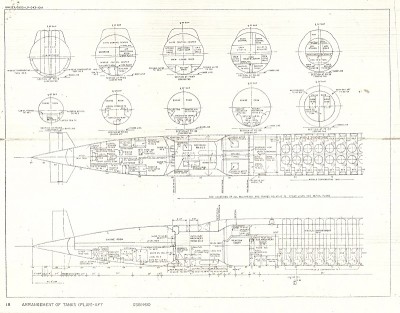

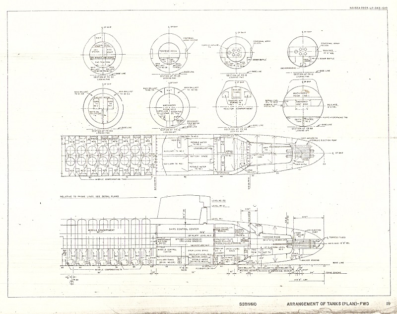

Maarten,
Maybe these will help:
John :wave_1:

WOW! I hadn't guessed these plans would ever become available! Many thanks John!
Just in case: do you happen to have slightly larger scans of these plans? The figures are only just readable, it would be so much helpful if we would have some numerical data available.

Hi Jacob,
That's really awesome! Where on earth do you get these plans from? And I even note they aren't exactly the same, as these are from SSBN 611, whilst the previous ones were from SSBN 610. True sisters I suppose, though.
Adding all this info doesn't make it any simpler: I already have to confess my assumptions don't seem to hold, as the missile compartment is definitely longer than the one in MikroMir's Washington model. I'll have to study these plans very closely befor I make new assumptions!
In the meantime my Ethan Allan model build will appear into the Gallery one of these days, please take my assertions there with a pinch of salt! Definitely an update will be needed soon.

Someone kept their Qualification notes and documents.
Those drawings came out of a piping training aid book (TAB). One of four (I think) system TAB's used by people qualifying or re-qualifying aboard a specific class of submarine. The drawings in there taken with a grain of salt as there are zingers in there -- for example, the trailing edges of the upper and lower rudder fall along the same vertical line, not staggered as you see in the profile drawings, etc. The piping TAB featured page after page of rationalized schematically presented hydraulic, sanitary, hydraulic, trim, MSW and ASW water, and weapon impulse runs. The other TABS where block-schematics of electrical distribution, reactor control, and other systems.
Those same plans of the boat from the TAB were also found in the more comprehensive Ships Information Book (SIB), a multi-volume document which provides a detailed discussion of the function, design, and use of the boats sub-systems; as well as a chart and graph heavy identification of the boats performance and dynamic characteristics in all conceivable situations.
Each crew had a piping TAB, but had to dig out one of the big SIB's for the narrative of the sub-system in question. Copies of these big books were held by the Engineer in Maneuvering, a copy in the Wardroom, and likely another copy down in the crews library.

David: thanks for explaining the source and purpose of the drawings! I hope we will see more of these soon, also from the other SSBN classes maybe?
My first analysis (putting all frames in a table, with their correct interval distances) brings me to these conclusions:
- in the 608 (Ethan Allan) class the missile section (frame 60-84) is exactly 70 feet long: 24 frames of 35 inches interval. This means three frames or 105" per missile tube. (note: the actual compartment is longer, from frame 58 to 85, but these frames are not very clear from modelling point of view).
- The Benjamin Franklin class drawing doesn't show the frame positions, nor any dimensional data, unfortunately. I scaled the drawing however to match the MicroMir Lafayette model, and all the missile tubes, sail and upper casing positions line-up very well. I assume for the time being that the MicroMir model is quite correct.
- Based on this assumption, the length of the missile compartment in the Lafayette end subsequent classes is 76 feet: this means 9.5 feet or 114" per missile tube. A little more than in the Allen class.
- In MicroMir's George Washington (GW) the length of the missile compartment is 64 feet: this means 8 feet or 96" per missile tube. I originally assumed the Allens had the same length, but that is now proven incorrect.
- Apparently the 608 Allen class tubes were a sort of mid-point in dimensions between the GW and Lafayette classes. Or the tubes were similar to the later Lafayettes, but then the space between the tubes was smaller.
- The nose section ahead of the missile compartment was in the Allens shorter than in the Lafayettes: 136 feet versus ca 149 feet in the Lafayettes. This is visible as the sail of the Allen is more forward on the curved upper casing, as being almost on a hoizontal surface on the Lafayettes. So David's assertion that the Allens were shorter in the service spaces must be entirely correct.
- as the overall length of the Allans is 410 feet 6 inches, so not really different from the 410 feet 4 inches assumed initially, I envisage changing my model this way: replacing the deck over the missile tubes with a longer version, and placing the sail accordingly further forward. As I already reduced the length of the entire boat, the sail will get into the correct relative position to the bow. Of course I will add material to the bottom rim of the sail to keep it horizontal, relative to the hull.
I am very interested in your comments, whether I overlooked something?
