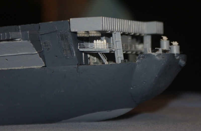

Update 103
I actually worked on the model itself last night. After much thought and discussion on the Calling all WWII Essex Class Carrier Fans Site regarding the smoke canisters and slide, I decided to go ahead and add them. For the slide I used a piece of PE fret and wrapped it around a piece of clothes hanger, which seemed the appropriate diameter. I then glued it to the little �jut� that I had wondered what was for and then cut a small strip of PE to secure and support it at the top at an angle that I eye-balled to match the photos I had found of the slide, including one of �SHANGRILA CV 38 UNREP 1945 STRBRD AFT� from the Bean Essex II DVD � Vol. 56, a clip of which is attached below.
The support strip, visible in the first two photos below, taken without the flight deck, will not be visible with the flight deck attached, and will add strength to the piece so it isn�t just hanging out in space.
I also added 5 smoke canisters to simulate the photo. I did this using 0.05� styrene rod that I rounded one end of before cutting to length. The canisters I have seen are white, so I didn�t even paint the styrene since it is already white.
To see what it will look like when completed (more or less), I dry fit the flight deck in place and took more pix.
Compare the photo below to the Shangri La photo above. I think it�s a pretty good representation.
I�m pleased with the result. I like the chute and it went on easily enough. However, because I decided to add the canisters late in the process, it was difficult to access where they needed to go, so getting them aligned properly before the gel CA glue I used dried was difficult. Therefore, a couple of my canisters are slightly crooked. To cover this fact, or �explain� it, I think I will have a couple of guys handling them and then one guy leaning on the end one, perhaps smoking a cigarette. My advice is that, if you are going to include gas canisters, put them on before attaching the upper level (part C19). It will be a lot easier to install them correctly.
Obviously I have plenty of painting to do, but I think that I will deal with the Gallery Deck bulkheads first.

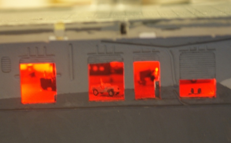

Of course I had to test them and take pix�

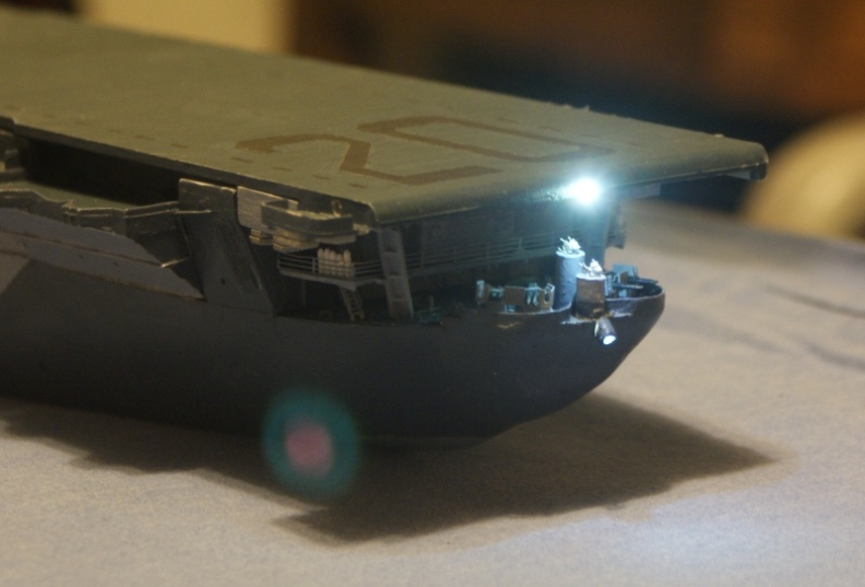

I love the lights, but I think that the stern light needs to be dimmed with at least one more coat of white enamel. I know that the lights are by no means realistic, but they are as close as my skills would allow, and I think that the effect is pretty cool. I could have perhaps used some of the fiber optic fibers one slim was kind enough to send me a while back, at least for the wake light, but I had already purchased the other lights, so I thought I would save that learning experience for my next adventure.

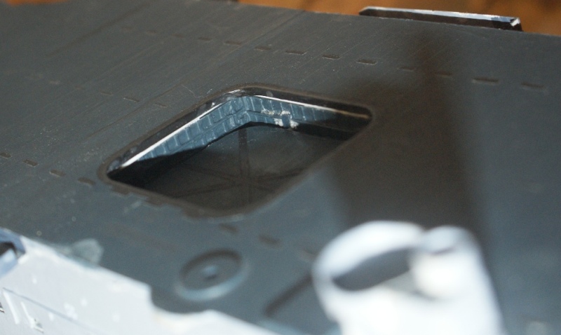

The question has to do with the fit between the flight deck and hull. It fits in place nicely and in fact almost snaps in place and is somewhat difficult to remove when in position. However, there is one spot, on the starboard side, in front of the island where the hangar deck bulkhead juts out.
I can get it to line up but I have to push fairly hard and the last time I pushed on it I heard a cracking sound which wasn�t good, so I don�t want to push on it too hard. Even so, I don�t know how I would hold it in position long enough for the glue to dry and even if it did, it seems like there would be a lot of force acting on that joint forever. I�m not sure what to do at this point, but I guess I have 3 options; 1) live with it, 2) try to force it into submission, or 3) heat it and ease it over. :scratch:
I don�t particularly like any of these options. Any suggestions? Has anyone run across this fit problem before? If so, how did you deal with it?

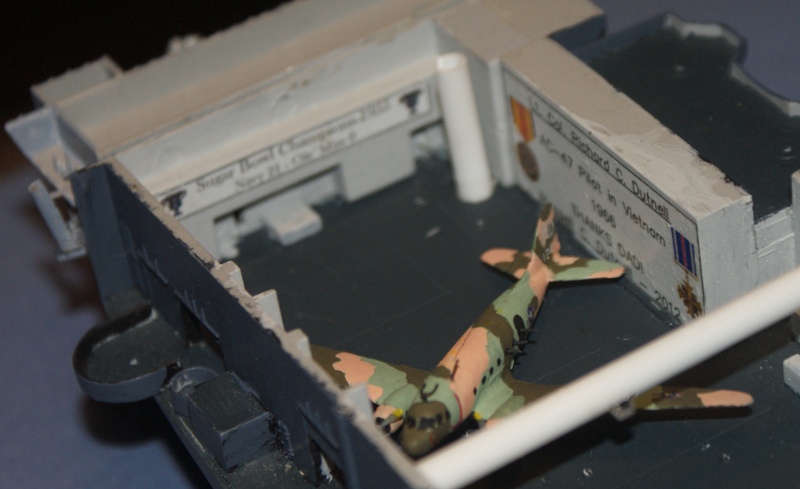

The hangar has been dull coated and awaits the flight deck. My intention was to put it on tonight, but I think I will wait and see if anyone has any suggestions before I do.
In the meantime, here are the parting shots of the hangar deck, before it goes forever into (at least partial) darkness.
In sgtryan13�s WIP of his spectacular George H.W. Bush he mentioned the sense of sadness he felt having to part with models that he builds for others. I had this same feeling when I gave the diorama and the AC-47 to my dad, so I knew exactly what he was talking about. Strangely, I am having somewhat the same feeling on closing the hangar. I�m going to miss looking at it sitting on my work bench and seeing it from all angles. I know it�s not going anywhere, but in a way, it is.

As to flight deck fit, if your wiring tubes are glued in place, then you have about 3 of those tubes fighting movement of the hull sides. In the first interior shot in the above post, it seems to me that there is a slight curvature of the starboard side, outboard, with the said three tubes tending to hold it there. I think you might want to put a straight edge against the offending area to check and then try to alleviate anything that is holding it.
Then, some heat in the offending area to soften/ease the plastic and a couple of C-clamps with the clamp ends at mid height of the hull side but resting against verticle wood battens that are verticle and distribute the force of the clamps up and down the hull sides. The upper ends of the wood battens should be at or a hair below the hull sides. May need a shipyard assistant to hold the battens while you apply the clamps. Remove heat source. Now set the flight deck and if the fit is right, hold it down to the hull sides firmly with rubber bands or C-clams. Now apply liquid cement to the joint lines, letting capillary action work its magic.
Just a thought :big_grin:

As to your hull fit issue, Russ makes a very good point and suggestion for a fix. Personally, I get very nervous when adding heat into the equation, especially at this late stage, so here is what I would do:
Given that the area is right in front of the island, and is obscured by the 5" mounts, and there is an overhang from the foreward mount anyways, I would just add a small styrene overhang to the deck edge in that area (maybe even mating it to the curved overhang) and paint it deck color and call it a day. It will be such a small part that only the most trained eye would possibly notice the artistic license you took. When ever I can, I try to take the "keep it simple" approach for things like this. I would greatly prefer a very small and slight inaccuracy rather than risk heating and potentially warping the hull, or cracking some bulkheads and ruining so much hard work. If you were much earlier in the build, then I would say totry and fix it right, as Russ described.

Of course, since I put the flight deck on, I had to make sure that all of the lights worked. They did!
And the �typhoon� deformed flight deck worked out well.
The stern light is not as bright with another coat of paint on it. I might add another.
I'm happy with the bomb crew in the light and dark, but if I was doing them over, I would paint their tops red. They were already assembled when I learned the clothing color codes. I�ll apply that on the flight deck.
I�m happy with the movie theater, even if it does have the largest projector in history.

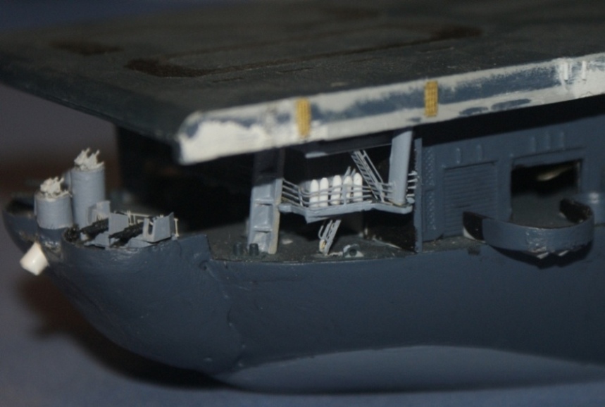

So, I didn�t do anything on the model last night, but this morning I fixed the gaps in the elevator shaft. The gap was somewhat larger than I thought it was (~0.04�), so I ended up using 0.05� styrene rod to fill it. It was quite easy, I just turned the ship over, laid the pieces in place and then brushed on the �Plastruct Bondene� I have (which I am liking more and more the more I use it).
I then painted it, including repainting the deck edge that I smudged paint on).
You can see them a little from these low angles, but just barely and from the angle that the model will be viewed, you can�t see them.
And they were effective at blocking the gaps.

Update 108
Thanks Gordon! I appreciate the kind words. :thumbs_up_1:
Here�s the next post.
I had one of those days Sgt Ryan wrote about. I spent most of the day in my workshop without a lot to show for it. However, the words of encouragement from you guys really paid off.
When I started this journey, as I�ve said before, I didn�t really think about details and how they would be so different between sister ships. When I started learning some of the differences, I found them fascinating (I still do), and pretty much became obsessed with correctly trying to incorporate as much detail as possible. I�ve been fretting about the Gallery Deck bulkheads for some time, and have spent hours poring through pictures, trying to find good pix of the details, and have been helped by some of you who have sent me links to excellent photos. Still, I didn�t know what to do and was afraid of messing it up. The encouraging words you guys posted helped me regain a better perspective.
With all of the detail I am including and activity I plan to put on the flight deck, the Gallery Deck bulkheads aren�t going to receive much attention, and most people probably won�t even see them. Still, I don�t think they should be featureless either. So, I decided to just make it up, and that�s what I did. I created a hodgepodge of various pieces of styrene and a couple of pieces of wire to approximate some of the features I saw in pictures and didn�t worry about realism.
Is it anywhere close to reality? No! But when painted it will at least break up the lines of an otherwise flat surface and it didn�t take me a lifetime to finish, just most of the day to do what�s shown in the pictures, so probably 3 or 4 days to do all of it. Is it worth it? I don�t know. I guess the end result will answer that question.
The white horizontal stripes along the bottom are the 0.03� x 0.03� shelves for the PE catwalks. You may have noticed that the doors (including the one on the gun platform) are cut below the deck surface. That is because I am incorporating this real recessed door feature in my model. Even though it will take a lot more time, I think in this case, the extra effort will definitely be worth it. I already know how I�m going to do it and thanks to Chris Toops, who was kind enough to send me extra catwalk that he had, I don�t think it will be that difficult to do.
It is really tempting to start putting on the catwalk, but it seems like it would be better to finish painting and weathering, before I start putting on PE pieces. Any thoughts on that?
