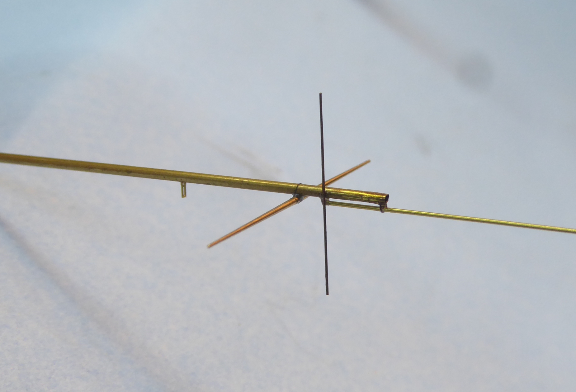

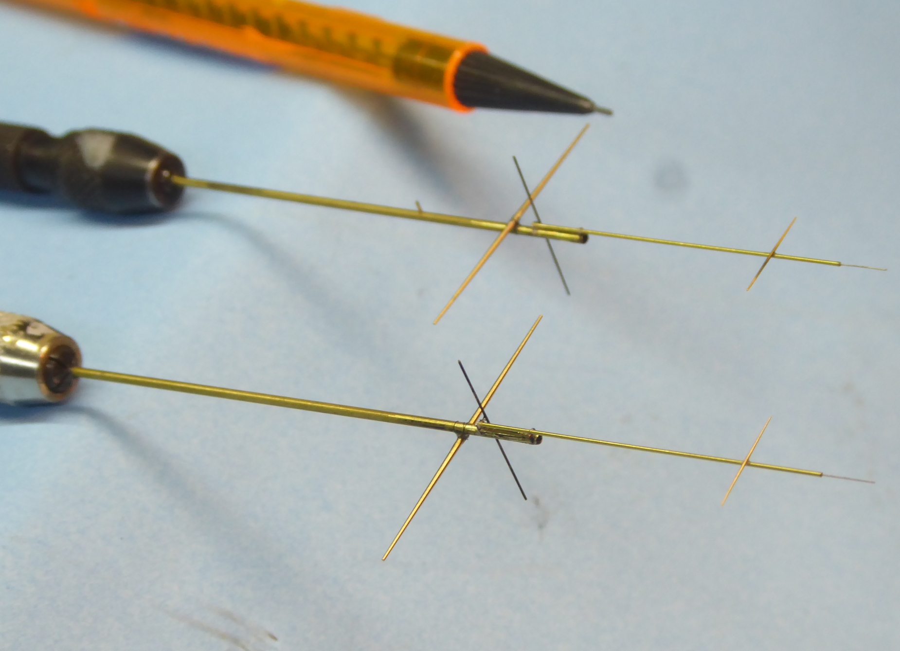

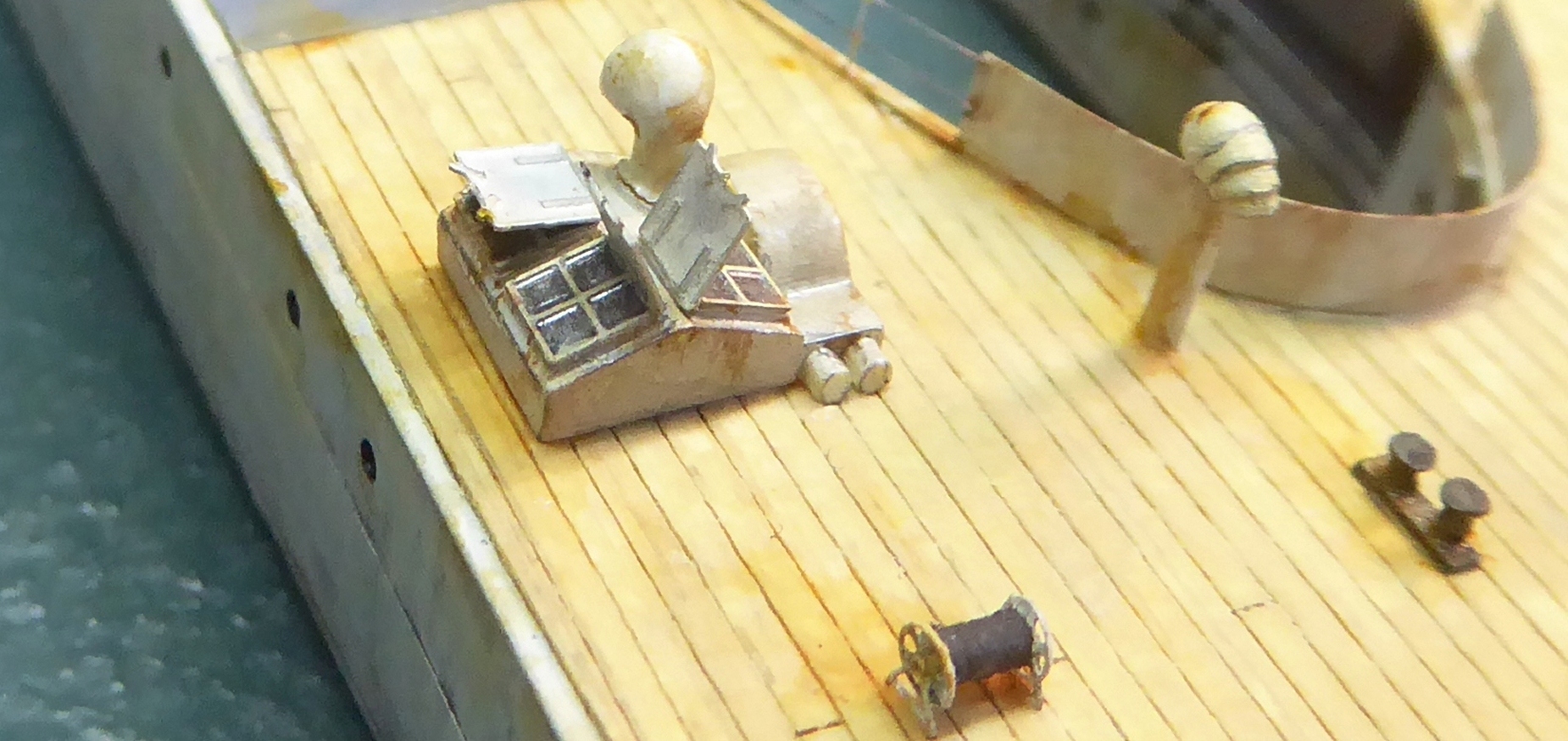

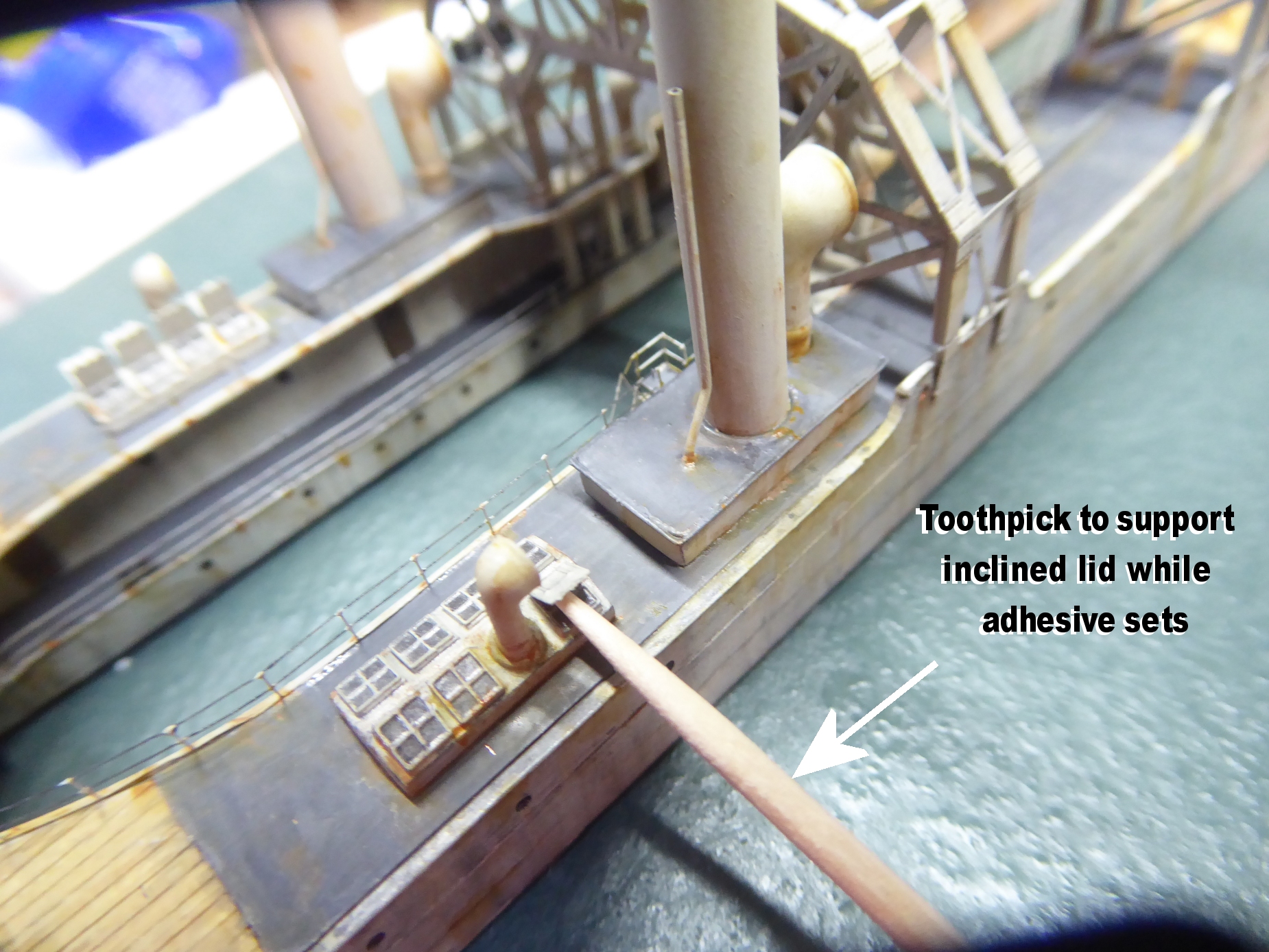

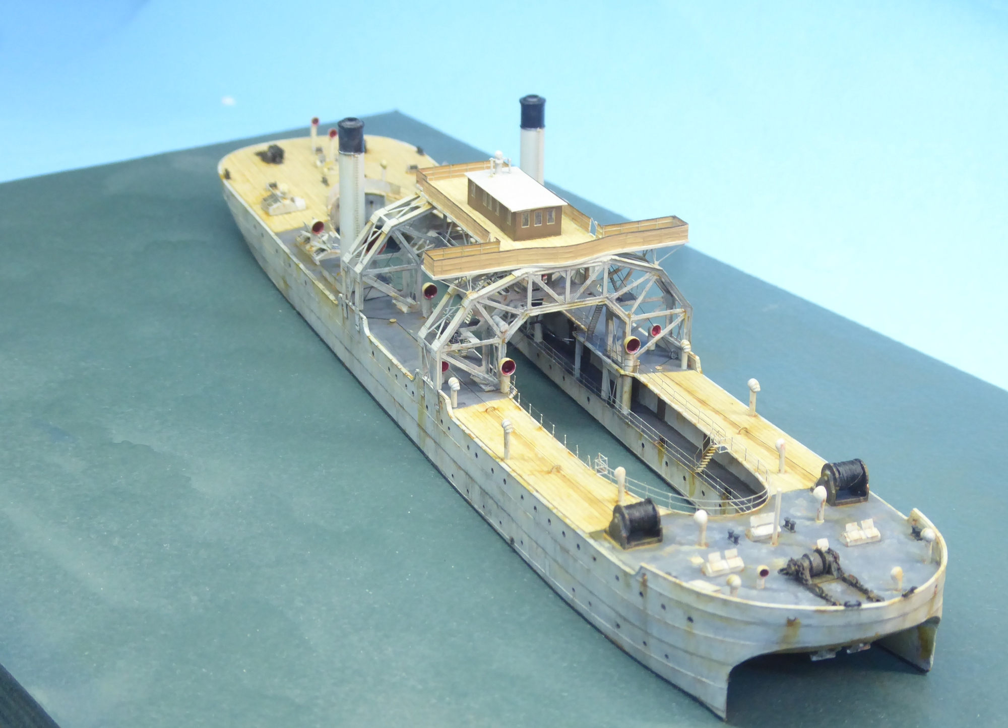

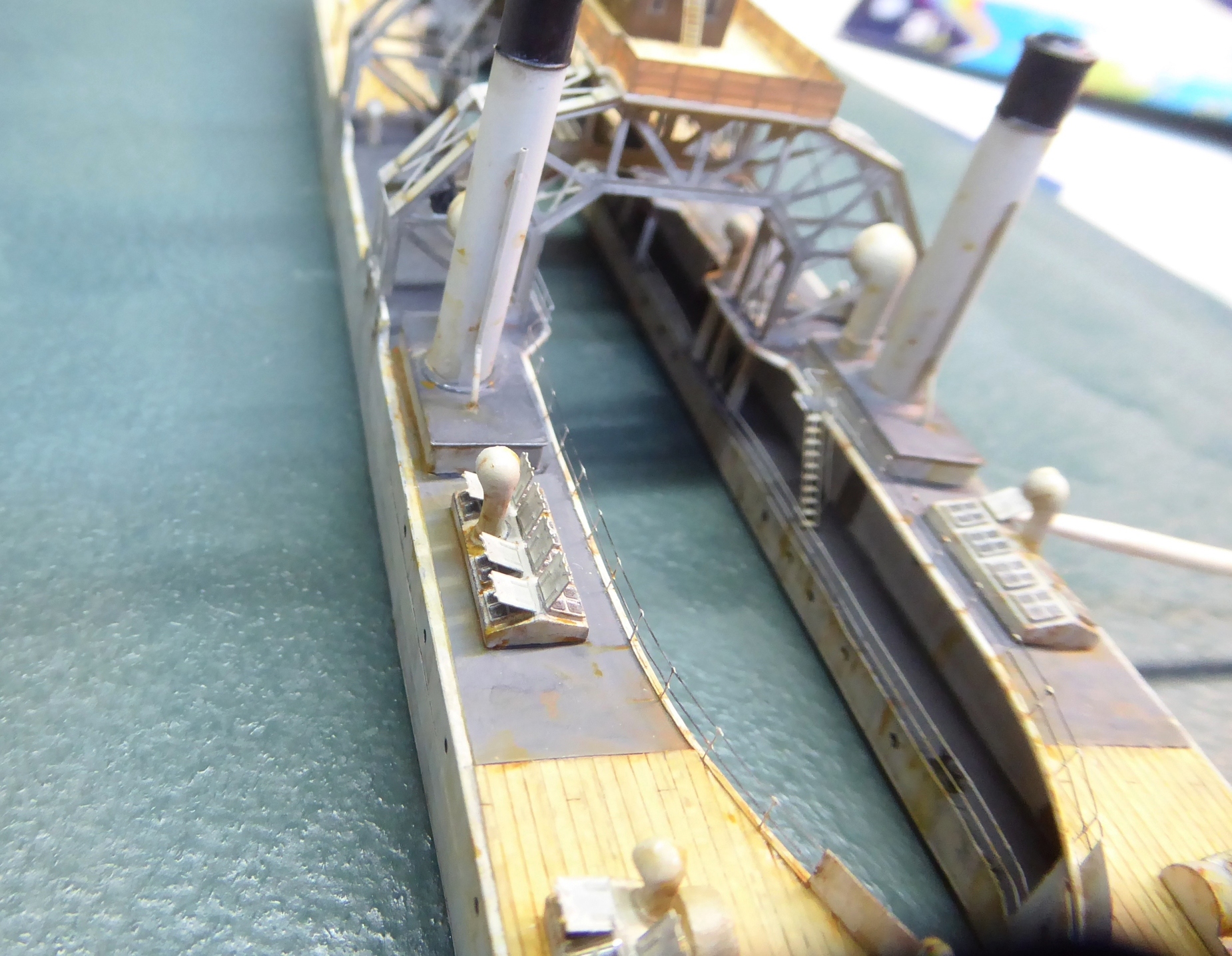

I restarted the project by first tidying up small bits of paint, adjusting pieces of PE that could be straighter etc...
I started by adding the lids ( from spare PE box) to the hatches -- mostly upright
but some at ' jaunty ' angles.
These were supported by the ' toothpick wedge ' whilst glue dried.
Fwd Fairleads were made of small strips of brass, the ends of which had the casting simulated with white glue droplets

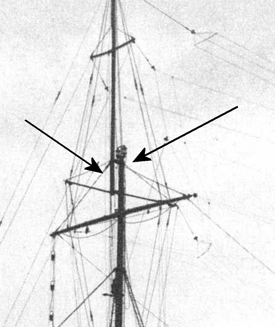

The masts are a little unusual, being un-tapered poles and in that they have no rake whatsoever -
- being dead upright to the waterline.
I had previously installed some brass tube sockets into the deck so that the masts, ( tubes-) to which I had installed some long stainless steel spigots, so that I could adjust the rake to exactly 90 degrees with the masts in situ
( contingency comment on my drilling accuracy !)
Unusual also in having a substantial 'air gap' between the lower and upper mast pieces. -
this was not as easy to solve as I had envisaged. ( Fiddly! )
I ended up making some very small - but robust -brackets using some old and overscale
1/700 stainless steel 3-bar railing cut down so as to make a small 'double ended fork'
Unusual lastly-- that unlike normal practice--where the upper mast off-set is usually facing fwd-
-the aft mast has the topmast offset aft of the pole mast.
anyhow herewith the assembled masts in the raw ready for first coats of paint
Onwards.... more soon

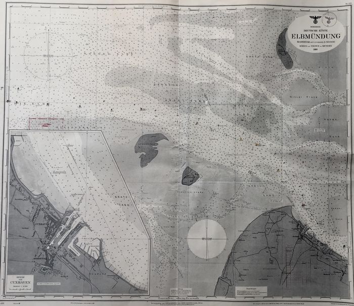

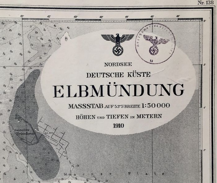

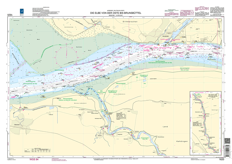

wefalck wrote:I don't think there were any mooring buoys in the Elbe River down there - because of the strong tidal current, but I may be wrong.
Well, today the estuary is marked with buoys anyway:

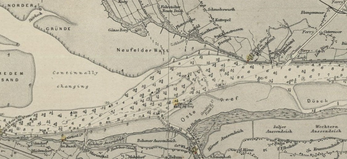

wefalck wrote:... Perhaps one can find some pre-WWI admiralty maps of the Elbe River on the Internet that show possible mooring/anchoring in larger scale. The mooring-buoys would have been painted black at that time.
There seems to have been a 1910 admiralty map, that was in use well into the thirties or even forties (note the Third Reich emblem in the title corner). It would be great to have a larger copy of that map that one could read the details...
And one more beautiful map from 1895 can be found here: https://www.christian-terstegge.de/hamb ... 00dpi.jpeg
And in particular this one gives you all the detail you need:
https://kulturerbe.niedersachsen.de/ful ... b_21980/1/
Roger Whittaker +9/13/2023

The modern chart shows that the main channel swayed further to the left bank, compared to 100 years earlier.
Navigation buoys normally are removed as soon as a state of war is declared. Not sure, whether they would have been put back in 1919 already.

Maarten Sch�nfeld
Posts: 1843
Re: Building SMS Vulkan (sub-rescue ship )and its tugs in 1/
Post by Maarten Sch�nfeld »
Included here a cutout of the map of 1896. Depth are in fathoms (=ft x 6) I believe.

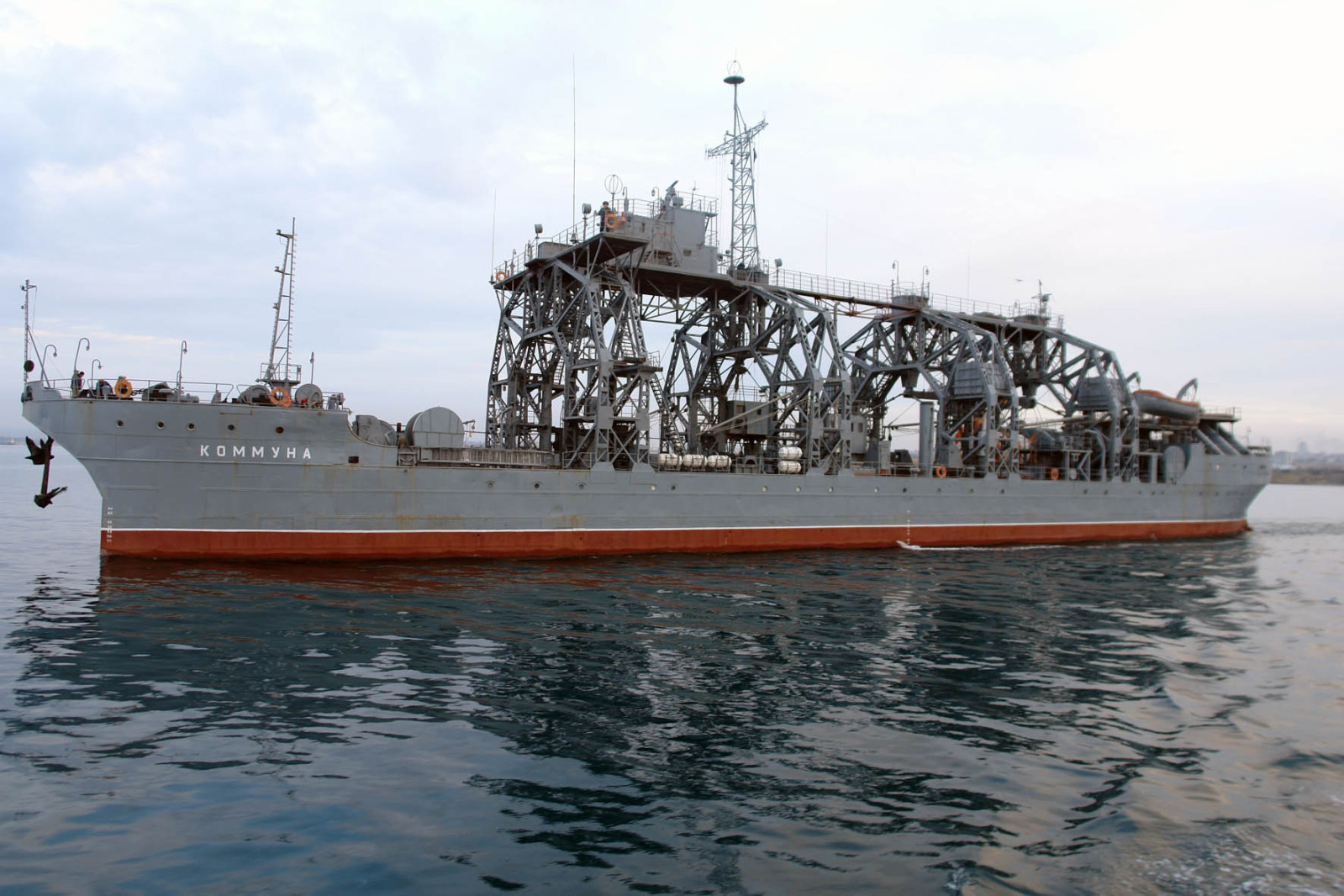

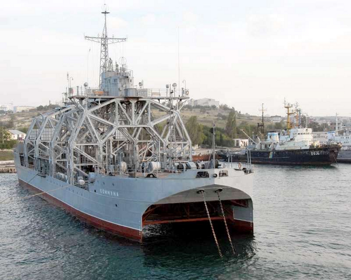

wefalck
Posts: 2125
Location: Paris
Post by wefalck »
The photographs on which the shore is visible do not show S.M.S. VULKAN, but perhaps a Russian oder Japanese one that was build under license by the Howaldtwerke in Kiel.
I quickly read up about VULKAN in
HILDEBRAND, H., R�HR, A., STEINMETZ, H.-O. (1999): Die Deutschen Kriegsschiffe � Biographien, Bd. 8 - Schiffsbiographien Undine bis Zieten.- 286 p., Hamburg (Koehlers Verlagsgesellschaft).
While the information there is not very detailed, it seems that VULKAN steamed through the KW-Kanal and then waited in Brunsb�ttel for several days. Apparently in those chaotic days after the end of the War, the crew behaved completely out of control and her captain asked for them to be replaced by more trustworthy men. It seems the crew went on drinking spree and rampage on land for several days and let the fires in the boilers die down before they left, so that ship was completely disabled. It may well be that she was moored then in the entrance bassin of the Kanal.
Eberhard

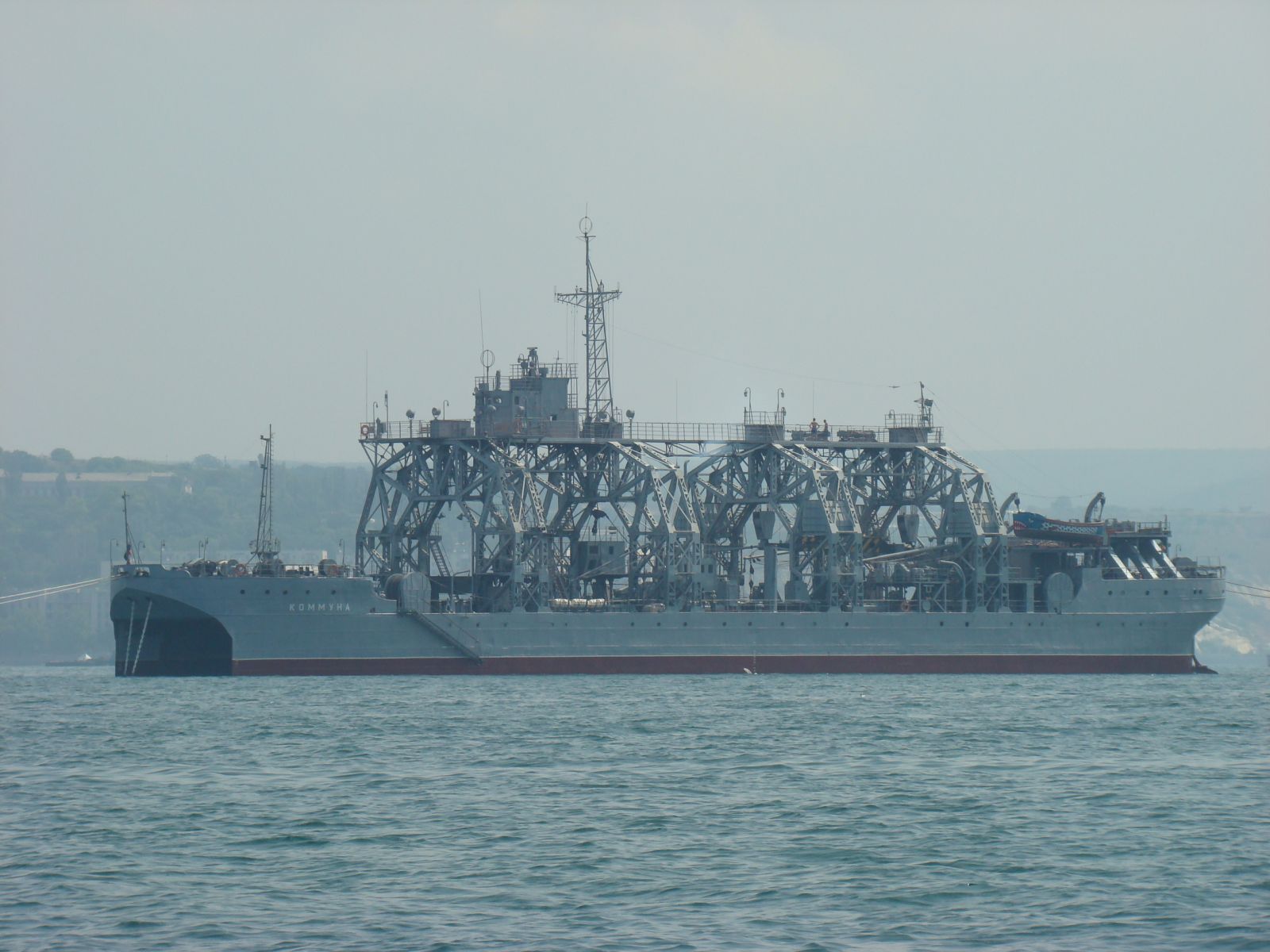

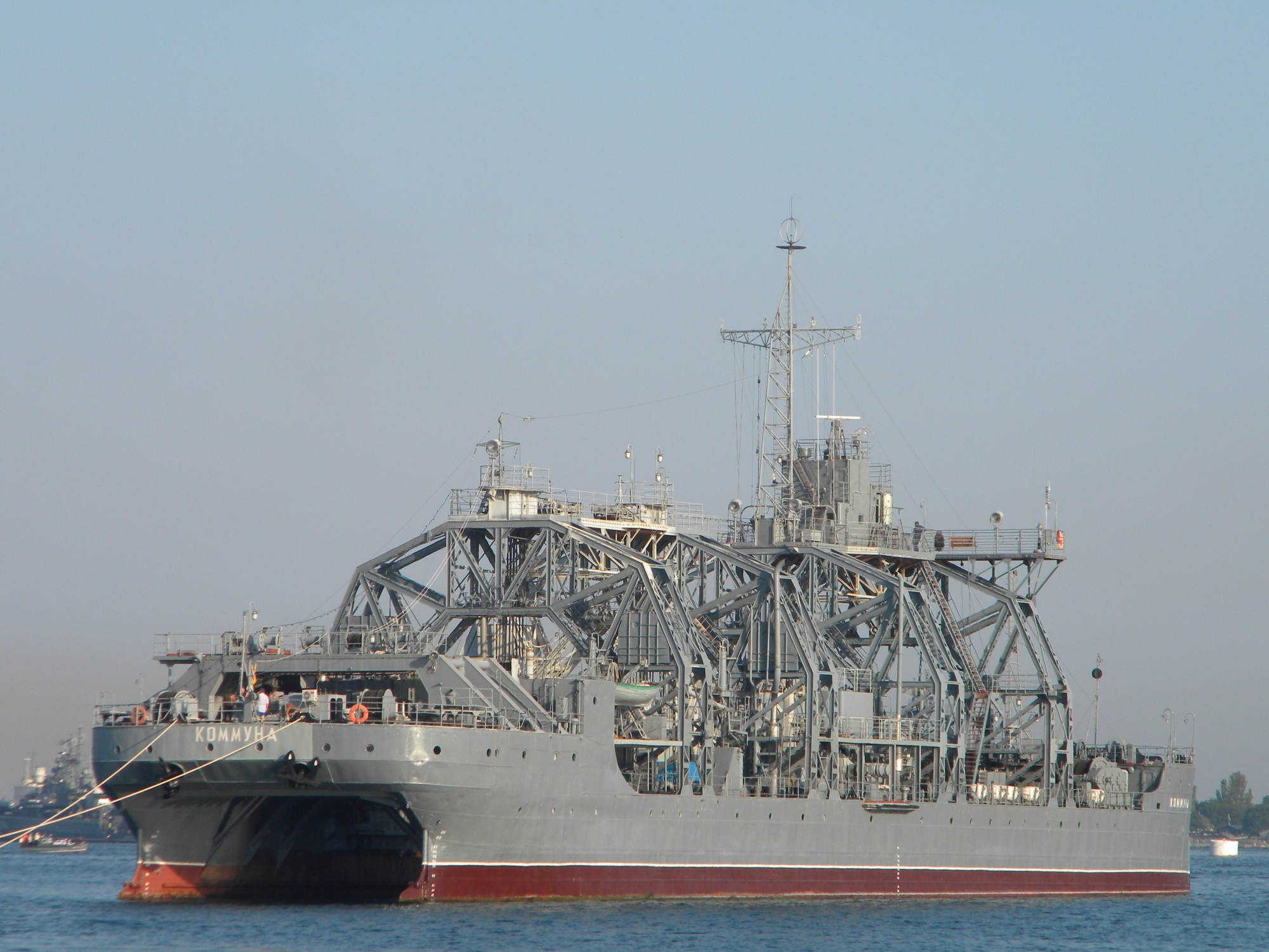

Post by wefalck »
It seems that one of the Russian one built under license was kept in service until a few years ago, but I don't have any detailed information.
Eberhard

So we blame the crew !
then-- allegedly the ship founders in wind Bf Force 5 ( not thaaat much wind) big ship like that should not (suddenly) start sinking
unless...==> - with the boilers shut down there would be no power of any kind for (high speed) pumps...
so maybe she made some water and then more water
making her unable to rise to the waves and thereby thewater issues becoming exacerbated ...?
unless.... it was a deliberate act -- ala the scuttling @ Scapa Flow..? as she sank really quite some way from any route to Harwich...?( !!)
get more interesting by the second--!
Thank you Wefalck and Maarten for your time and thoughts hitherto !

@ Wefalck
The Russian Navy - (much enlarged !) version of Vulcan is called Kommuna ( ex Volkov)
and is quite a beast! launched in 1913 (!)
more infos and images here
https://www.globalsecurity.org/military ... olkhov.htm

My (secondary) sources do not say anything about the original intentions. However, the commander of the cruiser REGENSBURG, who accompanied the towed convoy of VULKAN and CYCLOP considered VULKAN unsuitable for crossing the open North Sea. He was afraid that the movement of the connecting arches in the long squall would tear holes into the two hulls. When the tow began to encounter Force 6 winds VULKAN's crew was transferred to ? and they noted later a light listing of her before she eventually sank. The commander of REGENSBURG recommended a more sheltered route along the Dutch coast, but that was not followed.
Eberhard
Image Image Image Image
Maarten Sch�nfeld
Posts: 1843
wefalck wrote:My (secondary) sources do not say anything about the original intentions. However, the commander of the cruiser REGENSBURG, who accompanied the towed convoy of VULKAN and CYCLOP considered VULKAN unsuitable for crossing the open North Sea. He was afraid that the movement of the connecting arches in the long squall would tear holes into the two hulls. When the tow began to encounter Force 6 winds VULKAN's crew was transferred to ? and they noted later a light listing of her before she eventually sank. The commander of REGENSBURG recommended a more sheltered route along the Dutch coast, but that was not followed.
VERY interesting information, Wefalck! We can deduct valuable data from it for Jim.
So a few remarks:
1: I checked the Dutch historical weather reports for 5 and 6 April 1919, these can be found here: https://www.knmi.nl/nederland-nu/klimat ... aggegevens
Only from two stations there are relevant data: Eelde (near Groningen) and De Kooy (near Den Helder). Only Eelde measured a highest wind velocity of 9.3 m/s on April 5th, equalling 5 Bft (fresh breeze). However, the average wind for those days for both station was only 4 Bft (moderate breeze). As the windforce at open sea is 1-2 Bft stronger than on land, we have to add 1Bft to the measured values. Anyway, hardly weather conditions that would keep any sailor at home. (It would be nice if we had weather reports from Helgoland too...)
The commander of SMS REGENSBURG apparently regarded the condition of SMS Vulkan not good, given his concern even in the favourable weather conditions. So the conclusion must be that the state of maintenance was very poor. So back to the weathering of your beautiful model, Jim!
2: SMS REGENSBURG: I have worked my way already through four German WW1 cruiser classes, converting these from the venerable 1:350 Revell Emden/Dresden kit. My last one was the Kolberg class, with a suitable hull extension. It's not difficult at all. So if suitable drawings can be found, I think the Graudenz class (of the Regensburg) is well within reach. If you want I could do the basic conversion for you, leaving the superb detailing of course in your hands. (note: I have a good plan set of the Brummer/Bremse, with all the other data I have it should be possible...)
3: and I see you have built a model of GRAUDENZ already! Albeit in her Italian mod form... But in 1:700 that is.
