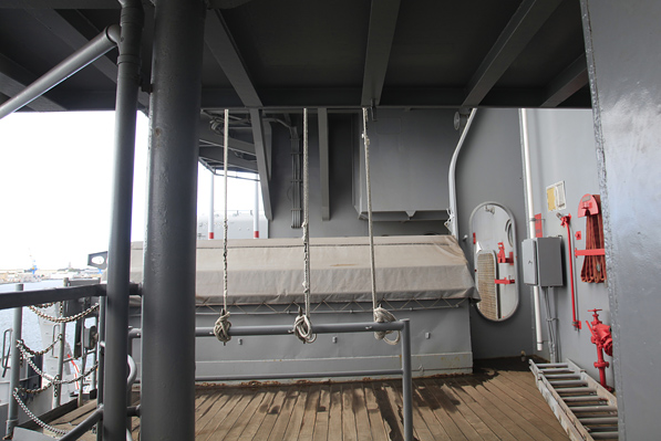

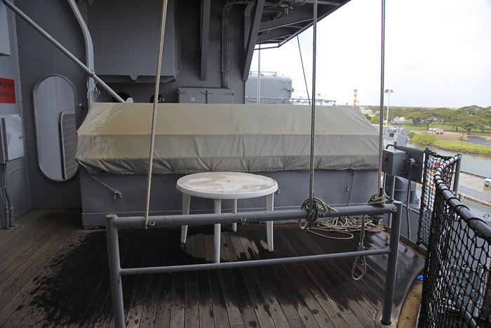

A couple of photos of the port and stbd flag bags of BB63. Unfortunately the lashed canvas cover obscures the rail.

Tom,
Thanks - at least the rail is there and that's what I suspected. Much appreciated.

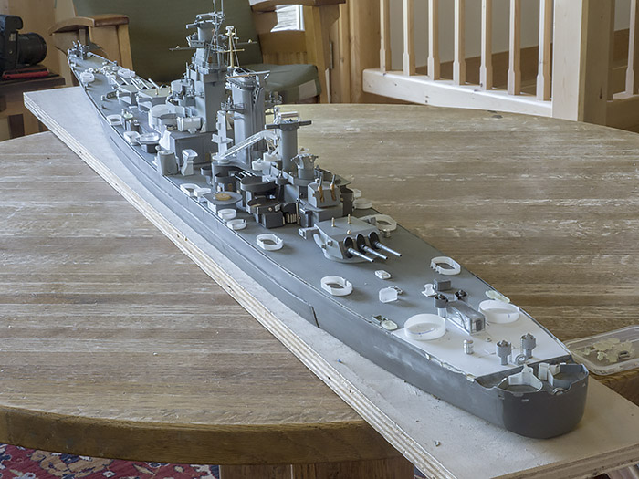

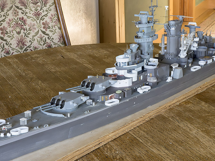

Added a bunch of main deck level 20 mm gun tubs and some other "stuff" which seems to never end. With all the white added stuff it looks a bit like it has measles.

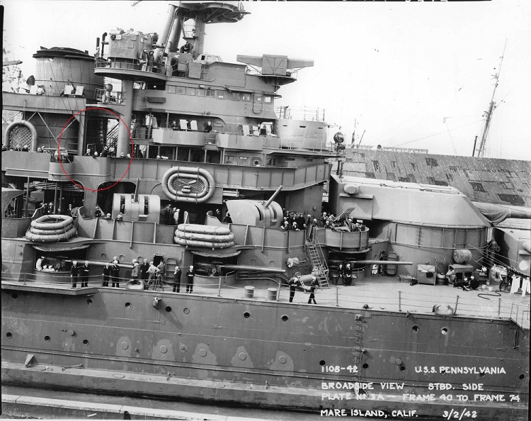

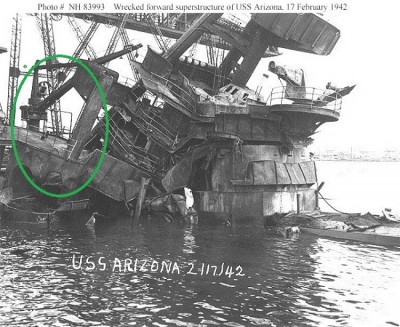

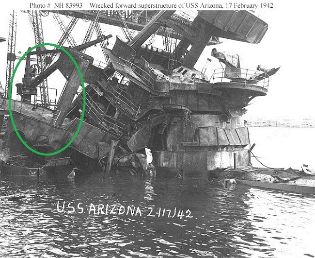

I wonder if this is the rail on the Arizona?
013919b - Copy.jpg (62.1 KiB) Viewed 1193 times

The flag bag is gone from the explosion. It should be right behind this frame. Source: NavSource
Although not identical, here's the Pennsylvania in early '42 before her major refit. It shows the bar tie-down.

Fliger, your model is looking quite beautiful! Again as I've said, really clean,crisp work. If it looks that good unpainted, it's a good sign!

Flieger: You are certainly making some progress on your model. It is looking like a proper ship, white stuff notwithstanding.
Randy: I bet that is the rail. Jeff incorporated that into his build.

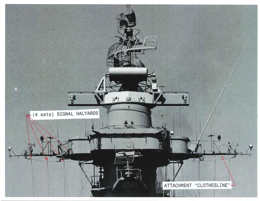

I was wrong - the IOWA class signal halyards are attached to the yardarm with a "clothesline" rig. They were not directly attached to the yardarm.
This is a photo of NEW JERSEY during the early 1950s - her halyards (and yard) did not change in her 1967-69 commission.
The signal halyards (4 sets/side) were attached to this clothesline by my guess at specific spaced attachment points for an even distribution for displaying signals. The halyard was run up/down as req'd thru a pulley at the clothesline.
The Trumpeter 1:200 model includes this clotheline in the kit supplied plastic mast and also is included on the Pontos PE set. What exactly this clotheline is for I'm not clear about - perhaps one of our members who was a former skivvywaver can enlighten us all!! NEW JERSEY had a 2nd yardarm added in 1967 which provided the forward connection point for her fan array radio antenna and other navigational aids similar to the ones on the signal yardarm.
I'm guessing again that most WWII era ships followed this same pattern or setup with their signal halyards. I will take some time this weekend to check out other warships and see what their arrangements may have been.
Hope this helps,

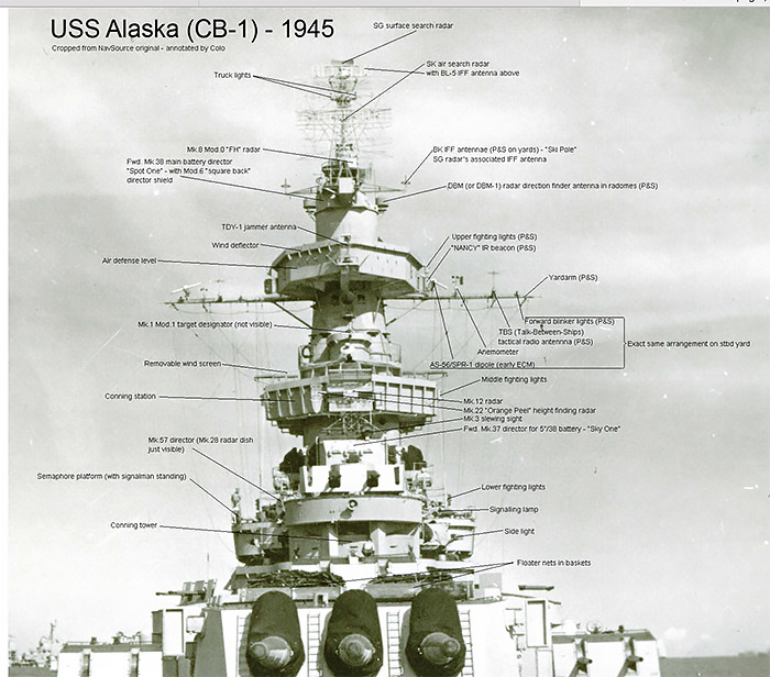

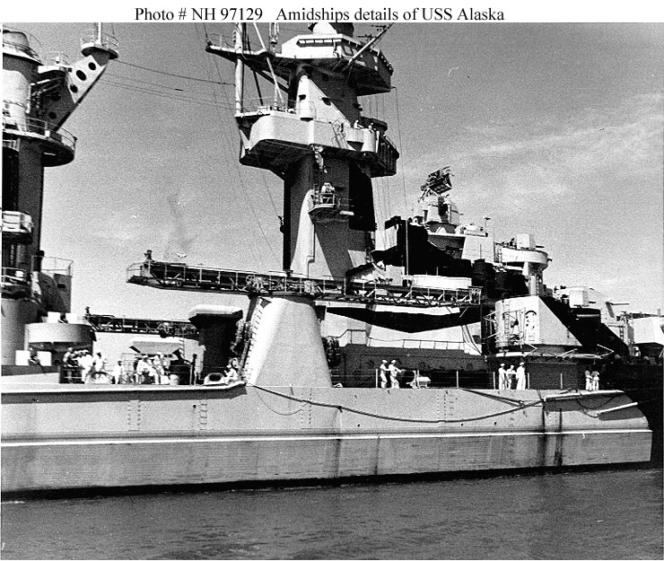

Looking at a photo of Alaska, she has them attached to the yard arm, with a foot rope below. Interesting as to how variations in rigging and equipment keep coming to light!
BB62vet

Tom,
Not disputing you, but two photos of ALASKA seem to me anyhow, to indicate a similar "clotheline" system for the halyard setup:
It's hard to see, but even with my "impaired" vision, I do see this setup in both photos. However, it could, as you said, it could very well be a footrope.
Posts: 5068
Re: 1/200 Scale Group Build 2015
Post by Fliger747 »
Hank:
I have a somewhat higher resolution photo of that area, provided by Colleseum, detailing many of the yard, radar and mast features, one can make out the halyard sheaves attached directly to the yard bottom, with the lines clearly passing behind the foot rope. As far as I can tell SODAK et al. were similarly configured whereas the Iowa's seem to be in the "close line" configuration from commissioning. Somewhere I have one of those great antenna photos of North Carolina but haven't found it as yet. I wonder what the genesis of that configuration was and what advantages their were.
Not sure these small res photos will show this well.

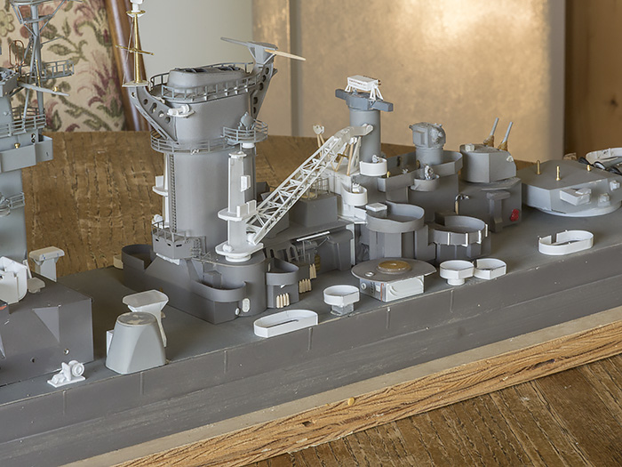

I find the number of main deck ventilators on this ship astounding. Especially as they are all of differing configurations and shapes! Slowly reducing the amount of visible main deck! Made masters and poured the mold medium for life raft stacks, more raft molds and bits and chocks. My experience with this stuff is that it takes seemingly forever (many days) to fully cure. I do have one of those micro scales that makes it much more precise to get the proper 1:10 mixture ratio.
Perhaps with a Ship named Alaska it should be cool and breezy below decks.
