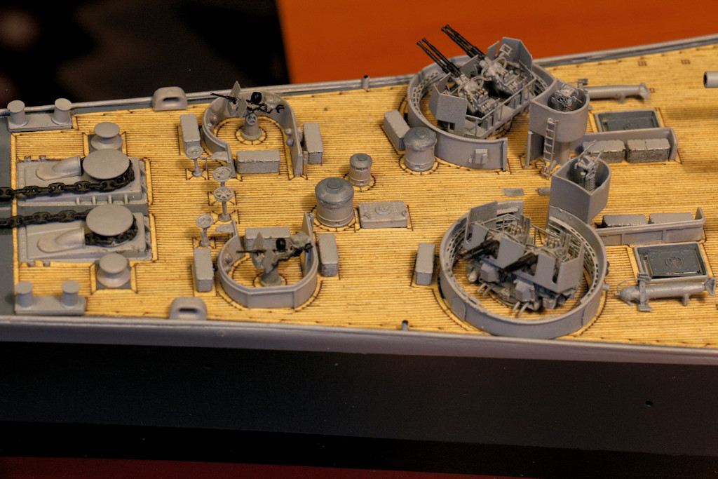

Next comes the waterways, or �scuppers�. These are strips of Pontos brass photo-etch (PE) that have been primed and sprayed Intermediate Blue.
The plastic part has an embossed deck pattern but the Pontos detail kit includes an actual wooden deck. It�s extremely thin and very fragile, which for my clumsy fingers is not a good combination.
The wood deck is adhesive backed, but many model ship builders here have complained that it does not stick down properly over time. To prevent this, we instead glue the decking down using artists matt gel medium. An 8 ounce bottle like this costs around $14.
We kill the adhesive on the back of the decking with Krylon clear spray and then slather on the matt gel, making sure every bit of the surface on both parts is covered.

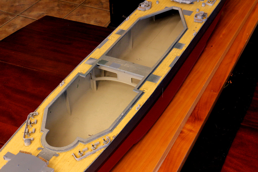

The gel doesn�t dry right away so we can position the deck where we want it. Then we make sure there are no bubbles or air pockets underneath, and using a brush and water, we clean all the excess off and set it aside to dry overnight.
Now we�re ready to start adding detail to the sides of the deck. I�m using a set of plans for the ship from The Floating Drydock that shows the deck in accurate detail as to what should be placed where. Yep, these plans cost extra too, but they are a little over 9 feet long and worth every penny! Unfortunately though, a lot of the detail shown on these plans are not included in either the ship kit or the two detail kits and must be hand made. Here's an example of what these plans show:
Space is limited on a battleship and consequently, every foot of unused space in utilized as storage for equipment of some type or another. Which means, there�s a ton of crap hanging off the sides of the decks.
Here I've placed a dime next to this part so you can get a relative idea if the size of small parts I'm dealing with. Now, mind you, this ship model is 53 inches long. That's 4-1/2 feet! A magnifying glass is a must!
Once both sides of the deck are detailed (we�ll show more of that later), we turn our attention elsewhere. As you may imagine, a model of this size and this delicate must be screwed down to a base. Up until now, the ship has been mounted on a temporary base that is not nearly as long as the ship. Now, though, we must mount it to a permanent base before we go any further. Once we glue the first superstructure deck to the ship, the opening you see here will be partially covered up and we won�t be able to get to the holes to screw the ship down. So, it�s time to build a base.

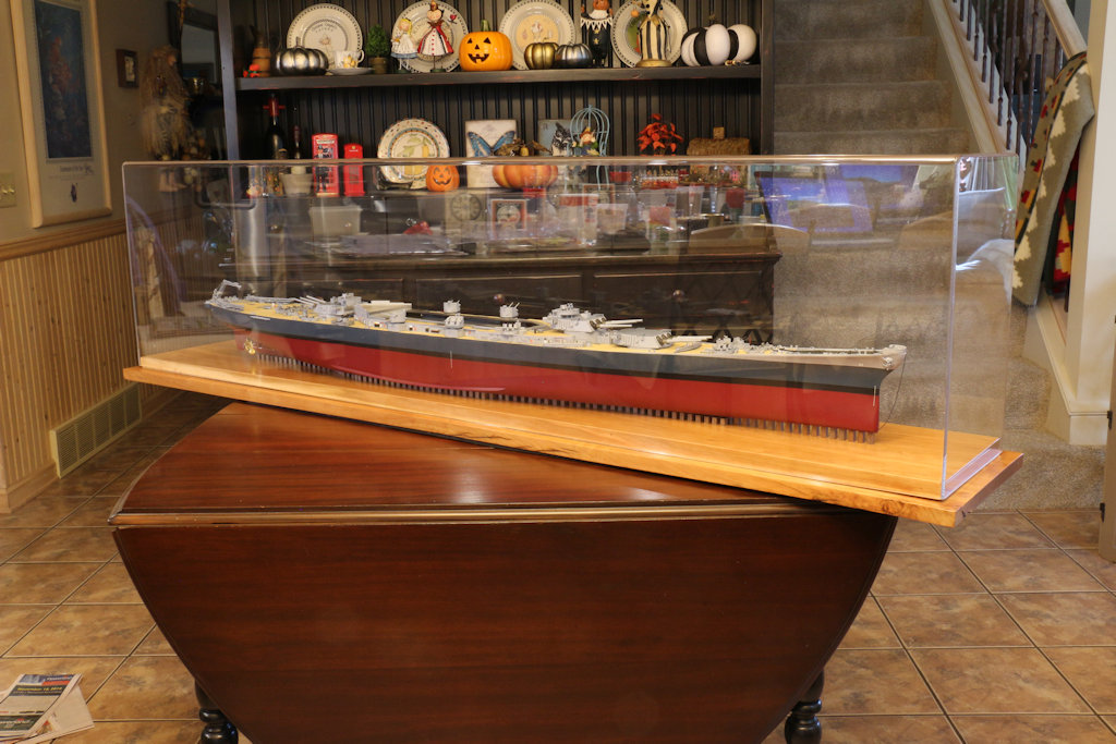

At the same time I was cutting out the keel blocks, I found a local acrylic fabricating company that could make me a clear acrylic case for this ship. If any of you are from southwest Michigan, I highly recommend a company called PlexiCase, located here in Grand Rapids. They were competitive, dependable, and did an excellent job. This case only cost $235. (Yeah, I know! More $$$$$$)
Re: Trumpeter 1/200 USS Missouri Build Log (Sept 2015 - ????
Posted: Mon Mar 16, 2020 2:23 pm
by steinerman
Part 3:
Plexicase borrowed the base and made the case to fit exactly over the lip of the bottom board. They did it in only a couple weeks, too. I promised them that when I finished the model, they could put it on display in their showroom for a month or so. They were delighted to hear that. Sure hope I finish it before they go out of business!
The case is 60� long, 10� wide, and 15� high. It is make of 3/8� acrylic and the seams are rounded and flame treated for smoothness. The ship is 53� long, which gives 3-1/2� clearance at both bow and stern. I�m having a nameplate engraved for the case, but it�s not finished yet. And yes, the case IS high enough. I may be dumb, but I ain't stupid!

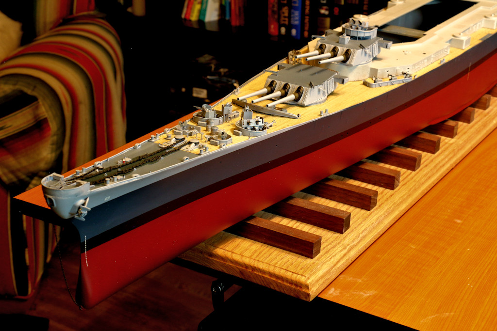

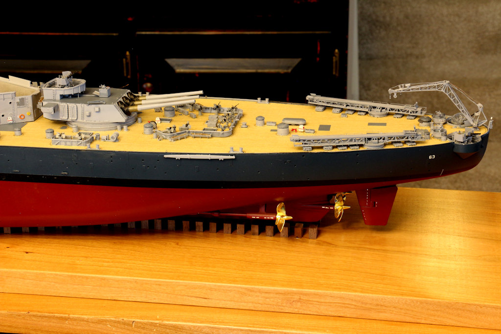

This and the next three pictures show the ship resting on the keel blocks. Looks kinda neat, don't you think?
I think this looks a lot nicer than if the ship was mounted on a couple pedestals.
Another shot of the ship resting on keel blocks. This is a lot more work than using pedestals, but I think it looks a whole lot better.
The stern of the ship mounted on the base. I don't know if I told you or not, but the silver colored strips on the prop shafts are zinc anti-corrosion plates. There are some on the rudders also. This is actually automotive striping tape!
This is an overall side view shot of the ship mounted on it�s base. A 36� yardstick is placed in front of the model to show the relative size of both the ship and the base. This is one BIG ship!! And please don't ask me where I'm going to put it!

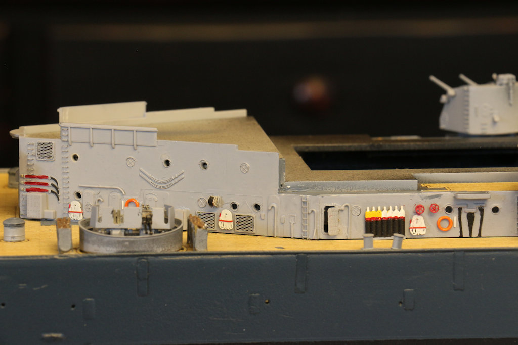

The next several pictures show close-ups of the detail on the sides of the first superstructure deck. The angled tubes you see on the outside of the 20mm splinter shield are spare gun barrels for the 20mm guns. Also, note the 9 gun crew helmets located on the outside of the 40mm gun tub. These items were all made out of bits and pieces of plastic. They are not part of any kit.
Here we are starting at the front of the starboard side of deck #1. We see a hose reel, fire hose, and life preserver. Note that all the vent pipes are hand made from thin brass rod, with a tiny dab of CA glue at the tip.
This view shows the detail of one of the 40mm quad Bofors gun mounts as well as the ladders and miscellaneous equipment hanging from the deck sides. I see from this photo that the open hatch is slightly drooped, which has since been corrected. This deck has not been glued down yet, resulting in the visible gap where it joins the hull deck. Note that many of the vent pipes are "kicked out" at the bottom about 4-5 inches. This bit of information came from the TFD plans.

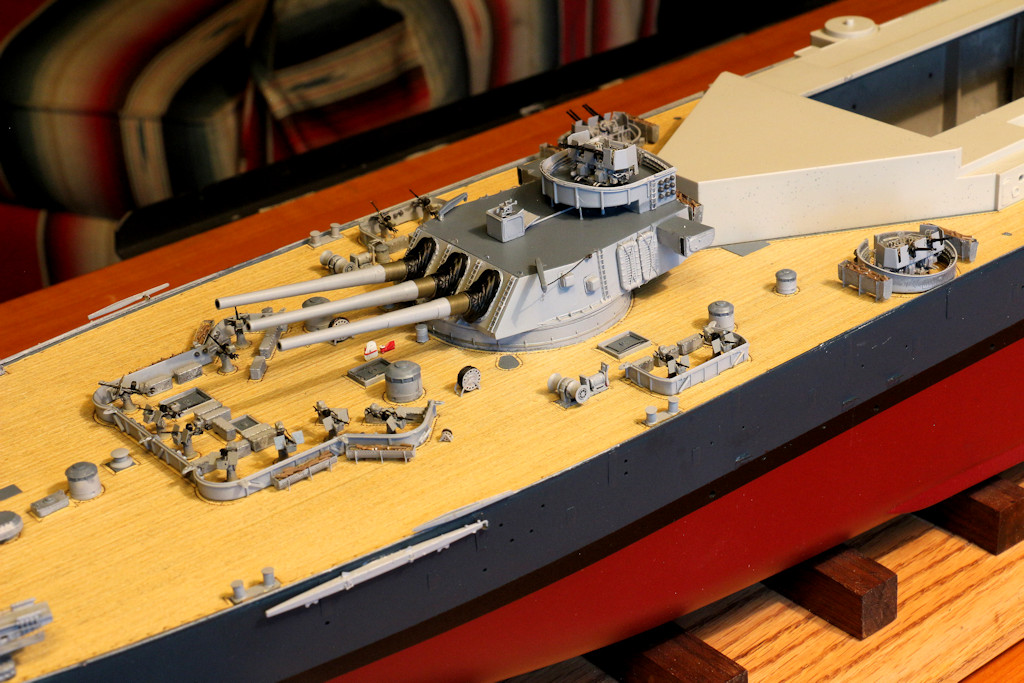

Progressing further aft on the starboard side, we see the life rings, the fire hoses, and the compressed air cylinders. There are red fire water nozzles that are glued to the main deck near every fire hose. These have not been added yet. I�ll do that after deck #1 is glued down. The short squat compressed air cylinders are acetylene, the ones with the green top are oxygen, and the ones with the white top at the far left are hydrogen. This is the way the tanks were painted in 1945.
This is a little further aft on the starboard side. Note the hoist on the side of the 5� gun platform. The two red valves above the fire hose are identified on the blueprints as steam cutoff valves. Also, the compressed air tanks with the yellow top are dichlorodifluromethane, which is used as a refrigerant. The location of the compressed gas bottles I've shown here and not actually as positioned in 1945. I'm trying to show a representation of the types of gas bottles that might appear on the ship.
This is a closer view and shows the detail of the front of a 5� gun mount. There are 10 of these on the ship, 5 on each side. Also, if you look very closely at the white fire hose, the nozzles are painted red. A good magnifying glass is a definite necessity when building this ship!
This is the aft starboard portion of Deck #1 � and actually part of deck #2 as well. I painted the ventilator intakes black behind the gray grids to make them look more realistic. The grids are actually separate brass pieces. Note that there is another open hatchway here.

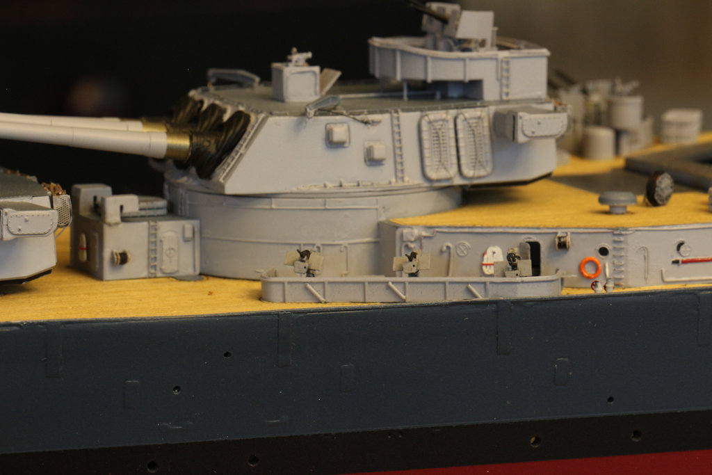

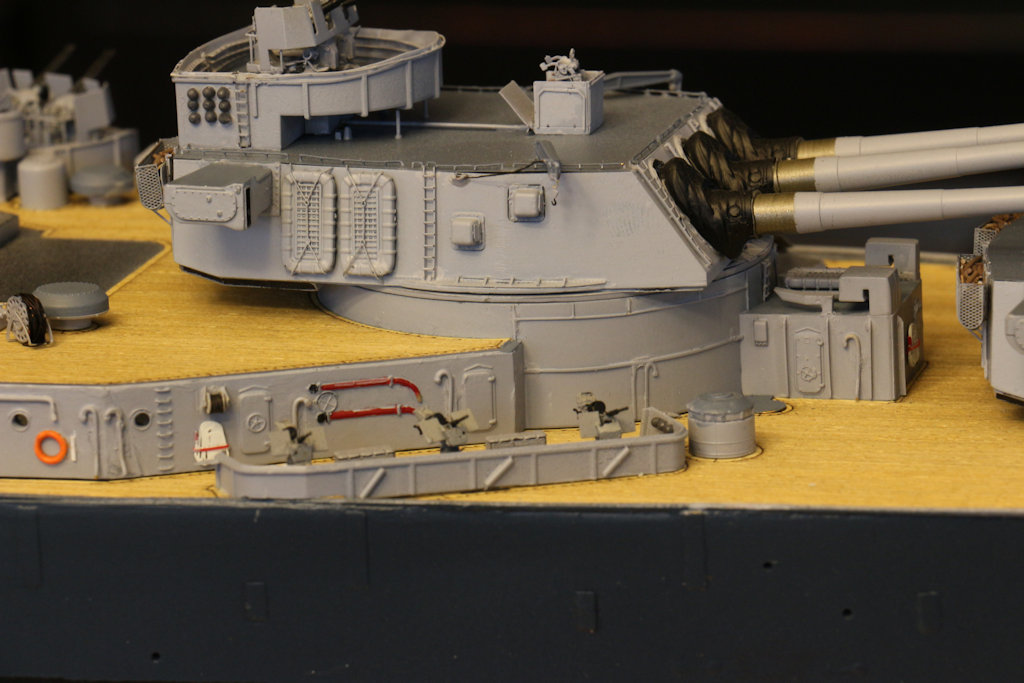

Now we start down the port side of deck #1, looking at the locker room and also turret #2. Again, the side of this deck is cluttered with all sorts of equipment and hardware.
Progressing a little further back, we see 5� gun turrets, a fire hose, a life ring, vent pipes, and more gas cylinders. The ones with the red tops contain propane and/or other fuel gasses. The solid black ones contain just compressed air.
I took this next shot to show the detail on the back of the 5� gun turrets. Note the hatches to gain access to the insides of the turret and also the two shell ejection chutes. These little snots were a bugger to make. Took me a couple weeks to make all 10 of these assemblies. Building a model like this as actually building dozens of small models and then putting them all together. Well, more or less!

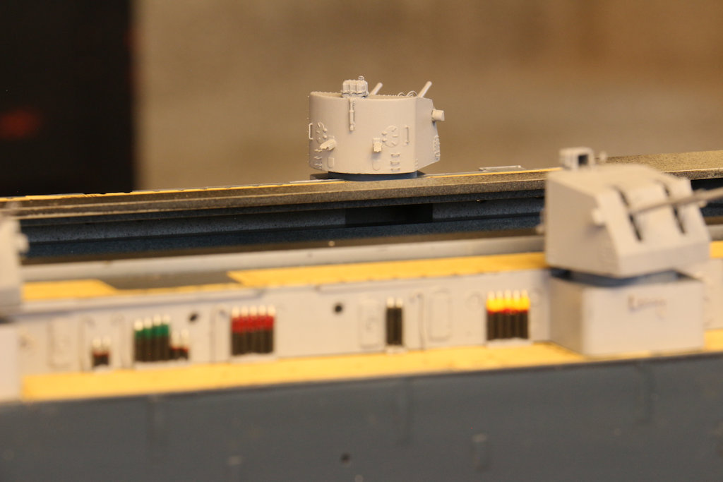

Here we�re looking at the aft end of deck #1 in the port side. Still more hardware mounted on the side. The brown topped cylinders are ethyl chloride and the red valve is another steam cutoff valve. I have no idea what the yellow valve is, the plans don�t tell me. The ventilator grill on this side was painted black behind the grill also. Yeah, the 40mm gun mount looks crooked, I agree. I�ll have to straighten it. Close-up photography is great at pinpointing problem areas!
I took this to show that there is stuff mounted on the sides of the 5� gun platforms. Here we have a hose reel, a fire hose, a loudspeaker and a rack with mops. No, these weren�t included in the kit! I had to make them by unraveling string and gluing strands to a plastic rod. Then I had to drill tiny holes in the rack. I have to make two more of them for deck 2, too - UGH!

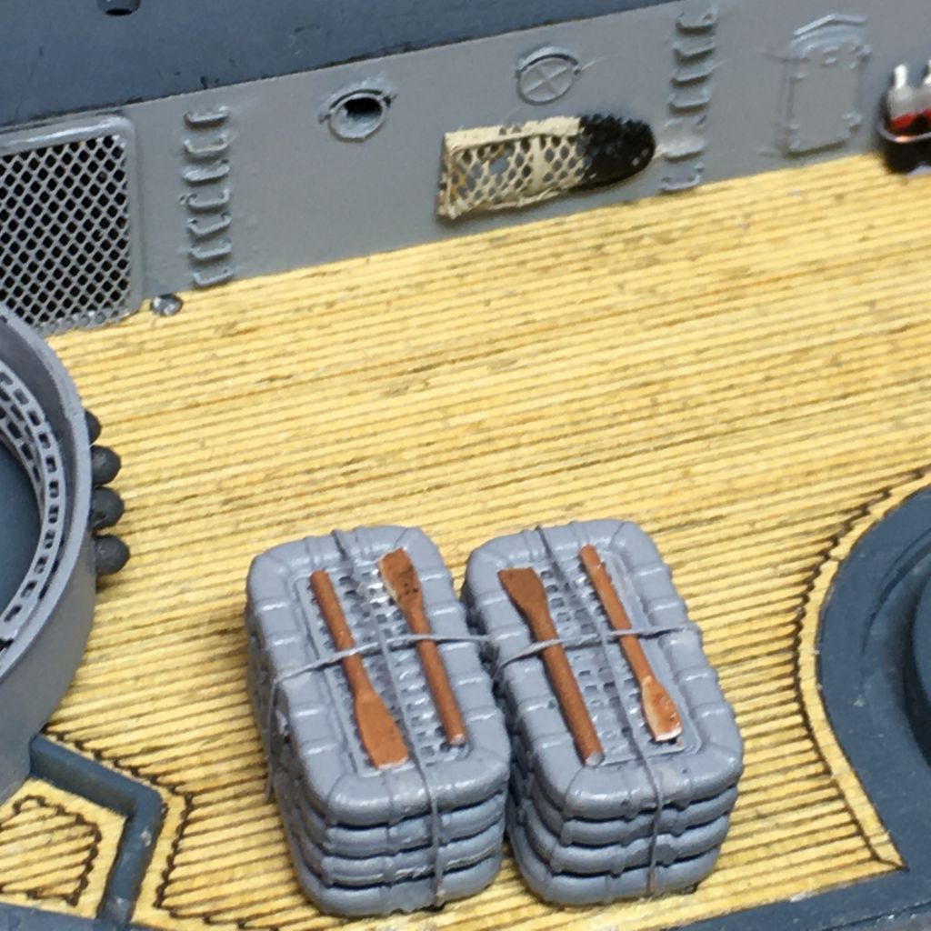

As you can see in the following picture, I added some detail to the life rafts. I took Evergreen plastic rod, cut it to length, and squeezed one end flat to simulate oars. I then also tied the stack of rafts down with fine wire to make things look more realistic.

Here's a close up of the oars and the tie downs I added to the life rafts. Gives a little added realism to the ship.

The kit doesn't mention it, but my plans show a rack mounted here containing refueling hoses. So, thanks to Evergreen shapes, we now have said rack, complete with hoses.
Working our way forward on the port side of the ship.
The ladder on that last photo looks really beat up. Yes, I have replaced it since this photo was taken.

THIS SHIP IS FINALLY DONE!!
That's right, friends, this beast is finally finished! After umpteen years, even more $$$, and lots of cussing (+ many bottles of vino!) I can call it finished. The last thing I had to do was paint 368 little people, approx 1/3" tall (360 sailors and officers + 8 Japanese). You wanna know what a pain in the butt that was! Especially the neckerchiefs the sailors wore! By the time I did all that, and positioned them in somewhat resembling a realistic manner, I was more than ready for this thing to be done. So, gang, let's take a look at the final project, shall we?
Here is the entire ship. You can't see a lot of detail in this shot. Be patient, we'll get there.
In case you've forgotten, I elected to mount the ship on simulated keel blocks similar to how they were when the ship was in drydock. I thought it looked nicer than mounting it on a couple brass pedestals.
This next photo shows a yardstick alongside the ship. The model is 53" long overall. It's a big sucker! And yes, if you look close, you can see some of the crew.
Here's a bow-on shot. You might be interested to know there are 4395 individual pieces of brass PE making up this ship. This is from the two Pontos detail kits, various Eduard sets, and the PE that came with the ship. As I finished a subassembly, I listed the parts on an Excel spreadsheet. (Yeah, call me anal!). In case you're interested, the modal contains 6754 discrete parts: 1325 plastic pieces; 730 resin parts, and 305 other misc parts, aside from the PE.
You have seen similar shots, but in case you forgot, here are a few pictures of the starboard side. I'm not showing port side photos as the ship is mostly the same on both sides. You can start to see the little sailors walking around.
I don't think you've seen the boarding ladders. There's one on either side.
Kinda hard to see all the people, but we'll get closer in a little while
