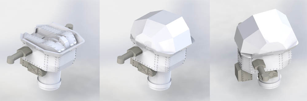

Post by Pontosmodel »
EJFoeth wrote:Depending on the productions schedule and flexibility left ( :wave_1: )
1) We have not commented on the boats & launches of HMS Hood, an area where the AOTS falls short for the 1941 version
2) The HACS director by Trumpeter is really poor. Good drawings of this director are readily available. This is one item that can be easily provided by the 3D printing community, though. The same probably holds for the pompom directors.
Still Alive....
Two Types of HACS will be added with some Etching Parts.
Thank you

Post by Elvis965 »
Those were designed by our very own Steve Larsen (a.ka. Model Monkey), so you can be quite confident that they are as accurate as they can get!
Steve is also working on accurate turrets.

Post by EJFoeth »
Note that HMS Hood was fitted with both the HACS Mk II and later Mk III. There is quite some variation between the directors among ships, but for HMS Hood the Mk III did not have that large bulging cover.
Here you can see that the opening is closed off. The image below is HMS Hood
THE ROYAL NAVY DURING THE SECOND WORLD WAR. � IWM (A 174)IWM Non Commercial Licence
You can note a few things; first the size of the rivets (hint, hint). Second, that the top of the director is closed off wth a roof. Compare that to this HACS Mk III director on board the Dutch cruiser Heemskerck
Note that there is this large bulging cover folded back you can see very clearly and that the director has no roof. Same for HMAS Australia
This is HMS Hood, but this is the Mk II director.
As a) I have one image that shows it closed off with a cover directly on the openings and b) not a single image showing the bulging cover, I would only use the model you have shown at left :smallsmile:
