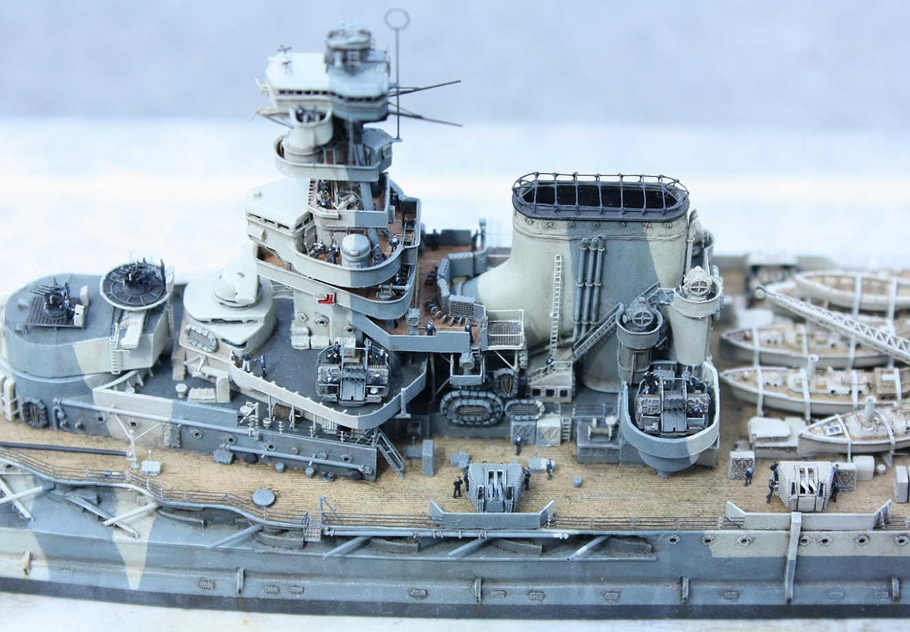

Before adding the AA armament I decided to deal with the crew � a departure from my previous practice, as populating the ships has always been the last step in the construction of my models. The reason for this change is that the ships is depicted in a state of combat readiness and therefore most of the crew is seen manning the open AA batteries and the bridge. It would have been nigh impossible to attach the figures to the 4� AA guns or pom-poms already fitted.
I used 101 PE figures from sets of GMM, Eduard, FlyHawk, Lion Roar and Five Star. I prefer to use photoetch figures with adjustable limbs � essential when you want to depict them seated or at an other specific posture. Ratings and officers have been glued to a piece of sprue, then their flat appearance was ameliorated by adding gel type superglue to their torso � one tiny drop to the front, two to the back, as learnt from Marijn van Gils, however without the addition of baking soda. A coat of primer followed by airbrushing dark blue all over them was the next step. Details like faces and hands, middle blue collars, white shirts and dark blue caps have been picked out by hand using a very fine brush. A layer of matte varnish completed the preparation of the crew.

Next, eight of them were attached to the 4� mountings, six to each pom-pom, three next to the Vickers 0,50 machine guns, and the weapons have been glued to their respective places. I added figures to several deck levels most notably ones to the binoculars at the compass platform. They are minuscule and very hard to notice but there they are, sitting at their instrument. In all it is somewhat surprising how the ship soaked up a hundred figures � you have to look twice to notice them. The empty expanses of the forecastle and the quarterdeck must be responsible for this, but I resisted the temptation to put figures there � they are not supposed to stroll around when the crew is at action stations.
All that remains to do is to affix the railing, quite elaborate on this ship, and to add some flags.
