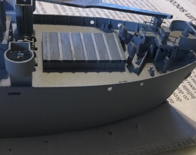

Re: Calling all Liberty / Victory ship fans

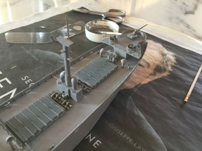

Very useful movie. And very useful suggestions. Today i tried 2 different grades of grey, the darker was the more realistic, i guess. Anyway i need to refine several points tomorrow. I made more wrong brush touches than i thought.

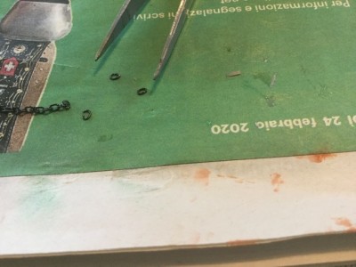

Today i spent some hours that are hardly justifiable to anyone who is not a modeler. Cutting rings less than 1mm of diameter, closing them again, passing the rope inside (i took more than 1 hour to find a way and to do the activity, since the usci van der host rigging rope is so thin that breathing alone moves it), gluing a nylon wire to the ring. The overall result is not excellent, but really i was not able to find a better way to simulate the pulleys that hold the lifeboat.

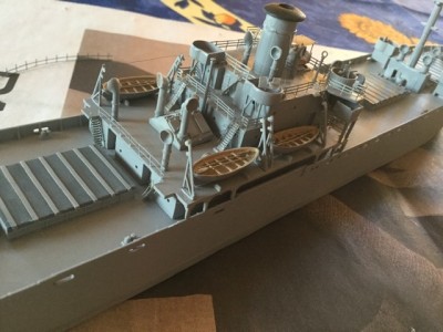

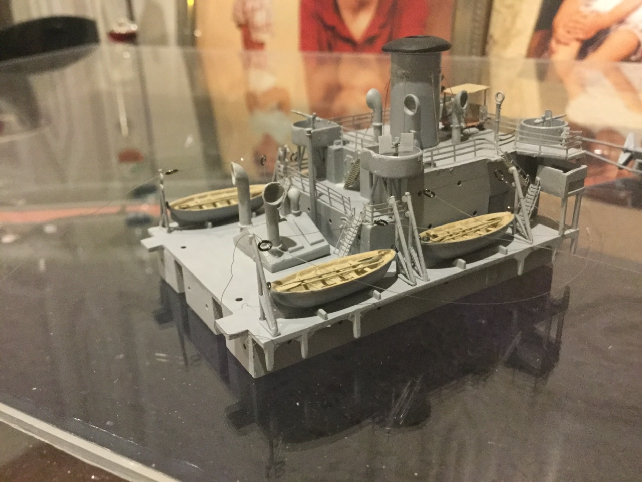

I had to give up the idea of improving the lifeboats area since the tension of the fishing nylon and of the rubber of usci van der host wire are very different and the nylon simply decided what to do, forcing the rubber in unrealistic shapes. Yesterday i focused on the covers: they still appear too much dishomogenuos, but after 5 passages i give up and keep them. I also added ladders and started to assembly the whole deck.

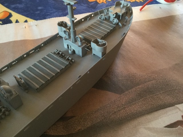

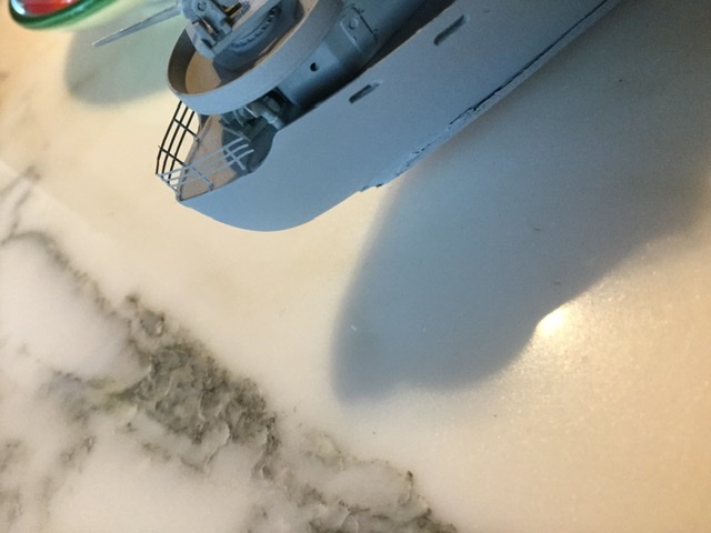

Not many improvements today. Scratchbuilding the two boxes in the bow area was challenging because they had to have the same shape and size and be enough squared. And the handrail in the area had a very peculiar shape. But in less than 2 hours i did both.

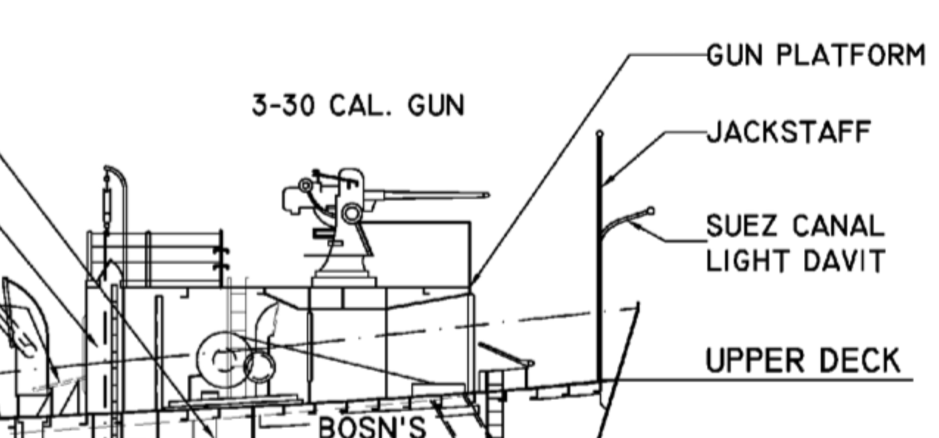

It should be a 3� 30 calibers (see the picture below)DavidP wrote:what size gun is that in the bow tub?

I think that is a typo. Should be 3" 50 cal.

I think you are right. Indeed 30 calibers should be very short and there doesn�t seem to have been made / produced a 3� 30. Sorry for not realizing it before posting my image and thanks Rick_h.Rick_H wrote:I think that is a typo. Should be 3" 50 cal.

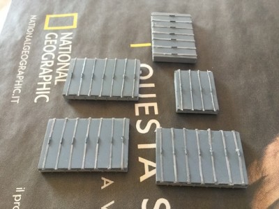

After all i was very unsatisfied with the hatches. The color was uneven, irregular, despite all trials. And the closing stripes were too large. So today i decided to remove them (luckily the glue is not so strong), sanded them till flat and airbrushed them. Next step, in future days, the re-building of the stripes. I will try both a plastic solution and a kitchen aluminium solution.

For what it is worth, a reference that I have showing hatch coverings of that era describe the batten bars (represented on the model as the stripes running athwartships on the hatch covers) as "made of mild steel about 3/8 inches thick and 2 1/2 inches wide."

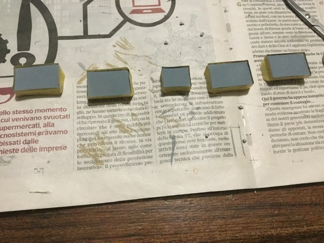

Dear all, many thanks to guest and Kimmerwerft.
The DO issue was really puzzling for me. Indeed it explains why something was detailed and something not
One hatch cover stripe (batten bar) of 2 1/2 inches in 1/350 is more than challenging. It is less than 0.2 mm. Doing it with a fishing nylon wire creates problems of thickness. I tried cutting aluminium stripes, but the blade simply destroyed anything wide less than 1.5 mm. I then tried with plastic, the thinnest i found (from a pasta envelope). There are problems with paint, but anyway i was able to cut it a bit less than 1 mm wide. Not too close to reality, but i think much better than the model base (moreover it allows to show somewhere some space between the stripe center and the hatch cover, that sound realistic).
Below the picture of the present status, with the pieces still quite troubled by cyanacrilate and the plastic sheet used as a base for the stripes).
