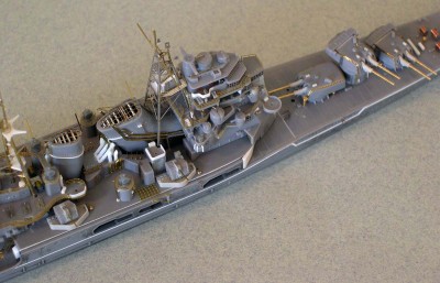

apfelzra
Hi Takao fans,
I'm getting close to completing my Aoshima 1:350 full hull 1944 Takao, and have a somewhat esoteric question. I have both the standard and Plus GMM photoetch sets, and in the latter there are a pair of boat booms with jacobs ladders for use when the ship is in port and at anchor. GMM's instructions are to install these two booms on either side of the hull opposite "X" turret (turret No. 4). However, I want to portray the ship at sea as she was in October 1944. Should these booms be completely omitted, or would they have been stowed longitudinally along the hull, parallel to and just below the deck? Would the small cranes that operated them be upright, or collapsed? If these structures are to be shown attached to the hull, I assume the attached ladders and hanging lines should be removed prior to gluing them in place. Thanks for your suggestions.
On another matter, I have installed brass 8-in. gun barrels to replace the kit's plastic ones, but to match the correct length I had to cut away the plastic blast bags when attaching the barrels to the plastic base that snaps into the turret. I was able to substitute small strips of tissue paper, fastened around the barrels with diluted Elmer's white glue, and then paint them very light gray. This not only achieved a satisfactory visual effect of the somewhat bulky bags, but still permitted each gun to individually raise or lower and yet show the barrel fully enclosed at the turret by the bag, which remained flexible enough to do this.
- Posts: 9053
As you suspect, the boat booms are stored against the hull, horizontally. They pivot at the attachment point to the hull. The davits are collapsible and are also stored up against the hull. Go to the first page of this thread and view some of the builds for an idea of how they are positioned. Booms, too.

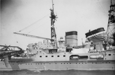

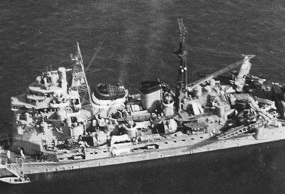

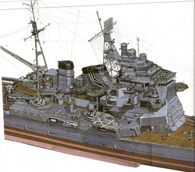

SRC
Takao-class midship detail
Wondering about the midship structures on the Takao-class ships - the ones with the ventilator grilles and various AA platforms (they vary from ship to ship in that class). On the Chokai especially, with only one AA station per side in that area, there is a lot of unoccupied surface on the top of those built-up areas. Did they have railings? It seems strange if they were unused or if personnel were unsecured if they were used for anything...? I have found no pictures or diagrams in any of my references that address this detail. ?? Thanx, Steve
- Posts: 9053
Did you have a year/fit in mind? There is information in the AOTS Takao book (the sisters were 98% identical prior to the 1938-39 refits of Atago and Takao); also in the Miyukikai plansets.
Prior to her refit with additonal AA and platforms in this area in mid 1943, much of this area was used for storage of damage control lumber. Some photos prewar and of my 1942 1-700 build, vs 1944.

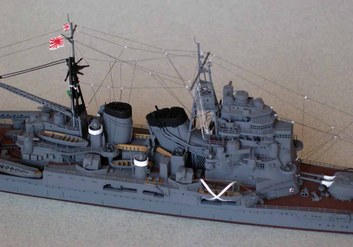

- Posts: 9053
Unfortunately, I don't have an extra Gakken for sale, Steve. Amazon or Ebay is probably going to be your best bet, Unless Pacific Front Hobbies has one.
The photo above was just an in-process shot. Below is a view of Chokai finished. It's late 1942 fit so, the raised platforms either side of #1 funnel used previously for saluting guns were changed over to an emplacement for a twin 25mm AA.
mozartgarage
Thanx so much for the pix, Dan; I know that was some trouble for you and I appreciate it. The Gakken #16 pic is, along with the rest of the magazine, unknown to me, so thank you for that, too. I have been working from the AOTS, the Model Art, and the Kagero books, none of which show the 1943+ add'l AA mods, etc. I find this interesting and would like to incorporate them into my 1/350 Aoshima build - maybe. Thus: what are the large structures behind each funnel that the Gakken pic shows, and what would be the other major alterations for that version?
