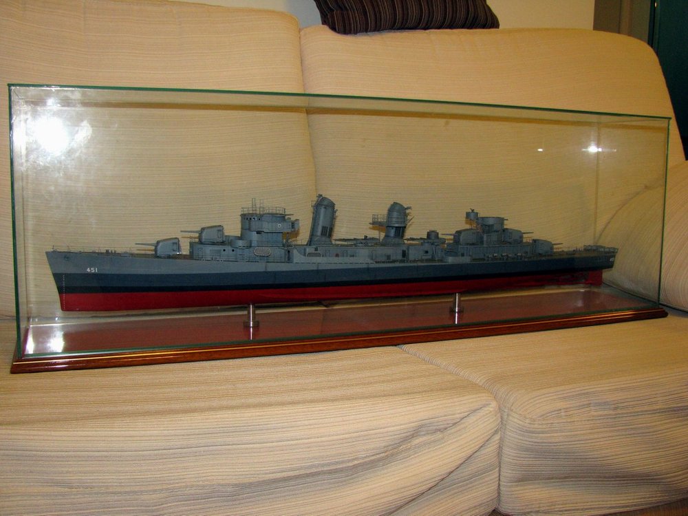

bountyjumper wrote:Doug, your work is inspirational. Nicest I've seen in a long while. I've given up comparing my work to yours and I sleep better at night now.
So how are you going to display it?
I think I solved the scoreboard problem on my ship, or at least came close. I found a 1/72 scale Corsair decal sheet that had just the right size kill markings. The silhouettes are chips and bits of white decals that I nudged finessed into place one piece at a time. It's not exact, but I think it works.
Pat
Hahaha, you meant notorious. Glad to know that you have the markings done. It looks good to me !!

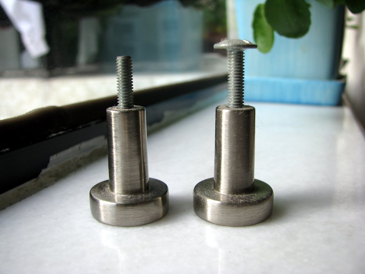

I would display it like this. I ordered a glass display cover. And I would support the model with two knobs with screws and nuts. I bought the knobs in IKEA funiture shop.

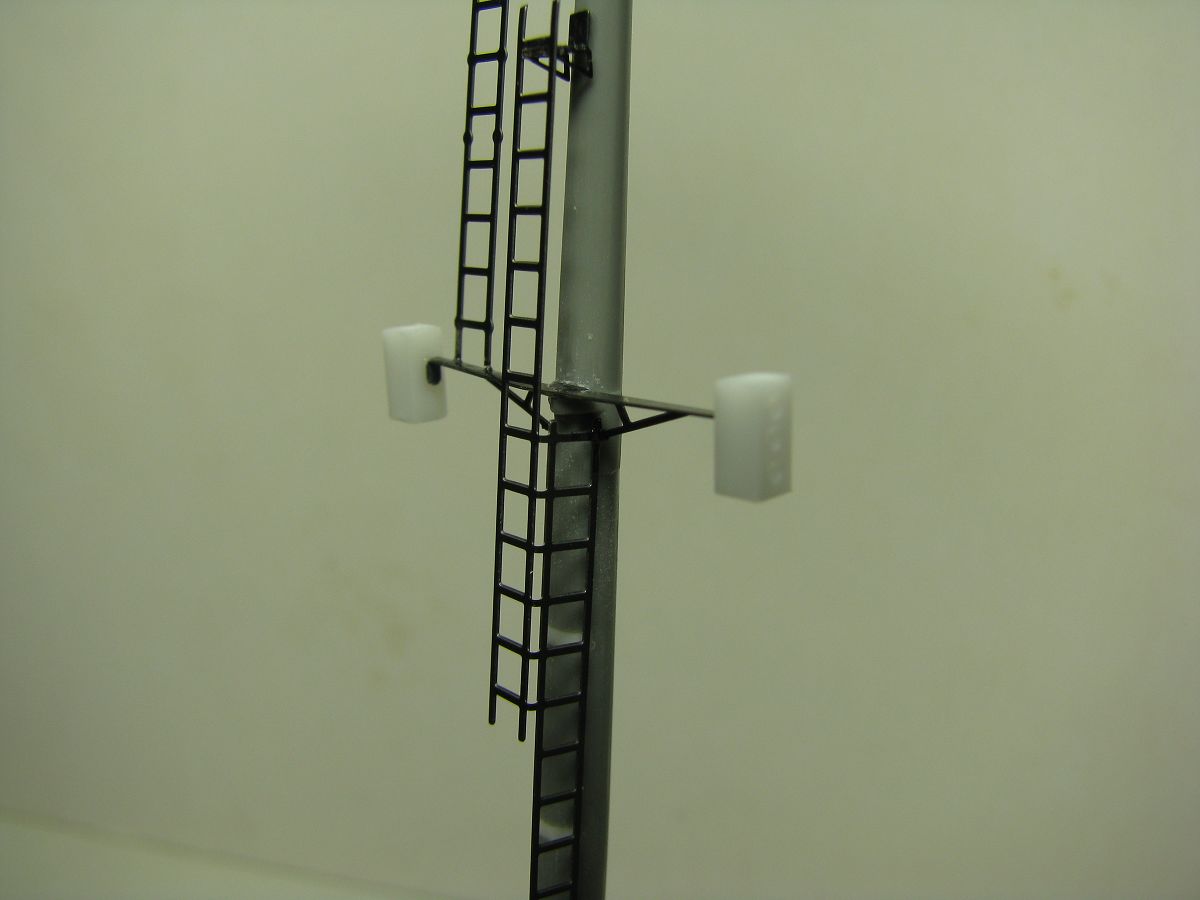

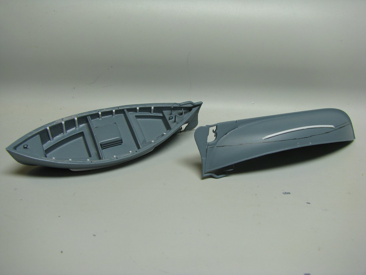

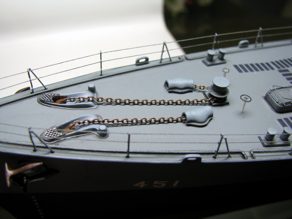

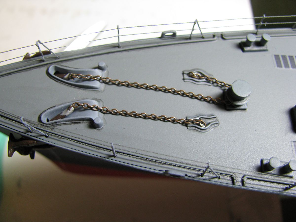

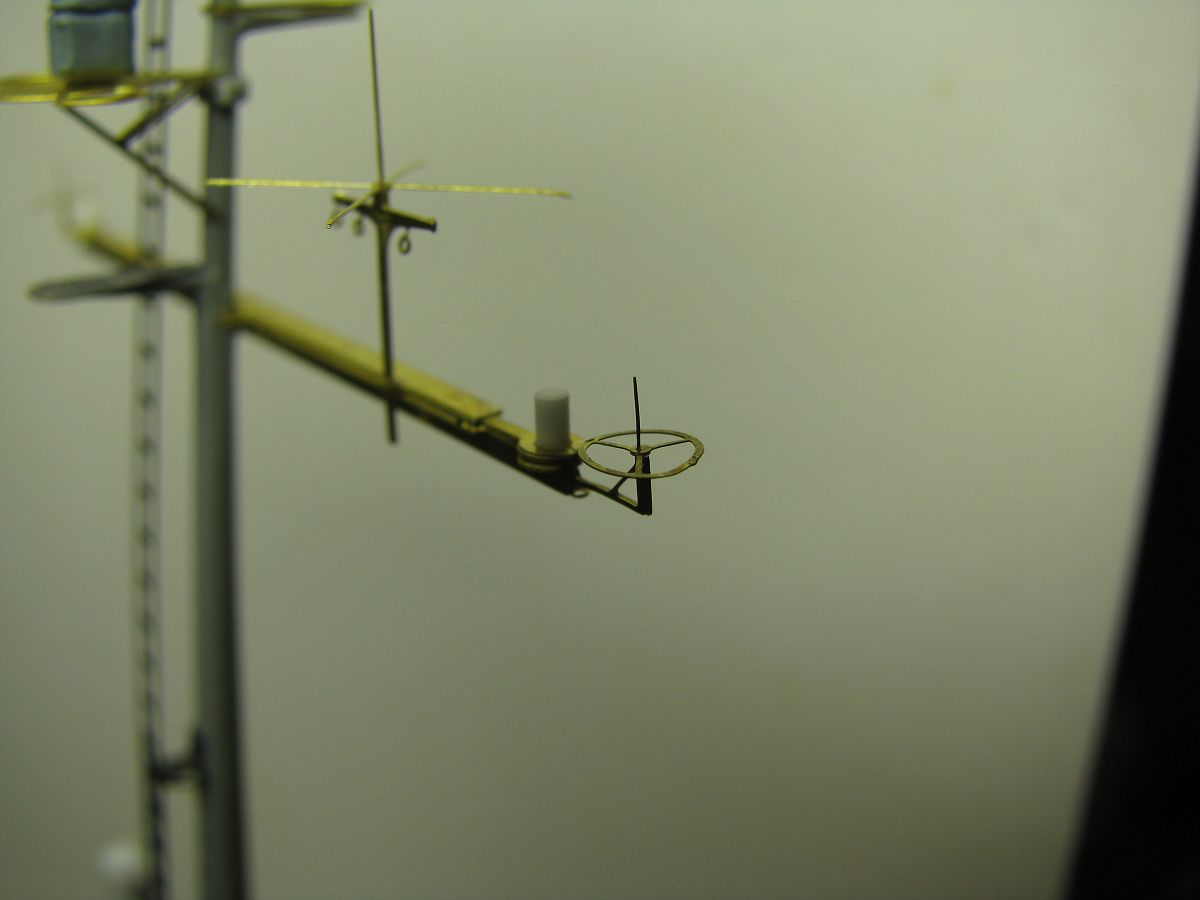

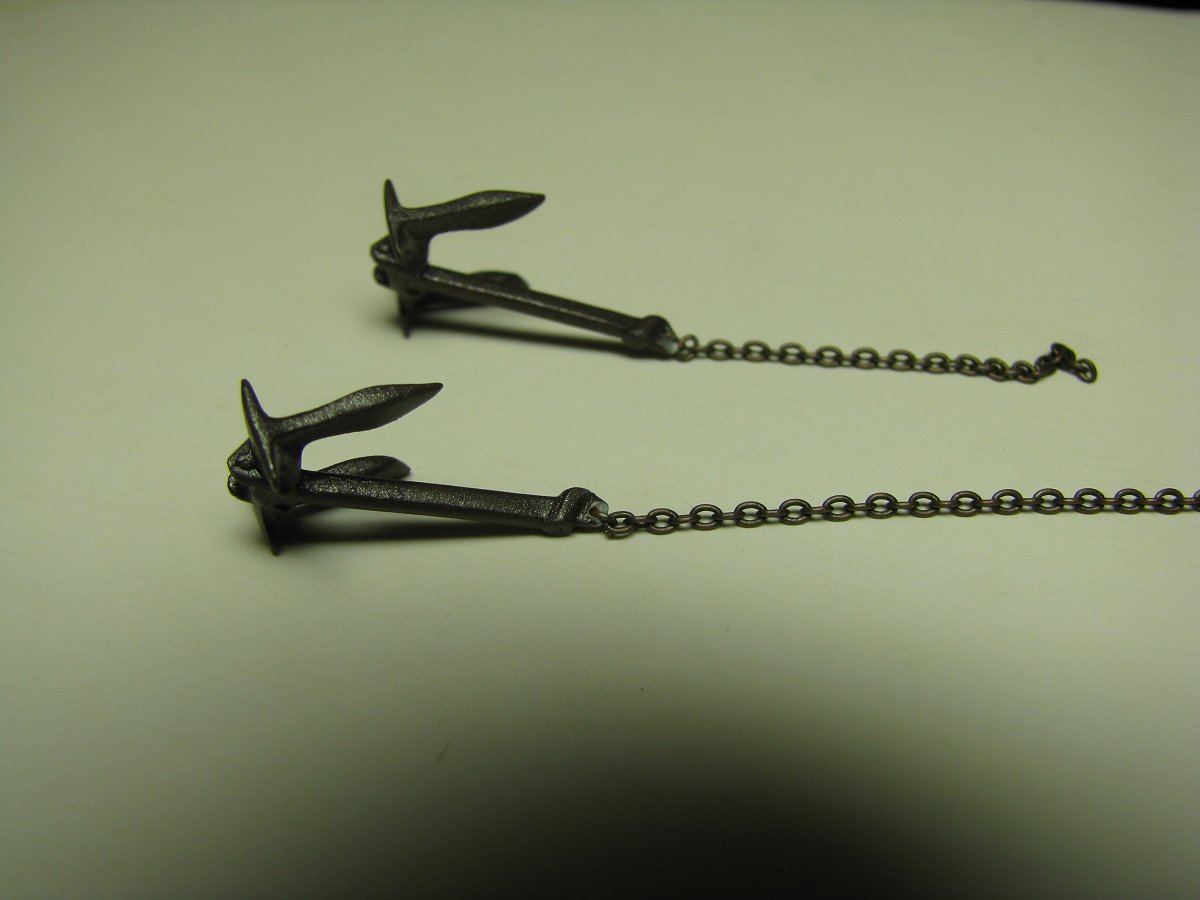

Some more .........

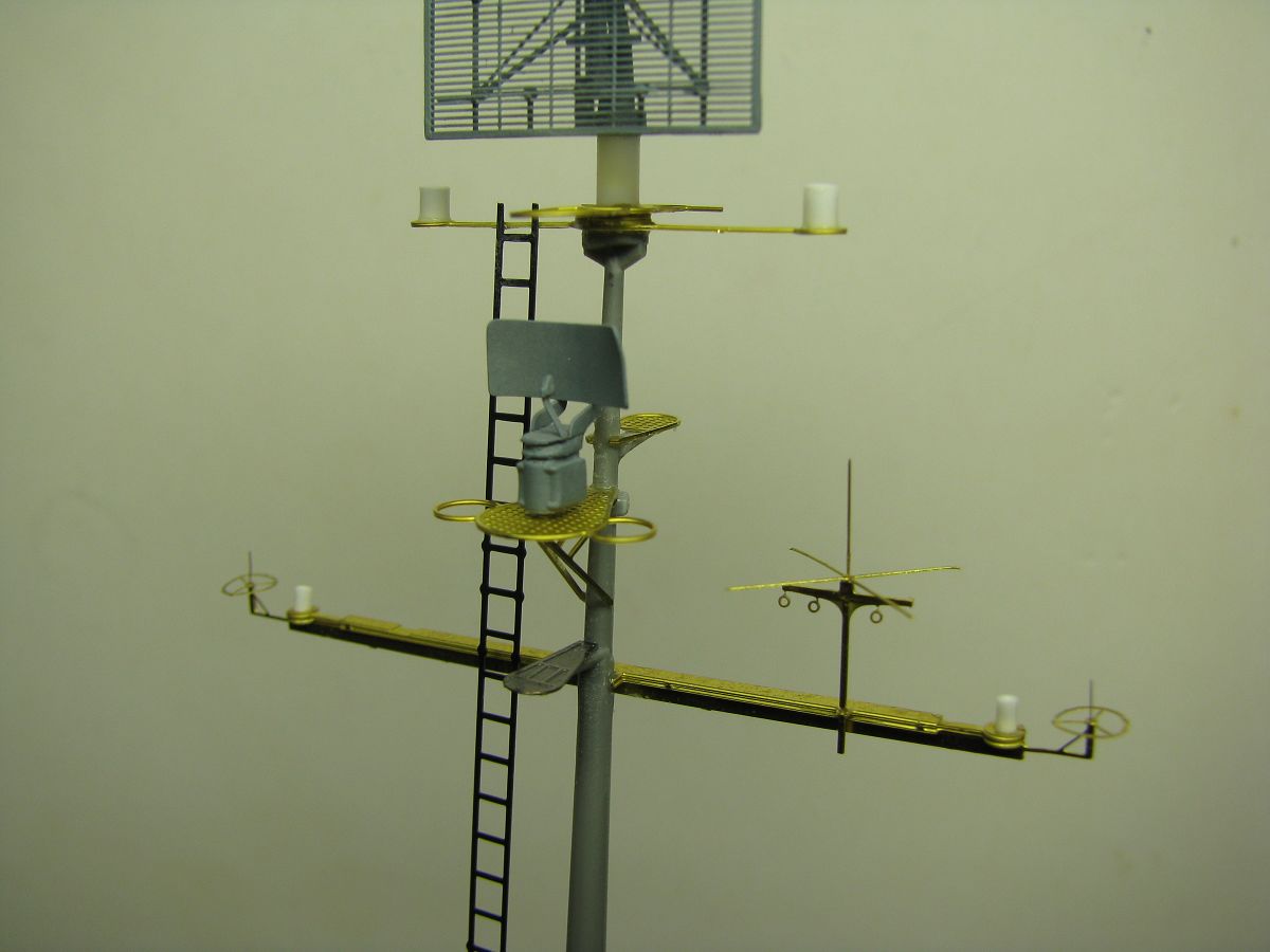

Looks great Douglas! What are you planning to use for the rigging - silk thread?

Douglas,

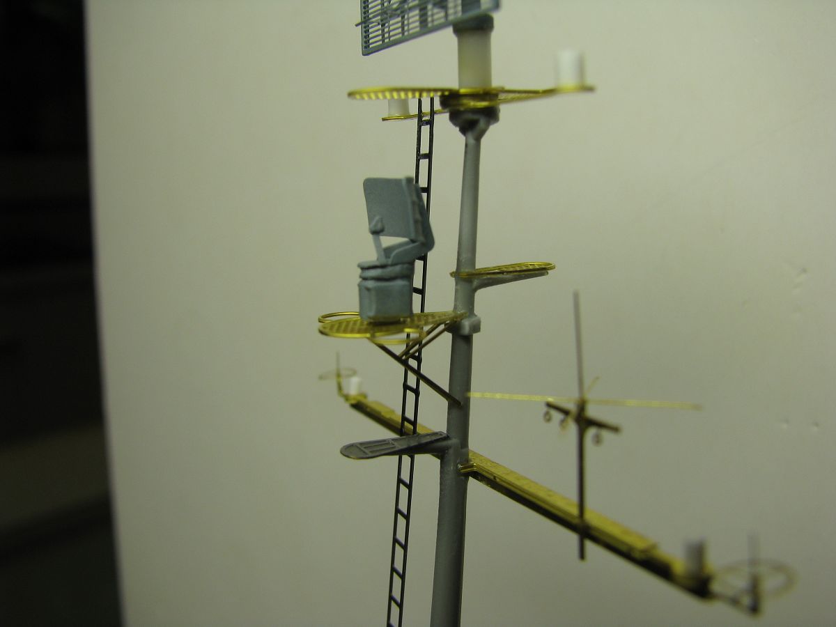

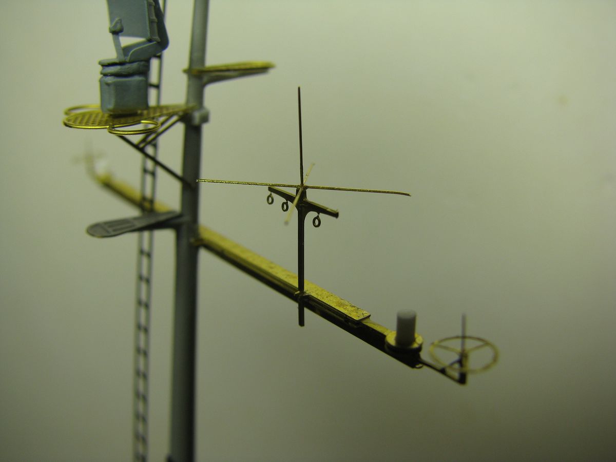

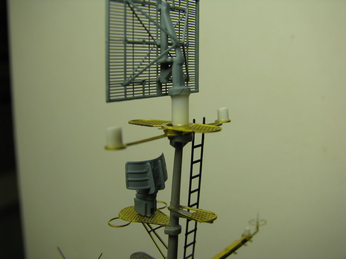

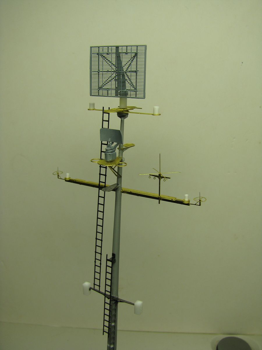

You do superior work, you are a heck of a lot more skilled than me, but I'm going to point out some details about CHEVALIER foremast configuration during her career ... July 1942 through October 1943 ... that don't agree with your mast. You can choose to modify the mast or not, that is up to you, but you do museum quality work and I sure would like to see your build as accurate as possible. I'm not sure what you are using as your source for the foremast layout, but it is a combination of early war SC and SG radars, which are correct, with IFF antennas that are not.
CHEVALIER (DD-451) on 24 October 1942 as she departed for Operation Torch. Note the foremast equipment, likely the equipment she had going to the South Pacific. Note the antennas installed and other arrangements. There is a TBS antenna on the port yardarm, but no other antenna on the starboard yardarm at this time. Also, the upper yardarms were not installed until very late in the war on FLETCHERS ... mid-1945 ... and were much shorter in length than you have here.
NICHOLAS (DD-449) on 24 August 1942, BIW-built sister to CHEVALIER on 24 August 1942 shortly before she left for the South Pacific. Note her foremast and the foremasts of a couple other unidentified FLETCHERS behind her. The "BL" IFF radar antenna has been installed on the starboard yardarm. The BL IFF system was installed starting in December 1942 on new construction and was sent out to the forward area in "kits" for installation on deployed destroyers. It was very common to be seen on FLETCHERS in the summer of 1943.
WALLER (DD-466) in August 1943 another South Pacific FLETCHER. Note the BL antenna.
BEALE (DD-471) on 31 December 1942 being completed at New York Navy Yard showing a new installation of the BL antenna,
PICKING (DD-685) on 4 October 1943 at New York Navy Yard as completed with the SC-2 radar. The BL antenna had problems with interference with other radar equipment and was replaced with a shorter version as seen in this photo. Note the location as installed at this time. This SINGLE antenna was moved outboard to the location you have starting I think in early 1944 (not sure when and doesn't appear to have been moved outboard on all FLETCHERS). Late in the war two of these antennas were installed as you have them ... starting late in 1944.
CONY (DD-508) in December 1948 in mothballed condition. Note the upper "yardarm" extensions for the relocated trunk lights (maybe NANCY gear).
Bottom-line, depending on when you are modeling CHEVALIER, she would either have the BL antenna (I have one very grainy image of CHEVALIER that "appears" to show the BL installed in August 1943) or no IFF antenna yet installed.

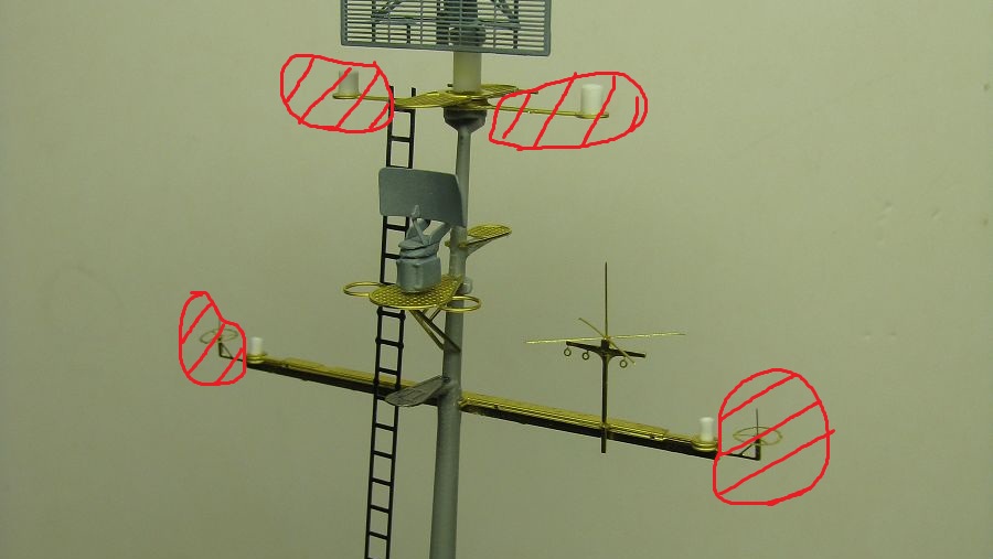

Rick,
Do you mean removing all those I circled in red ?

Red Devil Squadron wrote:Looks great Douglas! What are you planning to use for the rigging - silk thread?
Bill
Yes, Bill, silk thread, as I did the railing. I used a clip for a steady tension while I fixed the silk thread with instant glue. Photos later.

Post by Rotorhead »
Douglas,
Really looks SHARP!!!!!!!!! :thumbs_up_1: Doesn't look too hard to remove a couple of those pieces.
