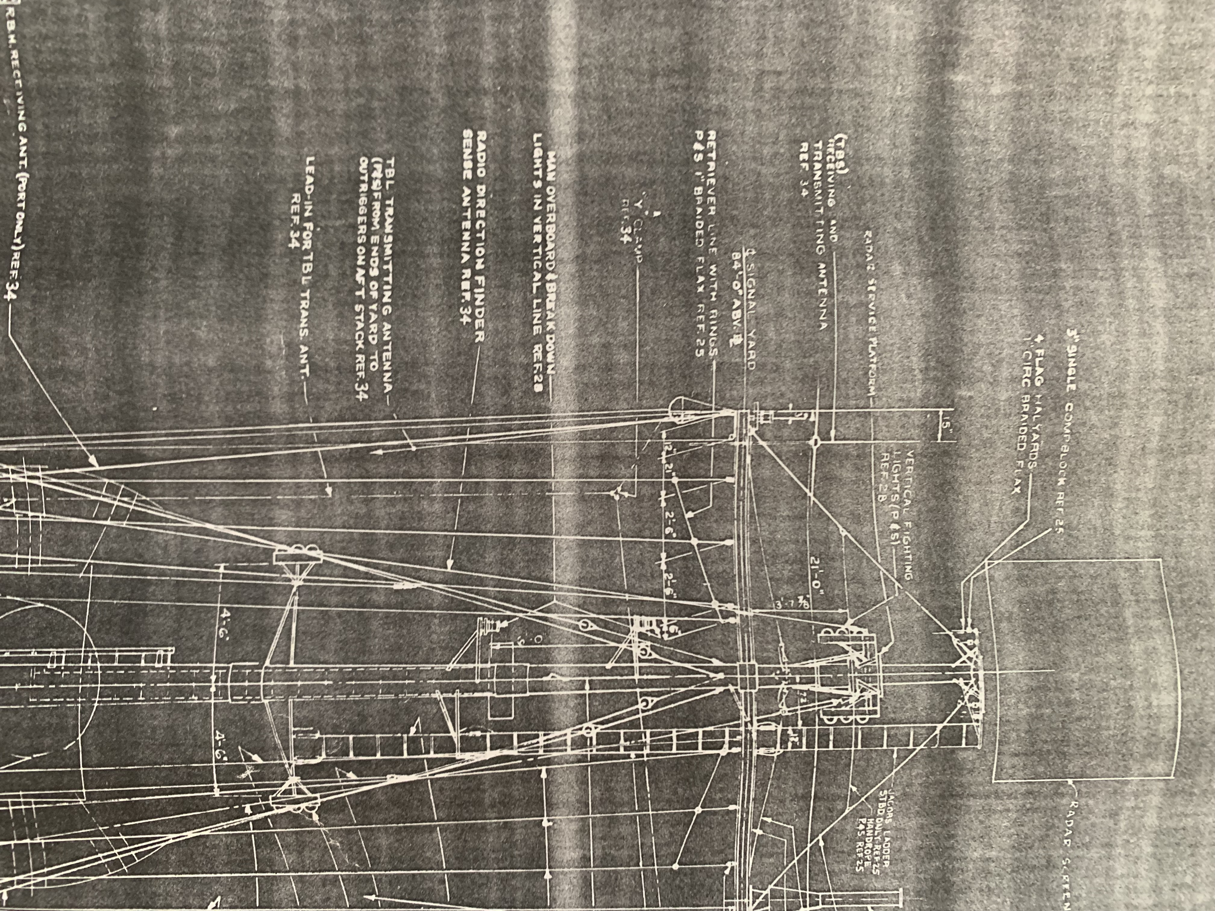

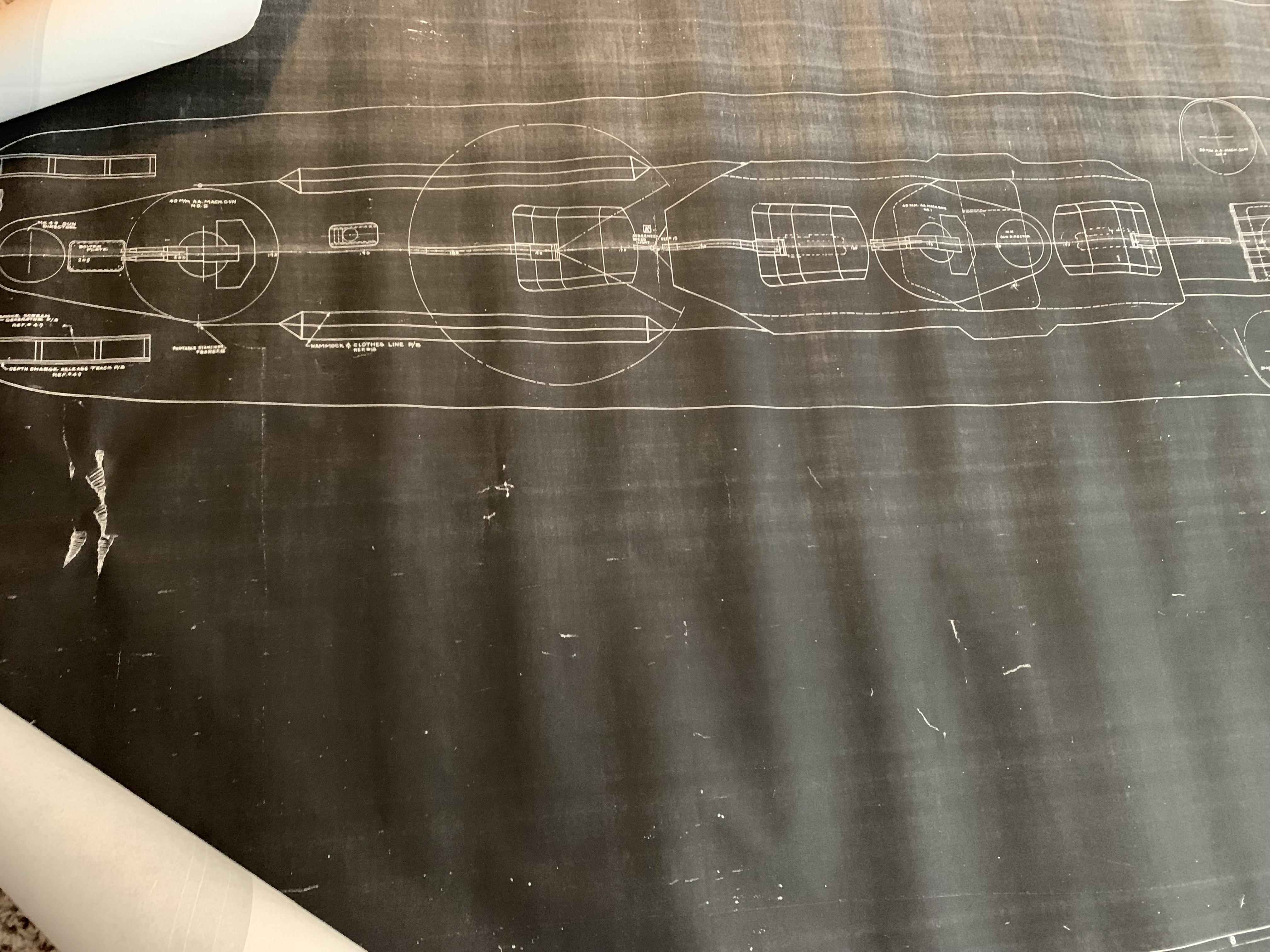

Found an interesting set of plans for the Fletcher class. Quality is not great but it has some interesting details to pick out.
One is the mast rigging Another is that I get the impression there was some plans to make Mt�s 53 & 54 open top like on the Sims/Benson/Gleaves class. Those two mounts are drawn differently from the other three. Cover sheet info Matt

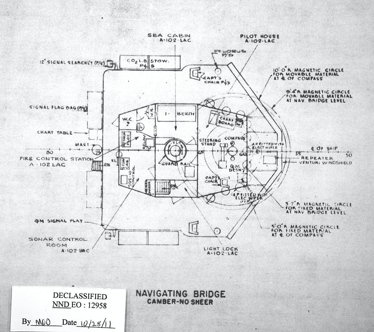

"Guest" (are you unregistered or forgot to log in?),
If you are a non registered guest, I can't send you images and you may or may not be able to view images I post.
To answer your question I need some additional info. What timeframe are you modeling USS BLACK (DD-666)? You referenced a photo of BLACK in the 1960's after she was upgraded to the 4-Gun configuration with three twin 3-in RFG mounts. Is that the timeframe you would be modeling her, or just an image showing what you were looking for? What scale are you modeling USS BLACK? Doing a 4-Gun mod Fletcher can be a challenge.
When you say "the door is placed on the left of the aft wall", you mean on the portside?
From what I can see, USS BLACK has the so called "Bethlehem Steel" style navigation level bridge ... https://www.model-monkey.com/product-pa ... steel-type ...
I have digital camera images of USS BLACK's BGP, but I didn't take overhead shots of her bridge.
However, I do have a BGP (dated 1956) overhead view of the bridge layout of her Federal sister, USS DORTCH (DD-670), which shows the so called "Bethlehem Steel" style bridge. She was also in the 4-Gun configuration, and both of their bridge layouts should be similar. Although internal layouts could be different. The aft bulkhead (portside) door is to the bridge "Water Chest" (aka Toilet).

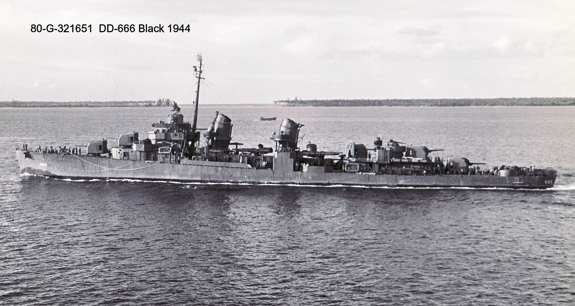

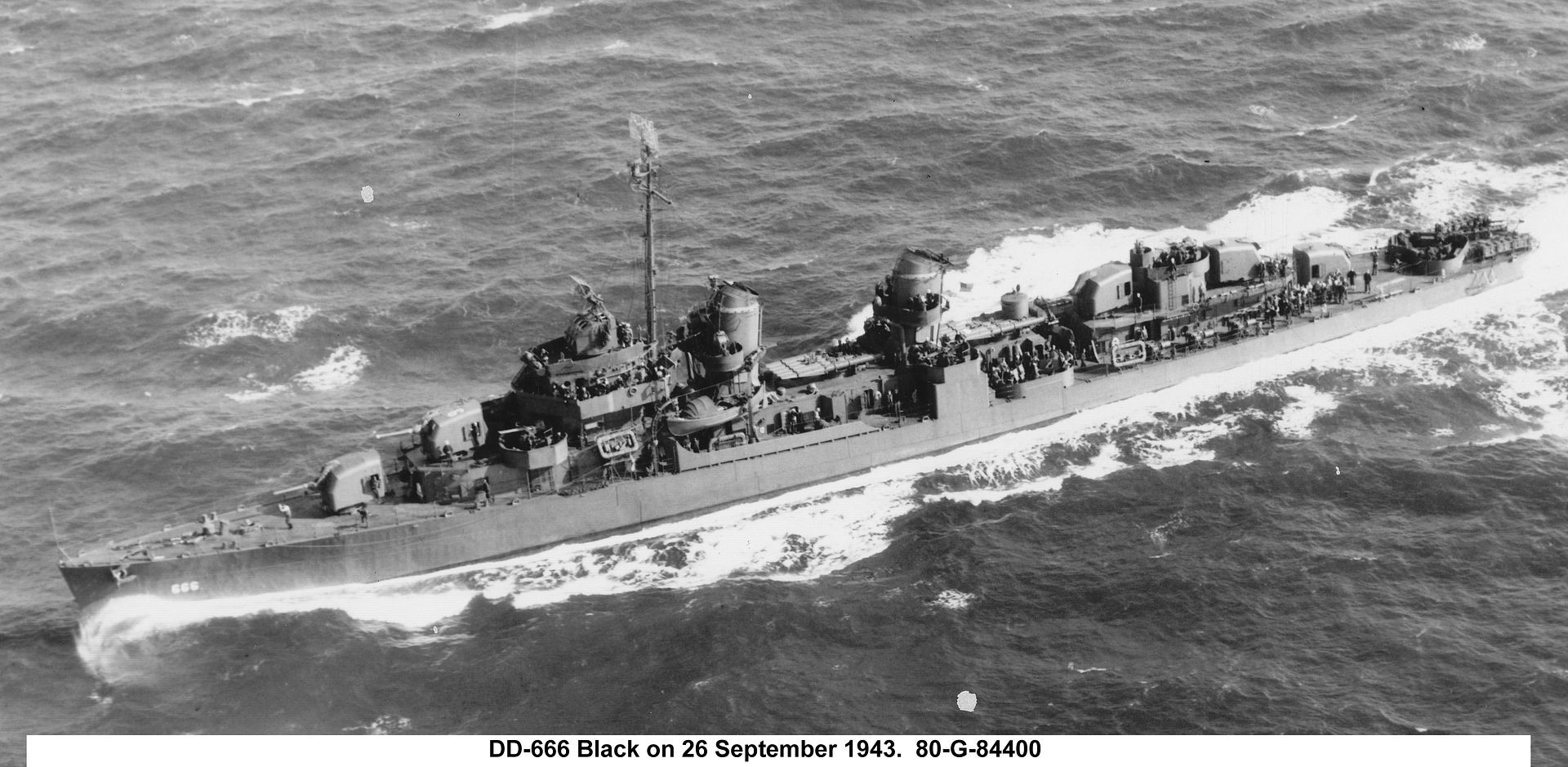

Takibi,
Sorry, but I don't have any detailed drawings of USS BLACK (DD-666) in WWII. The digital camera snapshots I have of USS BLACK's BGP date from 1966 in her 4-Gun configuration, which aren't complete coverage of all of her BGP and aren't really helpful for her WWII configuration.
There maybe drawings for one of her Federal-built FLETCHER's in the block DD-666 through DD-680 in their WWII configuration, which all should be nearly the same. But, in general any WWII drawings of a Square-Bridge FLETCHER should serve as a "baseline" for which changes to USS BLACK's configuration can be made based on actual photos. Pay attention to the bulwarks around 20-mm and 40-mm guns and life raft (floats) locations.
Here are two overall photos of USS BLACK showing her 1944 configuration prior to her late 1944-early 1945 overhaul that updated her fire control radar from Mk 4 to Mk 12/22 plus other small details. (Note: The second image of USS BLACK I believe is dated and located in error on Navsource (they have May 1945) and actually dates from prior to her overhaul in early 1945. The big clue are the life rafts under the ships boats were removed during the overhaul.)
