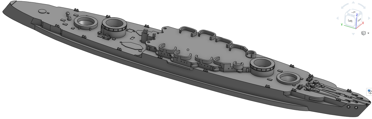

I wanted to share my current project with you all here. I'm developing a 1/1200 USS Arizona for 3D printing. I welcome any comments on my progress so far. Some items I'm limited on due to printer resolution such as the size of the cranes and the thickness of the splinter shields around the deck mounted 5" guns.
I plan to build 3 different models of this ship once I'm done; 1 in early 1941 either docked or sailing, 1 mid 1941 sailing, and 1 moored with awnings in Dec 1941.

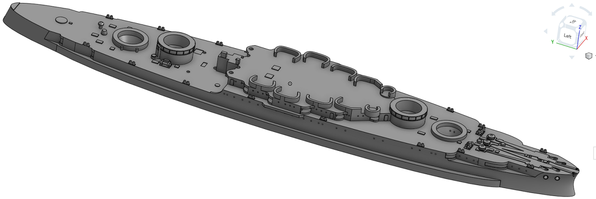

Here's the latest. Once I'm done with portholes, I'll move on to the detail set.

Hey, that's looking good!
Those plates (or lack thereof) are sure to raise questions... model kits and drawings have included them for so long that almost everyone (except us sticklers) "know" they're supposed to be there. In fact, the Trumpeter 1/200 scale kit has the deck planking scribed over them, but also includes plates to glue on top of them - so modelers can have it either way!
Also, good on you for having the casemates open, not presented as rotating cylinders like most kits have done.
- Sean F.
- Sean F.

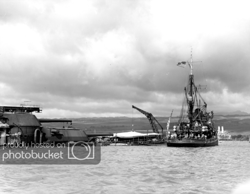

Here is a picture showing how the aircraft crane on the stern was used to raise the middle of the stern awning up a bit higher.

Sean, thank you! I'm happy to have the argument with people with photo reference lol I'm going for accuracy.SeanF wrote:Hey, that's looking good!

Ideally I'd have made little gun emplacements inside the casemates for wire to go into for gun barrels, but its just too small in there. Off the top of my head I think there's like 1.5mm clearance. I have holes designed in the back of the walls that will orient brass wire to the bow and stern as would have been normal running condition from what I understand.

David,
You could very well be right, but I've seen shredded parts of the awning in post attack pictures.
If you give me an alternative to what I'm seeing I'd be more inclined to believe nothing was there.
If you look closely at the photo in question on page 112 none of the other awnings showing up in the photo have almost the same light color as the Arizona's stern awning below it running around the edge were the railing should be. You can clearly see the edge of the stern awning with a dark sliver just below it and then the same light color as the stern awning runing in the same pattern as the edge of the awning were the rails should be.
If there was nothing there it should all be darker below the edge of the awning.
Just what I'm seeing.
