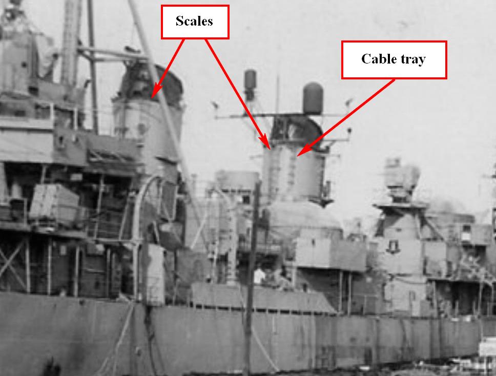

Before proceeding with the upper platforms I want to solve the problem of the wiring. I have more or less clear how to make it with stretched sprue and steel/copper wire, but I am bogged down with the brackets embracing them.
Would you have any idea on how to make them to look realistic ?

Regarding your question about how to show the cable tie-downs on your above photo - First, look and see if you have any photos of JORGE JUAN's after stack base in order to verify that the cabling is same/similar to that shown in your photo (USS SULLIVANS). As I've stated before, these ships were NOT all constructed the same and the wiring to the various electronics located on the stacks was certainly no exception. I will be trying to verify similar details on STODDARD when I get to the construction of the stacks and their electronic suites.
If it turns out that the cables ARE similar or the same (i.e., running up the after side of the stack), they are tied down using a vertical Cable Tray with a square metal tube underneath the cables (in this case nearest to the face of the stack) and a curved metal band over the cables to secure them. It appears in the photo of THE SULLIVANS that there are at least seven separate cables running up the stack. I would try to find some old multi strand telephone wire (the kind that has at least 4 leads [R,G,Y,B] within the outer sheathing) to use as these cables. The size might work out very well - you're more concerned with the plastic sheath than the wire inside. For the cable tray, possibly use some very small Evergreen square strips - today's cable trays are usually made out of "U" channel, but I don't see that being the case back in the 1940s. I can't offer any strip sizes as I don't know what you're able to purchase, but I think that 1/64" square stock (0.40mm) might work out and not look too large.

BB62vet wrote:(...) Look and see if you have any photos of JORGE JUAN's after stack base in order to verify that the cabling is same/similar to that shown in your photo (USS SULLIVANS)
No, no pictures of this area, and no hope of ever having one, I am afraid.
BB62vet wrote:If it turns out that the cables ARE similar or the same (i.e., running up the after side of the stack)(...)
They are. I have been looking into this subject, and I have found out that the position of the scales up both stacks, and tray and cables on aft stack, wether full of cables while she carried the ECM domes or empty when they were omitted, did not change all along Jorge Juan�s operative life. The aft stack scale seems to have always been between both cable trunks:
BB62vet wrote:I would try to find some old multi strand telephone wire (the kind that has at least 4 leads [R,G,Y,B] within the outer sheathing) to use as these cables. The size might work out very well
It is exactly the kind of wiring that I am using. When some years ago the telephone companies replaced the copper wire by optic fiber in my street I took some pieces of wire, just in case I could need them in the future, as it is now the case.
BB62vet wrote:(...) You're more concerned with the plastic sheath than the wire inside. For the cable tray, possibly use some very small Evergreen square strips (...) I can't offer any strip sizes as I don't know what you're able to purchase, but I think that 1/64" square stock (0.40mm) might work out and not look too large.
Yes I am. Using Evergreen is no problem, as I have virtually the whole Evergreen inventory at home, and I can always use stretched sprue for anything that can be necessary reg. rod sections and alike. The problem is the pieces embracing the wires all along the structure, really small things, as I intend the wires to be inserted into them with no glue.
Fliger747 wrote:In centuries past I have had good luck forming such channels from paper. I will testify that such paper items, painted will last perfectly at least 60 years. Probably much longer... 3D printing could also produce such an item.
Tom, this is an excellent idea that will definitely be tested. Actually, after your tip I am considering using the sides of a yogurt container, that are as thing as paper, but being plastic they will work wonderfully with the Tamiya glue that I am using. I will make a try at the weekend.

But searching further in my files, I have found a picture --a section of a picture, better said-- of USS McGowan herself that I had not noticed before, and that shows clearly not only the profile of the tray, but also that the brackets were not oval, but flat. This one:
It is clear now that this arrangement of the wiring laying flat is more intelligent than the one on board USS The Sullivans that I was using as a reference, which was basically a mass of cables tied together with my headache oval brackets.
This arrangement is confirmed on board some other units. Here USS Ross. Notice the neatly positioned cables:
This other pic of USS Uhlmann is gold worth:
Notice the identical arrangements of cables, the profile of the tray and the way the ladder is attached to the stack. As this seems to be exactly the way in which the tray, cables and ladder onboard USS McGowan were built, this is the model that I am going to follow, and as everything will be straight sections of styrene and stretched sprue, this will be (hopefully) the end of my worries in this section of the ship. Gee. As long as I have to deal only with straight styrene sections, I am confident that I would be able to build the Eiffel Tower.

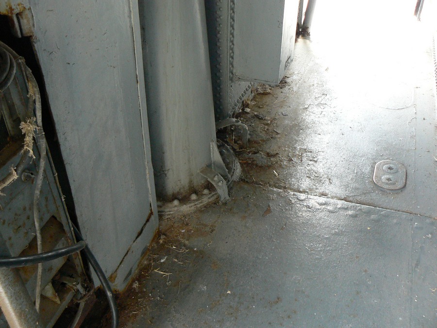

Thanks a lot for the excellent, salty picture, a flashback to a world that no longer exists. Mr. Davis, you are right, this detail is very small, and hence rare to be found in generic pictures, so your idea of addressing this subject is mostly welcome.
I could take some pics of this mast base detail when I was on board USS The Sullivans in Buffalo. As further info, I attach the pics that I have:
And something else that I had never ever seen before that eventful day: the base of the main mast at main deck level, just ahead of stack number one. I attach as well the pics that I have :
Not that it will be very visible, but actually this is a detail I forgot completely about when I closed the structures, so I will have to take care of it pretty soon.
In the meanwhile, I hope these pics are also of your interest.
