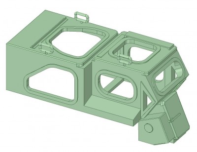

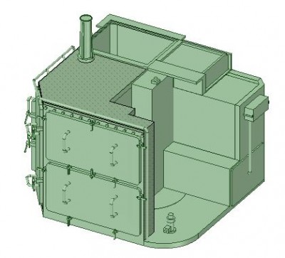

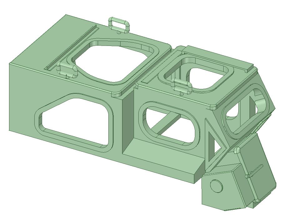

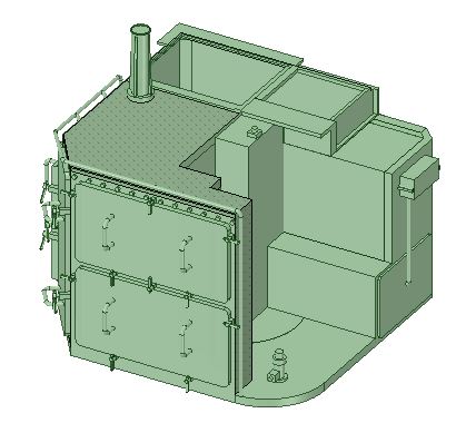

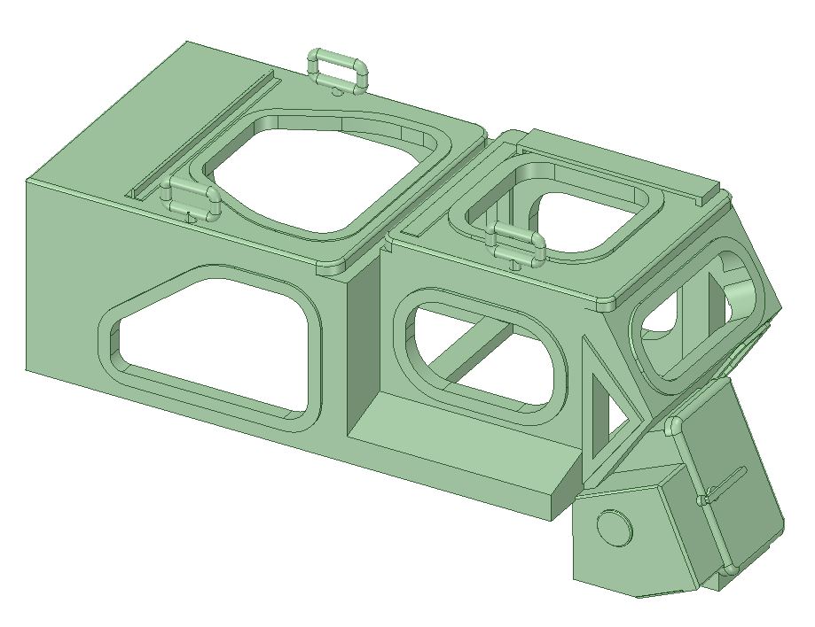

Well, sad to say that the director body did not print well - SO....Plan B!!
Last night and today I redrew/redesigned the director cupola - made it a separate part and then did a test print of 3 - all came out damn near perfect, so that set the guide for removal of the cupola from the director body. So, I now have a complete unit of 4 parts - base, director body, director cupola, and RADAR dish. Here's a couple design shots of the separate body & cupola:
Currently, two of the director bodies are UV curing and then tomorrow I hope to assemble two complete units. I was able to get a complete printing of all the handrails, rungs, pulls, grabs, etc. so I'm fairly well pleased with that.
Among the various aspects one learns while going thru this 3D design/print process, one comes to mind - that the software handles common and like thicknesses better than stuff that isn't consistent in design. This go-round, I made sure the cupola walls were identical in thickness as well as any framing, etc. I also noticed that it seemed to be a smaller file size than previous. I did, start from scratch on this - no using second hand stuff on this!

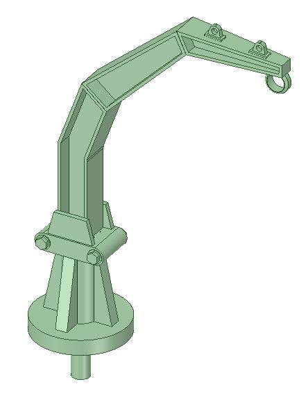

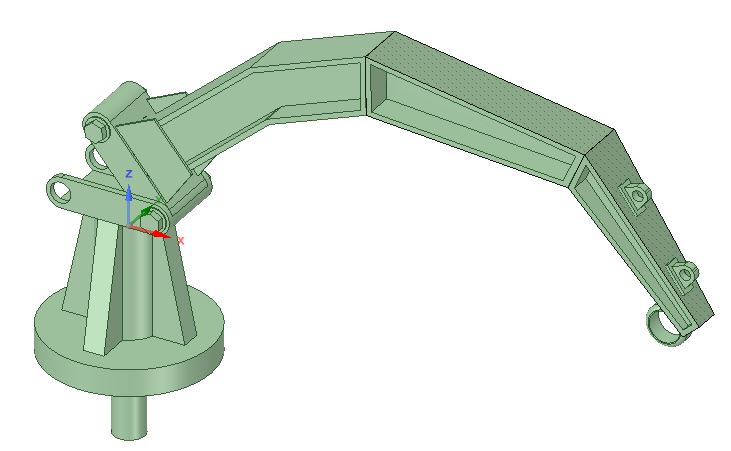

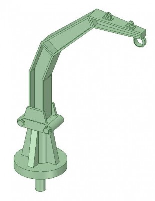

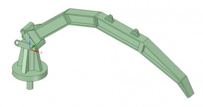

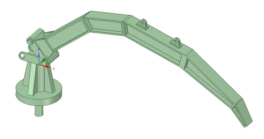

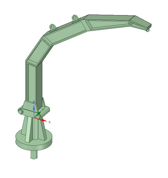

Yesterday & this morning I've worked on the torpedo davits - which STODDARD had a pair that were unique to her - after searching thru all the 4 gun configured ship photos that I have (thanks, R.E.D.!) I could only find a few other ships that had a similar davit setup. So, I've designed two versions - one in the down or stowed position, and one in the up or working position. The photos I have of it are sketchy at best, and the BoGP does not show these items except for the base plate locations. So for the most part, this piece of equipment is speculation on my part with size & shape being a WAG.

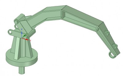

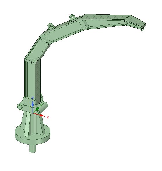

Davit in the stowed position:
Davit in the working position:
I have printed several of each of these today and while I wait for the yardbirds to appropriately clean, prime, and paint the units - I will do further work on the Mk. 56 director parts painting and assembly.
Willie

Again - thanks so much. I am glad someone appreciates the work that went into all those parts. I've actually got 3 more Mk. 56 directors that I'm in the process of painting, assembling and I'll pick the best of the 4 to put on the model. The others will go in the parts locker. :thumbs_up_1:

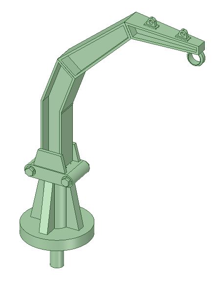

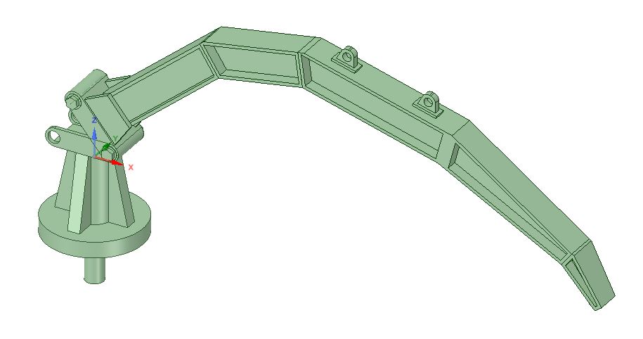

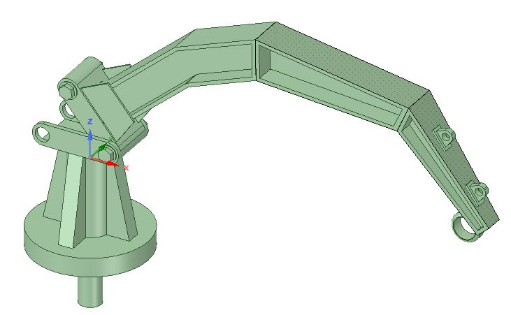

Torpedo Davits - well, as I've mentioned before - it usually takes 3, 4, or more editions until you get the design right and a good printing session. I did get a decent 1st edition, but the problem was that I had added too many sections on the davit and it was oversized. Designed for perhaps a "nucear" torp. (as that crazy Carter used to pronounce it). So, back to the design table and I did a 2nd edition and printing that has come out just the way it should have - sized right and as far as I can tell, represents what's in my photos pretty well. Here is the design pix of both up/down positioned davits:
Tomorrow, I'll be cleaning these up and painting them - also to go into the parts locker for later.

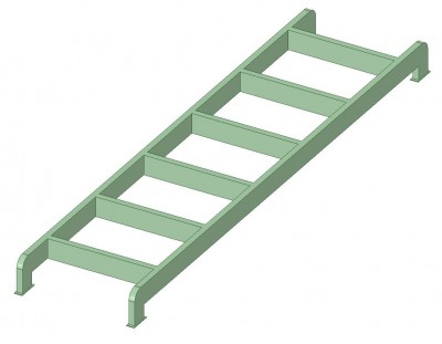

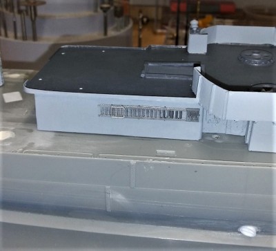

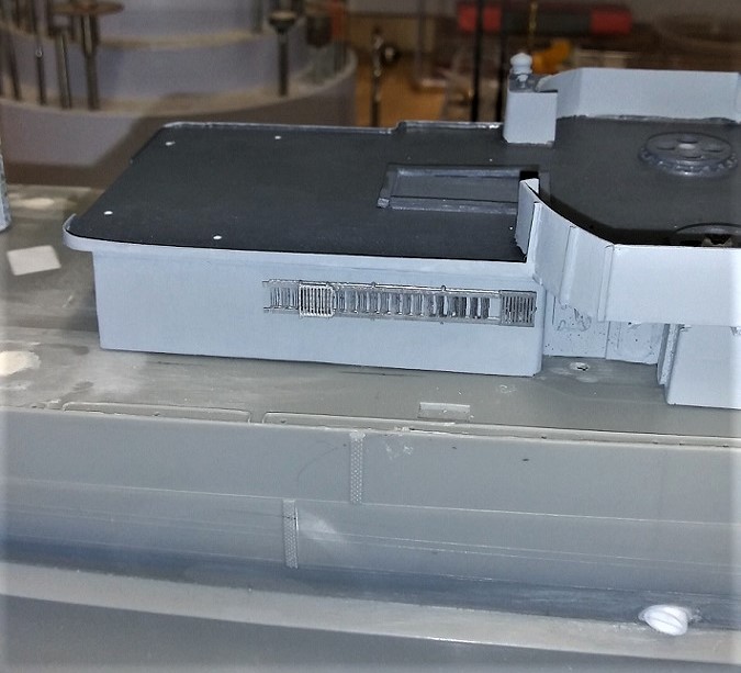

I hope to have a picture of the Mk. 56 in place (mock up, not glued) - I picked the best of the 4 items I had printed and painted. So, this is now complete.

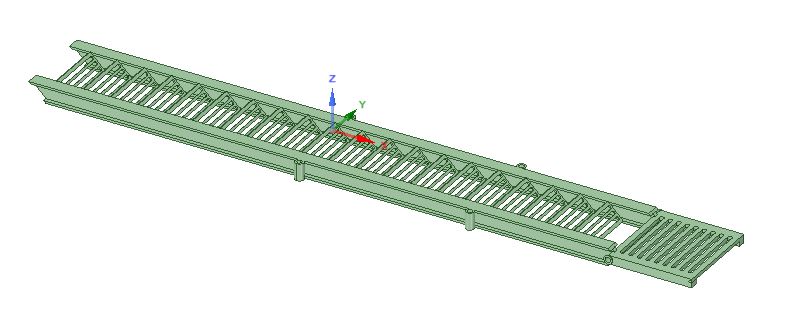

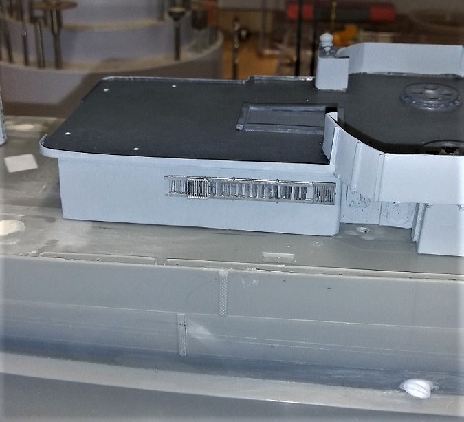

Yesterday & today I designed & printed 3 accommodation ladders & platforms for the model - this will be in the stowed position, so at this juncture I have not drawn up the handrails, but may at a later date to also include as stowed items. Here are the design pictures and then the ladder/platform in the stowed position on the stbd. side of the amidships deckhouse:
I've also installed the one life raft rack on the after side of the 3" gun tub but did so after taking the photo. :doh_1:
So, slowly things are all falling into place.
Posts: 5068
Re: 1/144 Scale USS STODDARD (DD-566) - Kitbash, Revell FLET
Post by Fliger747 »
Hank:
The accommodation ladder came out quite detailed! Especially that you were able to have the treads open. I didn't attempt that on the APA, though not sure what surface they had. I expect solid with a non skid surface?
Good work! Tom

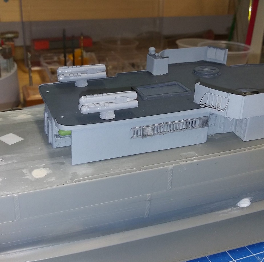

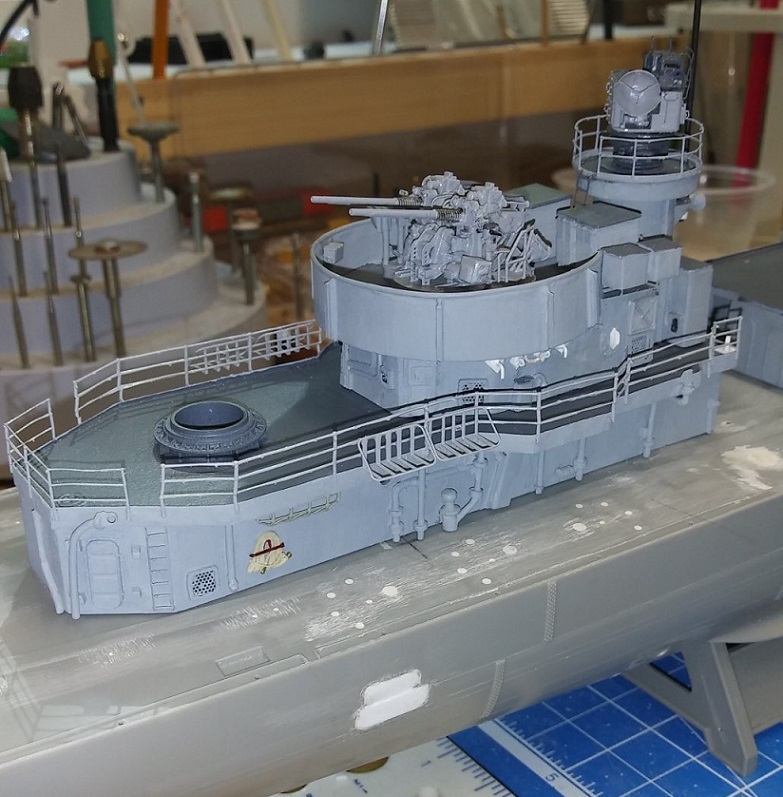

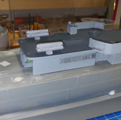

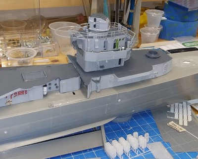

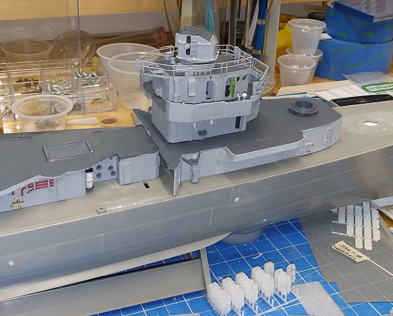

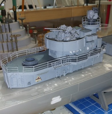

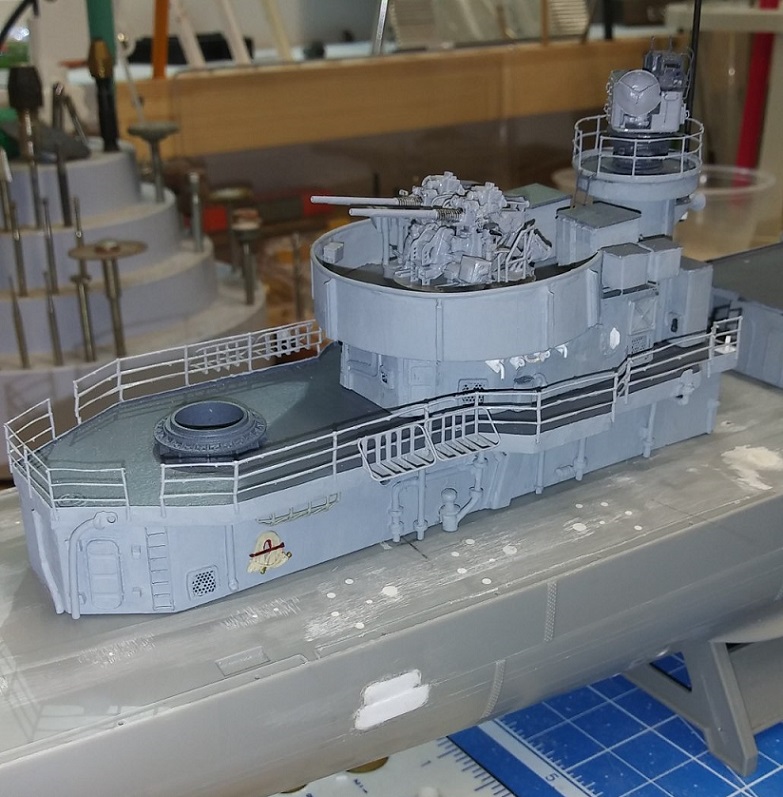

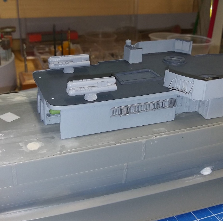

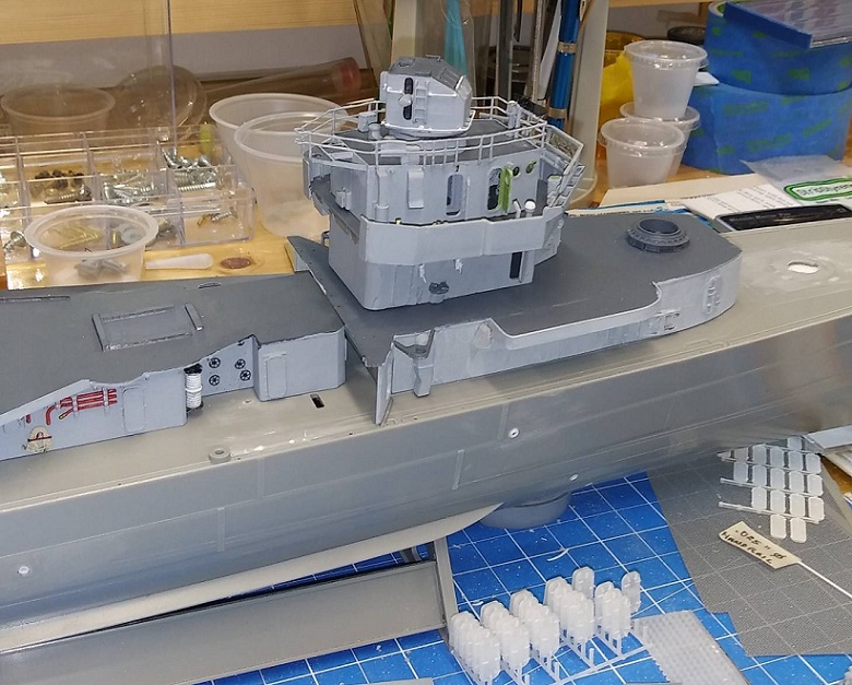

OK, here are a few photos of the current state of STODDARD:
From aft moving forward -
After deckhouse w/Mt. 33 & Mk. 56 (new)
Torpedo Deck with Mk. 32 Tubes
Nav Bridge & Pilot House
I have to cut out openings in the P.H. railing for the V.L. that also needs to be added.
Posts: 5068
Post by Fliger747 »
Hank:
You got that weathered canvas color of the fire hose just right. Also like the effect of being able to peer into the pilothouse deck structure.
Tom

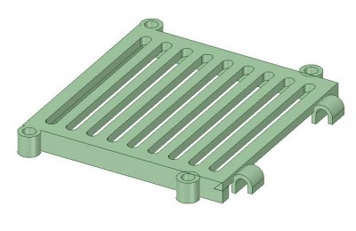

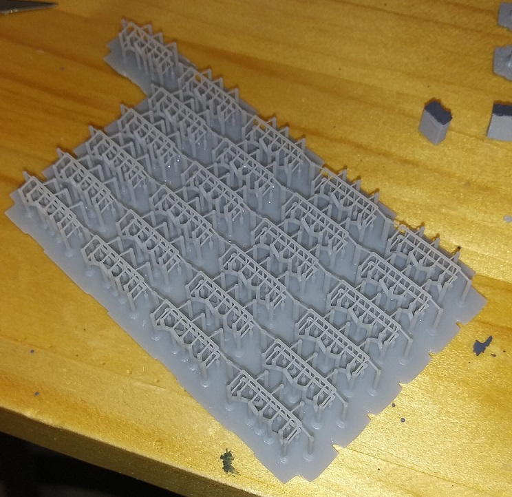

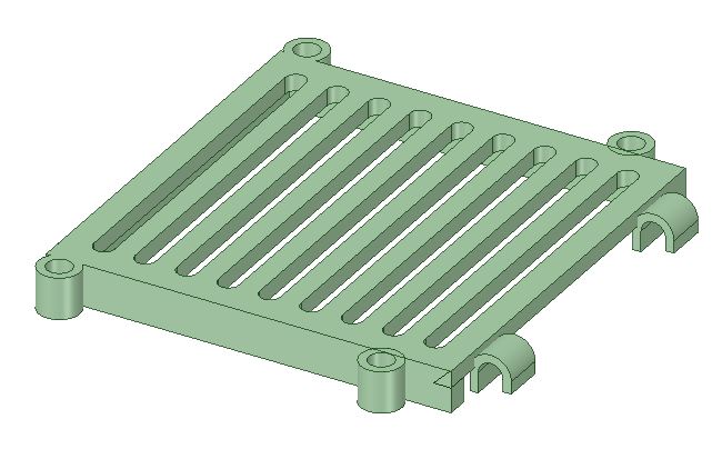

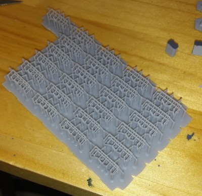

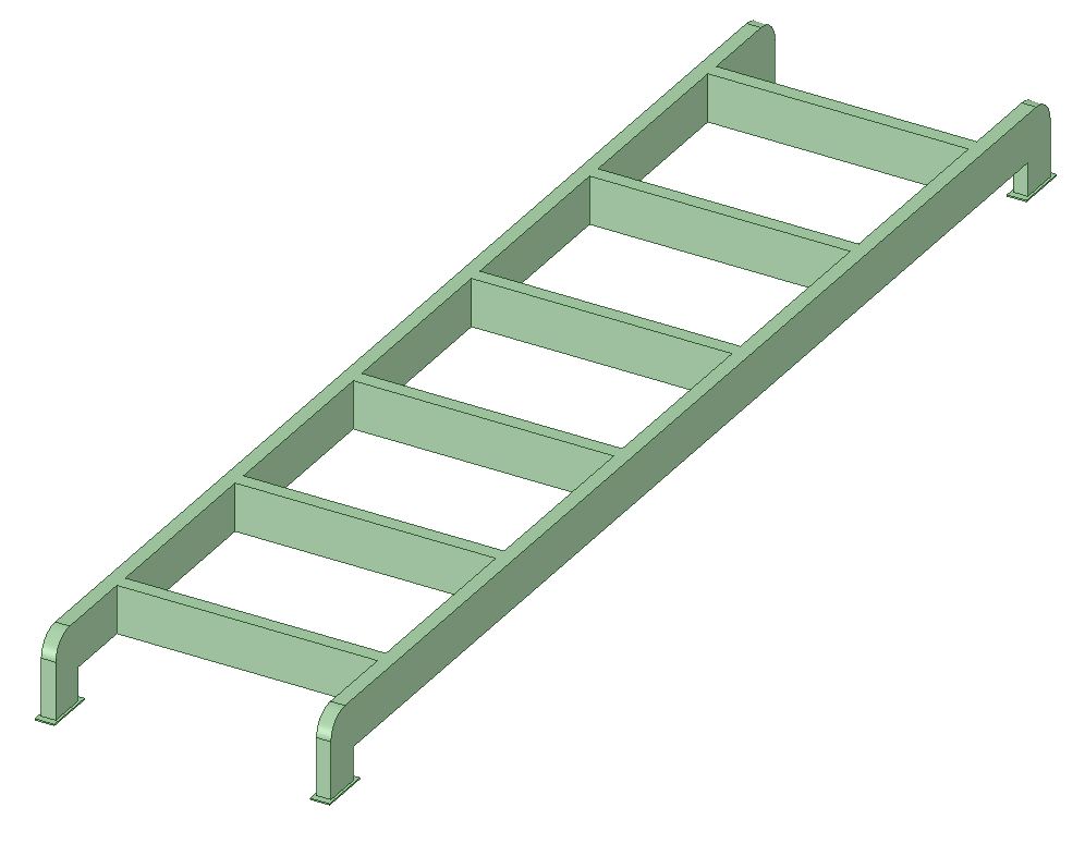

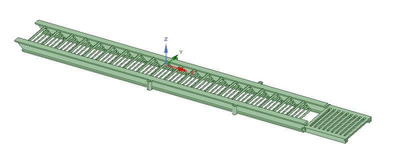

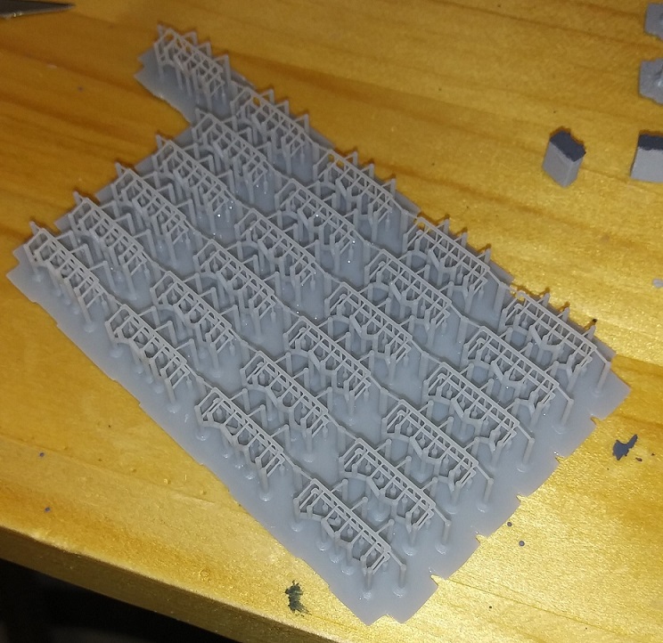

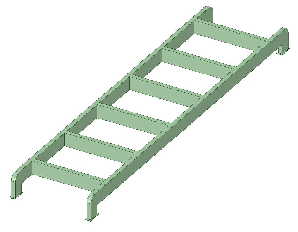

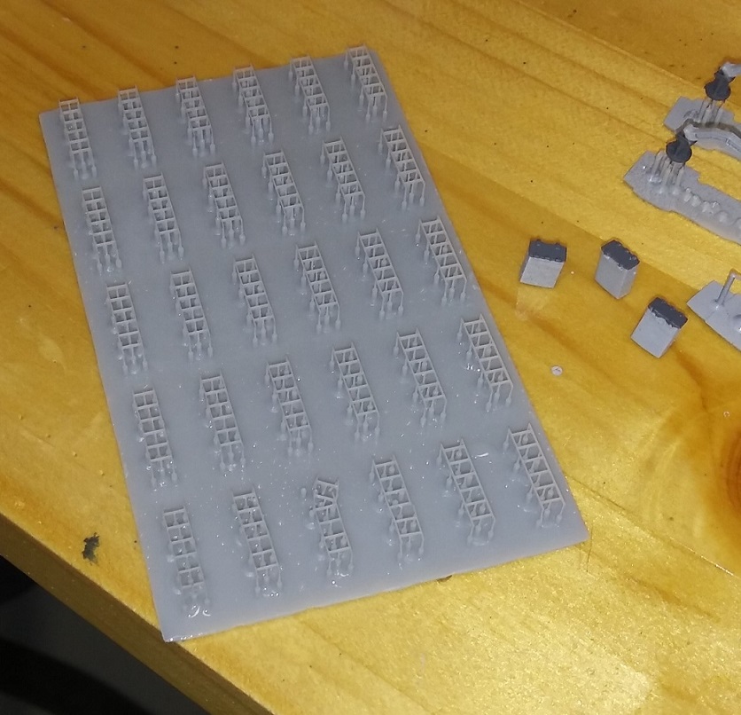

Today was Vertical Ladder day - designed & printed a couple dozen of them - had a few printing problems, but have worked all that out. Running out of PE ladders caused the desire for a more accurate version, hence 3D design!
Design of 6' long Vertical Ladder:
This design file can also quickly be copied and then lengthened as needed for other lengths of vertical ladders, etc.

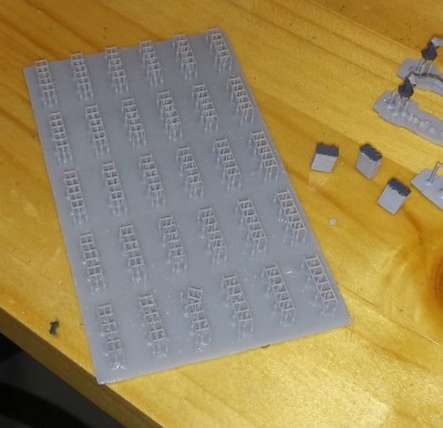

4th printing of the ladders:

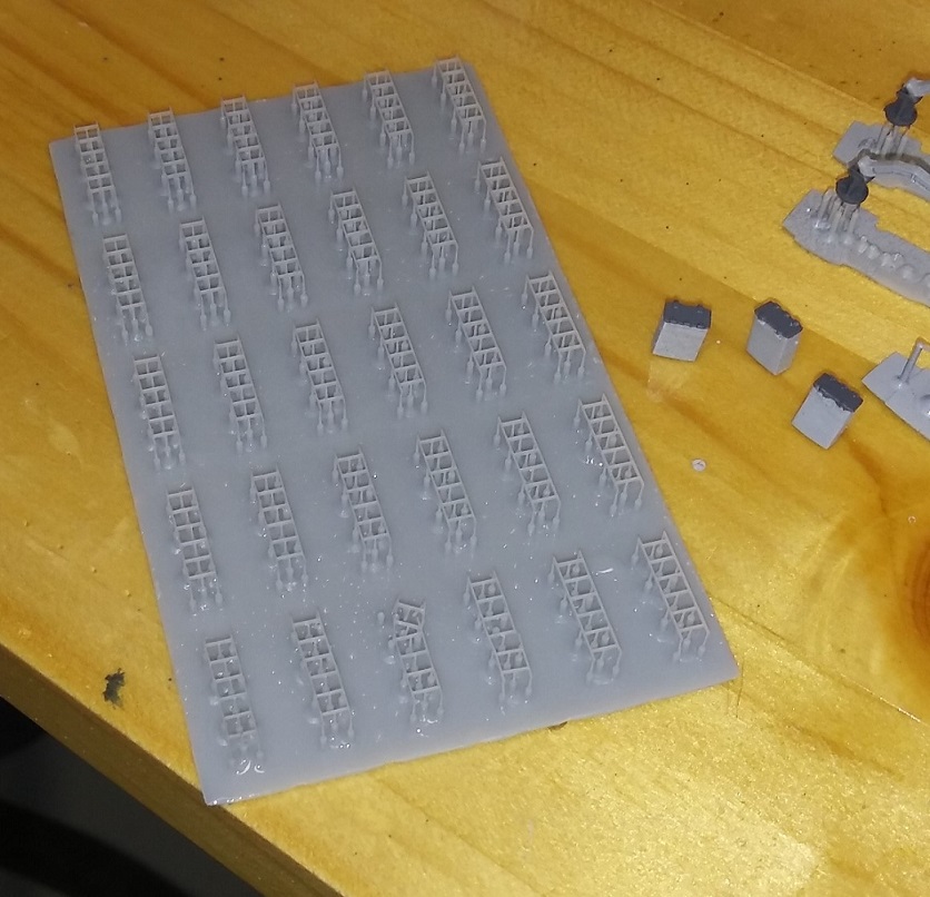

The 2nd printing (different orientation) was also successful:
One is broken, but the others quite useable. So, I've got more than enough to finish the model! This sheet has been painted and I'll do the other sheet tomorrow. So, another part to fill the parts bin!
