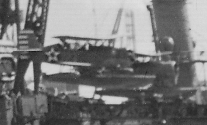

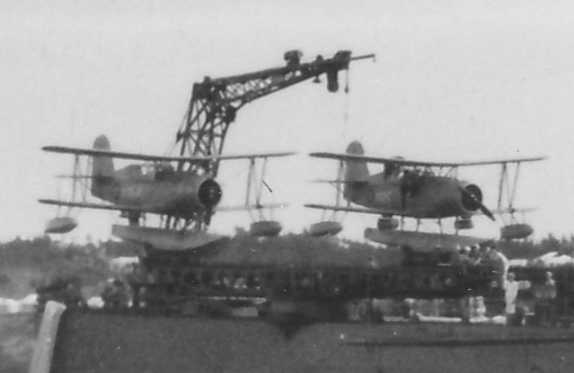

Below are close-up crop views of aircraft;
The fantail of USS BROOKLYN from that same 8 December 1941 "dated" photo that I posted a cropped view of the bridge area.
This view was taken at MINY on 15 February 1942 of USS PORTLAND
This close-crop view of USS VINCENNES aircraft taken at PHNY in May 1942 shows that the aircraft still has markings
USS ARIZONA recovering aircraft in a photo dated 8 September 1941. The aspect angle of this view doesn't allow seeing the unit markings on her aircraft, but the new colors are quite apparent. Additional views of this sequence of photos that can be seen on Navsource, do show aircraft unit markings in black.

Jeff Sharp
- Posts: 1056
Re: Calling all USS Brooklyn/Helena class (CL) fans
They kept the markings but changed the color from white to black. Here are a couple of pics of Portland's planes on 12/7/41.Colosseum wrote: Did this scheme retain the "9-CS-x" markings (which denotes the xth aircraft of VCS-9, etc) or did they switch to something else?
