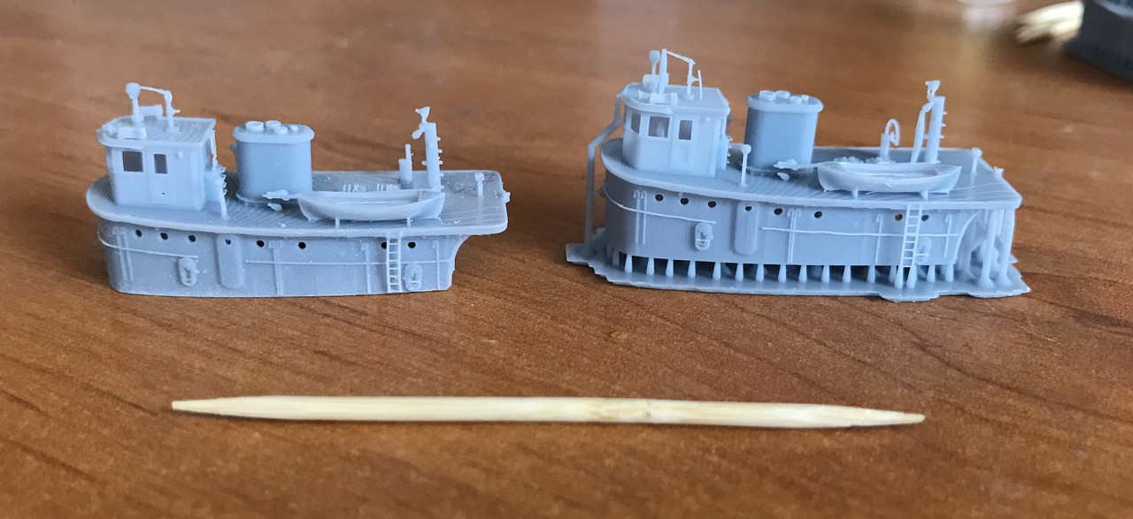

I just received yesterday the new Photon Ultra of Anycubic, there is no LCD screen:
https://www.kickstarter.com/projects/an ... ultra/faqs
This printer is very accurate. I will use it for small parts:
The same file, same resin: Mono X versus Photon Ultra. 50 microns both.
You can see that the pieces are printed thinner due to the lesser diffusion of UV in the resin, cause the beam i think..
It is likely that the dimensions are close to the dimensions of the design. I need to do tests on parts that penetrate.
I will have to take this into account in my design dimensions. Because it is very thin and fragile.
Look at the size of the tubes of the vertical ladder.
Mono X to the left
Photon Ultra:
Mono X:

Wow!! Quite a comparison of the printing abilities of newer/older tech. But, I guess that's the name of the game - nothing ever remains the same, esp. in this arena. Thanks for posting those neat photos!

Yes, the better is the enemy of the good ... looking much better indeed. This make me and my watchmaking equipment looking grossly inandequate :mad_1:
Still, I am not so impressed by how these horizontal rails come out. Making them in wire would be better, but putting the holes into the stanchions would be a challenge, I agree.

For the railing, the design is not intended for this printer (Ultra).
On my drawing the bar is not glued to the wall, but with the Mono X the bar is glued to the wall during printing because of the UV diffusion. With the Ultra the bar is so thin that it is not glued to the wall, which leads to a lack of support and therefore the waviness. The design needs to be revised specifically for this new printer.
Monon X 4K:
Click to enlarge.
1/100 slicing:
1/350 slicing
Pascal

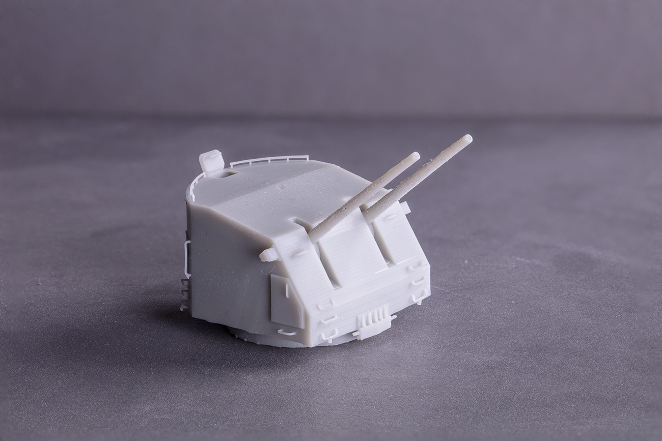

This is my 1:192 Twin 5"38 mount which I had printed for AK and MO. I am very happy with the small hand and foot rails, even all the rungs on the aft of the mount printed fine. The barrels are a separate print and slip in through the hollow barbette and can be adjusted for elevation and are on a common sleeve. To eliminate issues with bottom drooping I inclined the whole unit at 15 degrees along the barrel axis.
The grab irons are tres dinkydau dinky at this scale.
Tom
Post Script, printed in Goopy Grey as opposed to the rapid black, photo in the "raw", no primer.

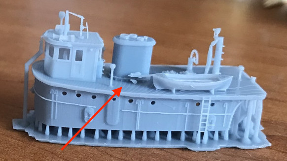

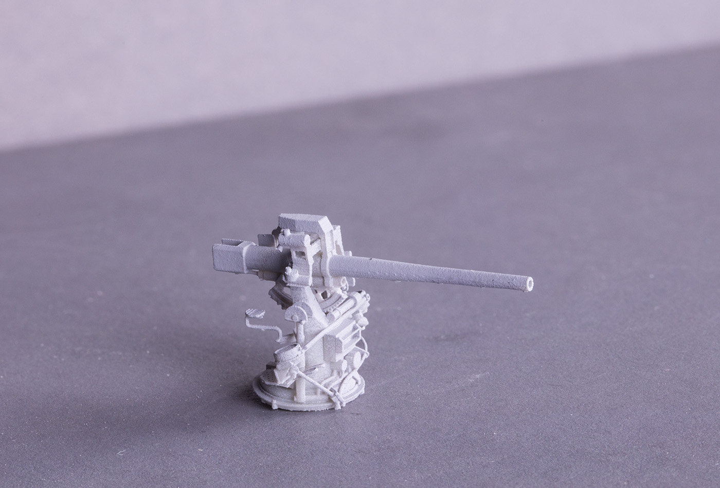

3" 50 printed today, used on various smaller vessels, LST's, AO, DMS, DE's and whatnot allowing some AA capability and replacing the single purpose 4" on the old 4 pipers. In 1:120 scale but I have also printed some in 1:144, which Hank has also used on his T-3 project. This could be printed as one piece but sometimes separately allows the barrel to be easily printed at an angle whereas the chassis prints fine horizontally.
Something weird as these came out as the only ones out of three, which ended up as blobs in the tank. The raft showed some leaving suggesting that there was a problem with the base layers?
