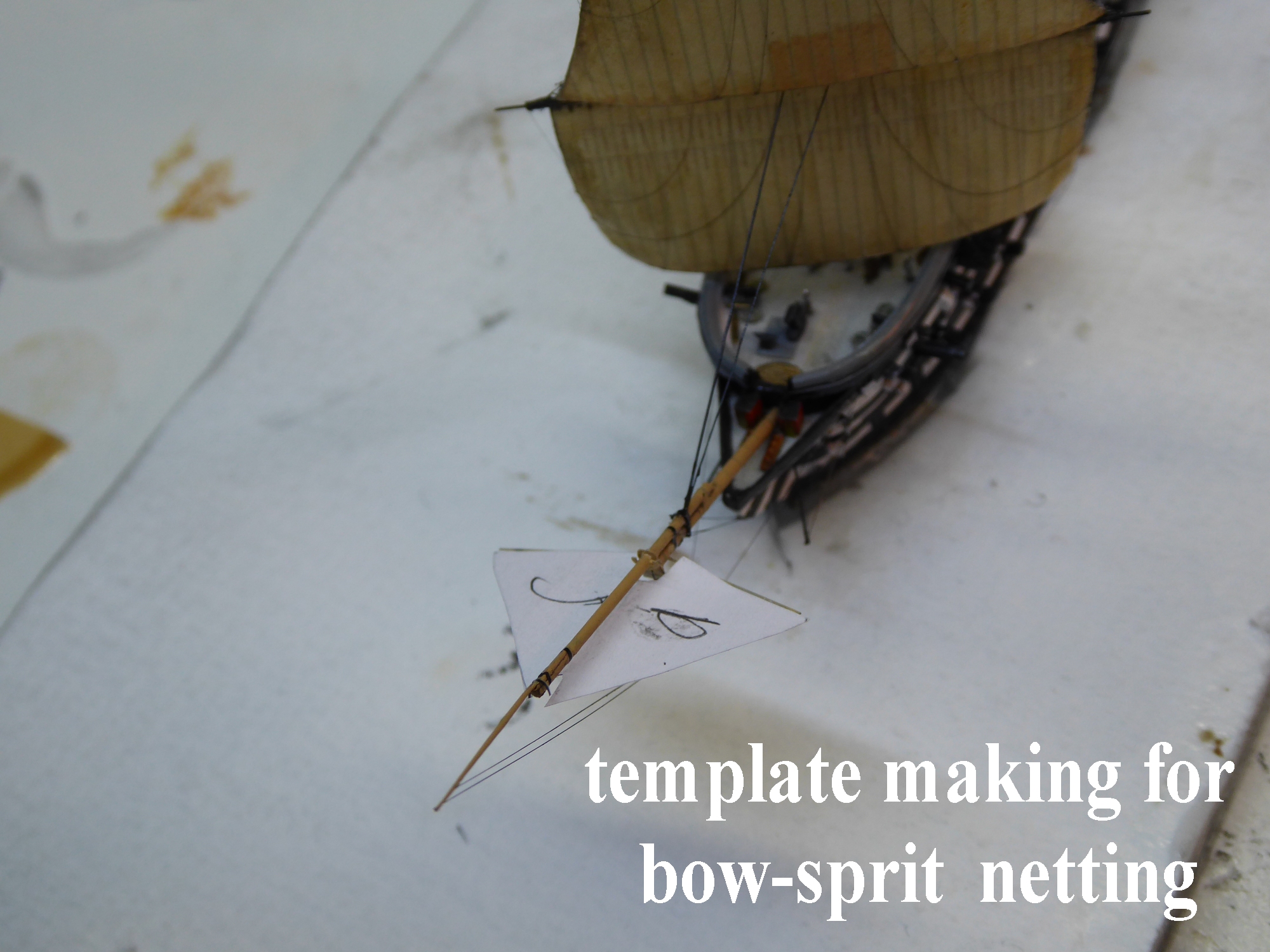

before getting involved with head-sails I tuned my attention to bow-sprit netting. I was using Paint filter mesh
a template was made ( folded paper and test-fitted)
this was eventually cut out
and installed to the vessel
( all that is delicate and fiddly on a partially rigged bow-sprit !!)

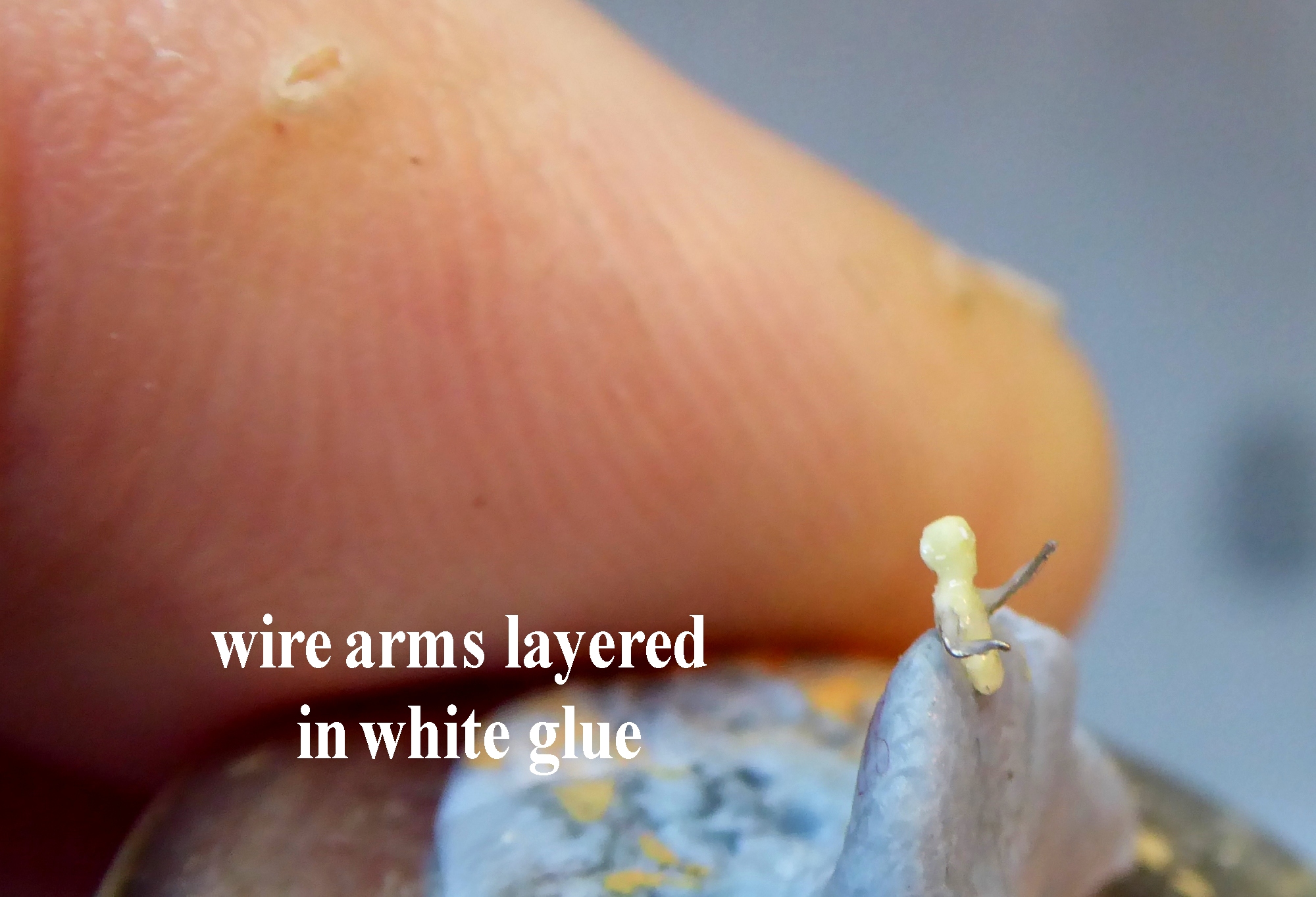

To make this figure head I used a L'Arsenal ( French company ! ) cast 1/350 figure
suitable chopped and altered;
I chopped off the arms ( ouch )
I drilled through the shoulders and made new wire armature arms
then bent the arms and thickened them with thinned white glue;
then made the sickle which was too big
and then made a smaller one...
and then installed it to the figure head
Once installed on sticky varnish, the CA glue and then extend with thinned white glue

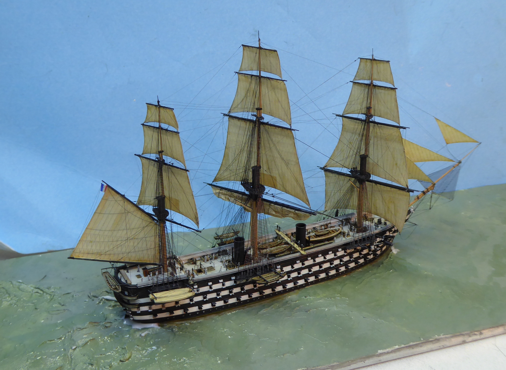

the model is essentially finished aside from from completing the sea-scape and flat-coating;
ero--- leaving me with still plenty of opportunities for a catastrophe...!! :big_grin:

Hello all again.
I am now on the final run--the seascape is well under way ( images soon!)
Interestingly;
I received an e-mail this morning from a ( wood) sailing ship builder in larger scales
( around 1/64 etc)
whose models looked very very good indeed !
He 'chastised' me for the lack of brown rigging and hemp coloured lines etc.
He had a point...( to a certain degree ) :big_grin:
however his models--most fine as they are --
are in full hull dockyard / builders style on brass finials.
They are beautifully built--but also somewhat ..errr... sterile.
now (....my personal opinion and hence disclaimer!)
I feel that often the ' correct' colours in small scales can often look
overpowering to the sum total of a model
(-maybe even slightly -err ....garish...)
I cite also small scale WW2 warships that have ' white' signal lines
...whilst undoubtedly correct-- -- seem to glare...
I put it to him that my ship was around 11 x smaller,
--and I was,.... in effect
.... trying to produce a 3-D atmospheric painting.
and as such-( in my view ) -
against a light background( like sky !! )
-- all rigging appears 'black.' ( as was much of it was the tarred rigging !)
Kind of as herewith in images below;-
But it got me thinking....
- what are the thoughts on this from you fellow modellers?

That has been a discussion raging for several years now in various fora - since people discovered that 'Stockholm' (i.e. pine) tar is not the same as coal-tar. Most people today are not familiar with pine-tar, as it is not used on ships anymore, except in a restoration or artisanal context (particularly in northern Europe).
Coal-tar became available in large quantities from around the mid-1840s, when cities became lit by gas produced by coking coal. As a waste product it was a lot cheaper than pine-tar from Scandinavia, the Baltics or Russia. I gather the availability for maritime use is related to the spread of gas-lighting in the various countries, Britain maing a start here. It would be worthwhile researching the availability of and use by the French navy of coal-tar in the mid- to late 1850s.
From a modelling point of view, there are various aspects to consider:
- both types of tar, tend to weather rather quickly, turning pine-tar into a dull greyish brown and coal-tar into a dull dark grey. After a few month at sea and unless being re-tarred the aspects tend to converge according to what I have observed.
- at a distance, rigging tends to look dark regardless, whether its body-colour is dark brown or black; the eye cannot process the high contrast of the dark rigging against the sky and adjusts more to give definition to the sky than to the narrow lines of rigging.
I have considered this aspect in my budding sailing project and think that I will go for either an burnt umbra-wash on black or black toned down with some burnt umbra. However, this is for a scale about four times bigger (1/160 vs. 1/700).
In summary, I would not give these comments too much weight.
