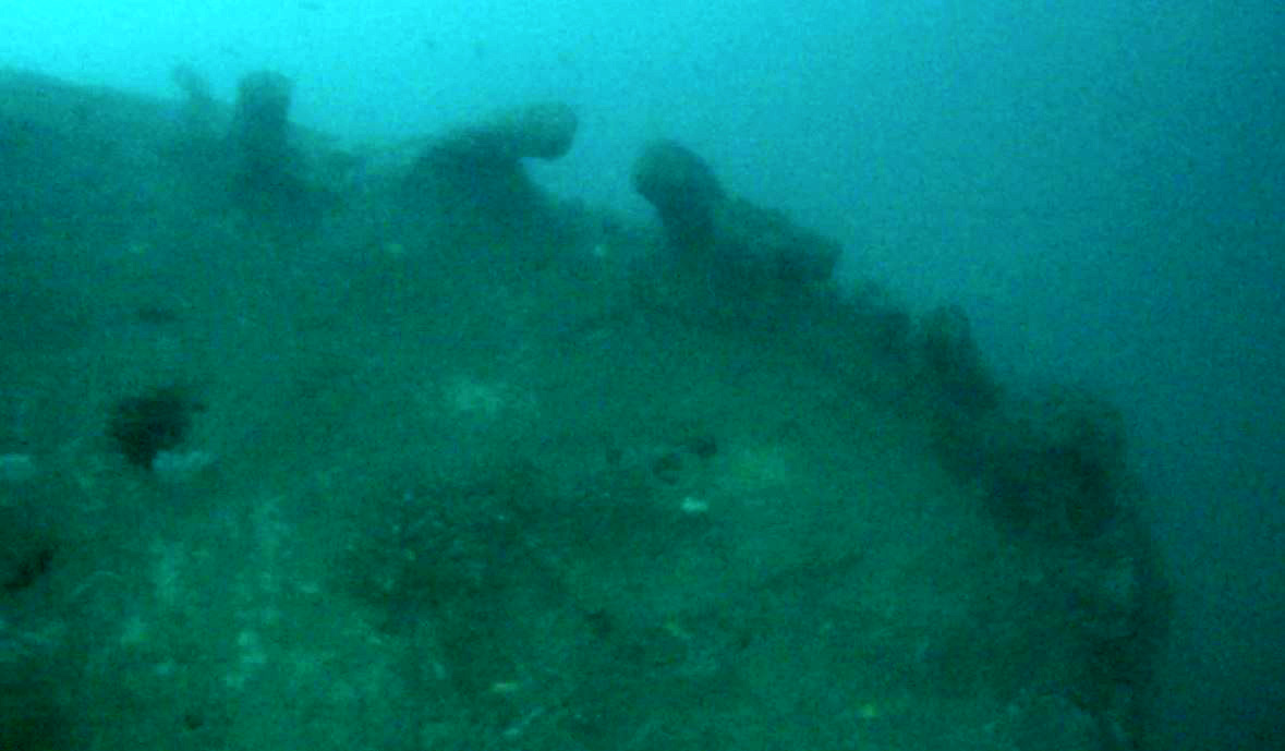

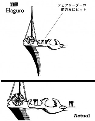

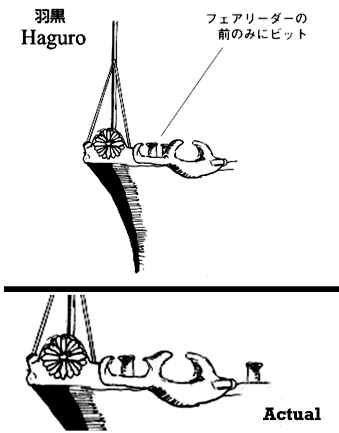

Gents,
Was just going through some old video footage of the wreck of Haguro and noticed an ever so slight difference to her upper bow when compared to the image Dan K (Hi Dan!) posted a few pages back showing drawings of all four cruisers' upper bow; that is there is a single bollard fore and aft of the fairlead on Haguro, not just to the fore.
No big deal in the grand scheme of things by any means, but I know some of you modeler folks are real sticklers for detail.
The upper image in 'schematic' below is from the previous drawing, while the lower one is modified to show how it actually looks. The pic is a grab from that early (non HD) footage showing her port bow edge, just to 'back it up'.
- Posts: 9063
Re: Calling all IJN Myoko Class Fans!
Great image, Kevin. Hard to argue with that.

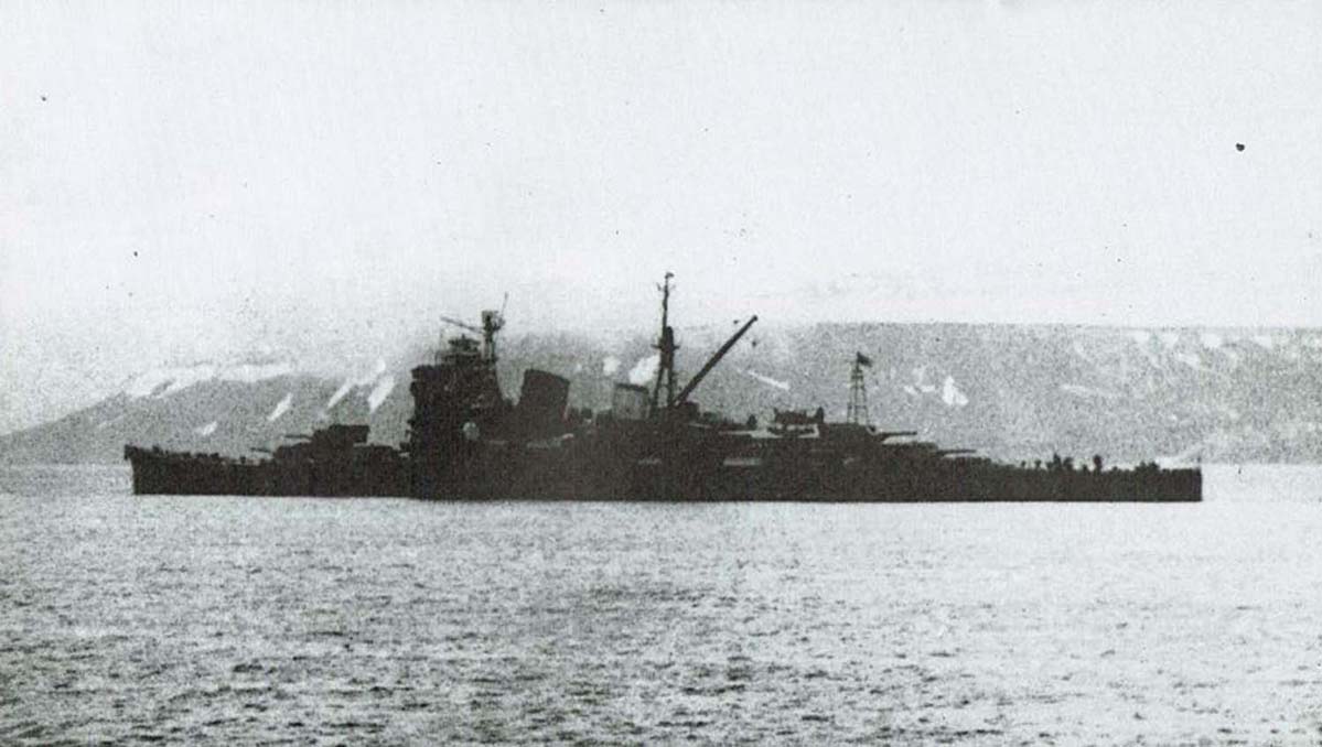

Just a bit of further clarification required. I found the following picture saved in my files, I believe I downloaded it from this site but can't find the thread. I have it named "Nachi_June_1943_Aleutians".
So is the "June" a mistake since the picture clearly shows an air search radar? Is the location a mistake? I'm pretty sure it is Nachi because the white aft funnel is a distinctive feature that I wanted to model when I asked about this in the past (again, can't find the thread). Was this already painted like that at Komandorski? What about the main director on top of the bridge, also white?
Vlad
- Posts: 9063
Well, it's not entirely clear, but, per LaCroix and Welles, when she was repaired at Yokosuka in April-May 1943 following the Battle of the Komandorski Islands, she received a Type 21 radar. That unit was apparently exchanged for a more sophisticated version in her next refit at Sasebo in November. At least, that's how I read it.
All the Japanese references concur that this photo is taken in June, 1943.
