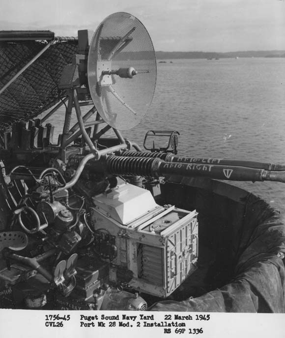

Ray D. Bean's photo disc #98 shows a shot of Monterey late war, with radar on the aft most 40mm mounts P&S. The vet who was a loader on the starboard 40mm mount #9 told me that it made for a wild ride, never knew where the mount was going to move. He said that He had to hold on for dear life because it was so fast. I didn't pick this out till after he told me about it.

Bob's e-mail tickled my memory a bit; this is one of the few photos CVL I found in the Pearl Harbor Navy Yard files... but it's from (PSNS) Puget Sound Navy Yard following the completion of her overhaul there. I'd completely forgotten I had it... I was looking to see if I had any textual records for Monterey's overhaul from the PSNS files. I do not... just a list of approved alterations. Perhaps this will be of some help for those building late-war CVLs; I sent it on to Navsource as well.

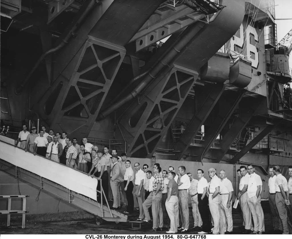

I found this photo of USS MONTEREY (CVL-26) taken during August 1954 while she was a training carrier. I thought it may help seeing how this area was "put together".

Nice find Rick! We could have used those platform support images when we were doing the CVL-22 kit!
