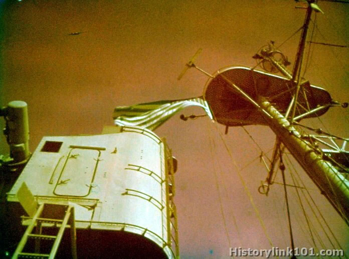

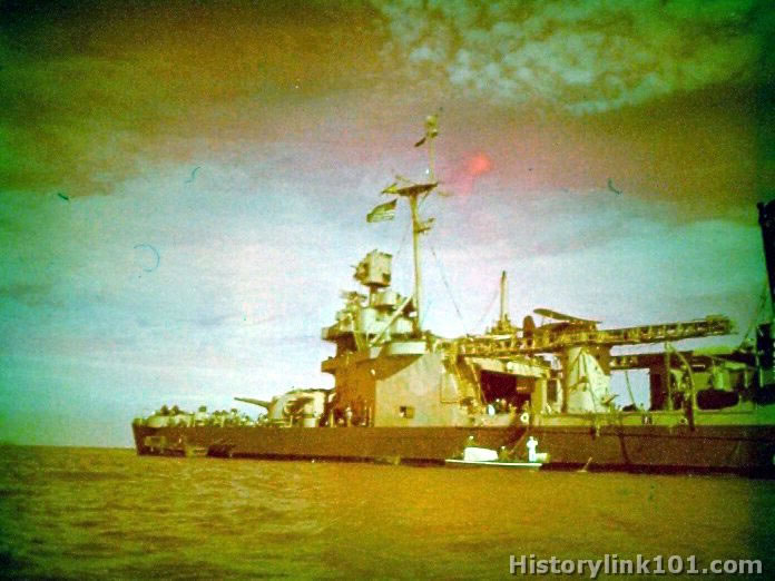

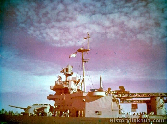

Don't know how much color shift there was here and you can't see the deck but...
Russ
