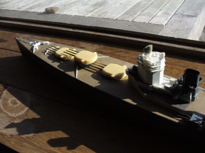

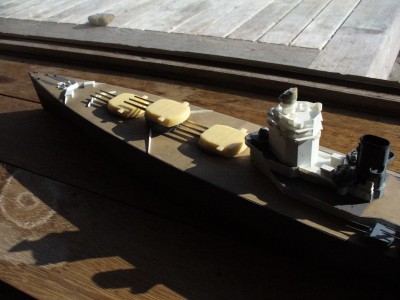

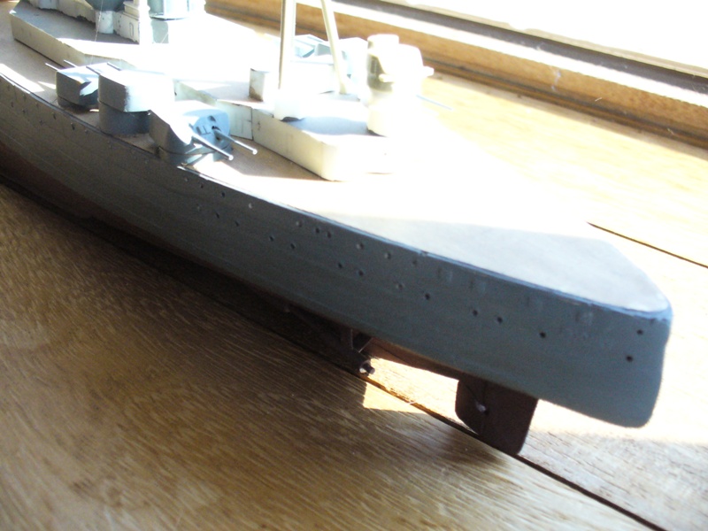

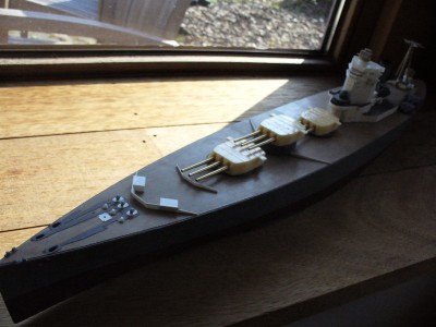

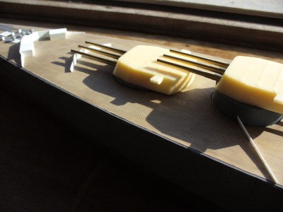

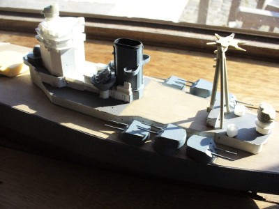

Hi Everyone,
Some years ago I started a scratch-built of HMS Rodney in May 1941 config. Last weekend my good friend Jan gave me the custom resin castings he made for me of the Rodneys 16" turrets, I had made a master some months ago. Today I had some time to clean them up and fit the brass guns, which I had received from the late Steve Nuttall, a few months before his untimely death.
Having the main and secondary armament in place seems a good moment to unveil this project of mine, as all the major parts are now there. But as you all know, there is still along way to go with detailing, first task will be to construct the 4.7" HA QF guns. Thanks to John Lambert I have good drawings of those now.
Well, enjoy the picures! Unfortunately the lighting conditions were not ideal and my camera is not the best either, in due time I hope to make some better ones. I detailed the hull with all the shell plates according to the NMM plans.
