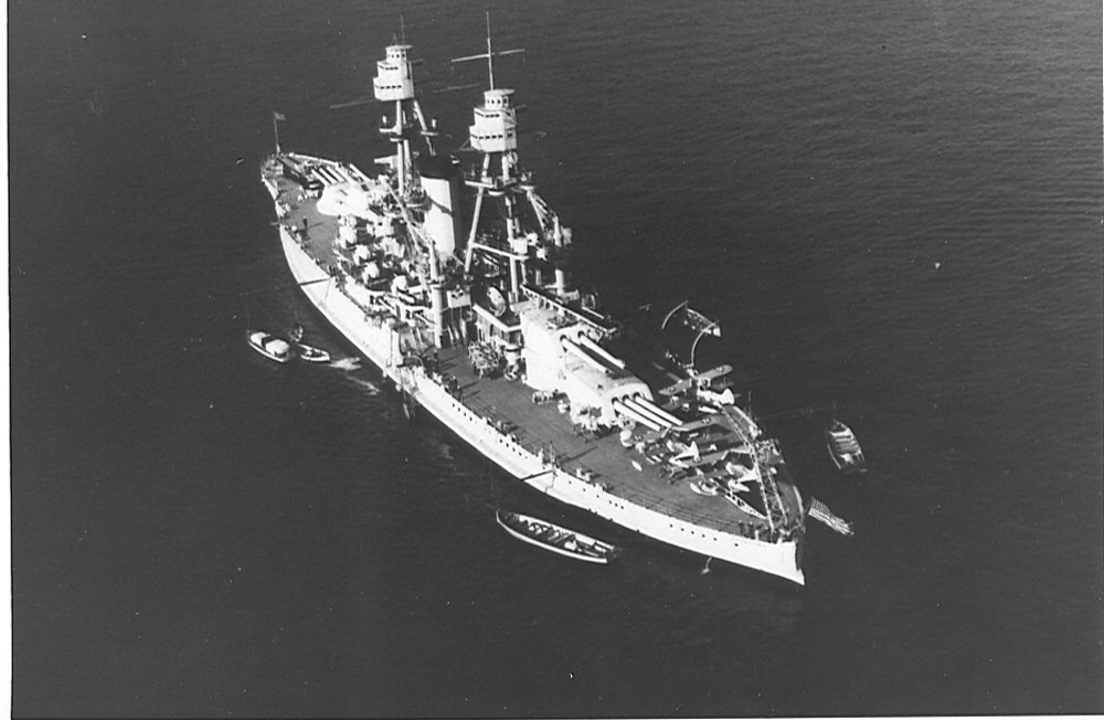

There's an opening in the back.....a movie projection booth similar to Arizona's, just up higher?
Now that's something I had not considered. Possibly a good answer - the opening in the back might possibly be for a projector lens. That's certainly a possibility given the size of movie (16mm?) projectors of the day.

Looks like its built onto the boat crane kingpost. And there's a railing around the top. :wave_1:

Whatever it is, it was installed between May 1934 and April 1935.
The second image was from a poor photo, so details are not great. Every other PENNSYLVANIA image I have dating in and after 1935 up to before the war shows the starboard side. There is not a similar "box" room on the starboard side.

I'm going with movie projector booth. Good find!

Rick:
Thanks so much for the 2 photos - the first one clears up what the port side bulkhead looks like - I haven't seen that one before. The second photo is a much clearer rendition of the "booth"!!

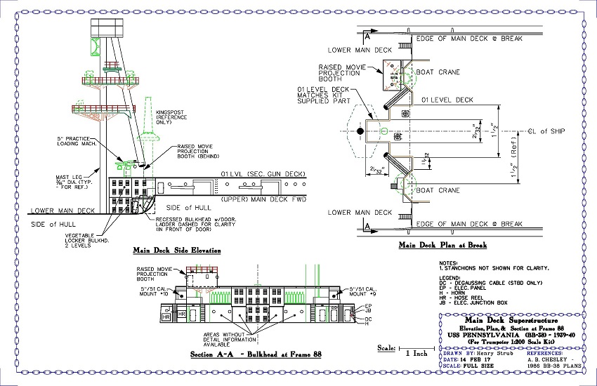

Thanks for the Kudos! It was an interesting discovery and subsequent investigation. Here's my current CAD rendering of the main deck bulkhead @ Frame 88 of PENNSYLVANIA in late 30's/early 40's based on my current information:
I based the size of the booth on "guesstimates" from the photos and once I have a scaled, full size sheet printed out of the OKLAHOMA's Plan, I'll make adjustments as needed. The height I took from the similar booth on NEW JERSEY aft of Turret #3.
Hope this helps all the PENNSY modelers out there. :big_grin:

BB62vet
Posts: 3162
Location: Mocksville, NC
Re: Something we've all missed on BB-38 - Until Now!
Post by BB62vet »
DavidP wrote:
don't you mean the late 30's early 40's?
Thanks, David - Indeed, that is correct. I've edited my post accordingly. Nice catch, by the way!!

Thanks, helps out greatly (didn't know there were 3 projector openings!!!). I'll need to modify my CAD drawing, but that's minor.
