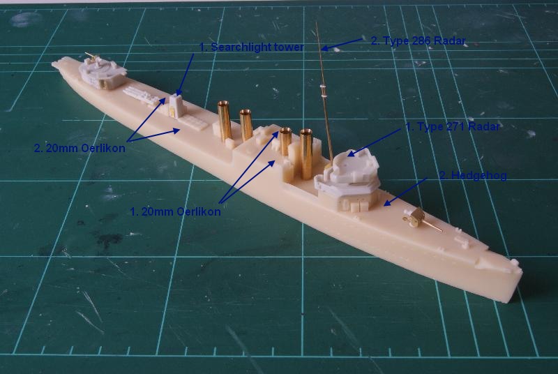

I start building WEMs HMS Montgomery. I would like to build her in a 1941 fit (approx. September 1941, 4th Escort Group based at Greenock), with the modifications made between April and July 1941 at Barrows:
According to naval-history.net, the following modifications were made:
Pt. 1
� Type 271 radar installed
� Torpedo tubes replaced by a British triple mount
� 20mm Oerlikons in place of 4in guns
� what kind of searchlight tower does she wear at that time, US or British style?
If these are all modifications at that time, I�m not sure about the following points. Does she carry them at the same time or were they replaced or resp. installed after the mod. at Barrows?!
Pt. 2
� Type 268 radar (should be replaced by Type 271?)
� 20mm Oerlikons on port and starboard on main deck platforms
� Hedgehog
If she did not carry the 20mm on port and stb., are there other installations at the same position?
Mmhh, a lot of questions but I hope I can get some more information about Montgomerys look during the timeframe September 1941. Next to this all other information about HMS Montgomery are appreciated!
TIA

Christian Bruer
Posts: 574
Joined: Tue Nov 21, 2006 7:44 am
Location: Germany
Re: Calling all USS Wickes and Clemson class Four Piper fans
Post by Christian Bruer »
Hi Gopher,
thanx for fixing the access to these fine photo :heh:
Yep, I know this, it was taken early 1941 before she was modified at Barrows. I have searched a lot and there are some photos on navsource and also in the "WP book Flushdeckers" but not a detailed one for the time period September 1941!
Thanx again :wave_1:

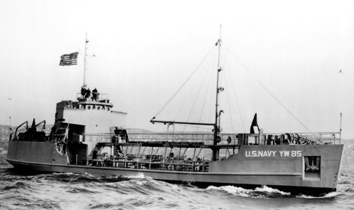

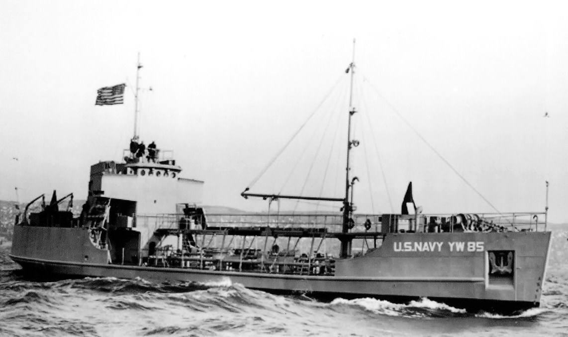

A YW was a self-propelled or non-self-propelled water barge. Basically a tanker for water.
I see no listing for YW-94.
The Naval Ship Register does not indicate a YW-94. From YW-83 on, YW's were purpose built. Prior to that, some are indicated as conversions.
This is a picture of YW-85

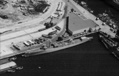

Navsource does indicate that two destoyers were converted. This is the only picure of what that looked like, YW-56 Moosehead ex Turner (DD-259)
