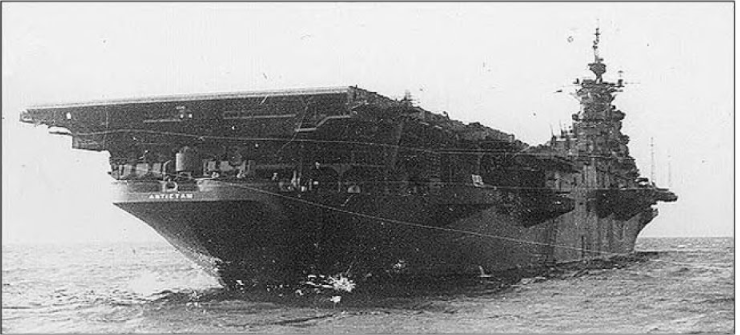

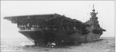

After spouting off that Antietam didnt have the starboard midship 40mm mounts, I prove myself wrong.
I have no clue when or where this was taken, obviously after war with the name being painted.
Still in MS21.
So are the Bennington & Shang the only wartime delivery ships that didnt get the midship 40 mm mounts?
Still in MS21.

I really appreciate the input. Looks like we can midships triple quad question to rest.
So,,,,,
Back to my orig question, do I use the Trumpy Tico for my 1/700 Atietam build.
So,,,,,

Re: Calling all WWII Essex Class Carrier Fans!
It looks like so.raggs wrote:Back to my orig question, do I use the Trumpy Tico for my 1/700 Atietam build.
You're actually paying for their time to go to the archives, get a good set up, and record the footage. While I can empathize with the desire to get all of our research for free, not everyone can work for free. I used to think that the $80 I spent on a Maryland Silver plans book was over priced, but after researching myself and having to deal with the microfilm, and realizing that that book probably took a couple of weeks of going through microfilm, then paying the reproduction costs for each printed page that gets turned into a page of the book, then the time to assemble all of that and get it printed and bound..... there's a reason that stuff costs money.anj4de wrote:Critical Past asks 200$ for those 2min of footage...!![]()
Not sure if this is the current rate for public domain material?
Hancock received her outboards at Pearl during her repair. (Had she hit one of the west coast yards she would most likely have had her flightdeck extended to full length.) Also, I believe that neither Antietam nor Boxer stopped at a west coast yard en route west. But both were at Pearl. Of course, that doesn't say where the sponsons were fabricated. But it would be easier to fabricate on site than to ship the parts pre-fabbed.Tracy White wrote:The sponsons themselves were manufactured at the west coast yards for sure, never seen photos of them being built at Pearl Harbor or forward of the west coast, although I haven't seen anything that shows they weren't.

I've been going through Hancock's departure report tonight and Pearl Harbor Navy Yard was ordered to fabricate Hancock's.

Antietam stopped at San Diego from June 10-13 1945 after passing thru the canal. She hit Pearl on June 19th.
I found a couple diary entries on Google books that on July 18th Antietam had gunnery practice out of Pearl.
Thats a month from when she arrived, ample time to get them installed given the grueling pace of repair work.

Checked out her War Diaries on Fold3 and on June 22 she reports "Entered No. 4 Graving Dock, Navy Yard, for availability in connection with increase to 40mm armament." She reports "Navy Yard, Pearl Harbor Availability" from June 23 - July 14th but doesn't report when she left dry dock. She fueled up on the 15th, so certainly before then.
