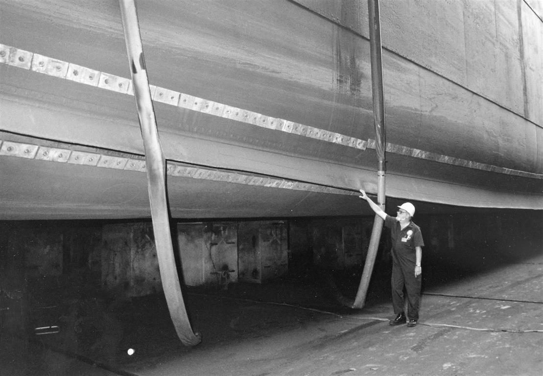

I will agree with the comment made that Jason's hard transition from side to bottom could probably use some smoothing. Even though I've seen NEW JERSEY in drydock (1969) I would not be the one to comment as that was a LONG time ago and I think the following pictures illustrate the conditions better than I could describe.
The first photo is of NEW JERSEY in the 80's in LBeach after her stbd bilge keel was repaired (along with other hull work) - that is my acquaintance Richard Landgraff in the photo - he's worked on all the IOWA class thru the years.

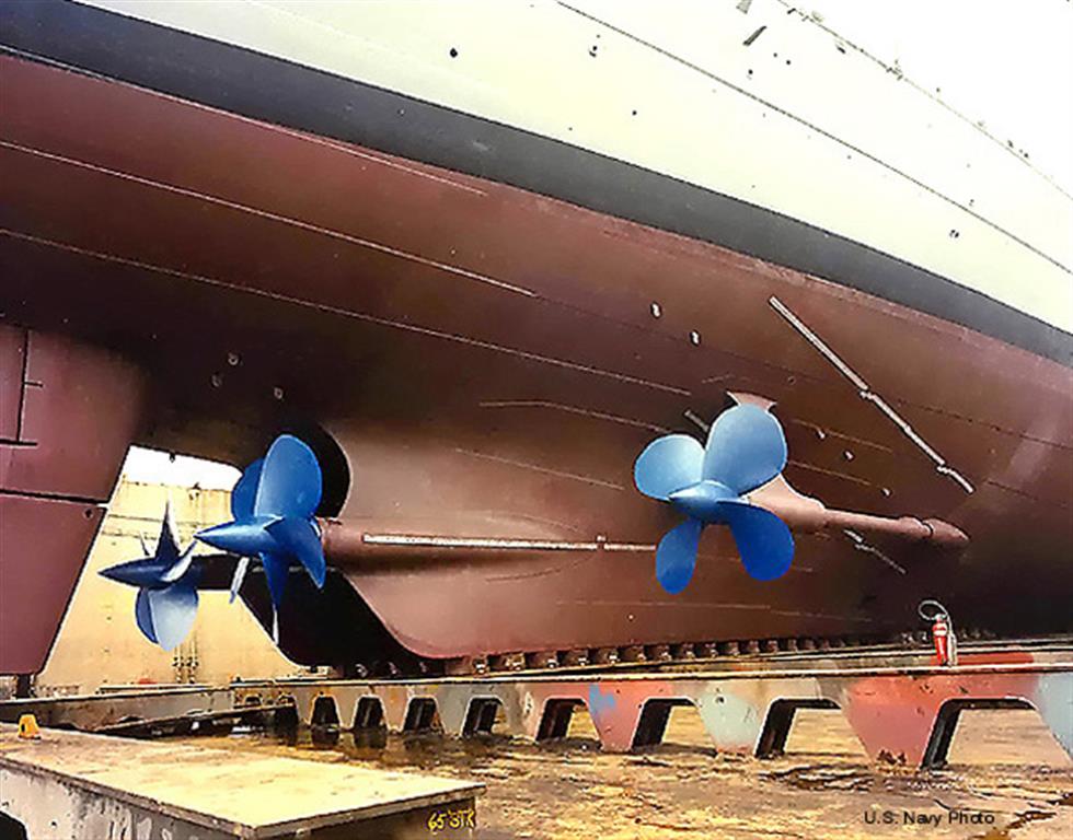

The next photo is of WISCONSIN in drydock in the 80's and shows the curvature of the hull in transition.

Interesting to note what appear to be vortex generators in the aft hull near the propeller areas. Most likely not a WWII feature. Good view of the plating lines as well. The Haynes model onboard Missouri did this area well.

I wonder if the why shape at the stern is just due to the dishing in of the shell plate? Note the openings at the bottom, sea chests or more likely access for maintance?

The photo of Dick Landgraff is interesting and is only 1 of a series, I was there with him when these photo were taken, I actually did the drawings for the repair shipalt to the New Jersey's bilge keels. They were curled under on the edges while transiting the Panama canal in 1968. This was causing a bit of cavitation off of the trailing edges of the keels and this in turn was causing excessive hull erosion in the effected areas of the shell plating. The Bilge Keels were actually filled with balsa wood and a preservative coating.

Looking at a pre launch photo of Iowa, the several items I thought might be a vortex generator ar present and are padeyes, one would guess from the location to assist in mounting and dismounting the propellers.
Not sure if the stern knuckle is best added with putty or sanded down. The slight centerline knuckle at the sternpost is visible in waterline photos as carrying somewhat above that point. For me I will probably add it, though the hull is already painted, boot top and all...

The plates you refer to (I think) are cathodic corrosion coupons if I'm not mistaken. The row on the centerline of the inboard shaft on the WISCONSIN photo was installed in the 80's. The diagonal row above the shafts I'm not sure about, may be coupons, as well.

Not talking about the anti corrosion plates attached as pads, but the protruding plates at right angles to the hull. Inspection of a closer photo shows these to be padeyes, which are located just above the propellers, and might be use in hoisting the props for maintenance.

I would agree that the small protrusions at 90 deg. above the shafts are padeyes used for install/removal of props/shafts, etc.

There are several padeyes welded to the hull for assisting with the removal of the props and shafts for their periodic maintenance. It should also be noted that the lifting padeyes were welded in place where the heavy internal stringers were located inside the hull. The shell plating by itself was not heavy enough to withstand the loading that was put on these padeyes.
The Plate under these ships sterns are for 2 things. One being hydrodynamics for the flow of water from the twin keels and rudders and also as a building feature, these plates were fabricated and placed on the shipways and then the plates above were erected and riveted in place. This made construction a bit easier. However this plate did not extend to the main deck, it ends at the 'Y' and the stern plates intersects at this point.
The configuration of the sacrificial cathodic protection anodes changed several time over the life of these ships and also differed from ship to ship in this class. 3 of the 4 ships of this class had impressed current cathodic protection systems installed. The design of this system was tested on hulls that I provided to Naval Research Labs. The interesting thing on this project is that the ship that we collected our data from was the New Jersey BB-62 which did not get the system installed in her before she was inactivated.
