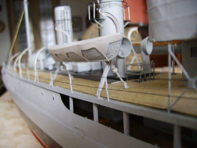

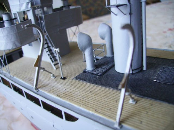

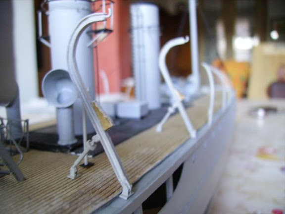

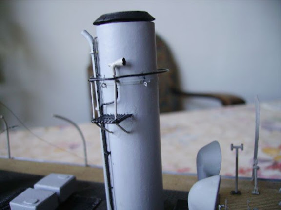

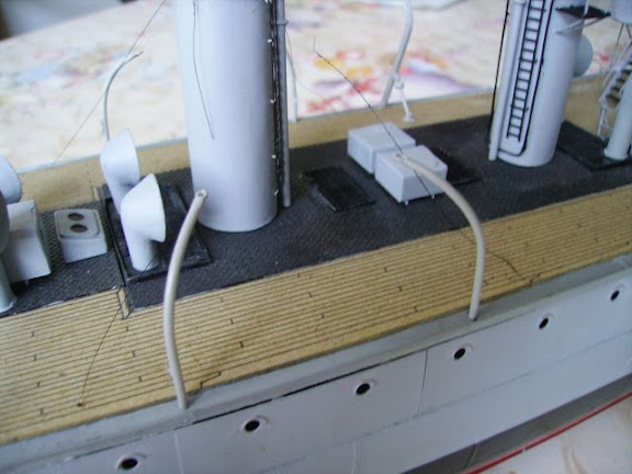

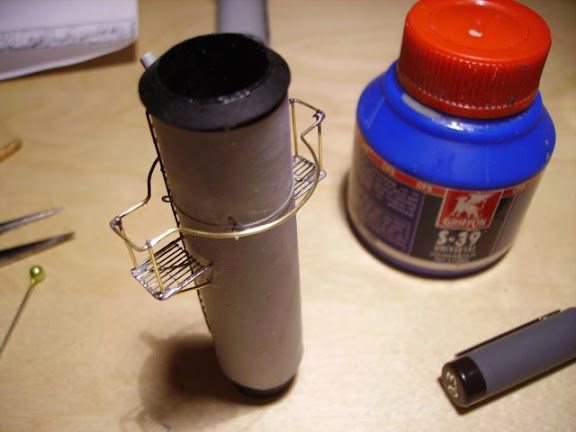

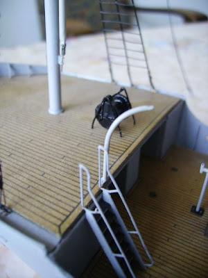

It's been a long time , but I was involved in another project for a few months .
Hereby what I certainly find annoying in scratchbuilding a model , all those little odds & bits that have to be done to get a good looking model :

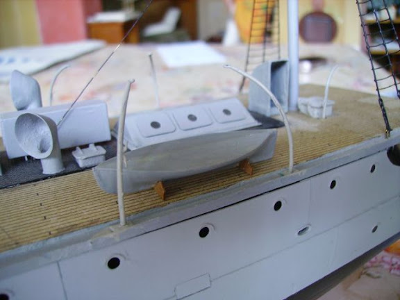

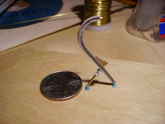

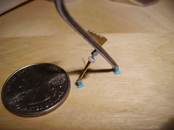

the 27 ft whaler's davits , made out of cardboard , the elevating gear is made from brass rod & tube , with some paper added on , the coin is a US "quarter" :
the davits on the port side :
the other davits , two pairs for the motor boats :
and two pairs for the little "Julia" dinghies :
building up the front funnel rigging :
the funnel rigging being painted & the two steam whistles added , with their piping :
four stove pipes had to be built :
one on the f'c'stle deck :
one coming from the PO mess , in front of the hatch near the CO's cabin :
a third one on the boat's deck , near the port whaler davit :

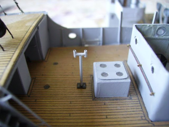

the fourth one comes on the after main deck , exhausting the gasses from the Wardroom stove , no picture ...

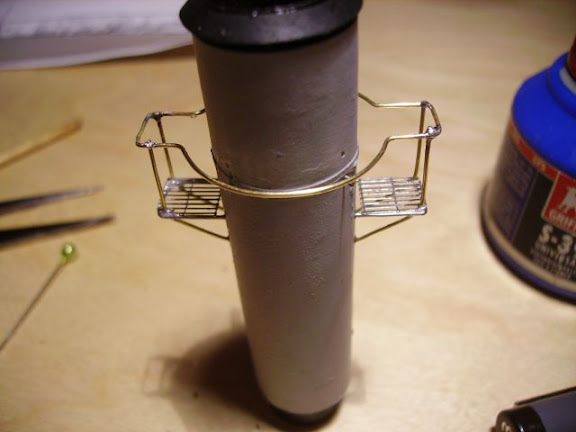

Crow's nest under construction :

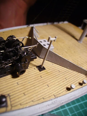

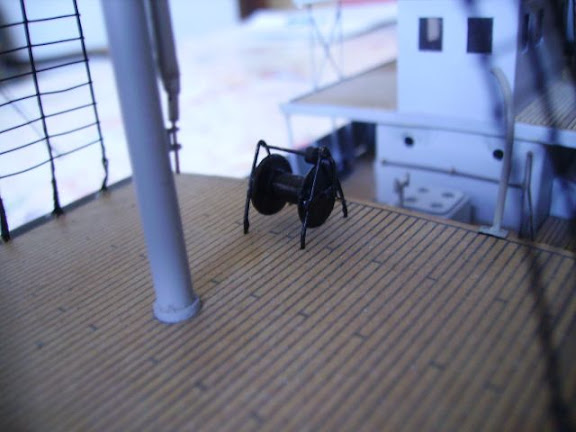

the winch to be used in conjunction with the boom on the front mast , to load & unload heavy cargo from under the PO mess :
stair from the f'c'stle deck to the main deck , ammunition davit and the same winch as above :

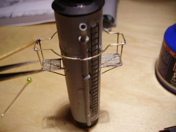

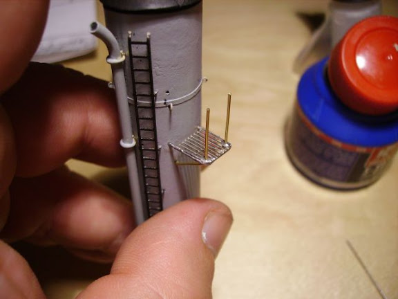

the after funnel :

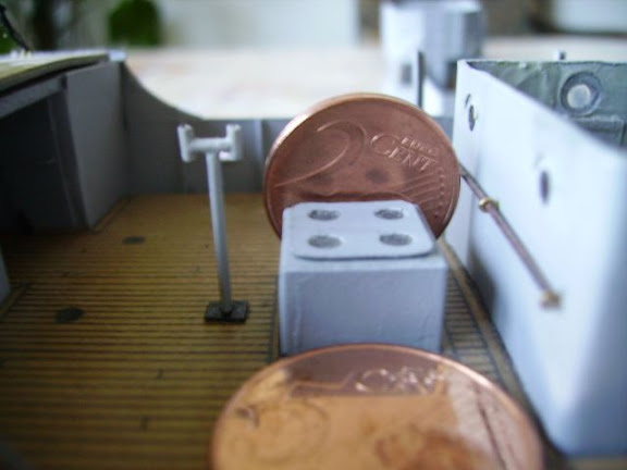

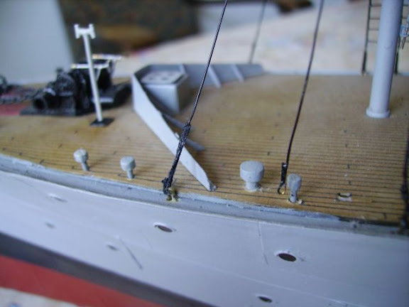

four little ventilators on the f'c'stle deck , to exhaust air from the washplaces , WC , sailor's mess :

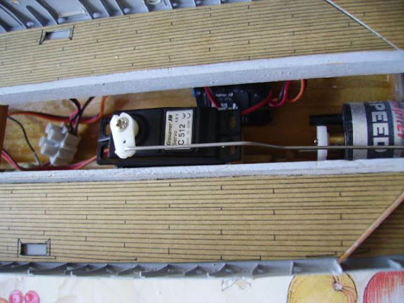

the rudder servo :
That's it for today !
Regards ,
Laurent

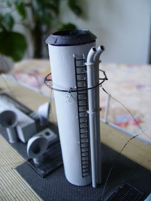

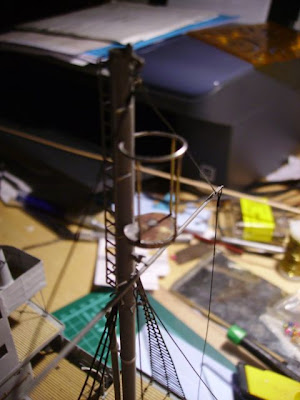

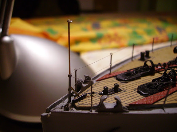

I'm building at a really slow pace now , as I have some other project , nothing to do with ships but with 1/72 planes : I intend to scratchbuild a Boeing 307 , the first pressurized cabin plane , a civilian plane based on the Boeing 299 , which led to the B-17 , using an "Academy" B-17-G kit , using the wings & tail ...

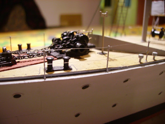

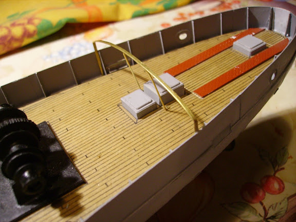

For now , what happened on "Zinnia" ( very little )

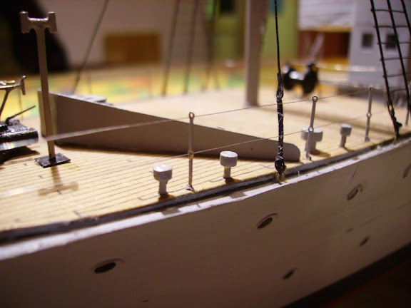

the f'c'stle deck got his stanchions & wire , the stanchions are brass PE parts , the 0,1 mm thick wire is out of aluminium :
the front jackstaff is on his place ( 0,5 mm thick brass wire ) :
the towing beam on the after deck , made out of a 1mm brass tube , being flattened with pliers , the support is made with 0,5 mm brass wire , the whole has been glued with CA glue
I'm finishing for now the last motorboat , and will fit shortly all the boats ( 6 of them ) under their davits .
Regards ,

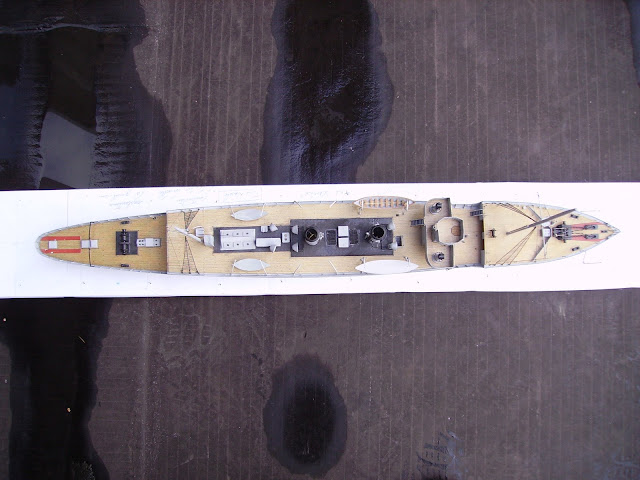

the further progress :
I enhanced the look of one of the two 27 ft whalers , by adding gratings on the bottom , replacing all the sitting planks , & add a "mahogany" cardboard margin plank :
I also made some blocks , out of cardboard either
the port & stbd lights are on place :

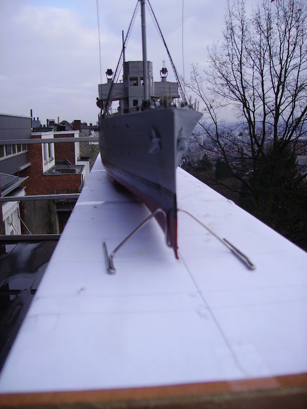

I put the whole superstructure on a letter weighing machine
it weights 110 grams :
the coaling hatches are glued on :
During the war , the RN added some protection to the chart room sliding doors . I presume those protection were made out of wood , painted grey
I covered the starboard whaler with its protection tarpaulin :

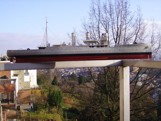

So , I may consider now this model finished at 90 % , I still have to finish those two motor boats , put them on their cradles , fit the whole rigging around all the boats , and it'll be done ...
I'm preparing a complete costs evaluation , RC rigging included , you'll get this at the end of the year .
Regards ,
Laurent

Now , I got some guys on other forums wanting more pictures of the whole model , here they are :
Regards ,
laurent
