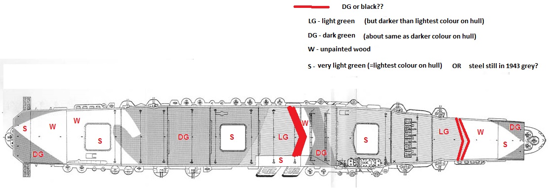

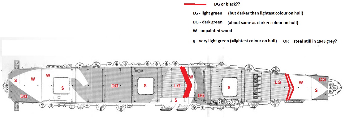

Dan, thank you very much for the video and drawing.
I want to draw attention to some points comparing the video to your latest drawing. At 2.10 you can clearly see there is a "double chevron" where the colour changes just forward of the fore 5" mounts. There also seems to be another dark line behind the bridge, so that chevron also seems to be dark-light-dark. And the middle elevator seems to be light, not just the forward. The first two of these features are also visible in the bombing photos. Also at 2.10 in the video, you can see the demarcation line between the wood section and steel section at the front of the flight deck. The colours look the same in black and white but it would be impossible to tell if the wood is painted, or if the steel is painted the same colour as the wood.
Based on that my interpretation is this:
Vlad
Posts: 9042
Re: Calling all IJN Shokaku-class fans
Post by Dan K »
Most of the early color sources, such as Maru Special #6 , and even the Tamiya 1/700 instructions, show original grey in some areas on the flight deck, so I think your interpertation is pretty good.
