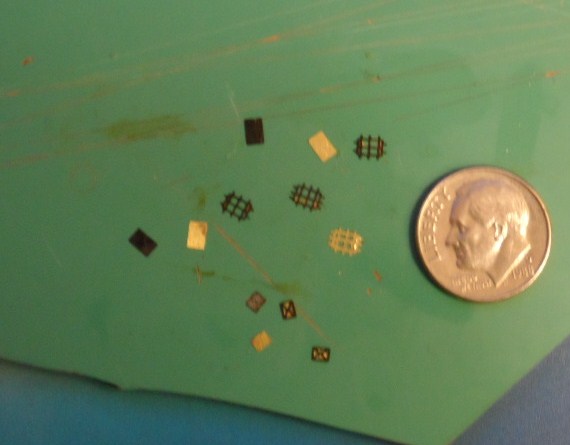

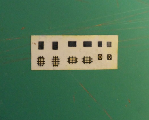

Photo etching isnt all that hard, its just about being patient. Did these earlier, but forgot to fill in the margins between pieces and make attachment points. This was a test run. Just these couple of pieces takes the same amount of time to do a full sheet.
PE parts still on sticker backing.
PE off sticker backing. Longer ferric chloride soak would have been better.

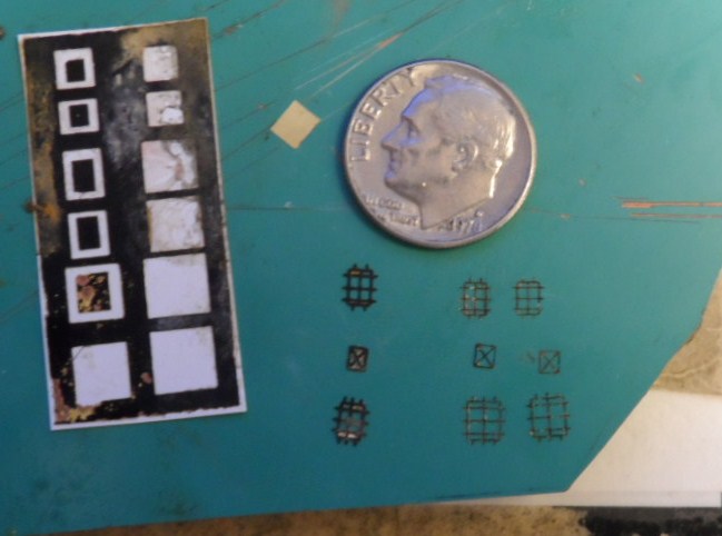

Round Two:
Learning from my test run seems to have been successful. Under the dime, for scale purposes, the pieces on the left are from my test and the ones on the right are my working prototypes. Now to figure out just what I want to detail and create a larger sheet of PE parts.

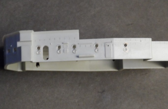

On another note, I wanted to share what I did for the porthole covers to add detail for those that dont go the uber PE detail sets. I used a 3/32 dremel engraving cutter chucked between thumb and index finger to make the concave section of the cover. I just spun the cutter until I was happy with the look.
