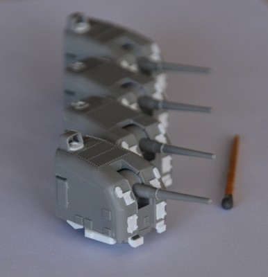

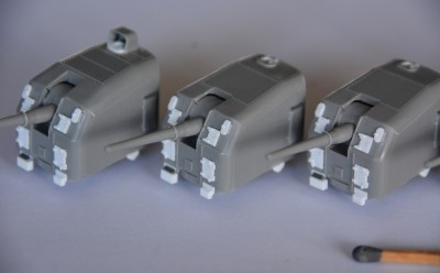

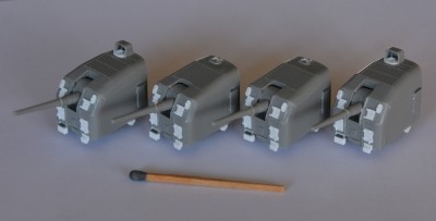

Posted: Thu Dec 31, 2020 9:02 am
by Willie
Hi again, folks.
While I think on how to make the b****y blast bags, I thought I could star detailing the many elements that will suffer no damage while handling the mounts for the construction of the said blast bags.
I started with the hatches on mounts 2 and 3. What you are given in the kit is correct but pretty basic, but it can be easily improved. First I made the inner elements with a scrap of plastic strip, two drills and a file.
I completed the set with some stretched sprue, and after it dried, I refined it with fine sandpaper:
Then I made the two hatches for mounts 1 and 4 that you are not given, following the same process:
The mounts captain�s cupola is basically right, and big enough to be refined to give it the correct shape:
Once the elements are set in place, they are like this:
So after adding some other basic elements, the mounts are like this at the moment, waiting to dry completly and be further detailed:
The next thing will be to detail the cupola and to make some other other easy elements in the front armor, unless I can start directly with the blast bags.
In the meanwhile, the mounts are starting to get some Fletcher shape.
I hope you like them, and very best regards from Spain,
Willie.[/size]
