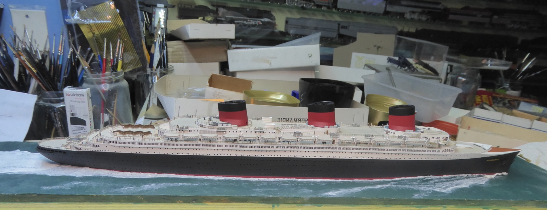

Hello all
Thank for your encouraging words--
The very warm summer and post -lock-down work stress has alas made some inroads on
my available model-building time, but there have been a few quantum leaps

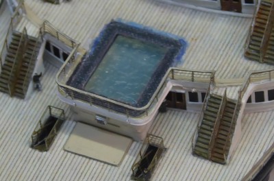

The recent photos of the aft decks of my ship model have been conspicuous
by the swimming pool having still been incomplete

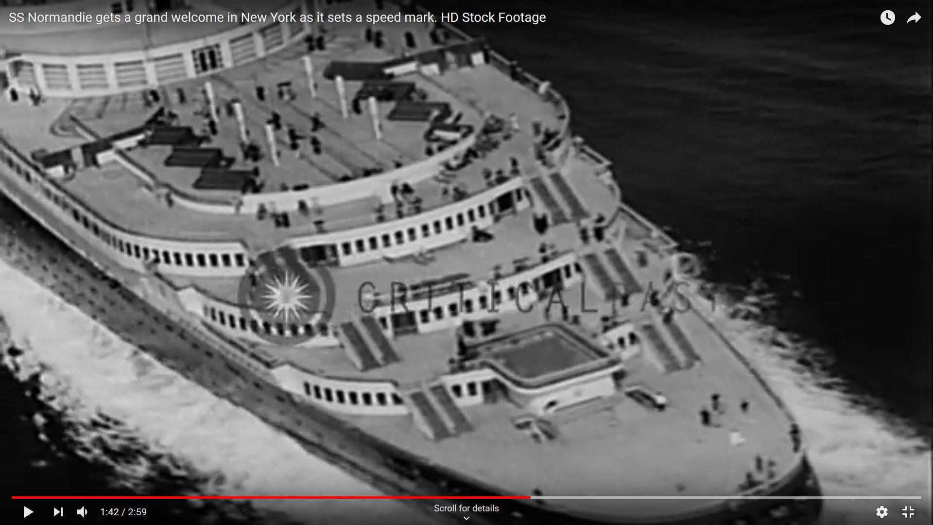

From the air--the pool looks neither very blue or the surround ever so very bright
from different angles in different lighting
closer up in black and white ....
even in colour

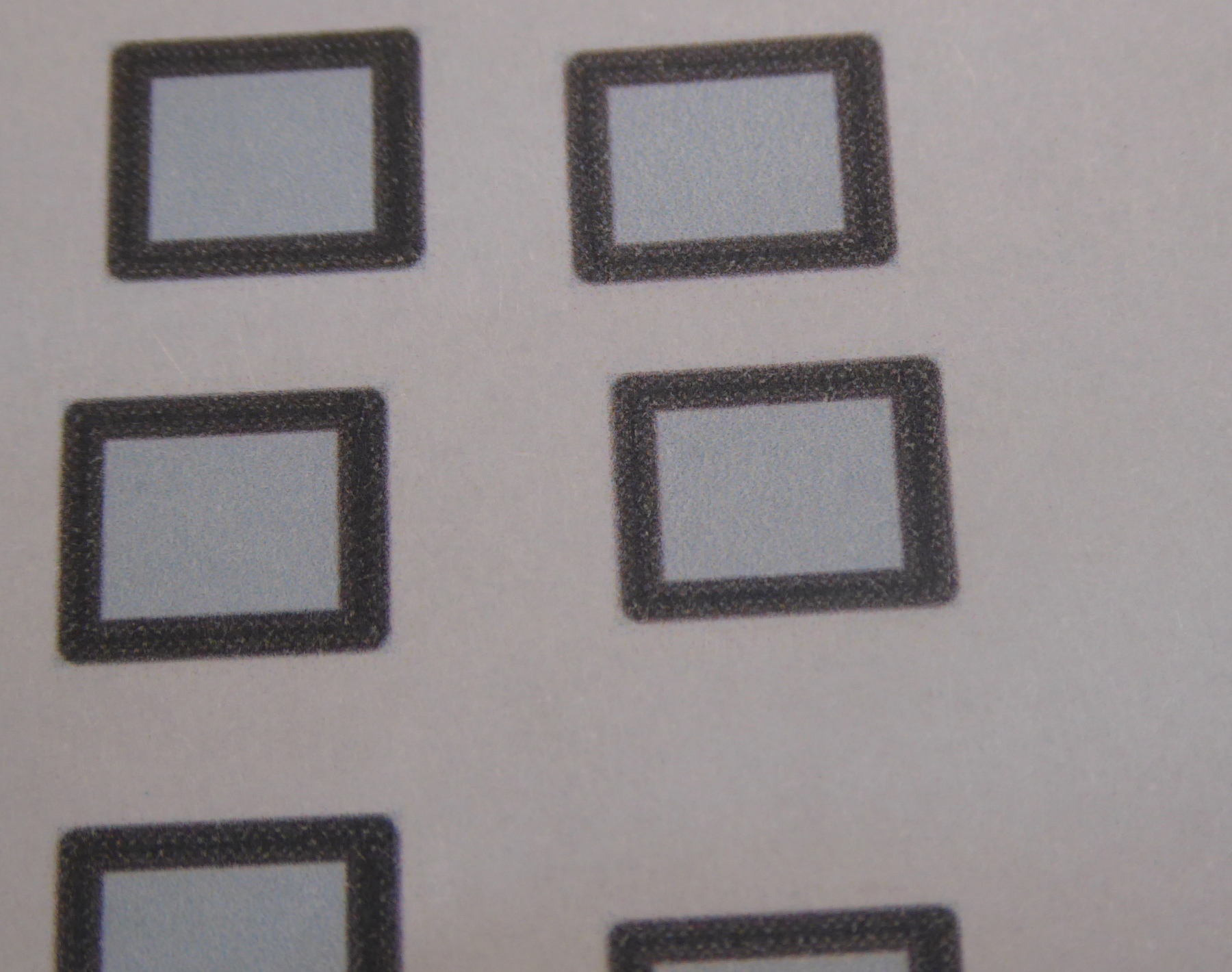

a few years back --having also bought the 1/350 version by OMK...
they had provided a pretty good decal for the pool surround
which I had scanned for future refs in case of damage etc so that I could reprint the decal .
That build never happened--domestic pressure-its a biiiiig model-- so I sold the kit to a friend.

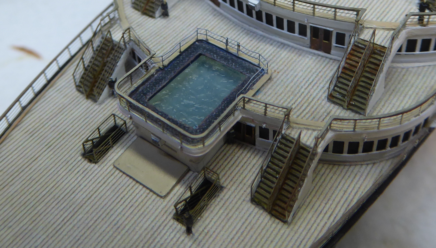

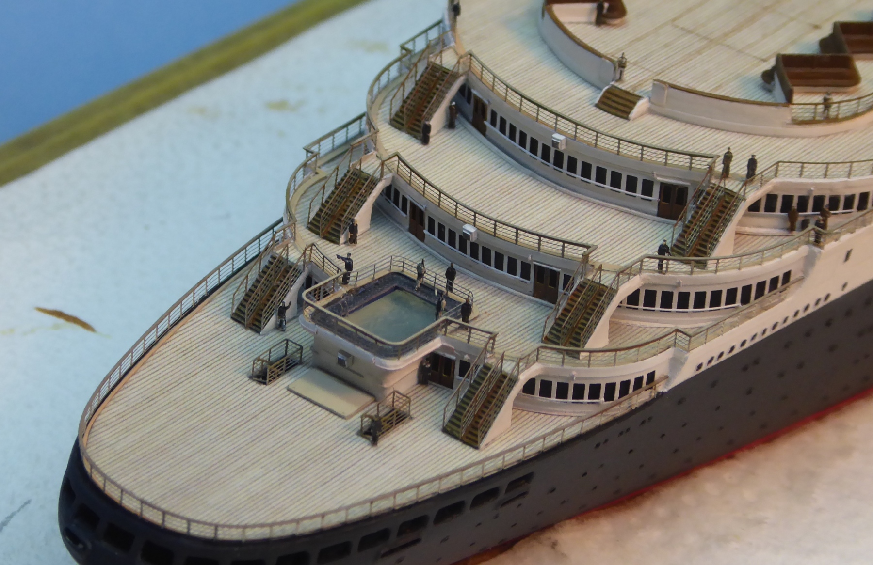

I dug out the scan which pretty accurately captured the tile pattern-- BRAVO ! OMK
I had already measured my pool surround--in 1/700 its pretty small 10.1 millimeters loa = 0.34 inch
I reduced the size of my scan and softened the contrast and colour hue to give a less stark effect
and printed various versions with sizes =/- 0.1 mm at a time to get an exact fit
version no 1 was unsatisfactory , I had simplified the surrounding railings, the contrast was too great , too much blue etc
when trying to make things better they often get worse first
to the extent that I also replaced the inboard timber pool surround with a thinner version
after quite some jigging and poking about with very small railings and people it
looked a bit more like an overhead view photo
a closer view

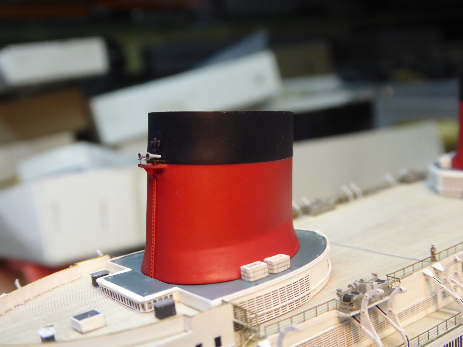

by diverting my attention to making the forward funnel siren platfrom
The original platform was cast on the funnel --- but was lost during the funnel reshaping and sanding
viewtopic.php?f=59&t=168156#p748736
....==> way back in November 2018 (!! )

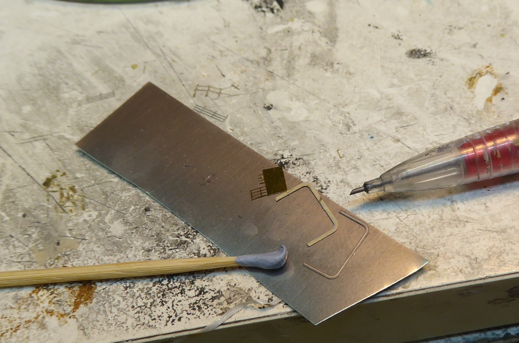

a new platform of CA infused paper, some GMM gold plus railing cut down and shape completed this task quite effectively
even in colour
a closer view

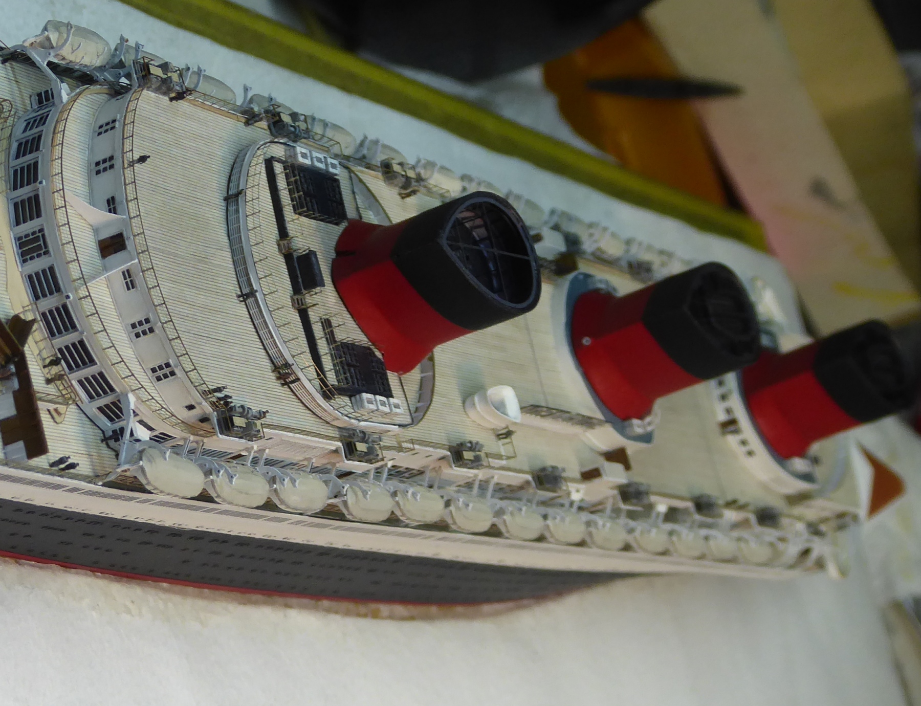

So-- having run almost out of things to do ( haha!! ) to avoid tackling the ships boats

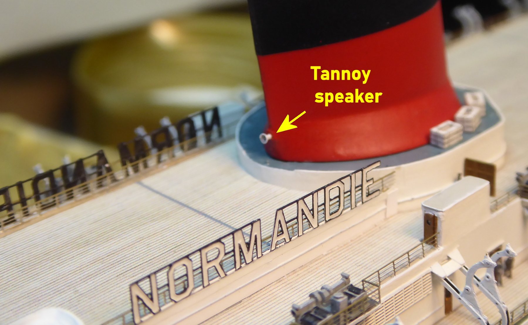

I added the very distinctive very large tannoy speaker to No 2 funnel
so back to the boats...
all I could do... was...--. to do them !

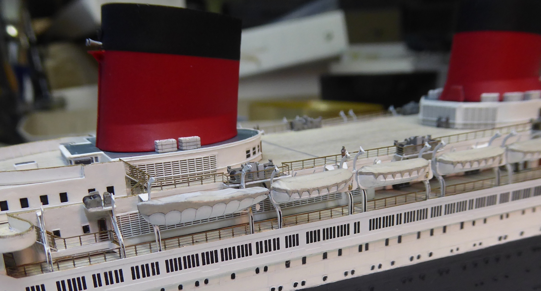

My biggest dread was how to get the boats aligned perfectly ,
the first of these issues was dependent on �( hopefully! )
my having previously installed and aligned the davits in a a sufficiently accurate manner
my second worry was how to actually get the boats to adhere to the davits, whilst allowing some
wiggle room and adjustment.
but first a few last minute preparations.

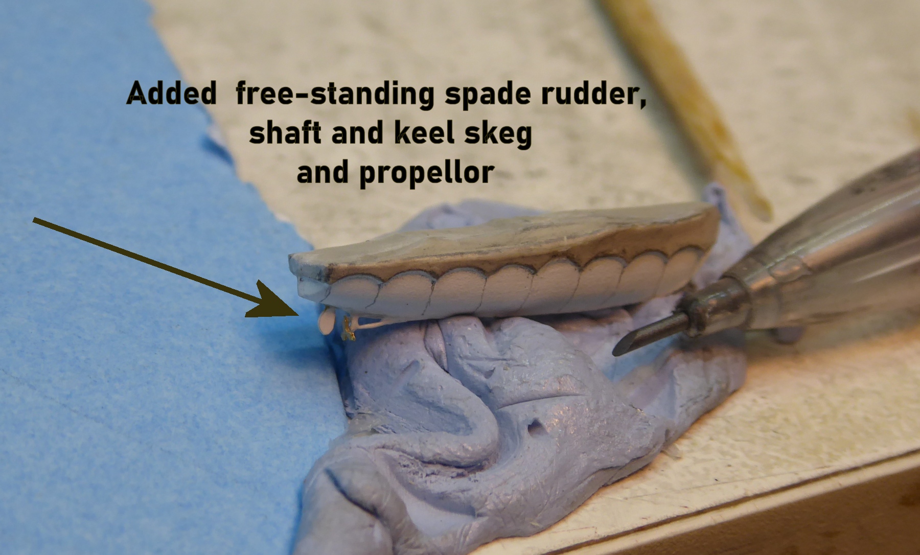

I had previously painted and prepared all the lifeboats back in November 2019 (!)
viewtopic.php?f=59&t=168156&start=120#p806471
all sitting on red pushpins for port and green for Starboard...
along with the 2 x large launches which now received the keel skegs of brass wire and white glue, the spade rudders ( brass) and the props in PE brass
I started on the Portside first ...-- for no good reason...
I found that despite the davits lining up almost perfectly when viewed along and eyeballed
that on 2 x boats on the portside I needed to ( brutally!) notch the bow section
on the inboard(un-seen !) face
The actual attaching of the boats went as follows ;
I propped the ship-on-its-sea-base at such an angle that the boats would " lie " broadly speaking in the cradle of the davit
without ' rolling ' off.
each one was test-fitted--with the boat being held in tweezers padded with sticky side out Tamiya tape
Once happy that they would site well
I added a small drop of fresh white glue to each pair of davits so that this would be hidden from view
and added the boat !
==> white ( Evostick woodworking ) glue has high grab and skins very fast.
but allowed final fore and aft as well as rotational adjustment for about 15 mins.
when things went wrong-and they did...-it removed willingly with no damage
first few boats on port-side

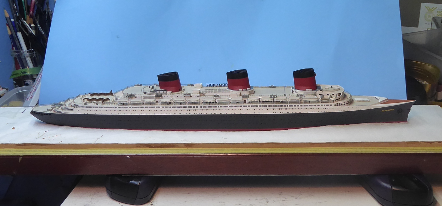

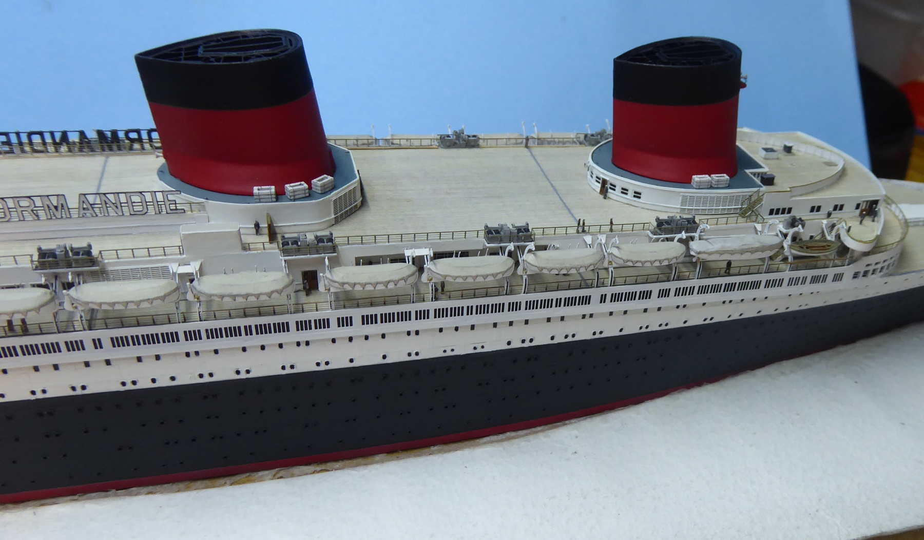

both sides completed... ( only 11 hours work !! )
The ship no longer looks undressed !
more shortly!
JIM B

She looks fantastic Jim!
The water in the swimming pool looks perfect too. How did you make that?
- pascalemod
- Posts: 2009
- Location: Stockholm, Sweden
The way you nailed the pool is simply mindblowing. I mean sure, the whole ship is off the charts, yada yada. The fact that the pool looks like a photograph of the real thing is just amazing. Thank you for sharing this build. I can't wait to see what kind of water colour base you pick: the cold dark blue Atlantic or something warmer? Going at speed through an ocean sweell, or gently gliding through the calm? Or docked in New York or passing Statue of Liberty or a bridge? An amazing array of options and all so romantic!

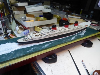

Thank you all for your kind words;
In answer to the water....
....we are doing 30 knots on a grey day just off the southern tip of the British Isles
-en route for New York !!
still working at it, but its coming along;
Normandie's wake pattern was always very clean--thansk to her Yurkevich Bow ( early Bulbous type )
Unlike here contemporaries, RMS Queen Mary et al-- she made relatively little water spray or white water
The boundary foam layer was also clean.
so here it goes in 1/700...
all I have to do now is to finish the other side !!!
