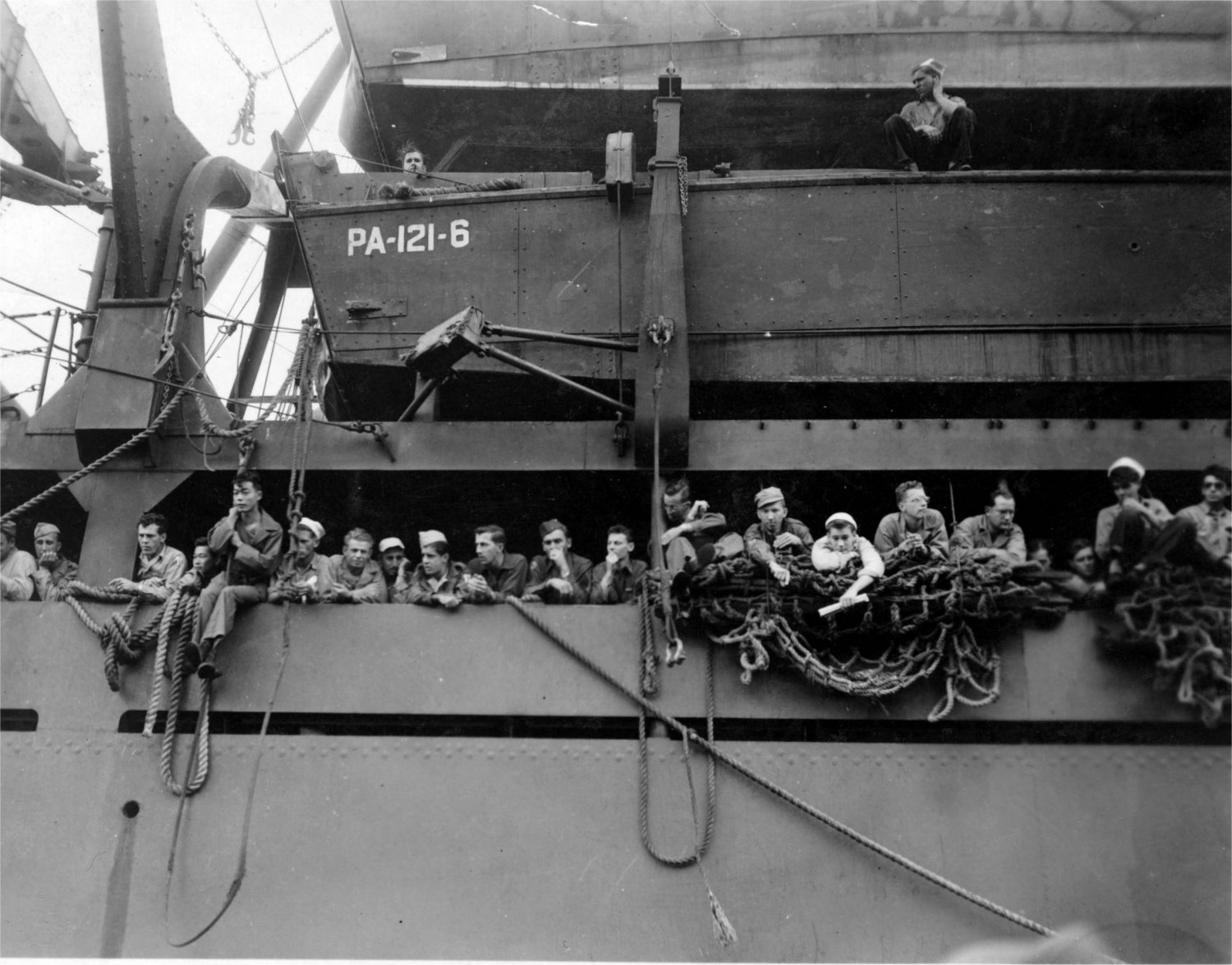

Somewhere I had a photo of these which has currently disappeared. It's a pipe frame with a bumper, about 2' long at the end, which would only be useful if it swings outboard. If I can find the photo I'll post it.

Here' is the bumpers to which i refer, looks as if they may swing to to position the bumper?

The boat cradles for the upper boats win the Whelan Davit stack. There are four sets of these.
The boat cradles swing out of the way from the inboard supports to allow removal of the lower boat.

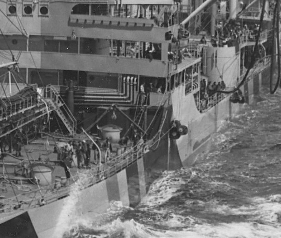

Harrumph! I have found tantalizing teases of what the Paravane Cranes look like and how they probably operate. But what does she really look like without the jacket and long flowing skirt, standing behind that truck? Looks to be a tripod from which rotates a two piece boom making a triangle with the tripod and doing able to swing through a 180 degree arc. Hoisting power comes from the nearby cargo winch ( in this case wench?). Oh for high rez photos!

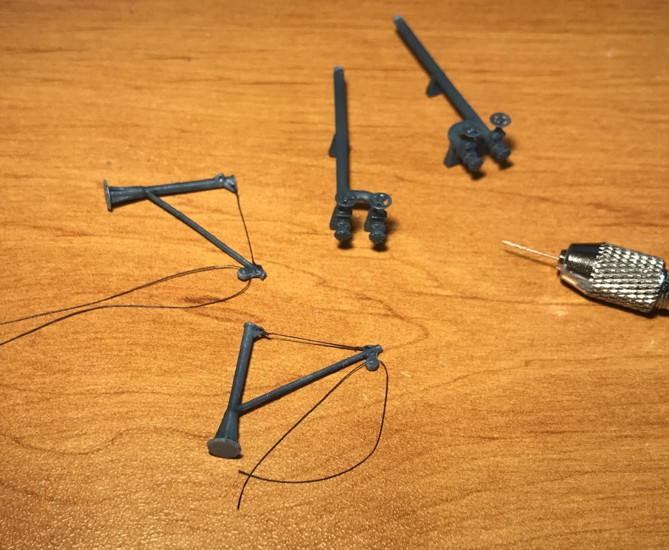

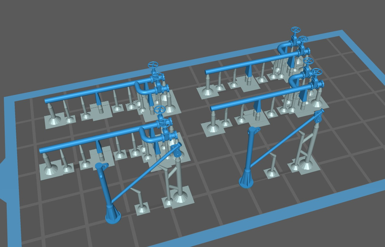

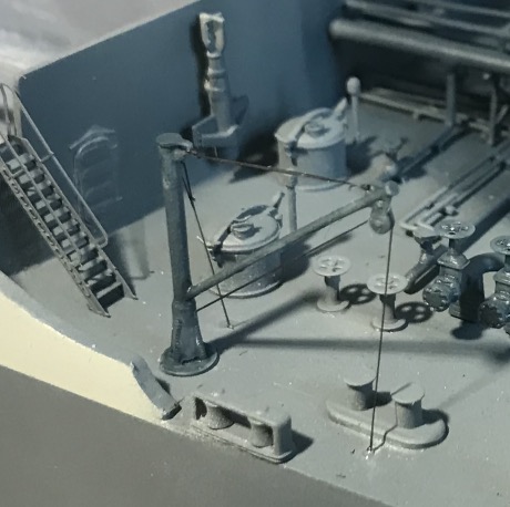

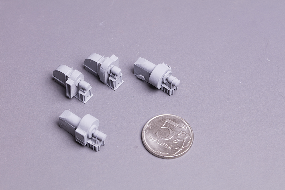

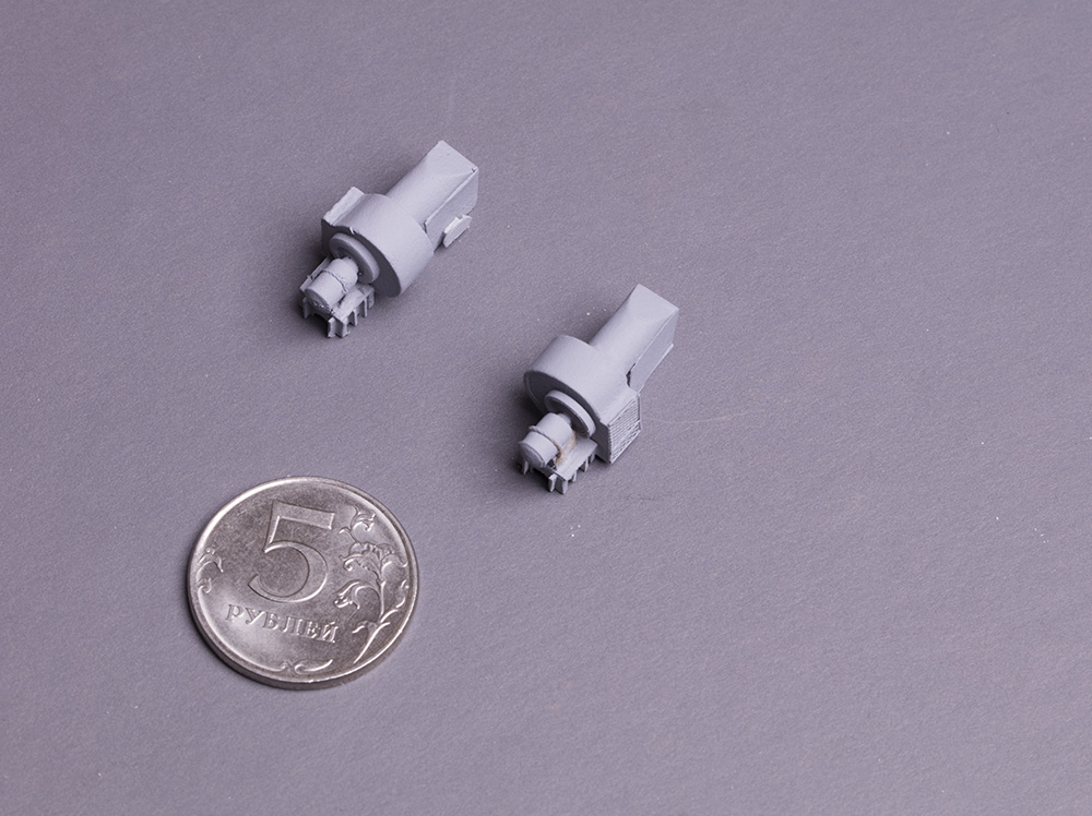

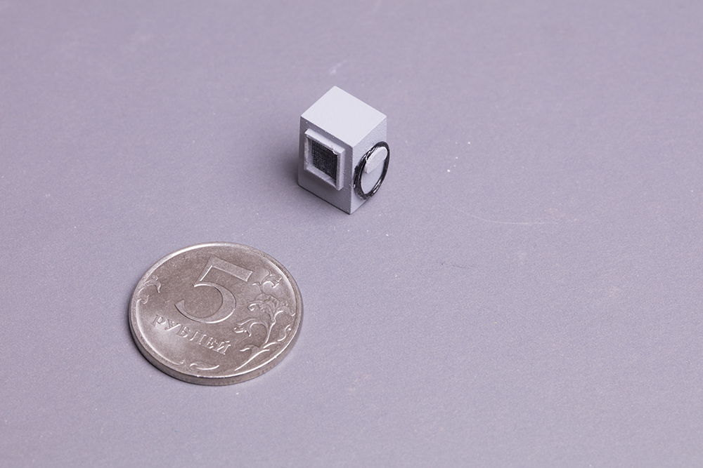

About paravane masts, I found this for T2 Tanker, maybe the same ones. A cable keeps the mast on the opposite side to the deck plating.

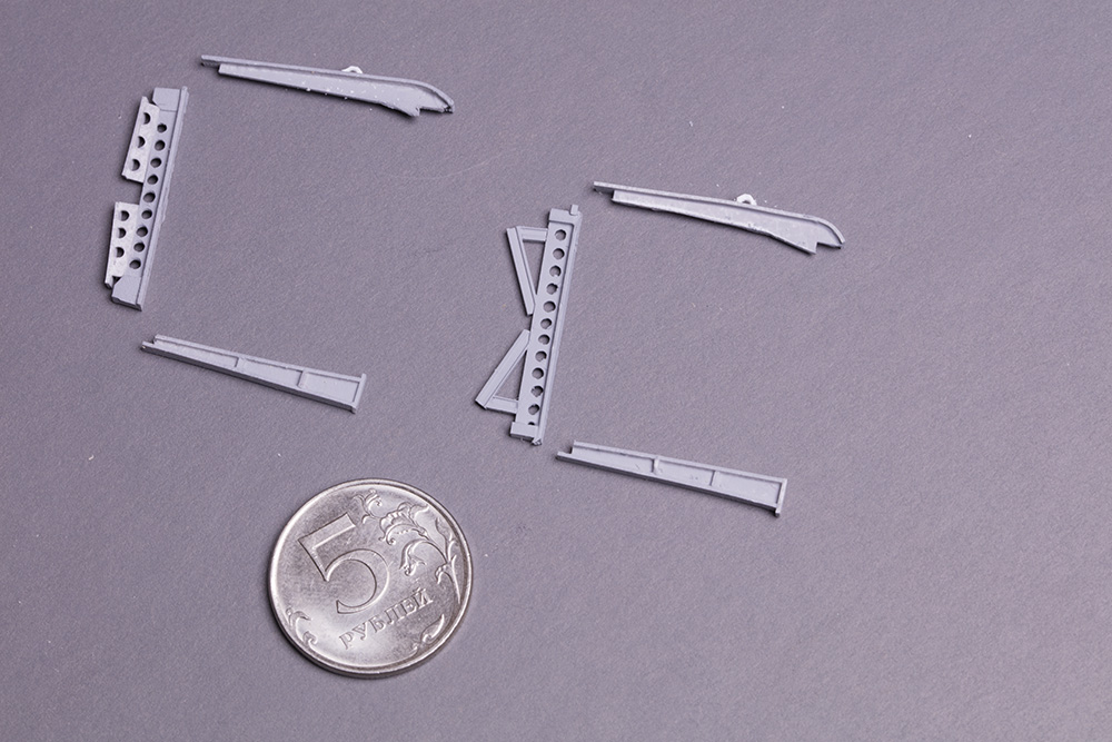

Your roller chocks came out well! There are a lot of small bits and pieces that 3 D printing works very well for, especially repetitive items. The paravane cranes look something like that but of course paravanes are much heavier than the oil hoses. Strangely they do not use a cable to control the angle of the boom but use a solid pipe so they have a fixed angle. They appear to (I might be wrong) have two braces to the deck making triangles set at 90 degrees to each other. Postwar the cranes appear to have been removed and a different setup is used though paravanes were still carried.
My project attempts to not use any PE or other commercial parts and build everything in the old fashioned way. In many cases the use of 3D, PE or commercial parts would save time, energy and challenge, produce a better result, but every part becomes a learning experience. I rather like the 1:120 scale, being as there are virtually no parts available but not the foot and inch crowd it is in many ways convenient, I directly read part dimensions with a digital caliper since 1"=10'.
Thank you for the information! I suspect that my cranes are quite similar with some adaptations to a different purpose.
Keep up the good work! Cheers: Tom

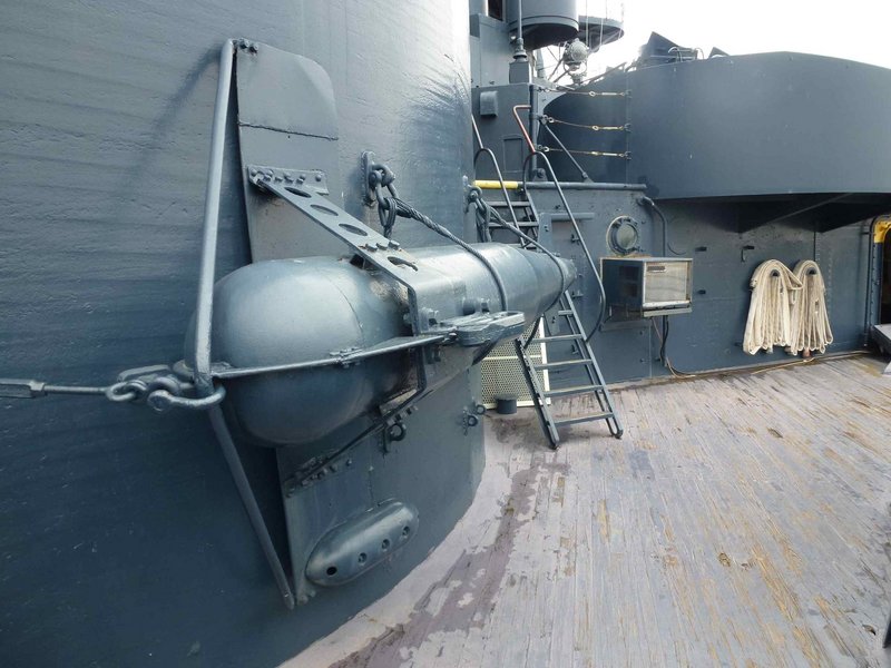

I think the paravans are not necessarily very heavy, it's a canister, some are slightly heavier because of their 80 pounds explosive load (36 kg), an option. It's their fin and their speed that makes them sink.

I forgot about the early anti sub various WWI techniques of "trolling" for submarines, which at the time couldn't submerge very deeply. Even in WWII the Japanese attempted to use grappling hooks to snag subs which might be lying "doggo" on the bottom.
Armed paravanes was a WWI RN idea which possibly persisted into WWII. It is not known if a single submarine was ever sunk by this method. However the USN employment of paravanes was to snag and cut mine cables such that they would bob to the surface and could be destroyed by gunfire. The Book of General Plans that I have referenced for the Haskell Class APA's show the small davit type cranes on the "boat deck" but I haven't found them in photos. My ship does currently have these small cranes for which I am researching possible replacement.
