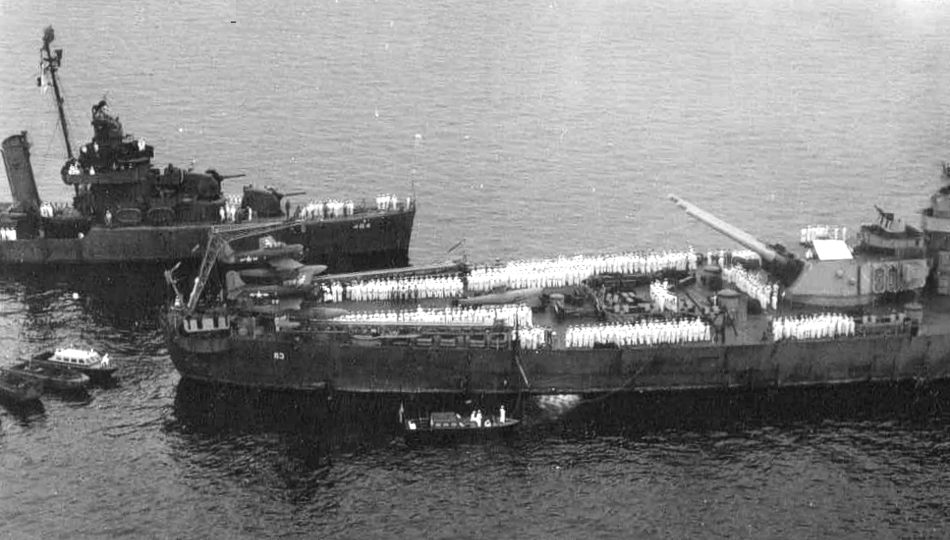

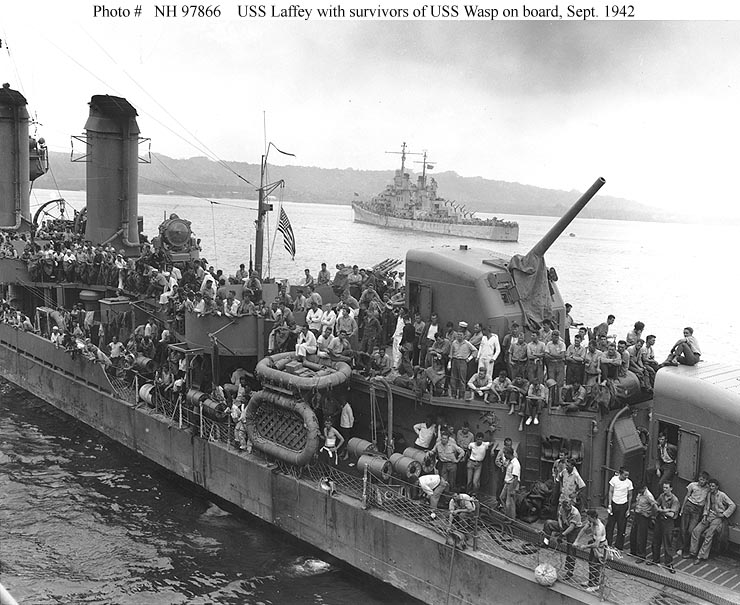

In this famous photo of the Laffey I noticed something odd, look just forward of the 20mm mount supports on the deck. There is a very large "drum", I didn't pay much attention to it before thinking it to be just another depth charge but then the "oh Duh" light went on in my head an noticed that it is twice the size of the other DC's on the throwers. I did some further digging around and found this on several other ships but the best photo is one taken onboard the Farenholt while she was fitting out. Now it shows an empty space but a large bracket(?) mounted to the deck which clearly is there to hold this drum. Did they experiment with 600lb DC's that just rolled off of the side? I can't imagine what else this could be and it has the look and size to be a 600lb DC as compared to the 300Lb ones on the throwers. I don't have access to my computer with the Farenholt photo but I am including one of the Laffey. The name escapes me right now as to the other ships that had this feature, Barry's question just reminded me that I wanted to ask this DC related question.

I don't think a side-roll-off DC would provide enough safety margin for the ship. Since she is pulling along side another ship, I think that the object is more likely to be a fender.
Posts: 3871
Post by Rick E Davis »
I think Dick is right, a fender would make sense, although normally they use those reed fenders. Why they would put one "large" Depth Charge to drop off the side would not seem worth it. I looked at another photo of Laffey where you could see the end of the "barrel" more clearly and it looks like a ... barrel ... looks larger than a 600# DC. The only other thing I can think of is that for some reason they have a barrel rigged there for quick jettison ... but what would be in it is beyond me.

Dick J wrote:I think that the object is more likely to be a fender.
There is a photo of the Gleaves class DD with the barrel clearly visable shown on page 41 of the Classic Warships new Buchanan book. It looks just like a 55 gal drum. It wouldn't make a very good fender. Note also that there is a rope fender stowed further aft in the same view.
I agree that a roll off depth charge is risky, but I don't think it is a fender.

If it is actually a 55 gal drum, there is another possibility. The ships carried at least one motor whale boat. Perhaps the gasoline was stowed in a 55 gal drum that could be quick-released when combat threatened.

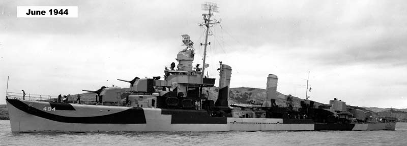

Does the Cyber Hobby release of the USS Buchanan have the correct armament to be used as a Gleaves class with the MS 32 camouflage scheme? If not, what would need to be reomved/replaced? Would the Dragon USS Buchanan be a better starting point?

sixman wrote:Does the Cyber Hobby release of the USS Buchanan have the correct armament to be used as a Gleaves class with the MS 32 camouflage scheme?
No changes, just paint.
