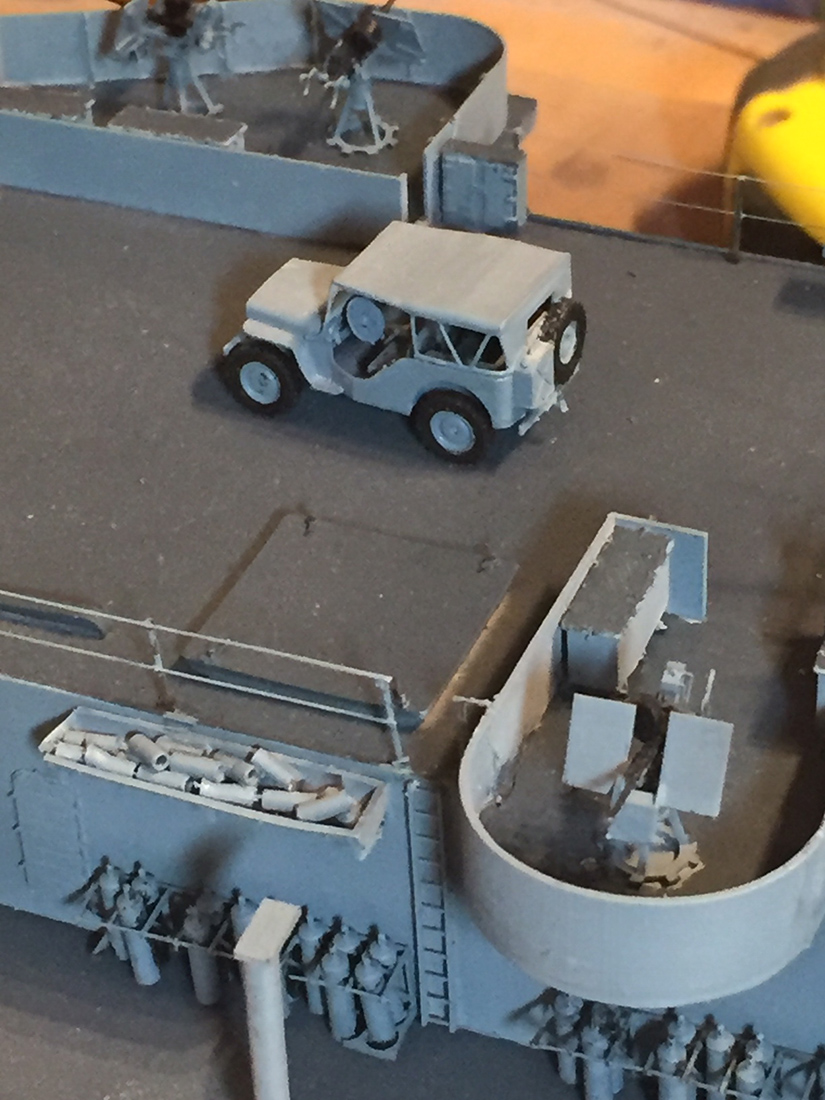

- Posts: 5068
Re: ARL 12 USS Poseidon
The Purloined Jeep, won by the Captain in a poker game. Where this took place I am not sure, Pearl Harbor perhaps too obvious, Mog Mog on Ulithi probably didn't have enough roads for a jeep to use, perhaps Guam or Okinawa. I do have photos of it being used on Okinawa and near the Fuel Depot at Manchester Washington.
I see, goofing off in the CO's JEEP while stores are sitting on the pier waiting for a working party to carry them aboard....what is the Navy coming to????
Tom - very nice work, indeed!!! Just had to take the opportunity, LOL!!!

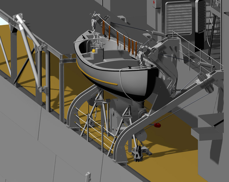

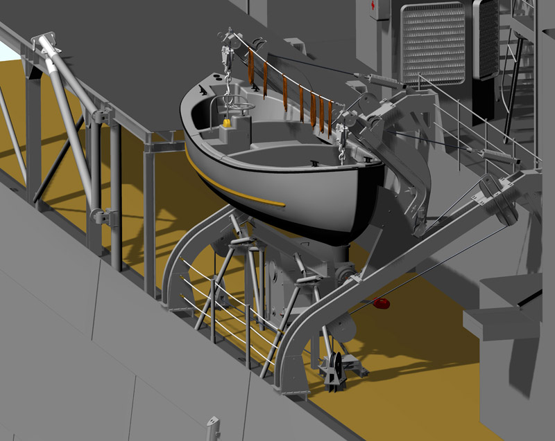

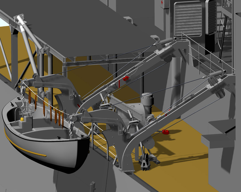

Boats suspended from the Welin davits usually had "preventers" (or some other such terminology) to secure them from swinging uncontrolled. These were ropes or flat straps that were attached to the ends of the davits, wrapped around the outboard side of the boats, and were tied off to the davits below the boats.
They were arranged in two different ways. In one way the straps attached to the same davit above and below the boat. With the other way the strap from the top of one davit wrapped around and under the boat to attach to the opposite davit.
On some ships there was a moveable support beam that was swung up under the boat keel to support the weight of the stowed boat. This beam was swung down clear of the boat before launching - after the preventers were removed - to allow the boat to be supported by the boat tackle.
Here re some illustrations from my CAD model of the USS Oklahoma City CLG-5:
viewtopic.php?f=27&t=70810
In the first picture the support beam is under the boat keel and preventers are attached. In the second the preventers have been removed and the support beam is lowered. In the third the boat is swung out on the davits ready for boarding.

- Posts: 5068
Phil:
Thank you, those are excellent illustrations. As far as I can tell from the LST illustrations and photos that there was a bumper on the inside of the davits to allow the preventers to snug the boat tightly against sway. The APA's had a similar setup when boats were carried outboard as well as in the racks. Those bumpers were hinged to swing outboard when needed. I need to go back to LST references to see just how low in the davits the boats were stowed and the size and the shape of the bumpers.

- Posts: 5068
Looking at Phil's images you can see the curved bumper for the 26' MWB, nicely shaped to fit the hull. The LST ones are a bit more generic. The ARL's usually carried 36' LCVP's in the davits, but fairly often the 40' Motor Launch which have a different hull shape. My guess is in a war zone that if a boat was damaged you either made do, replaced it, or time and materials permitting, fixed it.
I don't have a good record on actually declaring complete any model, they keep getting modified and upgraded. The only one that is sort of complete and sitting in a hall display cabinet, is "Whitehurst" a 7 1/2" DE waterline model. Completed using nothing but styrene, wire, a knife, tweezers and nippers. The lifelines are from an old girlfriends hair and have held up well.

- DrPR
- Posts: 1689
You are right about the bumpers. They were shaped to fit the motor whale boat hull. They were bolted to the davit "crane" and did not swing to the side. When the assembly slid down the rails it tilted over at the curved part of the rail, allowing the boat to swing free.

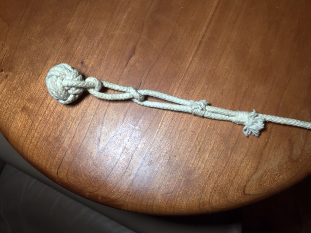

- Posts: 5068
I noticed this hanging up by my key rack. A harkening back to the old days and transition to the new. I made this "Monkey's Fist" as a young man. For those who don't know it's used for a heaving line. Perhaps a little more deadly if wrapped around a lead ball. Once upon a time I could do an eye splice faster than a landlubber could tie a bowline.

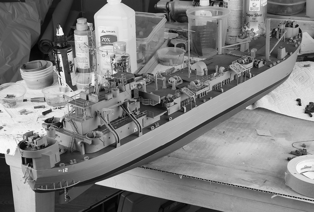

- Posts: 5068
I end up redoing some items, not long after initial adding them. The aft Carley floats, mounted at the rail were too tall on their frames and needed to move aft a little under the 20 mm tubs. So I uprooted them using my handy pliers. Generally things pop off, though glued with CA, the paint usually yields from the substrate. Shortened the legs, added a base bracket, painted and re installed. Popping the paint off leaves a "disruption" in the deck paint. Not normally a big deal but I flat ran out of my stash of home mede deck blue. The concoction I made has been satisfactory but was so long ago I don't remember what blue was in it. In the meantime I have a bottle go Floquil deck blue. As an aside I have always liked Floquil MRR Paints. The surprising thing is my existing and the Floqui are a very good match. Lucky beats good... A couple of stanchions needed to be relocated, small item.
Looking at photos from Stbd Astern, I spy a large cable reel near the lifelines, aft and a life ring on the very stern lifelines below the Bofors tub. Wondering id the port side aft also had a cable reel, photo search! So far not spotting smoke generators though dad said they made smoke at Okinawa.
Minus 41 in town today, chilly enough!
