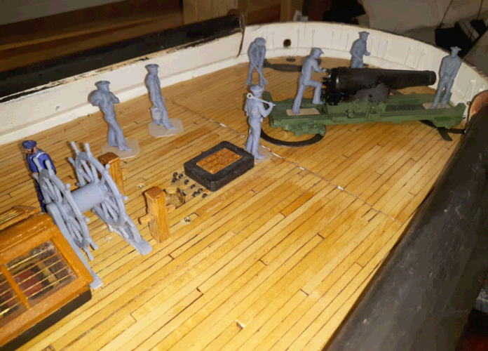

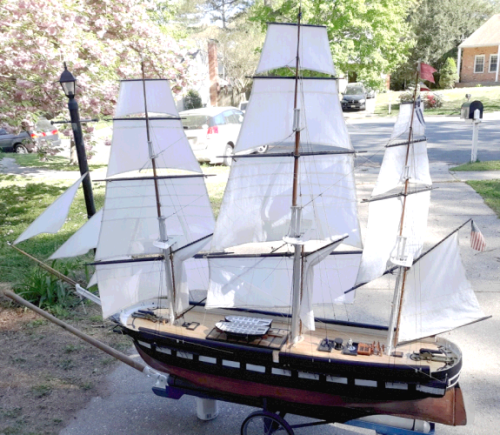

Making parts for a 1:36 scale RC square-rigger is an industry unto itself. The big thing about 3D printing is having the files to print, and the vendors don't carry much for 1850's sailing ships in this scale. Even as popular as 1:35 scale figures are, there's nothing out there as far as sailors, Marines, and officers (I could use Mexican-American War figures, but no one does those either). What I need to learn to model is the decorative filigree and vinework of the head and transom carvings (I have a 1:36 scale British frigate needing some love as well)

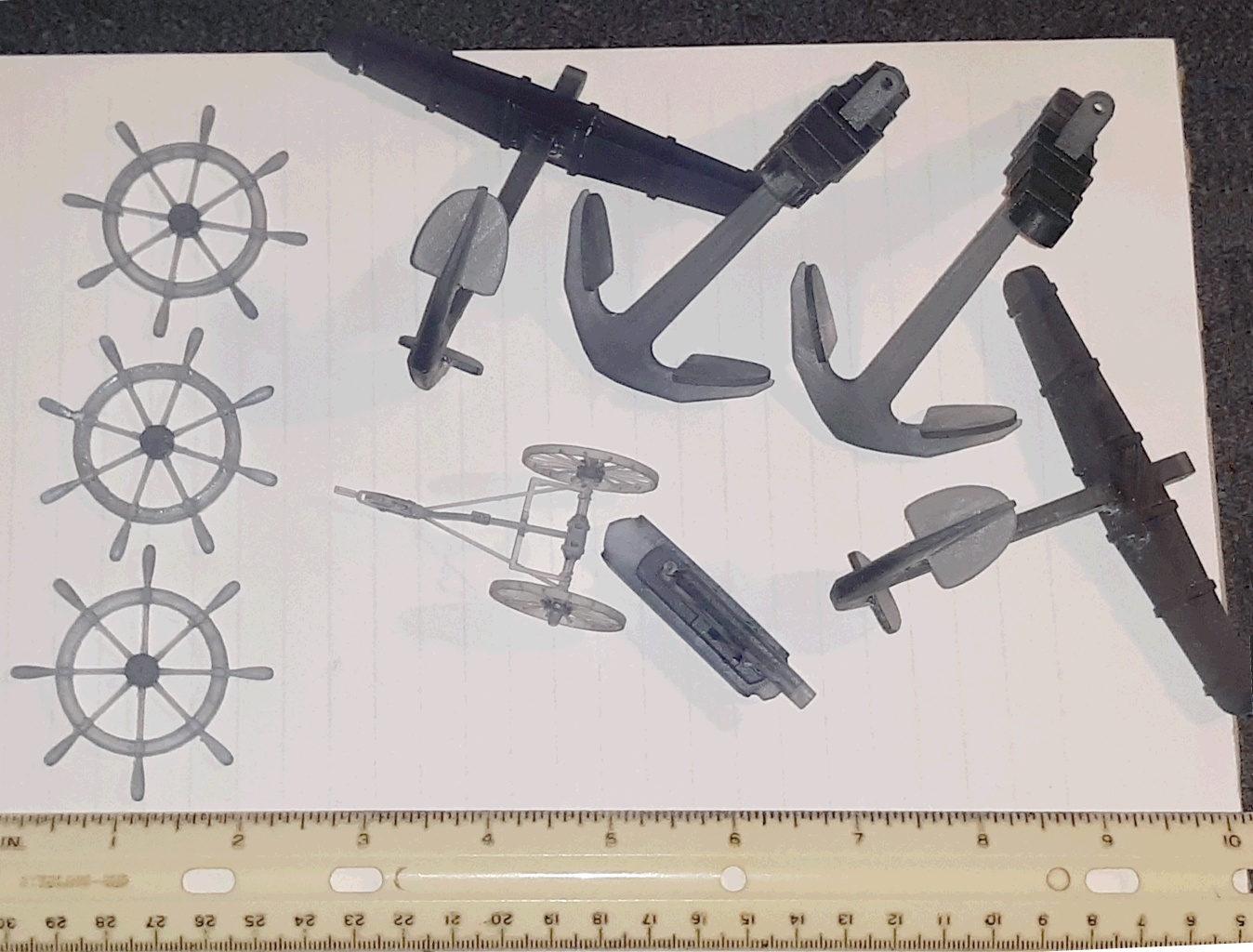

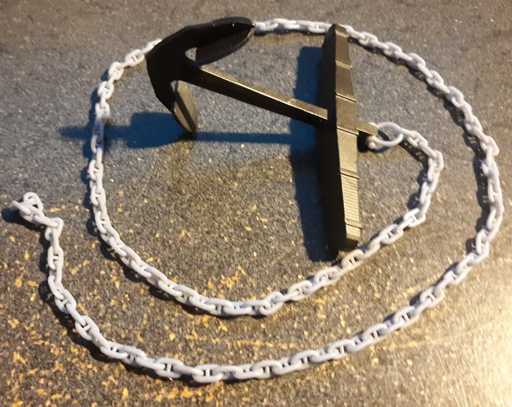

Still futzing with the new printer. Went back to use the "Anywho" software slicer. Printed a set of 3" 50 carriages and separate barrels as shown earlier. Carriages printed perfectly, barrels only leaving a set of thin base rafts in the tank. What I am wondering is if the position on the platen was the factor, I think the large platen created rather dramatic fluid dynamics and may have washed out the parts toward the center. Trying a reprint with the barrels along the side of the platen as an experiment. Perhaps a couple of anchor larger supports are needed?
Tom
Tom

Printing as a single piece of separate sometimes is an issue of scale. Very small parts can be difficult to assemble accurately where was in a larger scale this will not be as much of an issue. I was surprisingly able to successfully print my 40 mm quad mounts (with shield) in 1:192, as well as the 20 mm Orlikon mounts. Assembling these at a small scale would be far less satisfactory. something which I had earlier learned using commercial units which required assembly.
I seem to be making both peace and piece with the new printer, as a trial horse (Not hoarse from coarse language) using the above printed 3" 50. Reconfiguring the settings has paved some benefits. So far I have achieved successful prints using both the provided slicer and Chitubox. I printed the items near the edge of the large platen aligned with their axis pointing outward. Further printing experiments will determine whether or not flow of resin is an issue and further platen speed adjustments are needed. Using the same general support design and density that I have been using for a couple of years now.

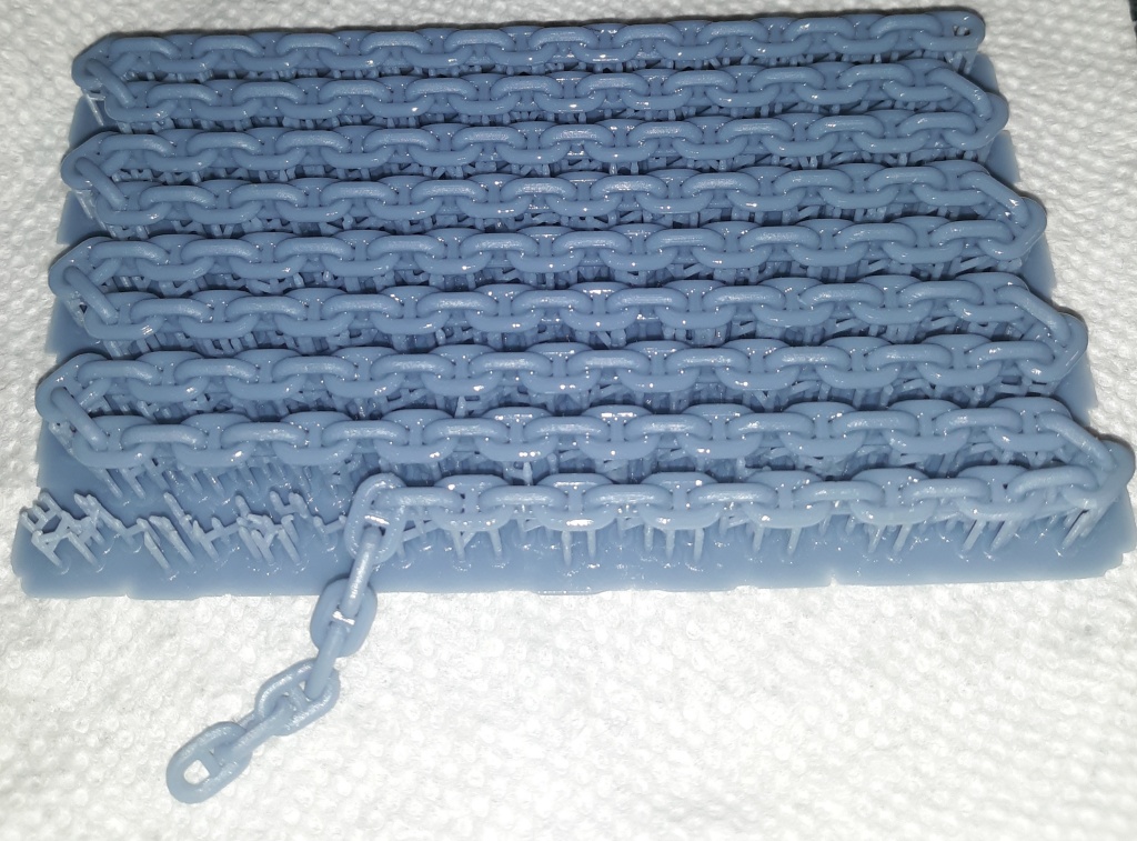

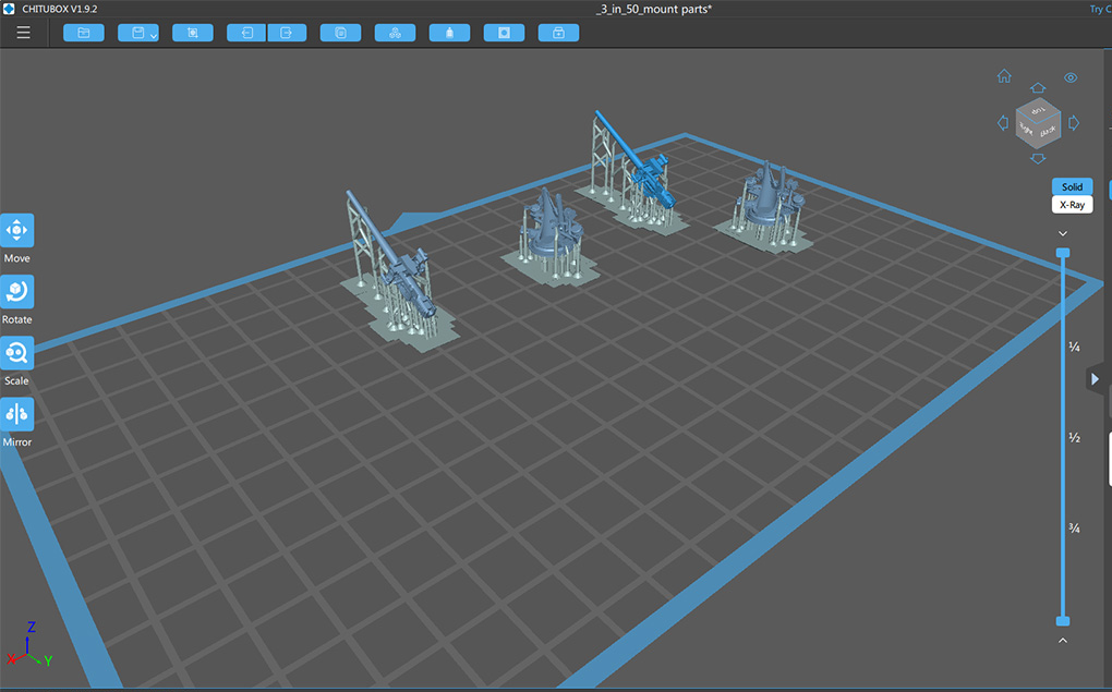

Orientation of pieces at the edges of the very large platen, aligned so the flow direction goes with the least drag for the barrels.
Tom

Re: 3D printing
Tom,
Thanks, that helps a lot in seeing how your description actually appears. Quite a contrast from a picture of the same objects on the OLD printer. Doing good work here - kudos!!!

Tom,
Orienting the parts to achieve a faster flow of resin into the space between the part and the FEP film is a good idea. I would think it is more important n printers with large print areas. Resin will have to flow farther to fill in the larger area and positioning parts to interfere the least with the flow would allow a better distribution of the resin during the time the paint is raised above the FEP film.

As seemed to be the case when I first began printing, the printer has started working without much change on my part. Of course that was two years ago, back when the planet still had 12 years left? As a test piece I am currently printing the MK 4 radar unit used on the MK 37 director. A common unit during the war. Alaska has two of these, which I replaced the PE units with printed ones. Now I think I will upgrade the earlier printed ones with the new ones, mostly from the same files, but they are much more fine and dainty and will add to the overall effect of the model. There does seem to be a limit to fine and dainty and the rather flexible Model (goopy) Gray resin becomes quite rubbery at small scales. The Rapid Black would probably be stiffer here but that's not really that important. The one's on Missouri use a parabolic dish (forgot the mark number) and so will probably remain as is.
With really fine items careful consideration of supports is necessary so as to not make them un removable. Individual placement is optimal. The latest Chitubox shows a ghost of where the support will be placed, very useful!

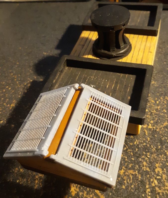

Back to printing... I was pleased with the airy aspect of the MK 4 units I printed for Alaska and replaced the existing ones. Missouri (both 1:192) has the MK 25 units so I have not replaced those. Last night I printed two of the 5" twin mounts in 1:120 but haven't fetched them as yet. 1:120 is a real resin hog compared to 1;192. On the larger platen I was bale to print two plus the separate barrel assemblies. I split the barrels off as separate files, this allowed me to angle the mounts at 15 deg and the barrels at 45 deg which should be more optimal.
Tom
https://www.electrical4u.com/klystron-t ... lications/
A development of the "cavity magnetron" which allowed the development of microwave radar. The Klystron tube is a microwave amplifier. I remember historical discussion of early British airborne Radar they dubbed the "Klystron Ray".
Tom

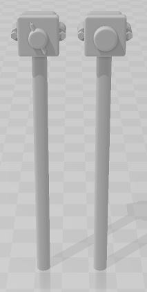

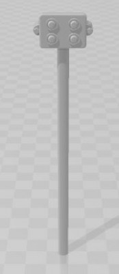

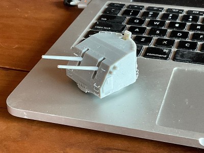

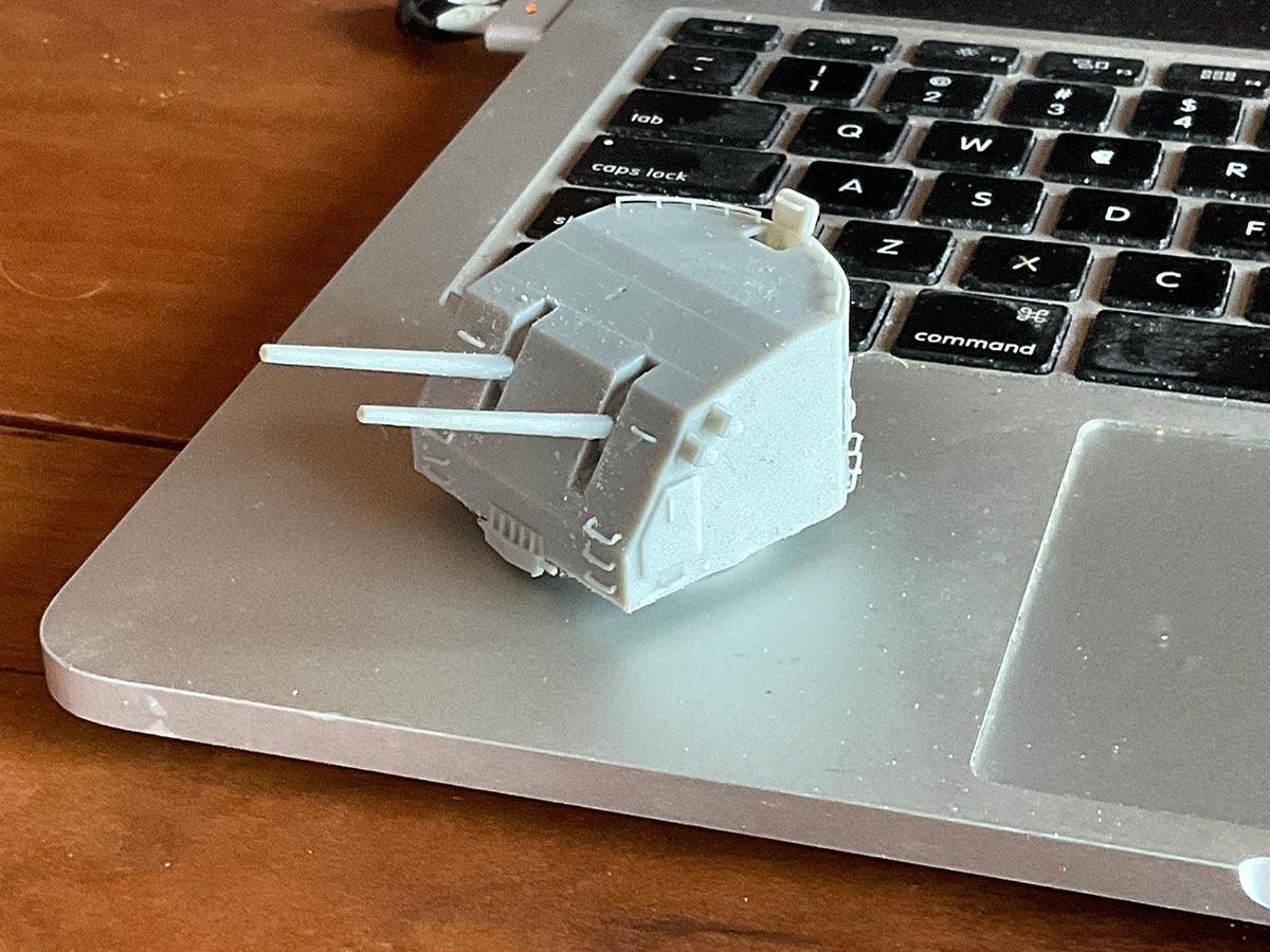

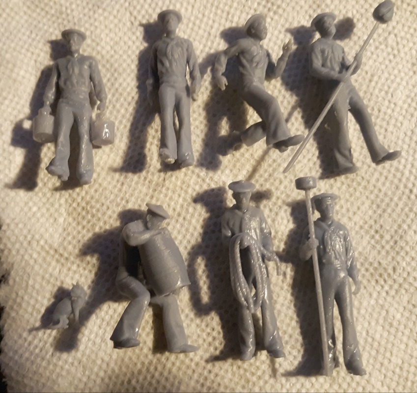

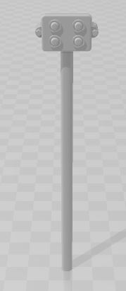

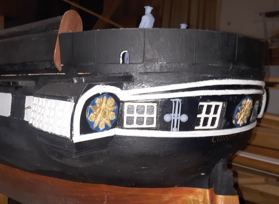

As part of an ongoing project, I printed the twin mount in 1:120. Strangely both barrel assemblies and one mount came out almost perfect. The second mount, sitting next to the other on the platen was just a blob stuck to the FEP.
In these days of cyber security concerns one cannot overlook any form of keyboard security. In the raw and still having some of that irritating resin dust which comes from minor cleanup of the object. Exaggerated in a sub arctic climate, the indoor humidity currently at 2%.
Tom
Tom

It happens sometimes, I have to check that the base of the supports is at zero on Chitubox. The bottom surface of the supports must be green. Sometimes Chitubox plays tricks on me, some bugs.Fliger747 wrote:The second mount, sitting next to the other on the platen was just a blob stuck to the FEP.
Tom
Pascal

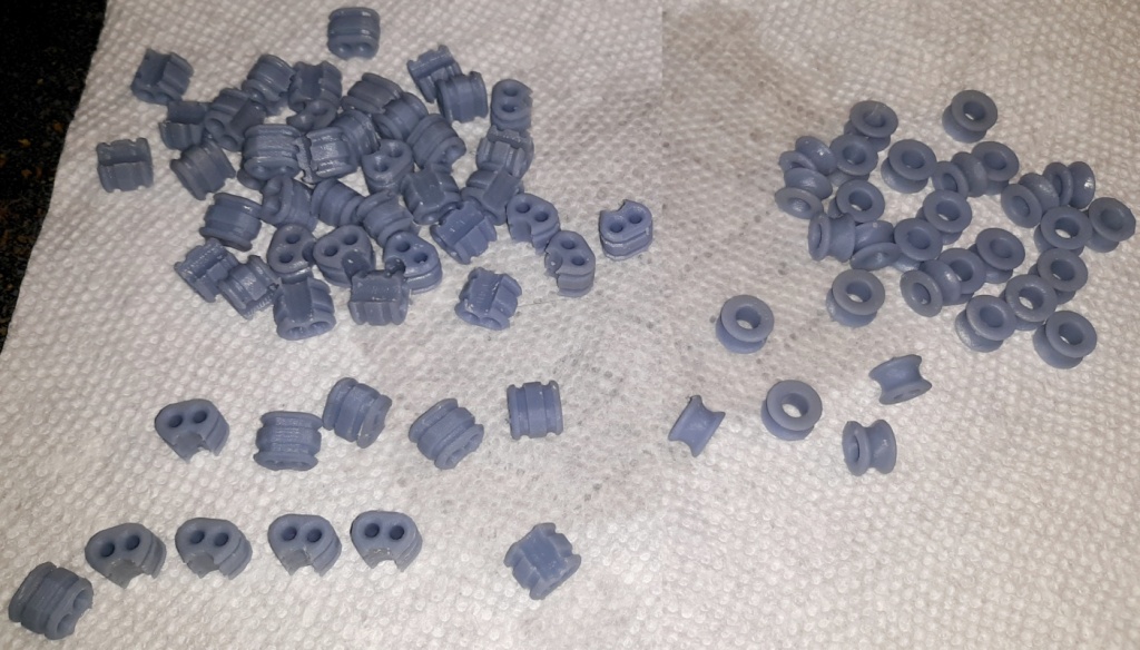

I think I found my sweet-spot in 3D printing and I've been trying to get everything I need printed before it fades away.
So far I'm finding a lot of "light" supports are working for me better than fewer larger supports, especially on edges and corners. I think they release from the FEP easier with each lift.
