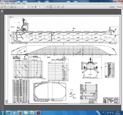

hello it is very nice project also i am planning a project about capesize bulk carrier.
is that pLan enough for hull body.
i am plannig about 100 cm lenght and 15 cm breadth.
i will ask question about boats engine what its manufacturere name

The drawing you show is a typical "docking plan", it contains a general body shape for docking the ship. If you're good at drawing, you could try to add more frames. This type of plan I'd use for a smaller scale type of build, more in 1/700, since it gives enough detail for that scale. For anything larger than that, I'd want more frames.
That is of course, just my opinion, if you're not too interested in accuracy on that hull, it should be enough. You can also interpolate some values from the side and top view to get a better representation of the shape. You can also use pictures to add to the accuracy of the bow shape. The stern section will be detailed enough with the frames supplied, the bow however is lacking...
