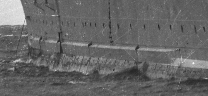

I am trying to get information on the armored belt that was added to the Kent sub class of the country class heavy cruisers of WWII.

Brett Morrow
Posts: 346
Re: Calling all Kent sub class Cruisers
Post by Brett Morrow »
What is it you seek exactly Richard? Check Norman Friedman cruisers for info on the added 4.5" belt.
If you require photo reference many images on the P.D. will show you the added belt, there is not much to see.
If you plan a larger full hull model you would be better to concentrate on the torpedo bulge.
See the main county thread, as this will probably end up there as the initial enquiry did.

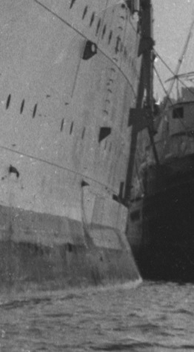

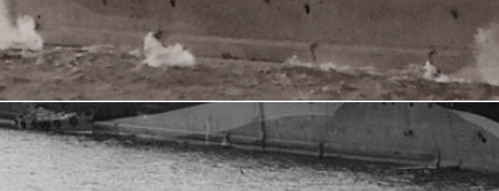

The Kent class torpedo bulge, and the added armour belt.

Hi Brett
Does the belt blend onto the bulges below the water line or wrap around them ? I am thinking of making a 1/96 scale plug in order to make a fiberglass hull.

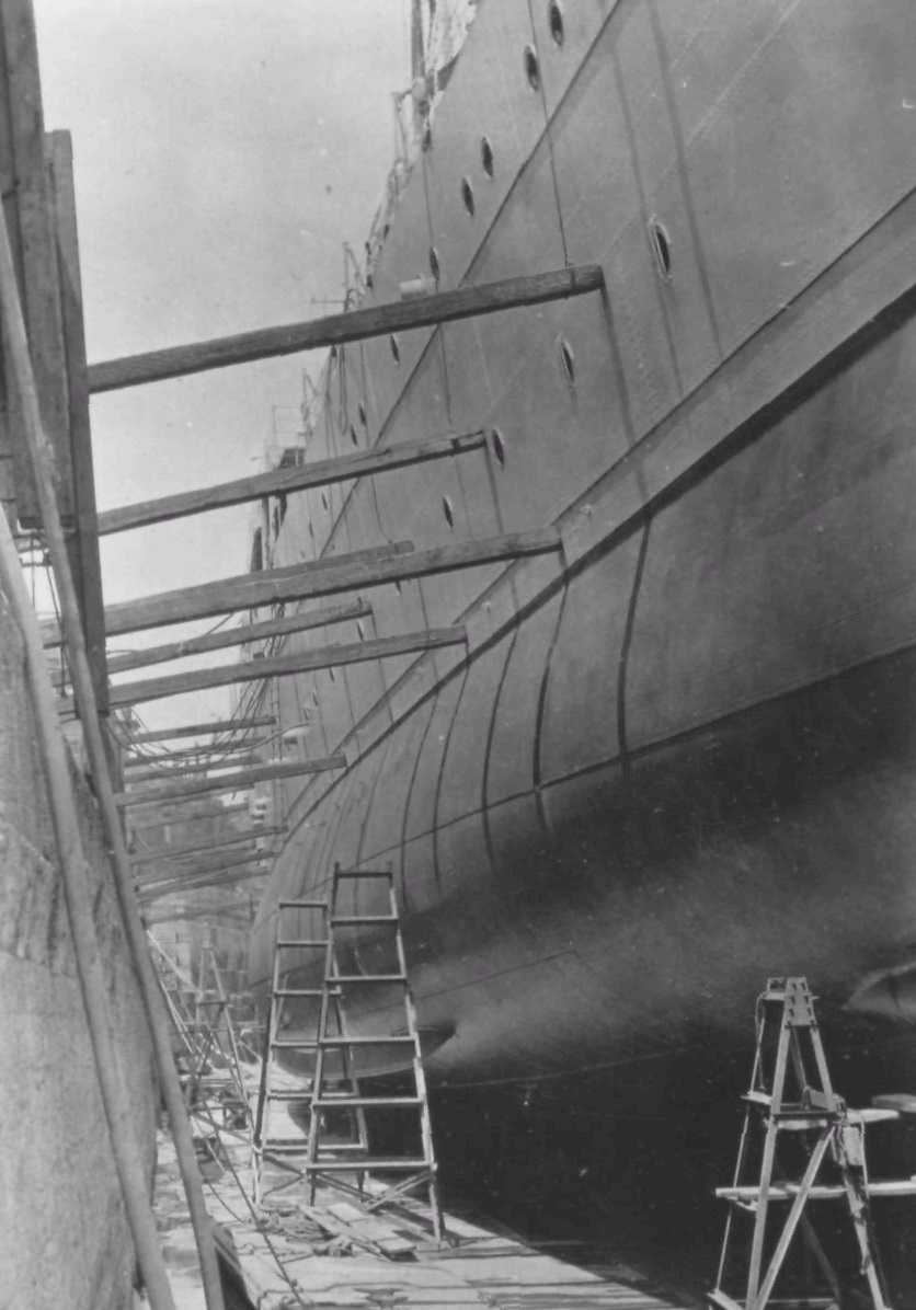

Hi David
The plug will be one piece but the mold will be two piece split in the middle. Iooked at ( world -war. co.UK ) and it shows it below the water line but the Profile morskie plans show it ends at the water line. Wish there was a Drydock photo. Maybe I will make it as launched and let the model builder add them if he wants to show it after moderation. Thank You for your help .
Brett Morrow
Posts: 346
Re: Calling all RN County class fans
The D.D. shot is before the belt was added, pre 39
It is difficult to see and only the right angle will show that the armoured belt actually overlaps the torpedo bulge by a small margin.

I rather suspected the drawings were not correct because they show the bulge looking more like a blister.I doubt they bent a 4.5" section of cemented armor around the bulges plus a strait part going up the hull side. I think it would blend into the bulge like on HMS VANGUARD.

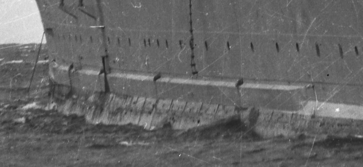

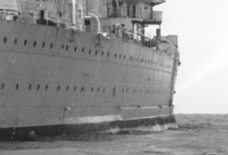

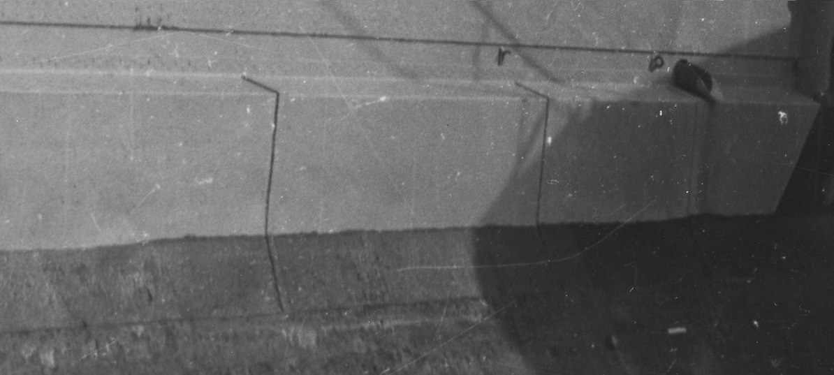

Brett Morrow
Posts: 346

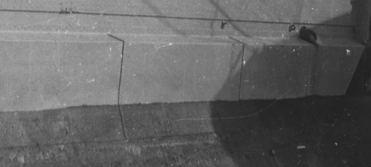

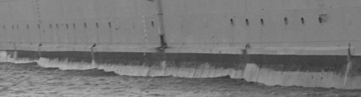

Images can be deceiving, here are some closeups of Australia`s belt.
Kent`s armour belt was identical, as were any of the other Kent`s which were fitted with it.
As I had previously pointed out, the belt overlapped the torpedo bulge, and appears may actually have extended below the mean waterline, this is open to one`s interpretation.
I would treat the world-war.co with some caution as regrettably not all the information is accurate, nor the profiles.
Don`t know what to make of the Kent G.A. and other ships which show what could be construed as an armour belt extending way below the waterline.
Australia was constructed as per the plans and layout of all the other Kents, but her profile onsite shows something totally different?
The Belts fitted to any Kent which received them appear to have been identical in design and fit.
