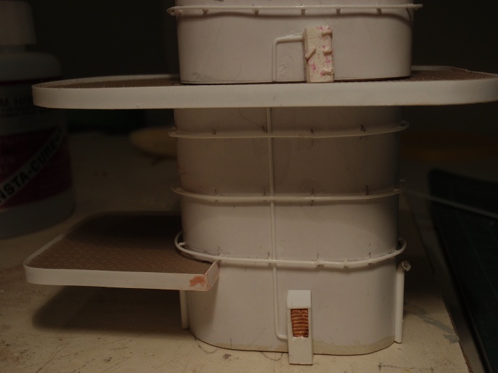

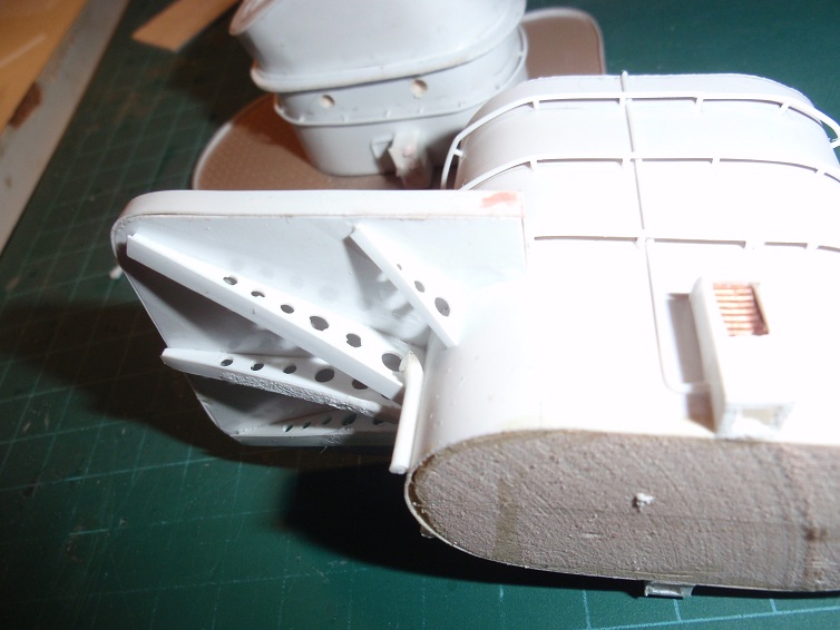

Post by russclark »

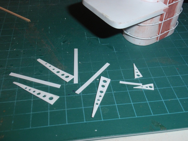

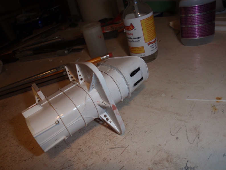

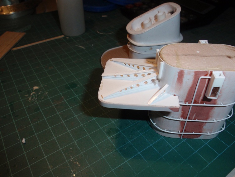

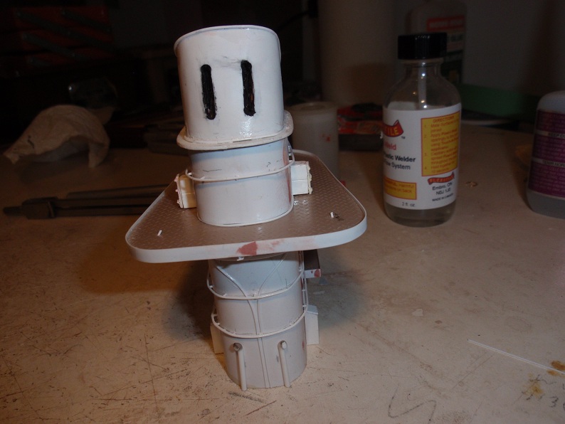

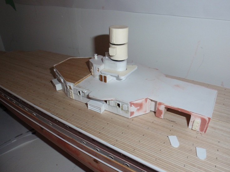

a little more progress on the funnel.i made the bracing for under the decks and a few other details ,piping and stuff.on the upper platform there will also be 4 search lights,two 20m.m guns,and the braces for the mast,and railings.also there are ladders to put on.

Hi Russ Very nice work indeed. I used a similar method for the Funnel casing on Tirpitz. When bonding the styrene to the timber I used �R-C modeller�s glue�, which is a superb adhesive for the job. Question what type of adhesive are you using for the same process. At one point I made a mistake and tried to remove the styrene thinking that it would peel off quite easily, I was wrong; it actually peeled off the tope surface of the timber. This proved to me that it was the right material for the job and I have used it ever since.
russclark
Posts: 1173
Re: 1/144 admiral sheer s.c. scratch build
Post by russclark »
thanks for the comments richard and dave. dave the glue i use is Lapages contact cement.once it is applyed it take about 1/2 hour to dry then one can stick the parts together.on larger areas i lay paper over the one side and start at one end applying the 2 pieces together then sliding the paper out as i work along.the glue only sticks to it self.if you don't and half way along things are not lined up ,it is tits up,you will not be able to peel it back.

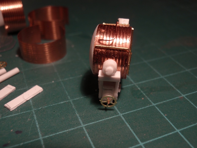

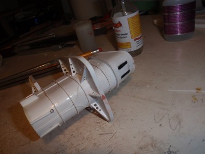

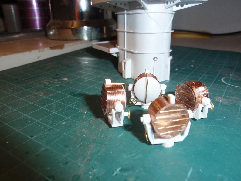

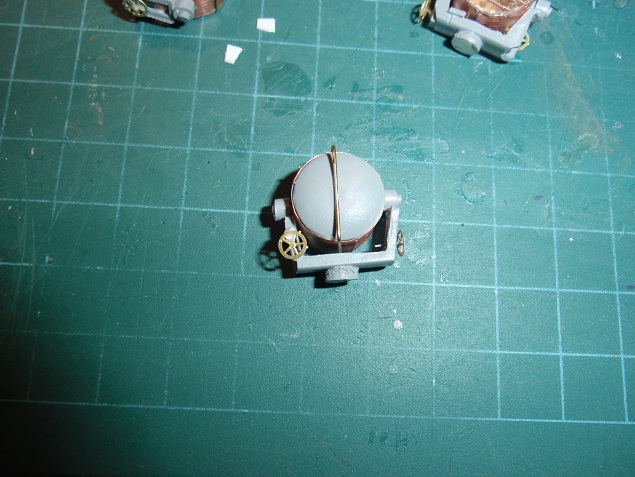

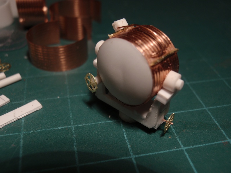

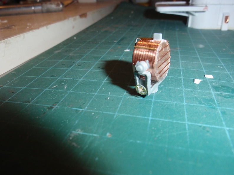

well i have made the 4 search lights for the funnel platform.for the main body i used styrene tube wrapped in thin groved copper sheet,i tryed casting them but they came out as bloobs and destroyed the mould so i built the 4 one at a time.
these 2 pics are painted,i think i am going to leave the copper unpainted adds a little contrast to a gray ship

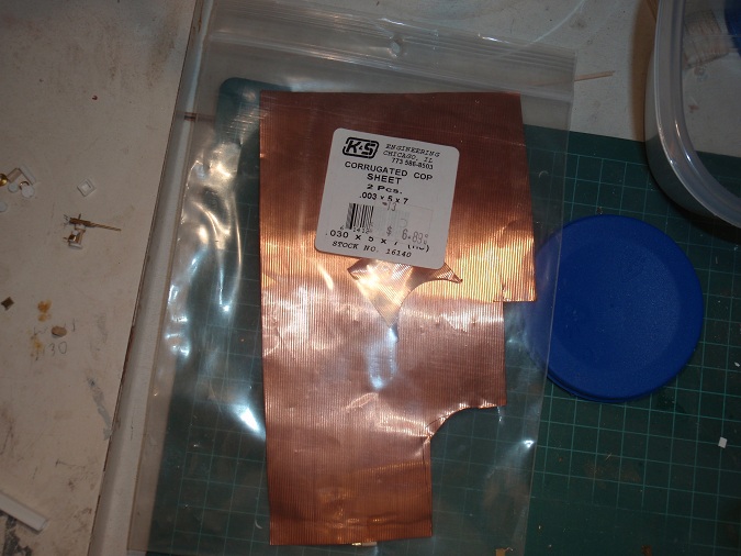

Great craftmenship on the lights :thumbs_up_1: :thumbs_up_1: :thumbs_up_1: .Were do you get the copper . :huh:
russclark
Posts: 1173
Post by russclark »
thanks for the comments guys,richard i do not recall where i got the sheet copper ,i have had it kicking around for years.

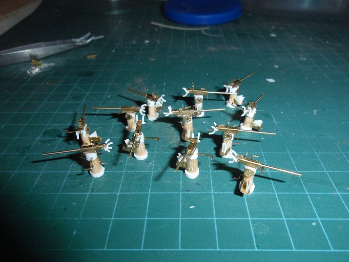

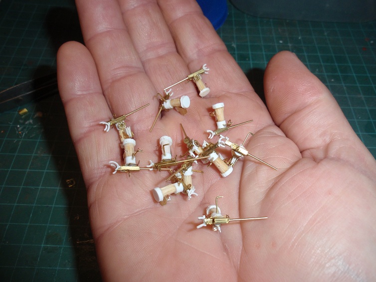

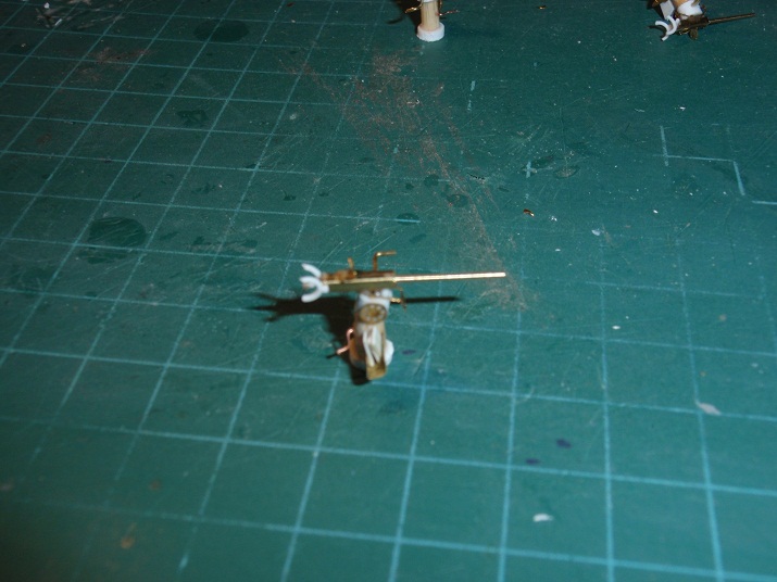

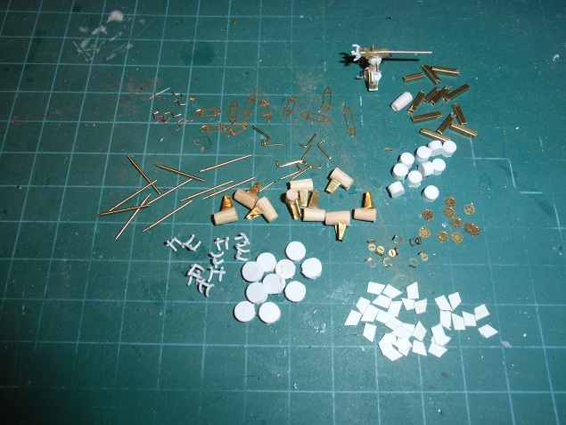

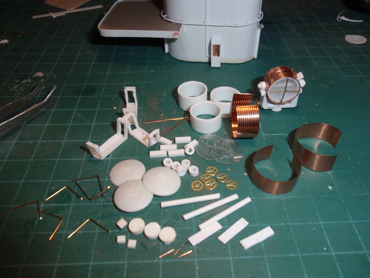

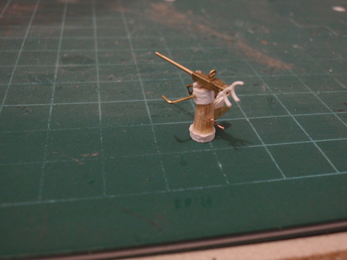

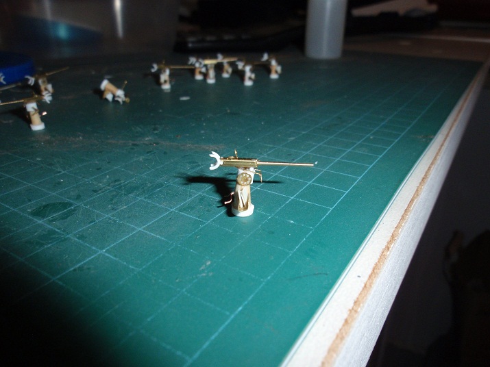

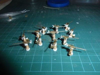

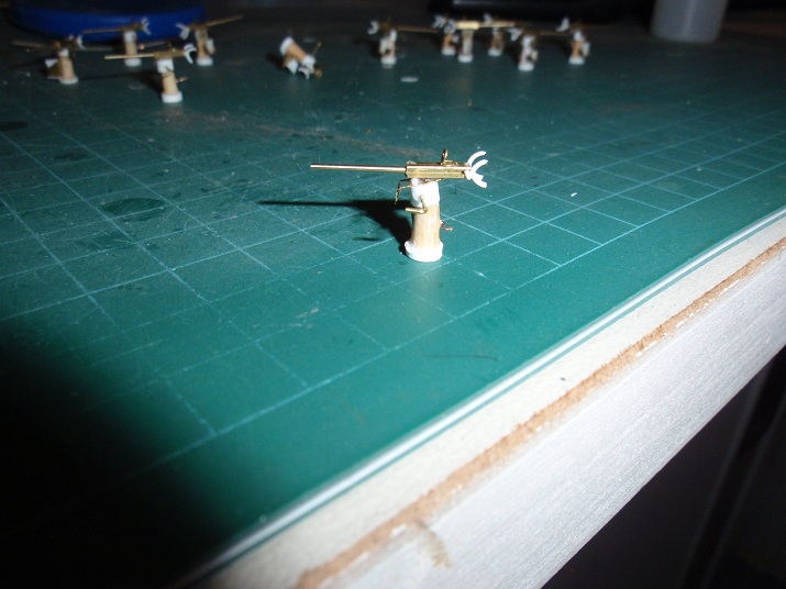

the last things for the funnel is ladders,railings and 20m.m's. For the 20's I used the small end of chop sticks to make the middle part of the base and styrene that i punched out with my old leather punch.i used the wooden chop sticks because i have no way to make tappered things,barrels are 37m.m' i had kicking around,perfect for 20 m.m'.so the material used is wood,brass,copper and styrene.here's some pics.
all the parts and pieces to build 12 guns
the hand wheel is the end of a 1/200 photo-etch hose reel
all 12- 20 m.m's,a very finicky job as you can see my fingers look big and my eyes are weak.

Hi Russ Now those 20mm are really excellent ,. great scratch building :thumbs_up_1: :thumbs_up_1: :thumbs_up_1:

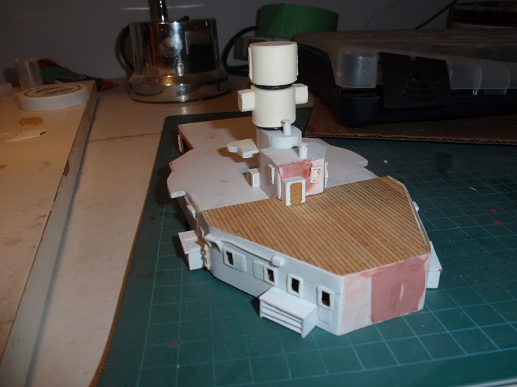

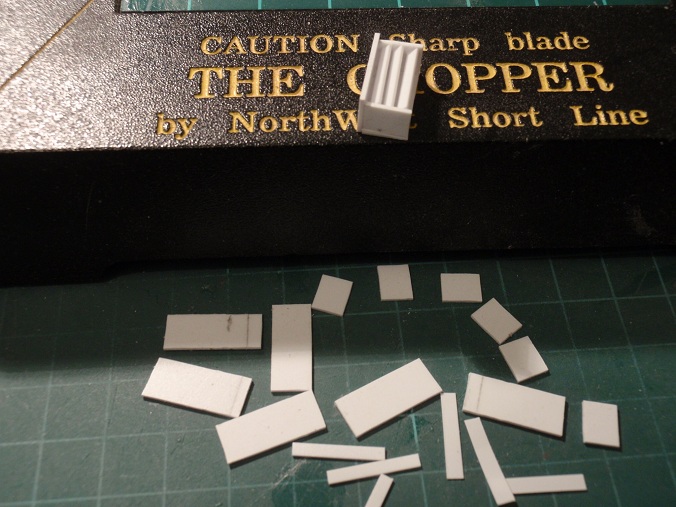

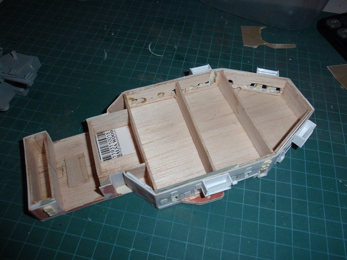

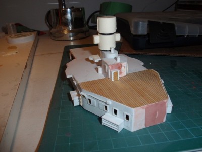

thanks dave,some where along the line i forgot to show the progress of the back deck it was done before the summer ,must have forgot to post it so here it is :heh:
a skin of styrene that will be glued onto the balsa

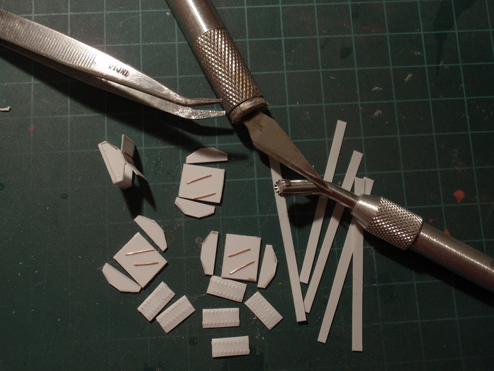

this are the parts for air vents and one assembled air vent

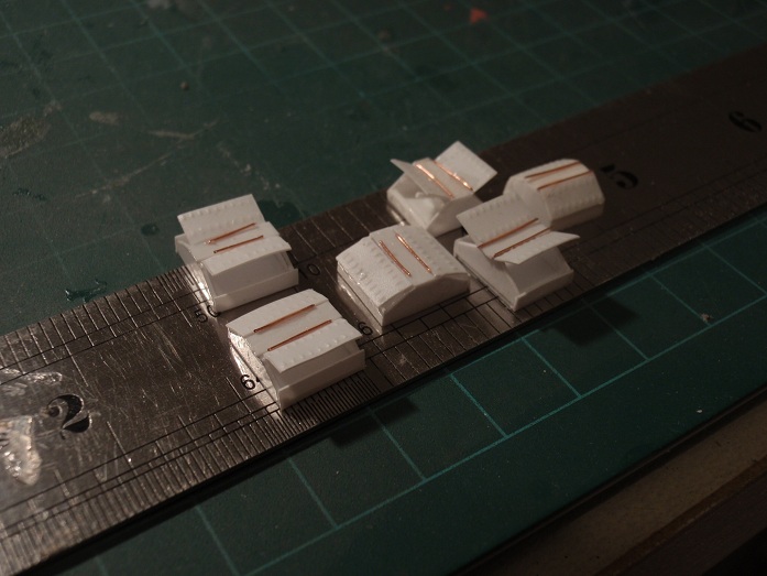

this is the parts for deck hatches
verious deck hatches
one more this shows the balsa sub assembly

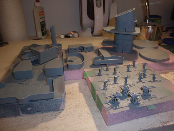

Post by russclark »

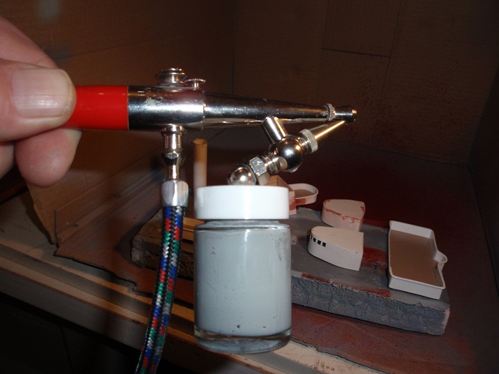

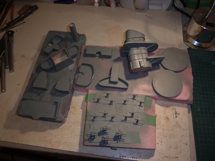

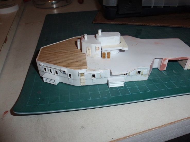

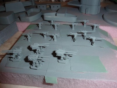

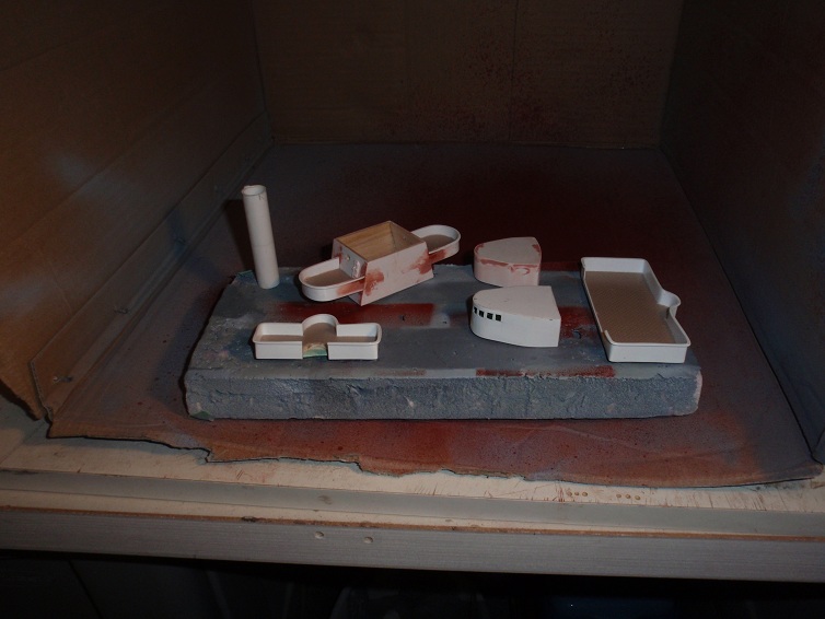

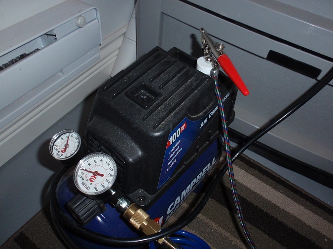

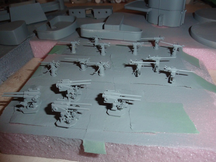

hello all,it's been a while since i've used my air bruch,so i painted the tower structures ,funnel ,and small guns,colour is medium sea gray.my gun is a single action paashe,i used a #5 tip.every time i fire it up it takes forever to get the paint to flow i even thin the paint future,i have to turn the pressure up .once it starts to flow i can then turn it down to about 10 or 15 lbs.

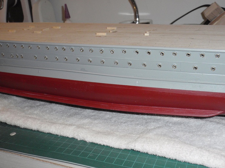

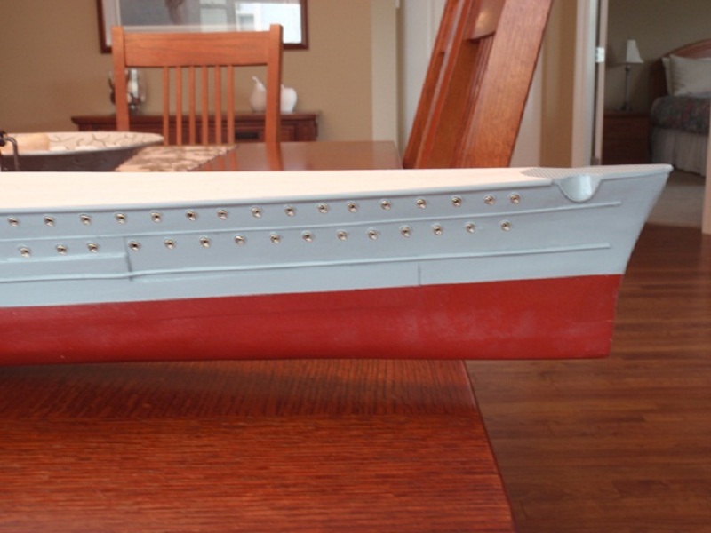

Post by russclark »

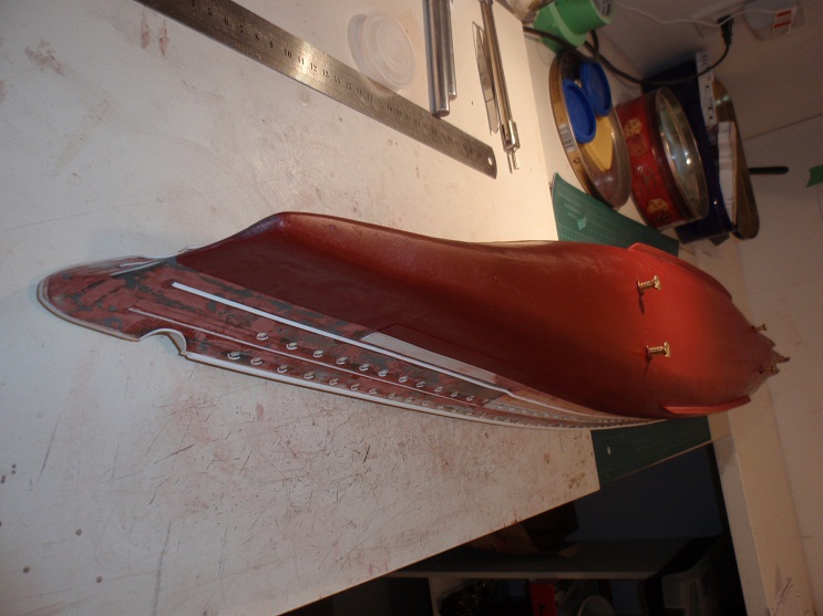

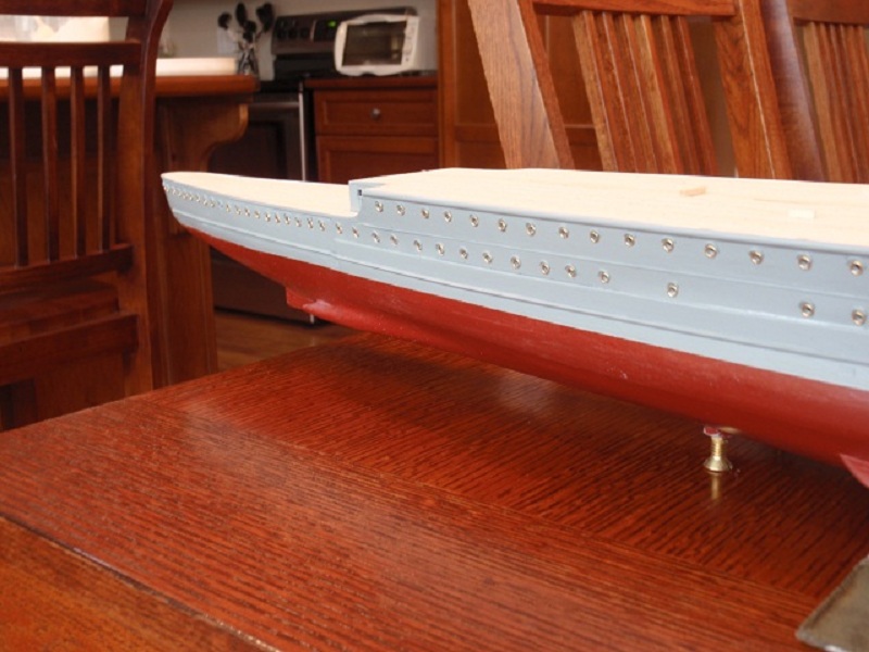

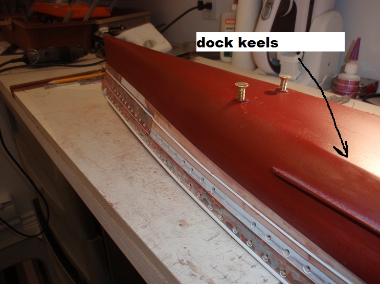

neptune here's a few pics of the hull hard to get an overall shot that will show everything so i took 3 shots of the hull,one pic shows docking keels,109 added them on his bismark mine are not as detailed as his but they are there.
this show the sheers sleek under water hull
Neptune
Posts: 2477
Post by Neptune »
Thanks for the pics, pretty awesome hull you have there!!! :thumbs_up_1: Love your ship's boats as well! If mine are half the quality of yours, I'd be a happy man :heh: :thumbs_up_1: :thumbs_up_1:

Richard J OMalley
Posts: 1012
Post by Richard J OMalley »
Hi Russ
Great job on the hull .The overall upside down shot realy shows her lines . :cool_1: :thumbs_up_1: :thumbs_up_1: :thumbs_up_1:
