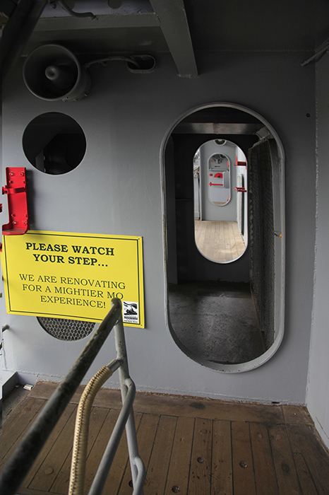

Re: Calling all USS Iowa class fans
Missouri has the comm tubes slanted as above. The vents you picture above are either covered or plated over at present on the ship.
Here is the current state of Missouri! The vents grill is there but I didn't remember it as it is plated over from behind.
I have no information when and where these were closed off.
BB-64 has them angled as well. Look through my photobucket for some shots of that area inside and out. Those vent grills are the fresh air intakes for Fireroom #1. We have them unsealed as well.
The X Bracing above the dual oval openings shown in Chuck's photo does not exist in NEW JERSEY. Her construction was different (as are all 4 ships) - above the dual oval openings was a solid bulkhead. This didn't change thru the 67-69 commission. So, for all practical purposes, I may alter the lower director comm. tube if I can find info. on whether hers was angled or not (I'm guessing it was).
From photos of the 4 ships, it appears that there was no common layout & directive for the way and type of X-bracing that was constructed. All appear to have been constructed as the shipyard directed.
Missouri has the solid bulkhead but originally had the X bracing. Either the solid bulkhead was more solid support or some use was found for a compartment here. On BB 63 the wt doors are of a size and type suggesting splinter protection.
