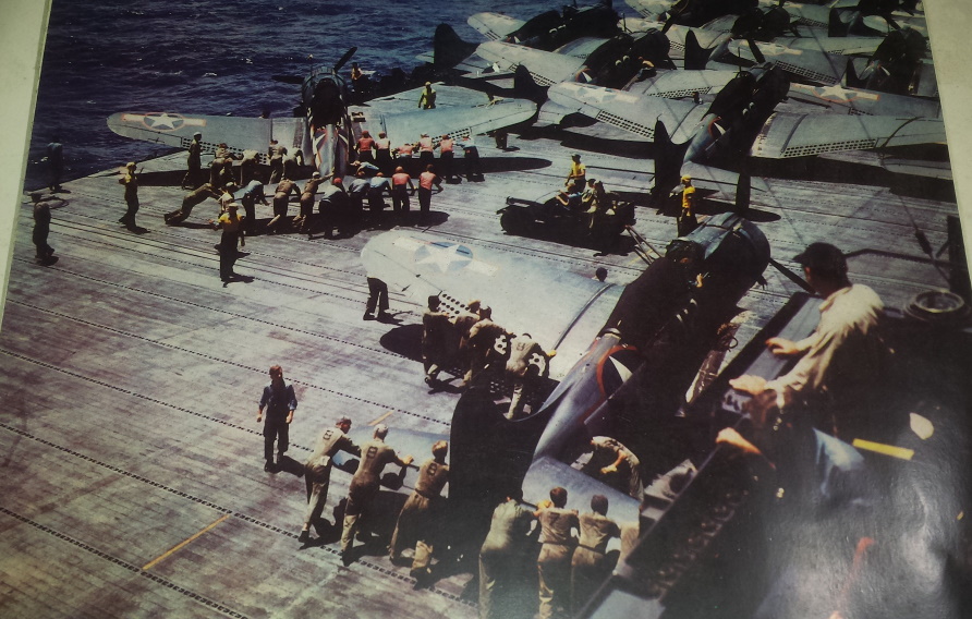

THANK YOU for the clarifications, I am looking for the early 1945 scheme, so my question has been answered. NOW, the aircraft: while there is no doubt all of the Corsairs on her had the overall glossy sea blue scheme, which had become the standard at that time, I have seen evidence that some or all of the TBM Avengers may have still had the 'tri-color' scheme during the same time, with the 'Arrow' matkings in the tail, and possibly some SB2C Helldivers too, any insight on that? I am talking late February until the kamakze attack, after the yellow nose rings had been removed/ painted over.

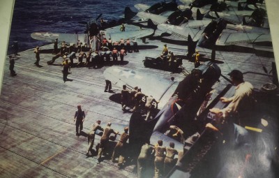

Most of the Avengers were still in tricolor, as you can see in this photo. The vast majority of the VB-84 Helldivers were Glossy Sea Blue but it appears that at least two were in tricolor according to this photo on Bunker Hill's Navsource page.
The carriers didn't repaint aircraft when new directives came out other than insignia, but Air Group 84 was relatively homogeneous (some air groups wild have a mixture of TBM-1s and 3s for example). It's possible that the tri-color SB2Cs were -3s that were sent to the ship to replace combat losses but I haven't gone through her war diaries yet to try and track that. The weekly summaries just list SB2C-4Es. For what it's worth Bunker Hill also had a small collection of Hellcats; six F6F-5Ps for photo recon / damage assessment at the start of the cruise with another four F6F-5N night fighters added shortly thereafter.

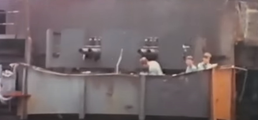

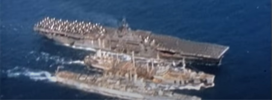

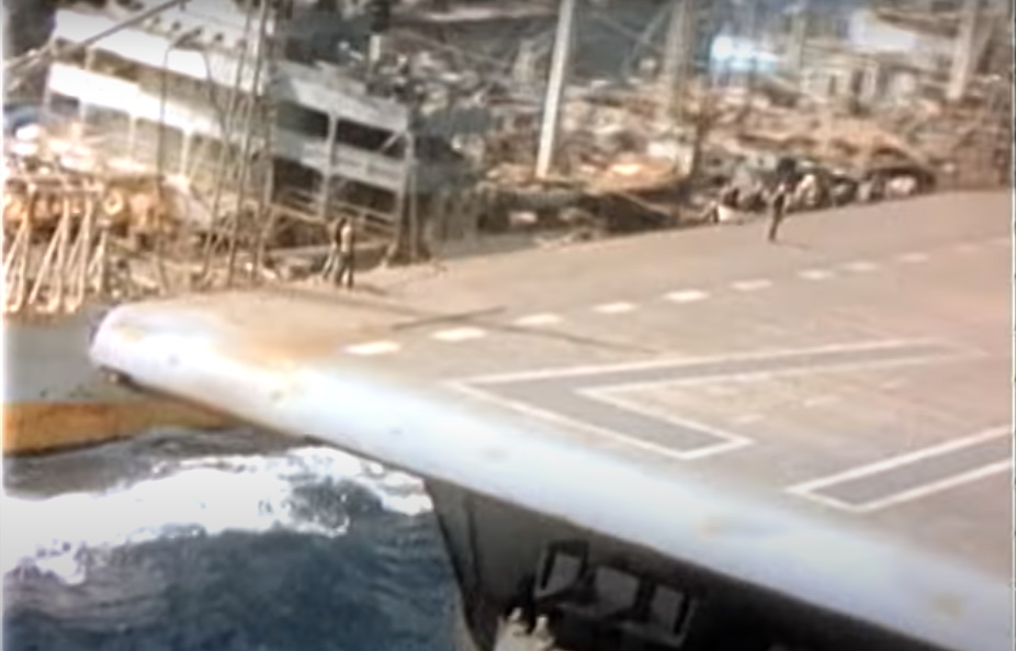

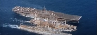

That's interesting. I had always believed she came out of her Jan 45 refit in Navy Grey based on the below color images.She was certainly in 5N Navy Blue measure 21 before the kamikaze hit - Puget Sound Navy Yard reported such.
It's hard to argue with the yard records but this looks like navy grey to me. In addition, I had read that Navy Blue paint was discontinued in 1944 due to lack of blue pigment stocks.
(the 40mm mount is actually May 11, 1945)

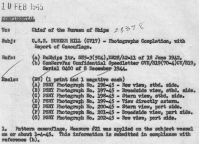

OK, I'm going to start this by partially walking something back, but I'll do that at the bottom after I lay some groundwork.
The first document I have is dated June 1944 and directs PNY to develop formulas and specifications for new neutral paints; a reply a week later indicates that these were preliminary formulas only. In the middle of November PNY forwarded samples of a proposed #37 (replacement for 5-L Light Gray) and asked the Bureau of Ships (BuShips) for approval, which was granted about a week later. BuShips notified the USN paint manufacturing yards of the new formulas a few days later.
At the same time, they notified the Pacific Fleet of the upcoming change and directed the use of the old paints until exhausted (paragraph 5). A letter in January 1945 also shows that the civilian sector was still manufacturing to the old formulas and was expected to for at least a couple of months. We know that the new leaflet specifications for distribution were definitely not in circulation before the end of January.
Now, Puget Sound Navy Yard (PSNS) reported that Bunker Hill was painted "on or about" January 4th:
Note that she's reported in Measure 21, but I need to walk back the definite mention of 5-N Navy Blue. There's no mention of a 5N at all, so we can't even be confused about if they meant 5-N Navy Blue or 5-N Navy Gray. November documentation indicates the specifications were still being finalized, but we don't know where Puget Sound Navy Yard was getting its paint and how much stock of 5-N Navy blue it had. Decision based on evidence is yours.
The process started in 1944, but it wasn't fully completed before 1945. I don't have all of the documentation "yet" but have enough posted to make a good argument. To lay a foundation; during WWII the Navy had two paint manufacturing yards, Mare Island (MINY) and Norfolk (NNY) Navy Yards, and Philadelphia Navy Yard (PNY) was the yard that developed and finalized paint formulas and specifications. Starting in 1942 the Navy started contracting out to various paint manufacturers and by 1944 we have a blend of paint from both civilian and Navy sources.Charybdis wrote:In addition, I had read that Navy Blue paint was discontinued in 1944 due to lack of blue pigment stocks.

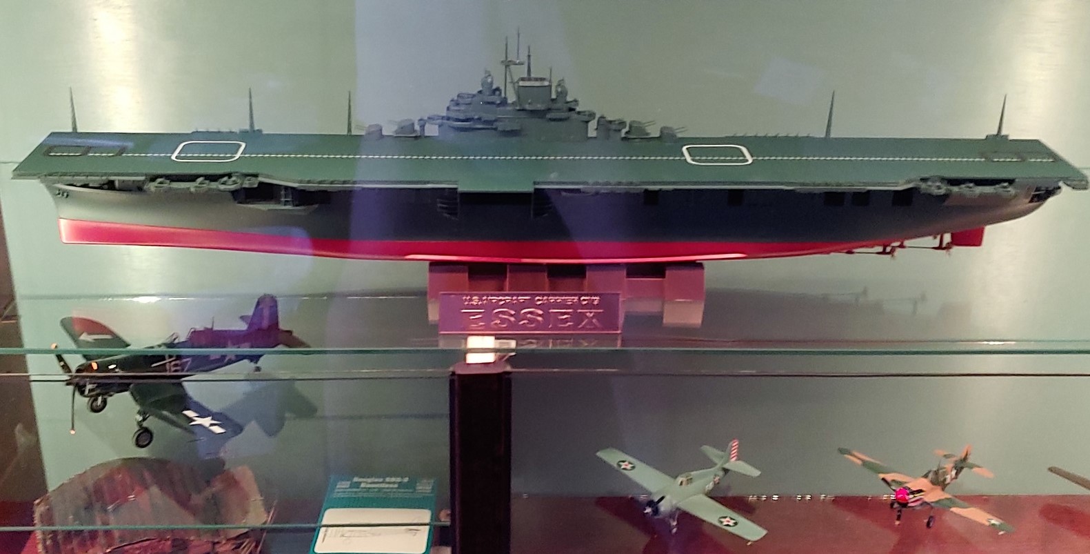

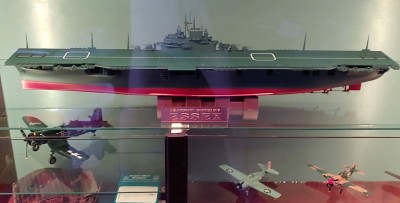

Welcome, I completed the Essex a few months ago, pretty much stock/ no special aftermarket items, this was my first ship build in decades, and my first 1/350 EVER. I built it as a primer before I begin my next build: 1/350 USS Bunker Hill CV-17 (from the USS Franklin Kit) in which I will go all out. One thing I learned: I used the correct colors on my Essex build, but they appear too dark. How a ship appears outside and how a model of it appears inside can be drastically different, if no no other reason the lack of sunlight. That said, the Bunker Hill build will be painted in slightly lighter colors that the actual ones used on these ships. Just my 2 cents. And I'm certainly no pro at this, 70 yrs old and haven't built many plastic models since I was a teen.Dave C. wrote:I am new to this forum and I have read all 124 threads w/interest. I have had the 1/350 Essex for about 15 years and I am glad I haven't started it yet! The knowledge you guys have is worth millions! Just from reading this post, I ordered the AOTS, and "Essex-Class Carriers" by Alan Raven. While I did not see much here on the Essex herself pre-1944, I did garnish a wealth of information to aide me in my build. (whenever I get to it) I have dabbled in model building since I was a kid and several years ago started building military aircraft. In 1992, I got a VIP tour of the John F. Kennedy when she was in Norfolk as part of a specialized team of fire instructors. I have had a hancoring to build a 1/350 scale of the Kennedy ever since! I have gotten a model of her to build and I also have two 1/400 Revell kits of the Enterprise that I want to do in the early 70's while she still had the beehive. I also have a 1/350 Nimitz that I would like to do for the Theodore Roosevelt. Sorry for rambling on but, I did want to thank you for taking the time to share your wealth of knowledge. It will go a long way in helping to build a more authentic representation of my Essex build. Thanks!

CorsairJock brings up two topics I want to throw a bit more on. With regards to colors appearing too dark, you might look in to what is commonly known as scale effect or scale color. In real life, as an object moves towards the distance air and humidity will tend to mute the colors towards neutral, which is why colors may look off on a scale ship that appears more in the distance by size. This is generally more of an issue for the smaller scales but doesn't mean it's not relevant for 1/350.
