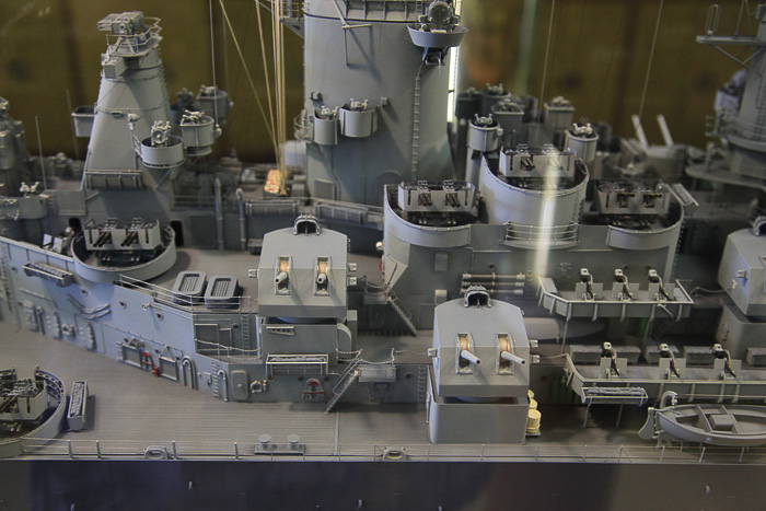

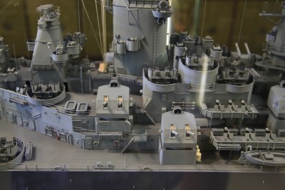

I have a similar to above looking down on to the 03 level flag bridge. You might check WWII photos but I believe the equipment there is about the same, binoculars (20 power) and a signal lamp. At the aft end of this there is an awarthships inclined ladder, not there during the war, just a vertical ladder. I think Trimpy has this right.

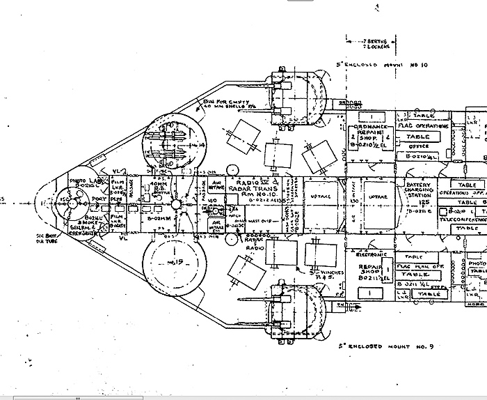

Tom, if you are referring to the pedestal binoculars and signal lamp on the wings behind the flag bridge, I am pretty sure those were not there in WWII. The reason is the binocular and signal lamp is currently mounted near the edge of the deck right behind the railing, and the railing extends forward outboard of the windows of the flag bridge.
In WWII, those railings were not there. Instead near where the binoculars are now there was a low bulwark set further inboard, extending back in line with the windows of the flag bridge. The space between the bulwark and the deck edge had a a floater basket on it. Inside of the bulwark there appear to have been a much bigger signal lamp than the one there now. It was possibly a small search light.
Also, does anyone know where I can find a inboard deck plan for aft end of superstructure at level 03?
In WWII configuration, on level 3, there were 2 door sized openings going through the superstructure, one right ahead, the other behind the base of the mk-38 director tower. Trumpeter closed those off with water tight doors, but several photos on Navsource as well several drawings and renderings indicate there were no doors, just plain openings on the side of superstructure. So I opened them up. Now it is possible to see inside. I am looking for deck plan there to see what is inside of these openings? Is there just a narrow athwart ship passage way for foot traffic behind each opening, or does the openings open onto a bigger compartment?

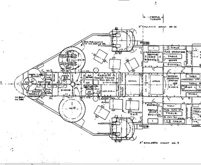

The HSNA general arrangement drawing (1954?) of BB64 shows the area you are speculating about. It does appear that there are two short passages that may not have external W/T doors. On either side a photo stores room, a clipping room for 40 mm etc. needs conformation as to being doorless, but not a huge open room.

Here is a shot of the doorless opening abaft the tower on the Iowa, visible just above the corner of the 40mm gun shield:
http://www.navsource.org/archives/01/016122.jpg
Here it is right above the 20mm shield
http://navsource.org/archives/01/061/016177.jpg
Here is the one before the mk-38 tower on the New Jersey, just above the aft most 5" mount
http://navsource.org/archives/01/062/016201b.jpg
I have not found photos of this area on the missouri or Wisconsin, but several renderings of missouri show the arrangement is identical to the Iowa and New Jersey.

Whisky plan aft, 1954. the hatched areas without are ovoid openings without doors. Same symbol is used by the awarthships Mk 37 director base openings. Note the centerline passage aft has one of these as well, indicating a structural support. As the ship still has her 40 mm mounts, probably somewhat similar to the WWII configuration.

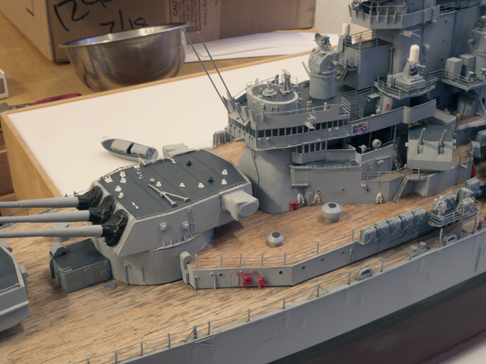

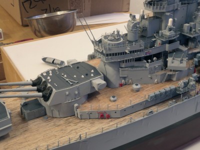

Hardly anyone goes over to the scratch section, so here is a today photo of the goings on with my 1:192.

Your BB63 is REALLY looking good - you've added so much detail - it's amazingly REAL!!!
I have to admit, when the topics on similar builds are spread out it's hard to cover each and all. Perhaps a management guru will see all this and figure out a simpler posting process so we all can see what we need to see in an easier fashion - something like a similar topic link within a given post that would be a quick-click to the next one and so one. Does that make sense?
OK, back to your model - I esp. like the way the deck has turned out - very realistic with the variance of the color and grain pattern - much like the real thing!!
