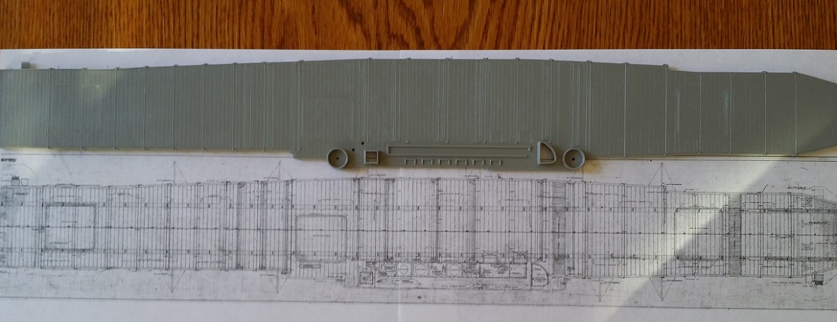

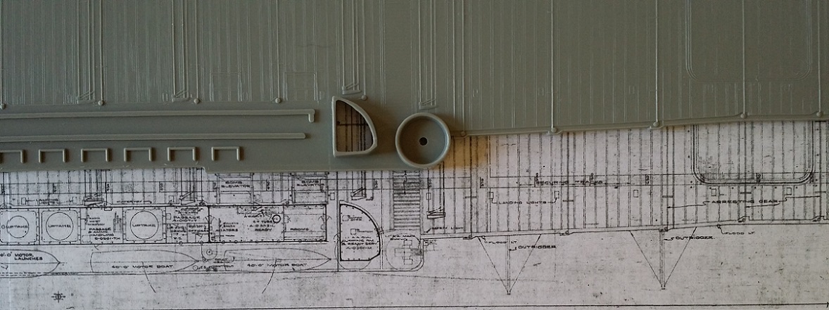

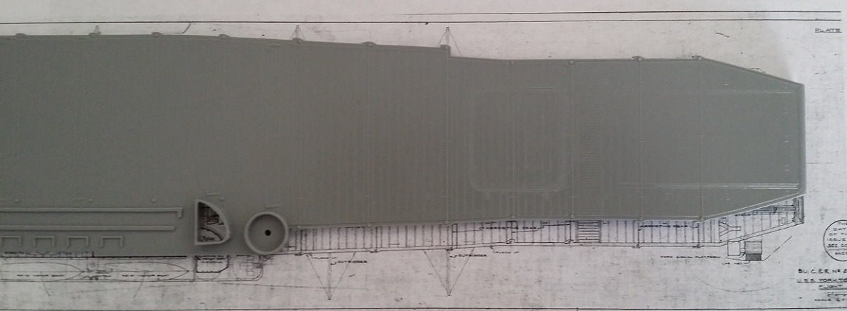

The Merit CV5 kit over emphasizes the hull plating. Is it everyone opinion that to provide a more scale appearance to the kit hull that all plating and vertical straps should be sanded off completely such that the hull is smooth?
Frank R

Yes, the best thing to do would remove it completely. Not only is it overstated, but it's a completely incorrect pattern.

It's really a matter of opinion. Yes, the hull strake detail is overdone, but some people like it and you do catch a hint of it from time to time in different lights on the real thing (uhhhh when she was afloat...)
Simply taking off the vertical straps is the easiest improvement as they sand away a lot quicker than the whole strake that runs the length of the kit. Taking it all off and either leaving it smooth or putting a more correct pattern and thickness back on are the other two main options. It's been suggested to fill in the "lows" with sheet styrene, but this option would require re-drilling a lot of portholes and would require a lot of test-fitting and tweaking for the strips fitting over the compound curves on the bow and stern.

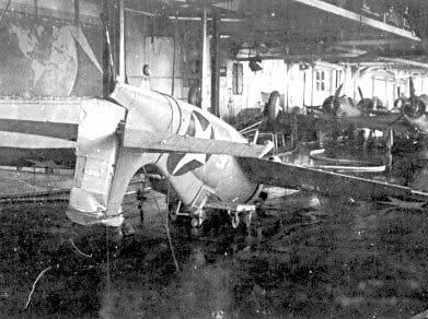

There are people who've spent YEARS searching for a full photo of that mural, and to this day one has not been found. It either doesn't exist, or it's in a file drawer or someone's shoebox of old photos somewhere.
Below are the only two photos that show it, to the best of my knowledge.

I'm one of the one who's spent "years" looking for it so I'll give you a rundown. Going to try and take another stab at it in a couple of months as well, so it ain't over yet.
US National Archives receives many records from many different government agencies. In the case of Naval records, you have many different groups (official term is "activity) submitting records, such as the Bureau of Aeronautics, Bureau of Ships, Chief of Naval Operations, Assistant to the Vice Chief of Latrine Development on Johnston Atoll (OK, that one's made up, but there's a couple that show up where your first reaction is, "really? We had that?"). Short of it is that there's a lot of places to look.
Next, one of the prime areas to look is a subset of Record Group 80, which is "General Records of the Department of the Navy, 1798-1947." There is a subset of RG 80 known as 80-G titled "General Photographic File of the Department of Navy, 1943 - 1958" (the beginning date is a misnomer, there are photos in 80-G that are much earlier - at least WWI). This is nearly 3,000 boxes long, about 540 linear feet. To say it takes a while to go through this is an understatement.
When the Navy turned over the photos, they also turned over a card catalog that lists photos and allows us to search for a subject as opposed to simply starting at one end and going from box to box until we get to the other. I covered a little bit of this here for those that are interested. They do things a couple of different ways - there's a section that is organized by ship name, another by designation, etc..
Neither the "CV-5" or "Yorktown" section has more than five cards in it, and there are far more than five photos of the ship in 80-G. So, it's become a case of grabbing known 80-G numbers for the ship, pulling the appropriate box and the ones on either side, and hoping that there was more than just that one photo.
Ron Smith said that at one point he saw a full picture of the mural in 80-G in the background of a shot of an admiral, but after a few boxes your mind turns to mush and it's really impossible to remember where you saw what. There's a good chance there's a photo out there, we just have to figure out where. We had hoped to get this included as a decal on the Merit kit, but it just didn't happen.
I'm sure you just wanted to know which book to buy or which website had the elusive image, but that's the state of the archival research, anyway. :thumbs_up_1:

I wasn't aware Ron had spied the unicorn. That's at least encouraging.
