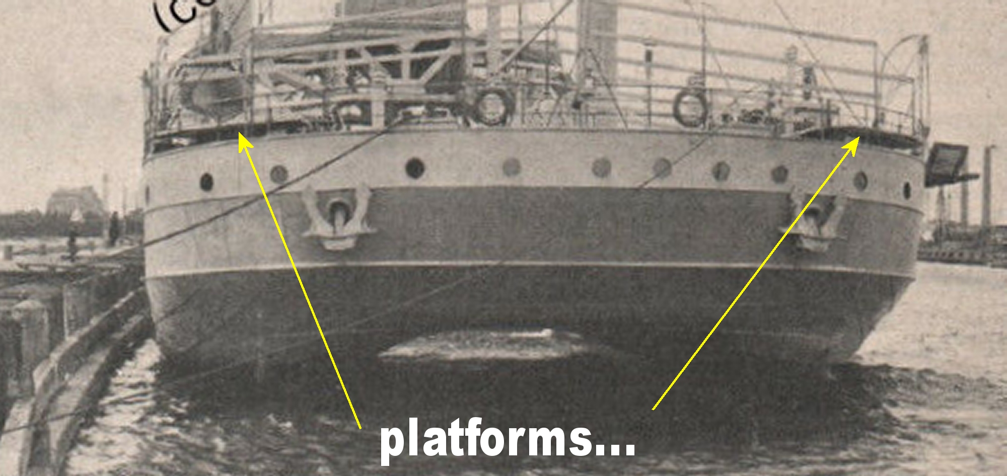

meanwhile.... I spotted these platforms some time ago
- but saw in my collection of images no positive confirmation of their actual presence on the ship
until I found THIS ' fresh ' image on-line.... seems like recently uploaded...( dohh! )
So I found in my PE stash some suitable brass grating material ,
cut and filed the platforms to shape and installed them on slightly raised very small legs (!)
Continuing on with the fictive narrative... :cool_2:
