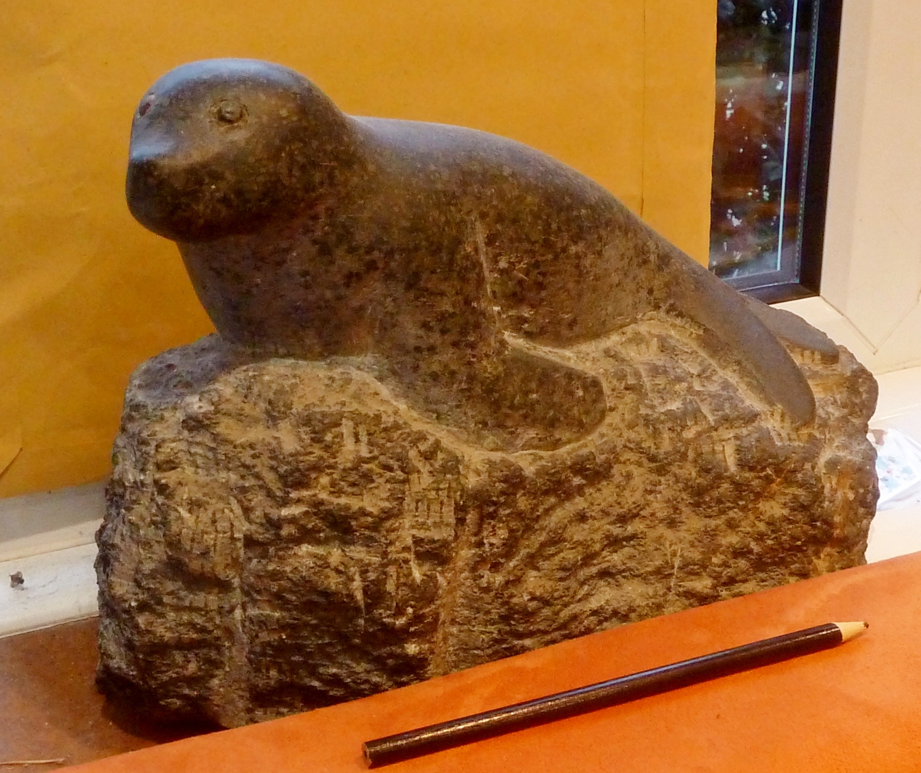

when I was 16 yrs old,- at boarding school,- I did some sculpture
I had time and opportunity back then--hammering at the stone with chisels and hammers...
This seal in sandstone has been in my homes ever since and now resides on the kitchen window sill!
Excellent step -by-step on the fgure head modellimg-- its results that count!
subtractive sculpture...
I can add ( hahah!) a bit here;

That's a great looking seal! Bravo!
