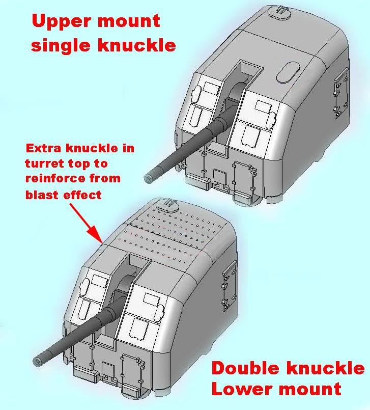

What are the visual differences between a 5" 38 cal 'single knuckle' and 'double knuckle' housing? Any good WEB sites that have pictures or drawings?

sixman wrote:What are the visual differences between a 5" 38 cal 'single knuckle' and 'double knuckle' housing? Any good WEB sites that have pictures or drawings?
Here is a comparison of the two.
Note; not all lower mounts had the rivets.

For the mounts that had the double knuckle, were the two sections of the double knuckle set at slightly different angles? From the drawing it looks like there are four planes (the front, the two knuckles, and the top) as opposed to three planes (front, knuckle, and top) on the single knuckle mount.

sixman wrote:For the mounts that had the double knuckle, were the two sections of the double knuckle set at slightly different angles?
Yes, those panels angle up at about 2 degrees on each side from the original plane. It is very slight and it hard to see on a mount. But it is there.

I posted this image on the Fletcher fans forum. However, the 5-in mounts were basically the same. This is the Abbot (DD-629) after a little fender-bender, that shows the welded versions of the gun houses. In many photos it is hard to see the double knuckle, but the lighting in this Pearl Harbor photo is just right.
