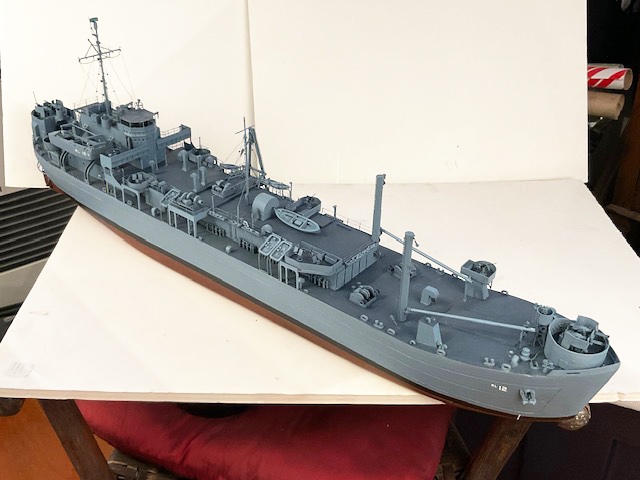

Current status stern area ARL 12.

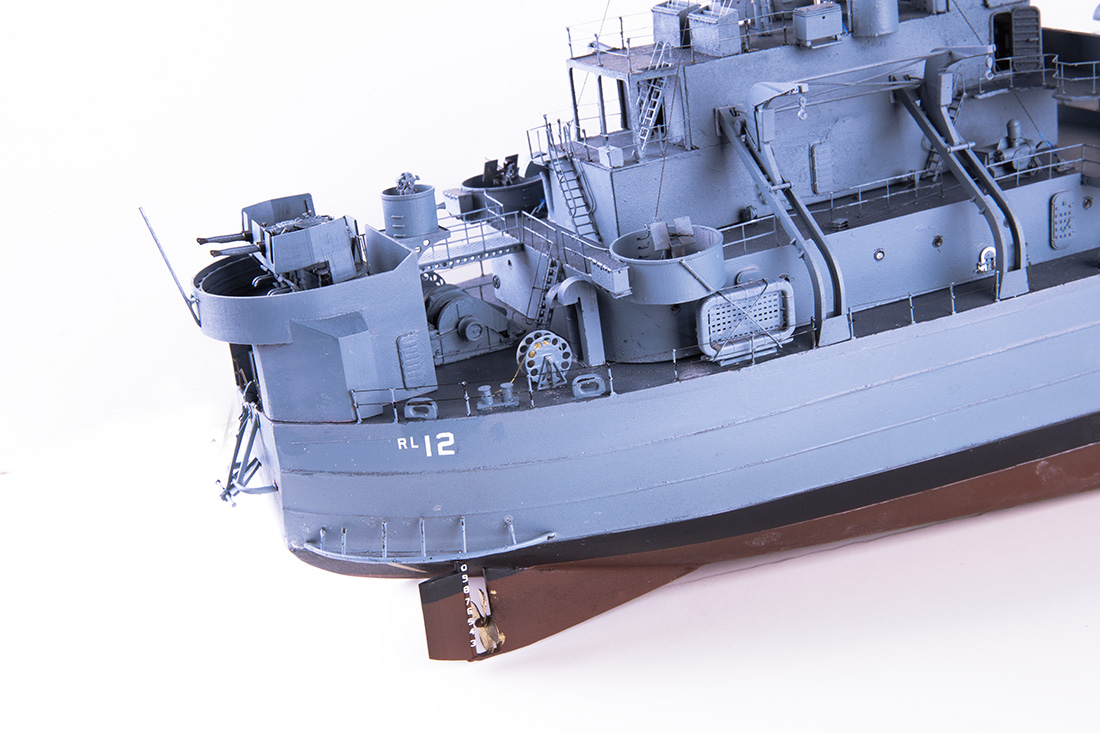

Progress is in miniature bites! I added a set of deck binoculars and a pelorus to each bridge wing, rigged the winches for the A Frame derrick plus a few small deck vents. Getting time to construct and emplace the various supports for the deck overhangs. Yet another things to procrastinate on. Working stern to bow, which seems an adequate plan.

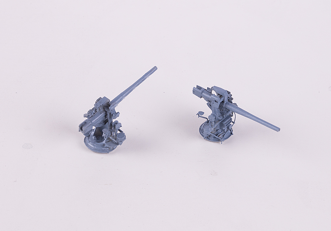

3" 50 as used on many auxiliaries and smaller ships.

Those look really good!
I'll be doing a print run this afternoon, so we'll see how they turn out in R.B. resin @ 1/144 scale. Only substituted one bottom base ring from the version I had started after scaling down from 120.

Hank:
Good luck, as always with complex shapes, the supports are critical. Reduced to 1:144 the brackets holding the sights for pointer and trainer may be a little thin, but then you are using a different (better?) resin. Check out the HNSA manual for the 20 series mounts, I followed that pretty closely. Perhaps the seats need to be a little wider. With the RB resin they should print with the perforations as the ones on the Bofors did quite well.

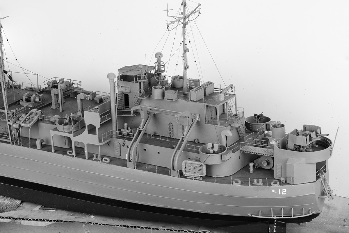

A few small additions, the twin tall vents abeam the bridge and new sky lookouts. Not sure about the tall vents, engine exhaust? The sky lookouts based on the ones on USS Slater on her bridge wings. Binoculars look like std navy 7 x 50's.

Thank you David. On my Sphinx drawing they are vanishingly faint! One wouldn't know they were there except for the caption displayed in front of the flying bridge!
