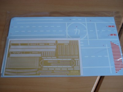

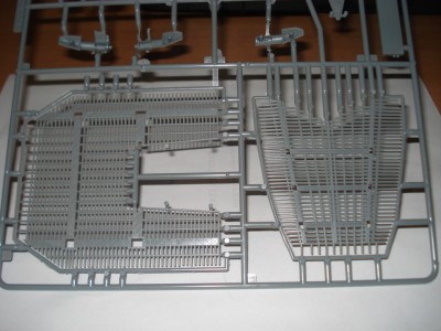

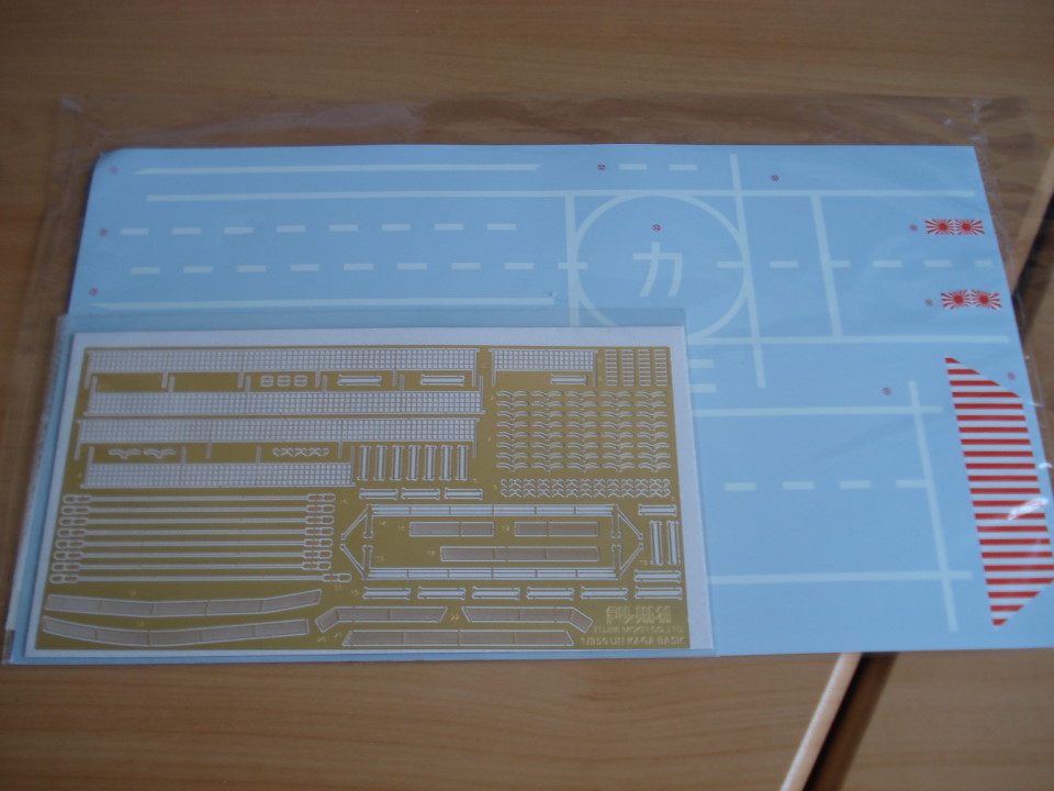

My 1/350 Kaga has arrived. Will post a pic here and can e-mail / send a few more if wanted.
Plenty of etch for under the forward and aft flight deck, similar to the Akagi. Degaussing comes in the larger etch set (#40) as an option, does not appear to be on the hull. Rearmost struts for the flight deck do not seem to be an etch option, they will need to be drilled out for accuracy (or wait for an aftermarket option). A single etch fret comes with the kit and includes nets, arrestors etc. Standard etch set (#39) covers all railings, ladders and colored landing lights. Will add 1 pic now and post another of deck/s when I get home this afternoon.
Looks to be a very, very nice kit.

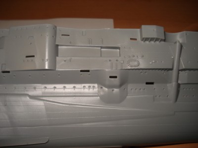

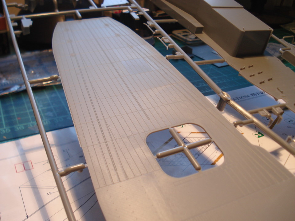

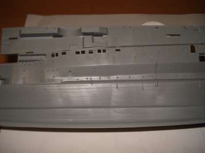

Some pics of the deck detail as requested, hope this helps
- Posts: 9093
Re: Calling all IJN Akagi and Kaga fans
Confirmation accepted.

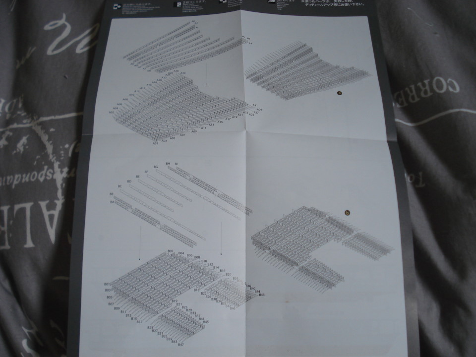

Hi Dan / All

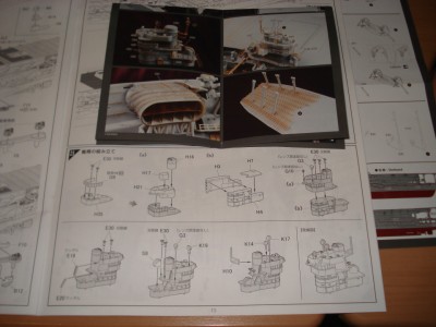

The Island looks pretty much like that on Akagi, the photo etch brings it to the next level as would be expected. I have added a pic so you can hopefully see how it is on the instructions.

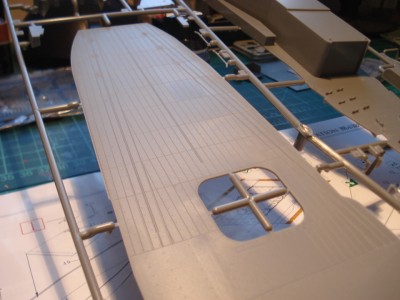

Putting the Kaga hull against my Akagi shows Kaga is a bit shorter but also "taller" by about 10mm.
Have also taken a pic of the hull with my half completed USS Fort Worth as reference.

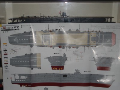

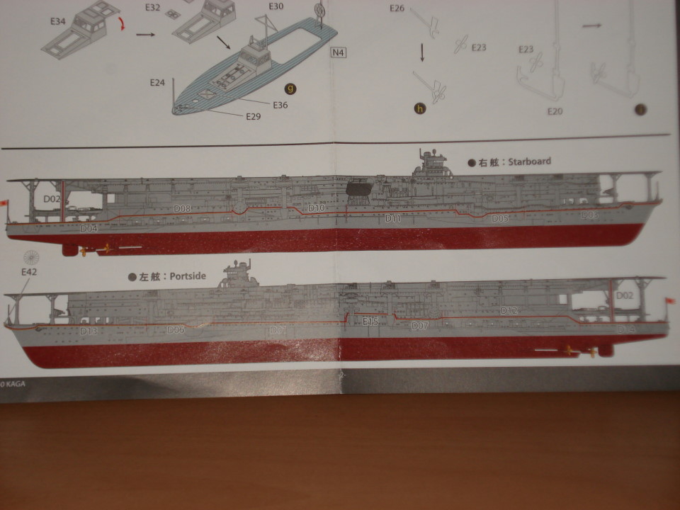

After studying the photos on page 8 of this thread, I am not 100% convinced they prove Kaga had 6 support struts under the forward part of the flight deck. I believe the "outboard" set of arrows might be the shorter supports to part K-33 of the 1/350 kit (the broad forward bulkhead to the hangar decks). The photos seem to match up well to the forward view of the painting diagram in the kit, which depict the ship with only 4 support struts.

Guys, fair point re only 4 support struts under the forward flight deck, the large full size poster that comes with the kit only shows 4? Not that that is by any means proof, but I think its good that we are given the option of 4 or 6 as per my pic of the instructions. At the moment I am probably going to use all 6. The Kagero 3D book (which is excellent) has all 6.
If anyone want's a pic of a part posted let me know.

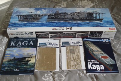

Kaga Kit, Etch sets & both Kagero Books. I haven't read the Hardcover yet but will post if it states anything about when the extra pair of supports may have been fitted.

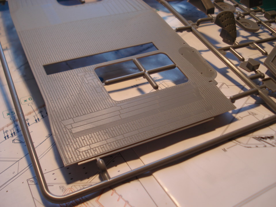

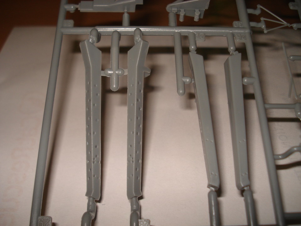

Thought I would take a few more pics, more I look at the parts, etch etc more I want to rush in and start.
Would have liked the very rear pair of deck supports (see pic) to have come in etch, but not so, either a very small drill or wait for A/M.
